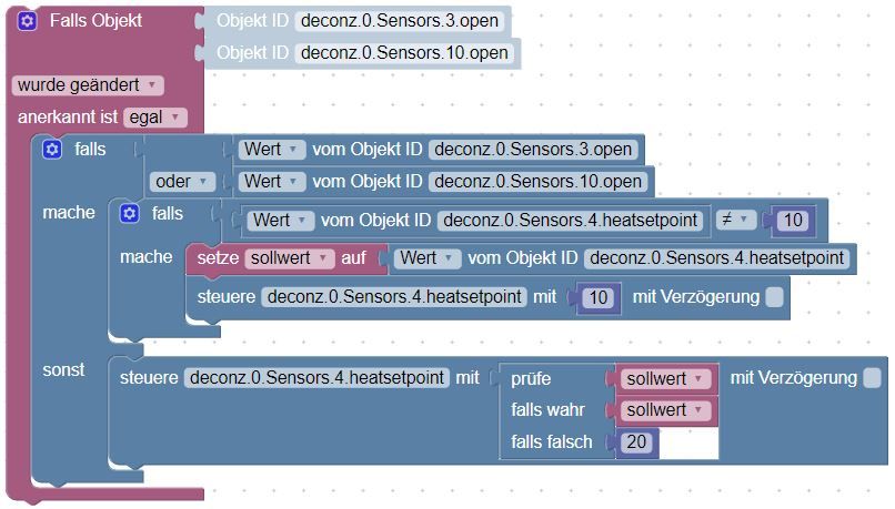

        paul53 @adrian-c last edited by paul53
        @adrian-c
        Versuche es mal so:
         <variables>
           <variable id="TU%]2q{ieoCPk=(uTLZg">sollwert</variable>
         </variables>
         <block type="on_ext" id="r}8_@`I?$%*,O-L;w2]b" x="-63" y="-196">
           <value name="OID0">
             <shadow type="field_oid" id="J3hGgkY5NI2Z0w;T~c}F">
               <field name="oid">deconz.0.Sensors.3.open</field>
           <value name="OID1">
             <shadow type="field_oid" id="-I7xDU0Sn~xm`7L1vnIP">
               <field name="oid">deconz.0.Sensors.10.open</field>
             <block type="controls_if" id="M3}s*{i,927;i8p=tb1(">
                 <block type="logic_operation" id="O4oV$P:dH5;yHPVsx$_[" inline="false">
                   <field name="OP">OR</field>
                     <block type="get_value" id="$^4pV_$`qRYqr0ErzSt)">
                       <field name="OID">deconz.0.Sensors.3.open</field>
                     <block type="get_value" id="vTJyj;AniVa7XHKVm9e)">
                       <field name="OID">deconz.0.Sensors.10.open</field>
                 <block type="controls_if" id="c/y=h-9ijaXlJ*iqZ7~l">
                     <block type="logic_compare" id="Mj9Nh,SwY/xqhm#}S0Yg">
                       <field name="OP">NEQ</field>
                         <block type="get_value" id="5)`nIBR_+7bn(tXg^AWp">
                           <field name="OID">deconz.0.Sensors.4.heatsetpoint</field>
                         <block type="math_number" id="h`fBr)|@-~pAWY_[4-%2">
                           <field name="NUM">10</field>
                     <block type="variables_set" id="=05J6CwY9*ba1U.U#=)}">
                       <field name="VAR" id="TU%]2q{ieoCPk=(uTLZg">sollwert</field>
                         <block type="get_value" id="LQP+]EdXz24s1({58a)A">
                         <block type="control" id="O8^w^;(ppG(Ef:xb3ikC">
                             <block type="math_number" id="5YwUK;n0vS;J!I*ny8,C">
               <statement name="ELSE">
                 <block type="control" id="*s-F$ZQt`h}-Yjo:UQlP">
                     <block type="logic_ternary" id="~*XrXjE#xj;s?FI8i0lz">
                       <value name="IF">
                         <block type="variables_get" id="PwE*yGbn1R=GA~p`|yPu">
                       <value name="THEN">
                         <block type="variables_get" id="`lCoZ:7FoG^JF0!l6k9x">
                       <value name="ELSE">
                         <block type="math_number" id="GGnz13N^nZ.ImKvW$dx_">
                           <field name="NUM">20</field>
          adrian-c @paul53 last edited by adrian-c
          @paul53 mega, danke!!!! Ich habe es nach deiner ersten Version probiert, funktioniert sehr gut.
          • okay, die 20Grad sind dann sicher eine Art „Ersatzwert“, korrekt?
            @adrian-c sagte: die 20Grad sind dann sicher eine Art „Ersatzwert“, korrekt?
            Ja, für den Fall, dass das Skript gestartet wird, wenn ein Fenster offen ist und danach das Fenster geschlossen wird.
