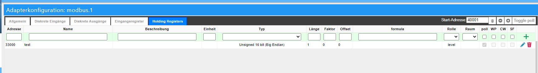

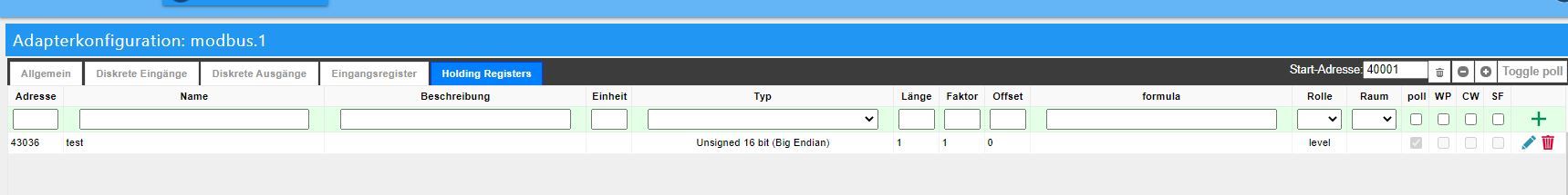

      ich versuche mit einem Modbus USB Stick eine Verbindung zu meinem Solis Wechselrichter herzustellen. Leider bekomme ich beim verbinden mit der Adresse nur folgenden Fehler angezeigt:
      code_text
      ```modbus.1	2021-04-27 11:29:44.372	debug	(821) Cleaning up request fifo.
      modbus.1	2021-04-27 11:29:44.369	debug	(821) Clearing timeout of the current request.
      modbus.1	2021-04-27 11:29:44.363	info	(821) Disconnected from slave
      modbus.1	2021-04-27 11:29:43.364	warn	(821) Poll error count: 1 code: {"err":"timeout","timeout":5000}
      modbus.1	2021-04-27 11:29:43.360	error	(821) Request timed out.
      modbus.1	2021-04-27 11:29:43.359	warn	(821) Error: undefined
      modbus.1	2021-04-27 11:29:38.345	debug	(821) Poll holdingRegs DevID(1) address 3035 - 1 bytes
      modbus.1	2021-04-27 11:29:38.344	debug	(821) Initialization of scale factors done!
      modbus.1	2021-04-27 11:29:38.341	debug	(821) Poll device 1
      modbus.1	2021-04-27 11:29:38.338	info	(821) Connected to slave
      modbus.1	2021-04-27 11:29:38.321	debug	(821) connect to serial /dev/ttyUSB0 with 9600
      modbus.1	2021-04-27 11:29:37.550	debug	(821) Add holdingRegisters.43036_test: {"_id":"holdingRegisters.43036_test","type":"state","common":{"name":"","role":"level","type":"number","read":true,"write":true,"def":0,"unit":""},"native":{"re
      modbus.1	2021-04-27 11:29:37.549	debug	(821) Initialize Objects for holdingRegs: [{"_address":43036,"name":"test","description":"","unit":"","type":"uint16be","len":1,"factor":1,"offset":0,"formula":"","role":"level","room":"","poll":true
      modbus.1	2021-04-27 11:29:37.548	debug	(821) Initialize Objects for inputRegs: []
      modbus.1	2021-04-27 11:29:37.547	debug	(821) Initialize Objects for coils: []
      modbus.1	2021-04-27 11:29:37.546	debug	(821) Initialize Objects for disInputs: []
      modbus.1	2021-04-27 11:29:37.168	info	(821) starting. Version 3.3.0 in /opt/iobroker/node_modules/iobroker.modbus, node: v12.22.1, js-controller: 3.1.6
      modbus.1	2021-04-27 11:29:36.749	debug	(821) Plugin sentry Initialize Plugin (enabled=true)
      Hat jemand eine idee was das Problem ist. Ich hänge das Modbus Register Datenblatt vom WR mal an._Without Control Hybrid EN 2020.9.15_RS485_MODBUS(ESINV-33000ID) Hybrid Inverter .pdf
      UncleSam 1 Reply Last reply Reply Quote 0

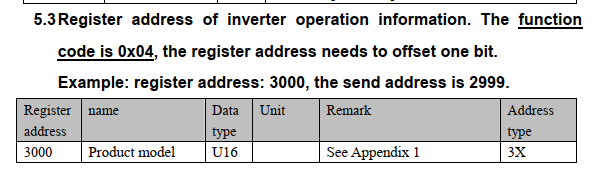

        @mathschut sagte in Modbus Verbindung mit Solis Wechselrichter geht nicht:
        Modbus USB Stick
        Ich nehme an, das ist ein USB-RS485-Stick?
        Stimmt Geräte ID "1"?
        Slave Address:it is the corresponding slave address, it must be matched with inverter address
        Das solltest du auf jeden Fall noch beachten (nicht mehr als 50 Register):
        Require higher than 300ms (Not included) of inter-frame interval. Recommend max data frame of
        100bytes (50 register address)
        Woher hast du Adresse 43036, ich finde die auf den ersten Blick nirgends in der Spezifikation.
          mathschut @UncleSam last edited by
          @unclesam Hi, danke für deine Antwort. Habe gerade nochmal nachgeschaut. Im Wechselrichter steht als Slave Adresse 01 drin. Muss ich dann auch 01 eintragen oder trägt man dann 1 ein?
          Wenn ich jetzt 33000 eintrage, müsste doch was kommen oder?
            @unclesam

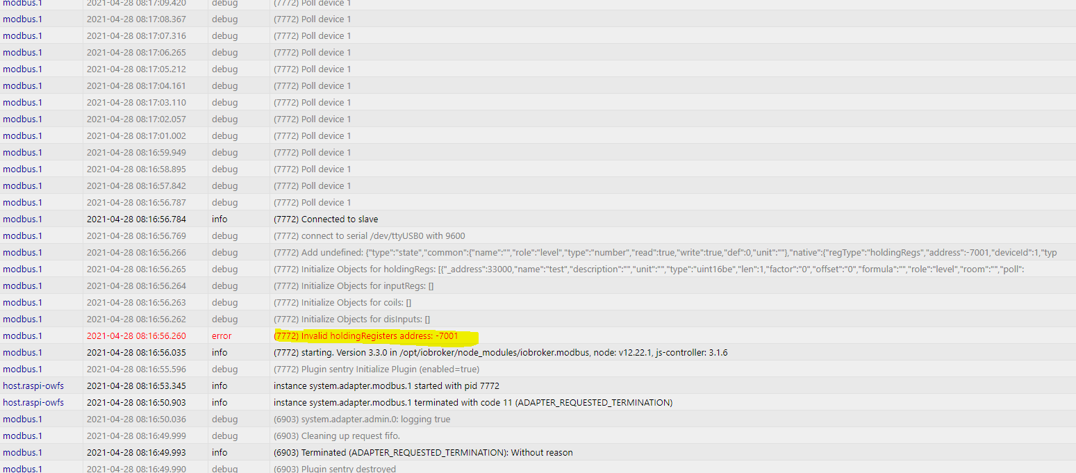

            jetzt bekomme ich immer folgende Fehlermeldung: 7772 Invalid holdingRegister address_ -7001
            Jan-Philipp Schmidtmann 1 Reply Last reply Reply Quote 0
            • Jan-Philipp Schmidtmann
              Jan-Philipp Schmidtmann @mathschut last edited by
              @mathschut

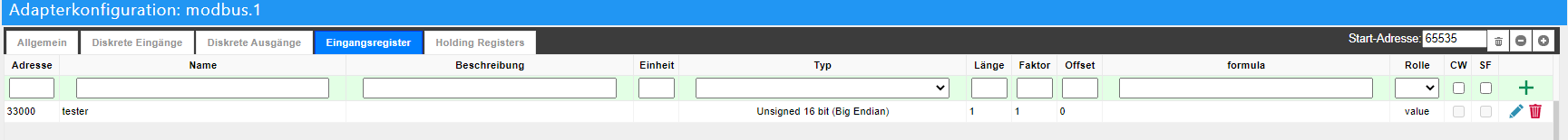

              Der Adressbereich 30001 bis 39999 sind Input-Register. Versuch mal, den Datenpunkt im Reiter Eingangsregister anzulegen.
                mathschut @Jan-Philipp Schmidtmann last edited by
                @jan-philipp-schmidtmann

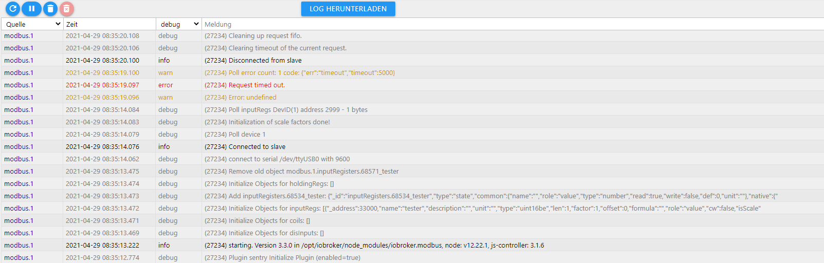

                Hi habe ich dort angelegt. Jetzt bekomme ich anderen Fehler:
                  @mathschut Bei Modbus ist es ja so, dass die erste Zahl der Adresse das Register angibt und der Rest die Adresse ist. In deinem Log sieht man, dass der Adapter versucht Adresse 2999 zu pollen. Die ergibt sich aus 33000-30001(die erste Adresse im Input Register). Versuch mal als Adresse die 33001 zu verwenden, dann sollte er die 3000 pollen. Vielleicht klappt das. (Hab keine Erfahrung mit dem Modbus Adapter, kenne das Problem jedoch aus Industriesteuerungen).
                    @jan-philipp-schmidtmann leider der selbe Fehler bei 33001

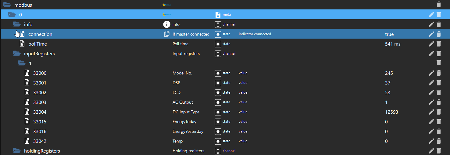

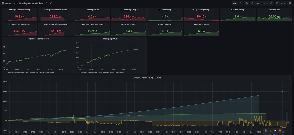

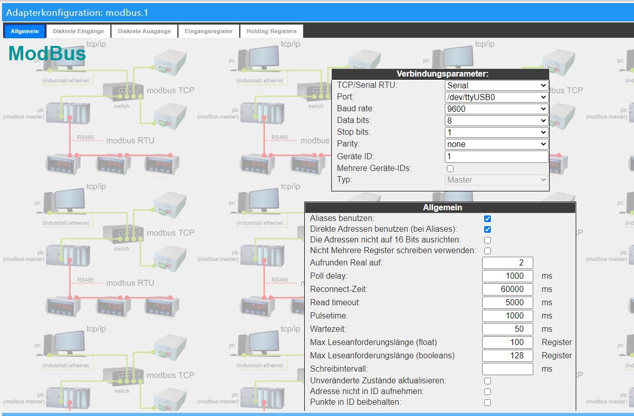

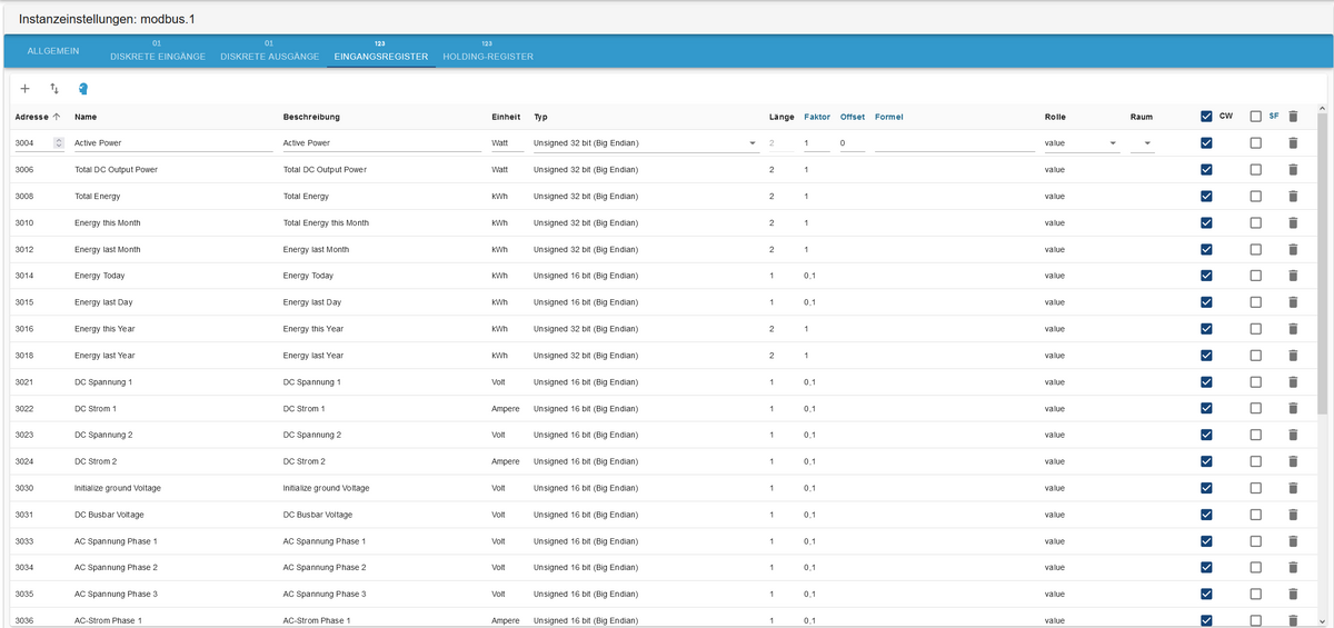

                                  @comtel Nach längerer Zeit habe ich mich gestern mal wieder mit meinem Wechselrichter, dem Modbus , IOBrocker und Grafana beschäftigt.
                                  Mein Solis-3P6K-4G-Wechselrichter ist nun über einen RS-485-USB-Stick an einem Raspberry Pi angeschlossen, auf dem Grafana und IOBrocker laufen. Im IOBrocker habe ich den Modbus-Adapter laufen, und in diesem die Register gemäß der Beschreibung die es für den WR zum Thema Modbus gibt eingetragen. Mit etwas tüfteln, habe ich festgestellt, dass man von den Registerwerten der Beschreibung 1 abziehen muss, damit plausible Werte dabei rauskommen.
                                  Und nüh funktioniert das.
                                  Das Modbus-Plugin von IOBrocker holt die Daten vom Wechselrichter und schreibt die in die Datenbank, die dann von Grafana angezeigt werden.
                                  Bei anderen WR-Modellen müsste man die Register anpassen, gemäß den Beschreibungen die man dafür im Internet findet.
                                  Ich hoffen einigen anderen, die Interesse an der Visualisierung der Daten vom WR haben, damit geholfen zu haben.
                                  StefanD.
                                  R T 2 Replies Last reply Reply Quote 0
                                    Roetty @Jean_Luc_Picard last edited by
                                    @jean_luc_picard
                                    Hi Stefan, könntest Du evtl. mal ein paar Details zur Verfügung stellen? Das wäre großartig.
                                    Ich versuche einen rhi-5k-48es-5g über IOBroker auszulesen, bekomme aber Fehlermeldungen.
                                    Interessant wären Infos von Anfang an:
                                    1. Verdrahtung: Welcher Port am Solis A an A B an B oder umgekehrt. Abschlusswiderstand Ja/Nein
                                    2. Parameter im ModBus Adapter: ID, Pollzeiten etc.
                                    3. Inputregister Screenshot (Haste ja schon gepostet ✌ )
                                    4. Evtl. fällt Dir ja noch mehr ein.
                                    Ich wäre Dir unendlich Dankbar 🙂
                                    VG Rötty

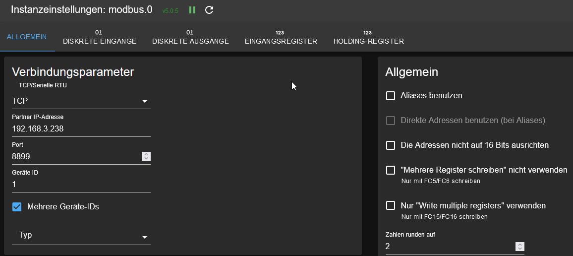

                                      stefan14 last edited by stefan14
                                      hat jemand von euch schon den Original Solis Datenstick verwendet, welcher ein Modbus TCP Interface an Port 8899 bereitstellt ?
                                      Leider habe ich bisher nur so belanglose Informationen wie Model No. DSP und LCD Version abrufen können 75cc6737-7d8d-431d-8df3-59e4ec953741-grafik.png
                                      Daten wie EnergyToday und die ganzen anderen interessanten Informationen bleiben leider bei 0.
                                      Ich vermute einfach "nur" eine falsche Adresse im Input Register. Die Adresse für z.B. EnergyToday ist im Solis Handbuch mit 3015 angegeben. Aber Adressen in diesem Bereich werden sofort als Fehlerhaft markiert.
                                      Aber dadurch dass einige Daten sich abrufen lassen, habe ich die Hoffnung noch nicht aufgegeben, ohne zusätzlichen RS485 Adapter die Daten via Netzwerk abrufen zu können 😉
                                      VG
                                      Stefan

                                        Schneider_Helmut @stefan14 last edited by
                                        @stefan14
                                        Hattest du mit dem Auslesen des Solis Datensticks Erfolg? Ich würde auch gerne Werte aus meinem Solis auslesen jedoch möchte ich den originalen Solis Datenstick sowie den Energie-Meter weiter am Solis eingestöpselt lassen.
                                        Somit ist keine Schnittstelle mehr frei am Solis.
                                        Es wäre echt lieb, wenn du mir auf die Sprünge helfen könntest wie ich die Daten vom Solis in den IOBroker bekomme.
                                        Es wäre mir bereits geholfen wenn ich zumindest einen der beiden Werte auslen könnte:
                                        • aktuelle Solarleistung am PV Eingang vom Solis
                                        • Be-/Entladeistung der Batterie durch den Solis
                                        Alle anderen Werte habe ich bereits durch Shellys erfasst.
                                        Gelmut

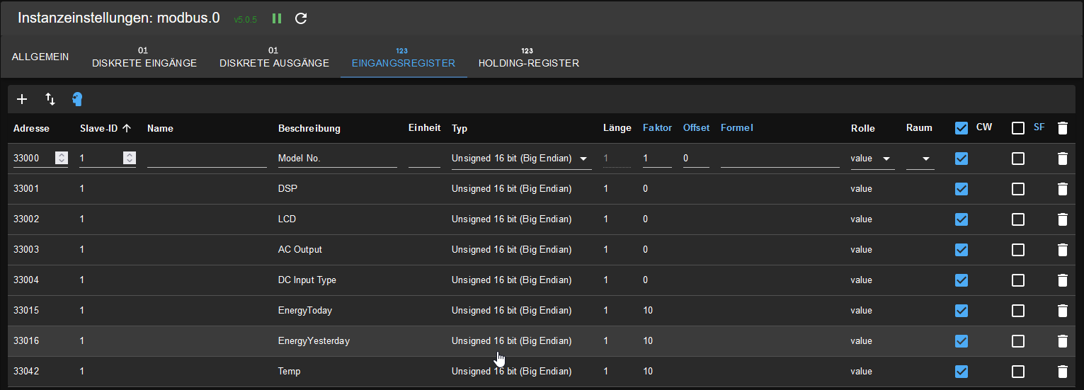

                                          @stefan14 ich will meinen Solis RHI 3P8 Wechselrichter auch über Modbus verbinden und bin bei der Recherche hier gelandet.
                                          Mit deinem Beitrag bin ich weitergekommen, und konnte den Wechselrichter erfolgreich mit dem Modbusadapter verbinden.
                                          Ich hatte auch erst die Probleme beim auslesen, dass die Werte "0" waren. Mit dem Register aus einem obigen Beitrag hat es dann aber mit den Daten geklappt und kann nun die benötigten Daten auslesen.

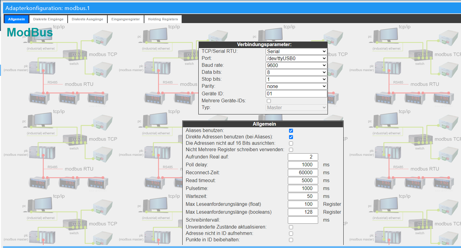

                                            Therry @Jean_Luc_Picard last edited by Therry
                                            @jean_luc_picard
                                            "Werte bei Objekten stimmen nicht! - Falsche Werte werden ausgegeben!"
                                            Hallo zusammen!
                                            Mein Solis Hybride Wechselrichter (RHI-4.6K-48ES-5G) ist über einen RS-485-USB-Stick an einem Raspberry Pi angeschlossen, auf dem der IOBrocker läuft. Im IOBrocker habe ich den Modbus-Adapter laufen und in diesem die Register gemäß der Beschreibung die es für den WR zum Thema Modbus gibt eingetragen. Es klappt auch, weil ich wie beschrieben von der Adresse jeweils "1" abgezogen habe, also statt 3005 bei "Active power" habe ich 3004 verwendet. Auch verwende ich das "Eingangsregister".
                                            Beim Datentyp habe ich "unsigned 16 oder 32 bit (Big Endian)" gewählt.
                                            Ich bekomme schon Werte ausgegeben jedoch stimmen diese nicht mit den aktuellen, tatsächlichen Daten überein.
                                            Es kommen Werte die total daneben liegen.
                                            Mir fällt leider nix mehr ein, was ich probieren könnte.
