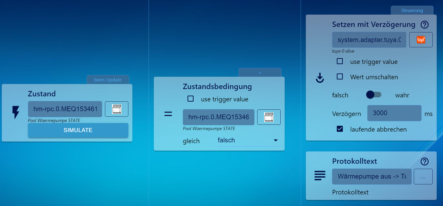

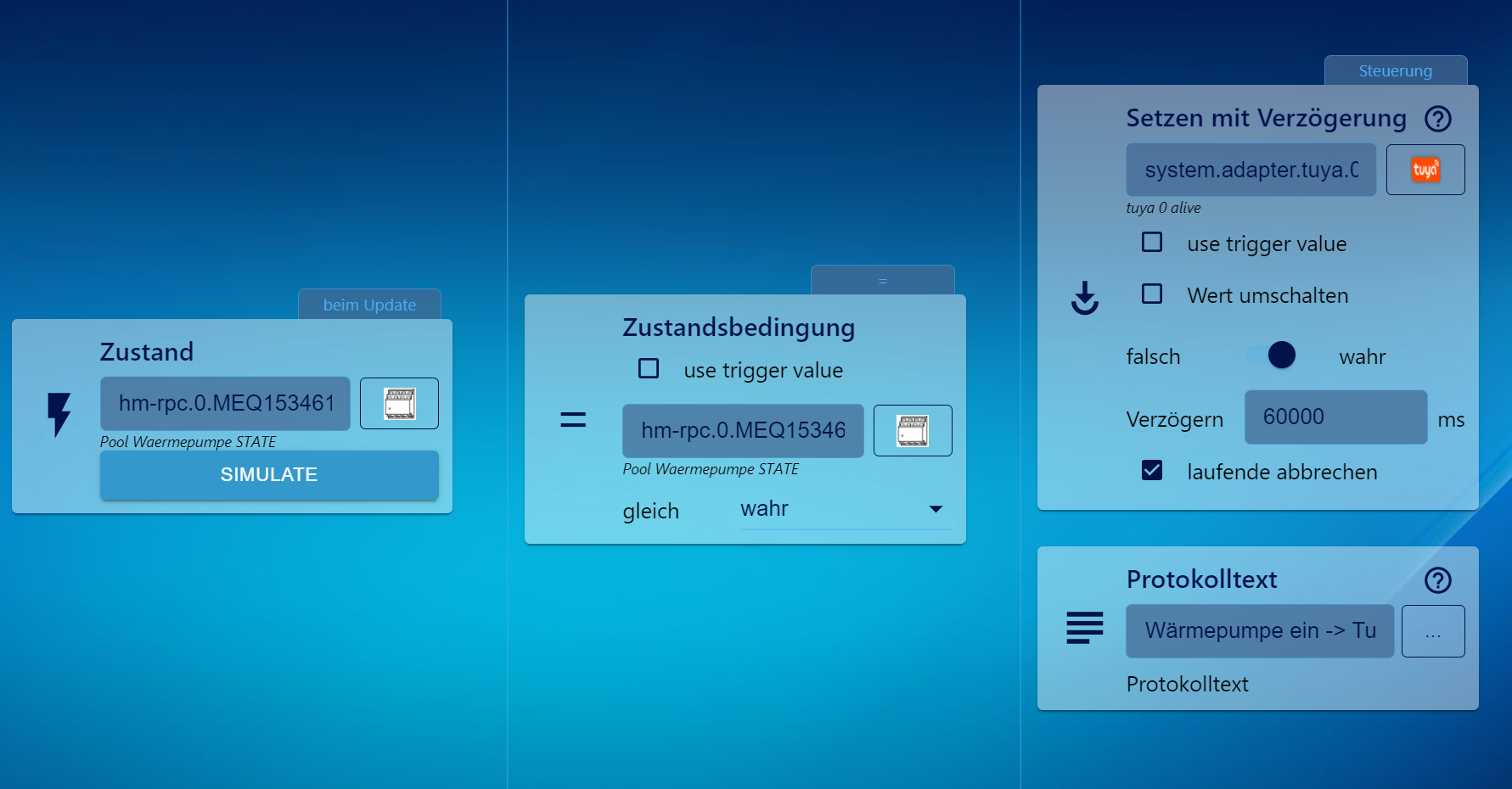

      Hi Leute,
      ich habe mir vor ca. einem Monat zwei einfache Rules Scripte erstellt:
      Hier umgewandelt in JS:
      let cond0 = false;
      on({id: "hm-rpc.0.MEQ1534614.15.STATE", change: "any"}, async function (obj) {
         const _cond = ((await getStateAsync("hm-rpc.0.MEQ1534614.15.STATE")).val == true);
         if (cond0 === false && _cond) {
             cond0 = true;
         	setStateDelayed("system.adapter.tuya.0.alive", true, false, 60000, true);
         	console.log("Wärmepumpe ein -> Tuya Adapter start ".replace(/%s/g, obj.state.val).replace(/%id/g, obj.id).replace(/%name/g, obj.common && obj.common.name).replace(/%old/g, obj.oldState.val));
         } else if (cond0 === true && !_cond) {
             cond0 = false;
      /*const demo = {
       "triggers": [
           "id": "TriggerState",
           "acceptedBy": "triggers",
           "_id": 1617428055062,
           "tagCard": "on update",
           "oid": "hm-rpc.0.MEQ1534614.15.STATE",
           "oidRole": "switch",
           "oidType": "boolean",
           "oidDef": false,
           "oidWrite": true,
           "oidRead": true
       "conditions": [
             "id": "ConditionState",
             "acceptedBy": "conditions",
             "_id": 1617428193108,
             "tagCard": "=",
             "value": true,
             "oidDef": false,
             "oidWrite": true,
             "oidRead": true
       "justCheck": false,
       "actions": {
         "then": [
             "id": "ActionSetStateDelayed",
             "acceptedBy": "actions",
             "_id": 1617430645664,
             "tagCard": "control",
             "oid": "system.adapter.tuya.0.alive",
             "value": true,
             "delay": "60000",
             "clearRunning": true,
             "oidRole": "indicator.state",
             "oidWrite": true,
             "oidRead": true,
             "toggle": false
             "id": "ActionPrintText",
             "_id": 1617798437406,
             "text": "Wärmepumpe ein -> Tuya Adapter start "
         "else": []
      let cond0 = false;
         const _cond = ((await getStateAsync("hm-rpc.0.MEQ1534614.15.STATE")).val == false);
             cond0 = true;
         	setStateDelayed("system.adapter.tuya.0.alive", false, false, 3000, true);
         	console.log("Wärmepumpe aus -> Tuya Adapter stop ".replace(/%s/g, obj.state.val).replace(/%id/g, obj.id).replace(/%name/g, obj.common && obj.common.name).replace(/%old/g, obj.oldState.val));
             cond0 = false;
      /*const demo = {
       "triggers": [
           "oidDef": false,
           "oidWrite": true,
           "oidRead": true
       "conditions": [
             "tagCard": "=",
             "value": false,
             "oidDef": false,
             "oidWrite": true,
             "oidRead": true
       "justCheck": false,
       "actions": {
         "then": [
             "value": false,
             "delay": "3000",
             "oidWrite": true,
             "oidRead": true,
             "toggle": false
             "_id": 1617798372342,
             "text": "Wärmepumpe aus -> Tuya Adapter stop "
         "else": []
      Das erste Script soll den Tuya Adapter starten, sobald meine Poolpumpe eingeschaltet wurde und das zweite soll ihn wieder stoppen, sobald die Pumpe ausgeschaltet wurde.
      Das hat auch einige Tage problemlos funktioniert, aber seit ein paar Tagen werden beide Scripte nicht mehr getriggert, obwohl ich daran nichts verändert habe...
      Hat jemand eine Idee woran das liegen könnte ?
      Hab alle Adapter auf den latest stable Releases...
      Beste Grüße
      Fabio 1 Reply Last reply Reply Quote 0
      • Fabio
        Fabio @Qlink last edited by
        @qlink ich kenne mich damit nicht gut aus, aber evtl. muss man im zweiten Feld use trigger value wählen.
        Q 1 Reply Last reply Reply Quote 1
        • Q
          Qlink @Fabio last edited by
          @fa-bio
          Danke, das war tatsächlich der Fehler.
          Beste Grüße
          • Fabio
            @qlink gerne.👍
