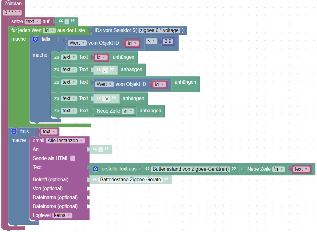

                Vorschlag:
                Atifan 1 Reply Last reply Reply Quote 0
                • Atifan
                  Atifan @paul53 last edited by
                  @paul53 Hi super, thx. Genauso mach ich das 🙂
