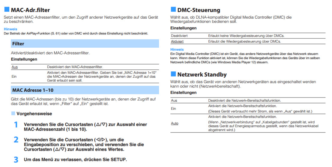

        bei meinem RX-V773 gibt es einen Menu Punkt der "Netzwerk Standby".
        Laut deiner Anleitung gibt es das auch.
        Vielleicht mal die Sachen aus der Anleitung überprüft:
        Vielleicht hilfts.

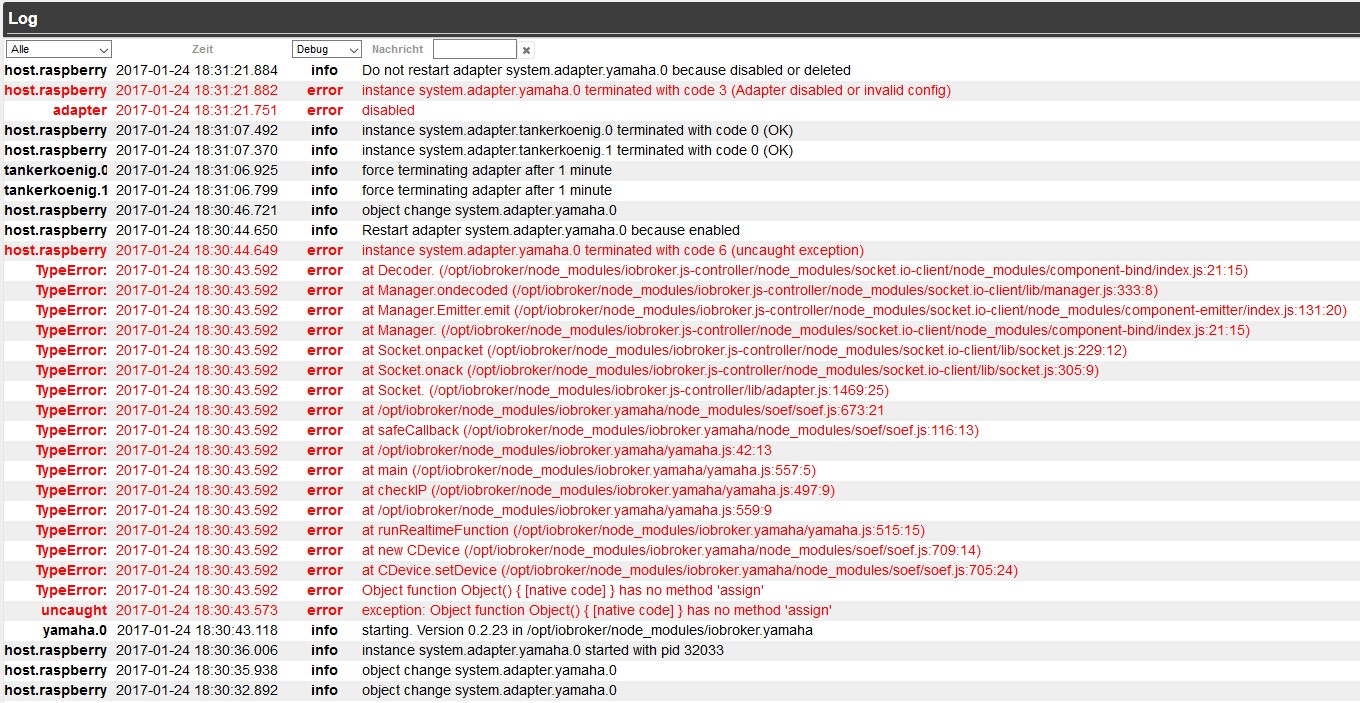

            Was erscheint denn im iobroker log wenn du für den Yamaha Adapter den Level mal auf Debug stellst und den dann neu startest?

                yamaha.0 2017-01-24 18:54:06.938 error yamaha.0 TypeError: Object function Object() { [native code] } has no method 'assign' at CDevice.setDevice (/opt/iobroker/node_modules/iobroker.yamaha/node_modules/soef/soef.js:705:24) at new
                yamaha.0 2017-01-24 18:54:06.937 error yamaha.0 uncaught exception: Object function Object() { [native code] } has no method 'assign'
                yamaha.0 2017-01-24 18:54:06.867 info yamaha.0 starting. Version 0.2.23 in /opt/iobroker/node_modules/iobroker.yamaha, node: v0.10.22
                yamaha.0 2017-01-24 18:53:56.219 error yamaha.0 TypeError: Object function Object() { [native code] } has no method 'assign' at CDevice.setDevice (/opt/iobroker/node_modules/iobroker.yamaha/node_modules/soef/soef.js:705:24) at new
                yamaha.0 2017-01-24 18:53:56.218 error yamaha.0 uncaught exception: Object function Object() { [native code] } has no method 'assign'
                yamaha.0 2017-01-24 18:53:56.144 info yamaha.0 starting. Version 0.2.23 in /opt/iobroker/node_modules/iobroker.yamaha, node: v0.10.22
                yamaha.0 2017-01-24 18:53:49.355 error yamaha.0 TypeError: Object function Object() { [native code] } has no method 'assign' at CDevice.setDevice (/opt/iobroker/node_modules/iobroker.yamaha/node_modules/soef/soef.js:705:24) at new
                yamaha.0 2017-01-24 18:53:49.354 error yamaha.0 uncaught exception: Object function Object() { [native code] } has no method 'assign'
                yamaha.0 2017-01-24 18:53:49.286 info yamaha.0 starting. Version 0.2.23 in /opt/iobroker/node_modules/iobroker.yamaha, node: v0.10.22
                yamaha.0 2017-01-24 18:53:33.011 error yamaha.0 TypeError: Object function Object() { [native code] } has no method 'assign' at CDevice.setDevice (/opt/iobroker/node_modules/iobroker.yamaha/node_modules/soef/soef.js:705:24) at new
                yamaha.0 2017-01-24 18:53:33.010 error yamaha.0 uncaught exception: Object function Object() { [native code] } has no method 'assign'
                yamaha.0 2017-01-24 18:53:32.952 info yamaha.0 starting. Version 0.2.23 in /opt/iobroker/node_modules/iobroker.yamaha, node: v0.10.22
                yamaha.0 2017-01-24 18:53:22.310 error yamaha.0 TypeError: Object function Object() { [native code] } has no method 'assign' at CDevice.setDevice (/opt/iobroker/node_modules/iobroker.yamaha/node_modules/soef/soef.js:705:24) at new
                yamaha.0 2017-01-24 18:53:22.309 error yamaha.0 uncaught exception: Object function Object() { [native code] } has no method 'assign'
                yamaha.0 2017-01-24 18:53:22.243 info yamaha.0 starting. Version 0.2.23 in /opt/iobroker/node_modules/iobroker.yamaha, node: v0.10.22
                yamaha.0 2017-01-24 18:53:15.474 error yamaha.0 TypeError: Object function Object() { [native code] } has no method 'assign' at CDevice.setDevice (/opt/iobroker/node_modules/iobroker.yamaha/node_modules/soef/soef.js:705:24) at new
                yamaha.0 2017-01-24 18:53:15.472 error yamaha.0 uncaught exception: Object function Object() { [native code] } has no method 'assign'
                yamaha.0 2017-01-24 18:53:15.403 info yamaha.0 starting. Version 0.2.23 in /opt/iobroker/node_modules/iobroker.yamaha, node: v0.10.22
                yamaha.0 2017-01-24 17:52:59.068 error at Decoder. (/opt/iobroker/node_modules/iobroker.js-controller/node_modules/socket.io-client/node_modules/component-bind/index.js:21:15)
                yamaha.0 2017-01-24 17:52:59.068 error at Manager.ondecoded (/opt/iobroker/node_modules/iobroker.js-controller/node_modules/socket.io-client/lib/manager.js:332:8)
                yamaha.0 2017-01-24 17:52:59.068 error at Manager.Emitter.emit (/opt/iobroker/node_modules/iobroker.js-controller/node_modules/socket.io-client/node_modules/component-emitter/index.js:133:20)
                yamaha.0 2017-01-24 17:52:59.068 error at Manager. (/opt/iobroker/node_modules/iobroker.js-controller/node_modules/socket.io-client/node_modules/component-bind/index.js:21:15)
                yamaha.0 2017-01-24 17:52:59.068 error at Socket.onpacket (/opt/iobroker/node_modules/iobroker.js-controller/node_modules/socket.io-client/lib/socket.js:236:12)
                yamaha.0 2017-01-24 17:52:59.068 error at Socket.onack (/opt/iobroker/node_modules/iobroker.js-controller/node_modules/socket.io-client/lib/socket.js:312:9)
                yamaha.0 2017-01-24 17:52:59.068 error at Socket. (/opt/iobroker/node_modules/iobroker.js-controller/lib/adapter.js:2134:25)
                yamaha.0 2017-01-24 17:52:59.068 error at /opt/iobroker/node_modules/iobroker.yamaha/node_modules/soef/soef.js:673:21
                yamaha.0 2017-01-24 17:52:59.068 error at safeCallback (/opt/iobroker/node_modules/iobroker.yamaha/node_modules/soef/soef.js:116:13)
                yamaha.0 2017-01-24 17:52:59.068 error at /opt/iobroker/node_modules/iobroker.yamaha/yamaha.js:42:13
                yamaha.0 2017-01-24 17:52:59.068 error at main (/opt/iobroker/node_modules/iobroker.yamaha/yamaha.js:557:5)
                yamaha.0 2017-01-24 17:52:59.068 error at checkIP (/opt/iobroker/node_modules/iobroker.yamaha/yamaha.js:497:9)
                yamaha.0 2017-01-24 17:52:59.068 error at /opt/iobroker/node_modules/iobroker.yamaha/yamaha.js:559:9
                yamaha.0 2017-01-24 17:52:59.068 error at runRealtimeFunction (/opt/iobroker/node_modules/iobroker.yamaha/yamaha.js:515:15)
                yamaha.0 2017-01-24 17:52:59.068 error at new CDevice (/opt/iobroker/node_modules/iobroker.yamaha/node_modules/soef/soef.js:709:14)
                yamaha.0 2017-01-24 17:52:59.068 error at CDevice.setDevice (/opt/iobroker/node_modules/iobroker.yamaha/node_modules/soef/soef.js:705:24)
                yamaha.0 2017-01-24 17:52:59.068 error TypeError: Object function Object() { [native code] } has no method 'assign'
                yamaha.0 2017-01-24 17:52:59.061 error uncaught exception: Object function Object() { [native code] } has no method 'assign'
                yamaha.0 2017-01-24 17:52:58.957 info starting. Version 0.2.23 in /opt/iobroker/node_modules/iobroker.yamaha, node: v0.10.22

                    ! yamaha.0 2017-01-24 18:54:06.938 error yamaha.0 TypeError: Object function Object() { [native code] } has no method 'assign' at CDevice.setDevice (/opt/iobroker/node_modules/iobroker.yamaha/node_modules/soef/soef.js:705:24) at new yamaha.0 2017-01-24 18:54:06.937 error yamaha.0 uncaught exception: Object function Object() { [native code] } has no method 'assign' yamaha.0 2017-01-24 18:54:06.867 info yamaha.0 starting. Version 0.2.23 in /opt/iobroker/node_modules/iobroker.yamaha, node: v0.10.22 yamaha.0 2017-01-24 18:53:56.219 error yamaha.0 TypeError: Object function Object() { [native code] } has no method 'assign' at CDevice.setDevice (/opt/iobroker/node_modules/iobroker.yamaha/node_modules/soef/soef.js:705:24) at new yamaha.0 2017-01-24 18:53:56.218 error yamaha.0 uncaught exception: Object function Object() { [native code] } has no method 'assign' yamaha.0 2017-01-24 18:53:56.144 info yamaha.0 starting. Version 0.2.23 in /opt/iobroker/node_modules/iobroker.yamaha, node: v0.10.22 yamaha.0 2017-01-24 18:53:49.355 error yamaha.0 TypeError: Object function Object() { [native code] } has no method 'assign' at CDevice.setDevice (/opt/iobroker/node_modules/iobroker.yamaha/node_modules/soef/soef.js:705:24) at new yamaha.0 2017-01-24 18:53:49.354 error yamaha.0 uncaught exception: Object function Object() { [native code] } has no method 'assign' yamaha.0 2017-01-24 18:53:49.286 info yamaha.0 starting. Version 0.2.23 in /opt/iobroker/node_modules/iobroker.yamaha, node: v0.10.22 yamaha.0 2017-01-24 18:53:33.011 error yamaha.0 TypeError: Object function Object() { [native code] } has no method 'assign' at CDevice.setDevice (/opt/iobroker/node_modules/iobroker.yamaha/node_modules/soef/soef.js:705:24) at new yamaha.0 2017-01-24 18:53:33.010 error yamaha.0 uncaught exception: Object function Object() { [native code] } has no method 'assign' yamaha.0 2017-01-24 18:53:32.952 info yamaha.0 starting. Version 0.2.23 in /opt/iobroker/node_modules/iobroker.yamaha, node: v0.10.22 yamaha.0 2017-01-24 18:53:22.310 error yamaha.0 TypeError: Object function Object() { [native code] } has no method 'assign' at CDevice.setDevice (/opt/iobroker/node_modules/iobroker.yamaha/node_modules/soef/soef.js:705:24) at new yamaha.0 2017-01-24 18:53:22.309 error yamaha.0 uncaught exception: Object function Object() { [native code] } has no method 'assign' yamaha.0 2017-01-24 18:53:22.243 info yamaha.0 starting. Version 0.2.23 in /opt/iobroker/node_modules/iobroker.yamaha, node: v0.10.22 yamaha.0 2017-01-24 18:53:15.474 error yamaha.0 TypeError: Object function Object() { [native code] } has no method 'assign' at CDevice.setDevice (/opt/iobroker/node_modules/iobroker.yamaha/node_modules/soef/soef.js:705:24) at new yamaha.0 2017-01-24 18:53:15.472 error yamaha.0 uncaught exception: Object function Object() { [native code] } has no method 'assign' yamaha.0 2017-01-24 18:53:15.403 info yamaha.0 starting. Version 0.2.23 in /opt/iobroker/node_modules/iobroker.yamaha, node: v0.10.22 yamaha.0 2017-01-24 17:52:59.068 error at Decoder. (/opt/iobroker/node_modules/iobroker.js-controller/node_modules/socket.io-client/node_modules/component-bind/index.js:21:15) yamaha.0 2017-01-24 17:52:59.068 error at Manager.ondecoded (/opt/iobroker/node_modules/iobroker.js-controller/node_modules/socket.io-client/lib/manager.js:332:8) yamaha.0 2017-01-24 17:52:59.068 error at Manager.Emitter.emit (/opt/iobroker/node_modules/iobroker.js-controller/node_modules/socket.io-client/node_modules/component-emitter/index.js:133:20) yamaha.0 2017-01-24 17:52:59.068 error at Manager. (/opt/iobroker/node_modules/iobroker.js-controller/node_modules/socket.io-client/node_modules/component-bind/index.js:21:15) yamaha.0 2017-01-24 17:52:59.068 error at Socket.onpacket (/opt/iobroker/node_modules/iobroker.js-controller/node_modules/socket.io-client/lib/socket.js:236:12) yamaha.0 2017-01-24 17:52:59.068 error at Socket.onack (/opt/iobroker/node_modules/iobroker.js-controller/node_modules/socket.io-client/lib/socket.js:312:9) yamaha.0 2017-01-24 17:52:59.068 error at Socket. (/opt/iobroker/node_modules/iobroker.js-controller/lib/adapter.js:2134:25) yamaha.0 2017-01-24 17:52:59.068 error at /opt/iobroker/node_modules/iobroker.yamaha/node_modules/soef/soef.js:673:21 yamaha.0 2017-01-24 17:52:59.068 error at safeCallback (/opt/iobroker/node_modules/iobroker.yamaha/node_modules/soef/soef.js:116:13) yamaha.0 2017-01-24 17:52:59.068 error at /opt/iobroker/node_modules/iobroker.yamaha/yamaha.js:42:13 yamaha.0 2017-01-24 17:52:59.068 error at main (/opt/iobroker/node_modules/iobroker.yamaha/yamaha.js:557:5) yamaha.0 2017-01-24 17:52:59.068 error at checkIP (/opt/iobroker/node_modules/iobroker.yamaha/yamaha.js:497:9) yamaha.0 2017-01-24 17:52:59.068 error at /opt/iobroker/node_modules/iobroker.yamaha/yamaha.js:559:9 yamaha.0 2017-01-24 17:52:59.068 error at runRealtimeFunction (/opt/iobroker/node_modules/iobroker.yamaha/yamaha.js:515:15) yamaha.0 2017-01-24 17:52:59.068 error at new CDevice (/opt/iobroker/node_modules/iobroker.yamaha/node_modules/soef/soef.js:709:14) yamaha.0 2017-01-24 17:52:59.068 error at CDevice.setDevice (/opt/iobroker/node_modules/iobroker.yamaha/node_modules/soef/soef.js:705:24) yamaha.0 2017-01-24 17:52:59.068 error TypeError: Object function Object() { [native code] } has no method 'assign' yamaha.0 2017-01-24 17:52:59.061 error uncaught exception: Object function Object() { [native code] } has no method 'assign' yamaha.0 2017-01-24 17:52:58.957 info starting. Version 0.2.23 in /opt/iobroker/node_modules/iobroker.yamaha, node: v0.10.22 `
                    0.10.22 hat kein Method assign. Use node.js 4.7.x

                      0.10.22 hat kein Method assign. Use node.js 4.7.x `
                      Ui… dann war ich ja gar nicht so verkehrt zum Schluß 😛
                      • Bluefox
                        Bluefox last edited by
                        @wendy2702:
                        @Bluefox:
                        Ui… dann war ich ja gar nicht so verkehrt zum Schluß 😛 `
                        Sogar absolut richtig. 🙂
                        Ich habe jetzt den Entwickler angeschrieben, dass er diese 4.x Feature raus nimmt.
