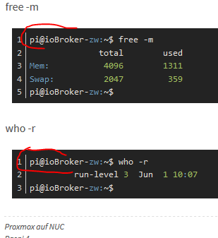

      free -m
      pi@ioBroker-zw:~$ free -m
      Mem:           4096        1311        2619           0         165        2784
      Swap:          2047         359        1688
      pi@ioBroker-zw:~$
      who -r
      pi@ioBroker-zw:~$ who -r
               run-level 3  Jun  1 10:07                   last=5
      pi@ioBroker-zw:~$

            free -m
            Swap:          2047         359        1688
            pi@ioBroker-zw:~$
            who -r
            pi@ioBroker-zw:~$
