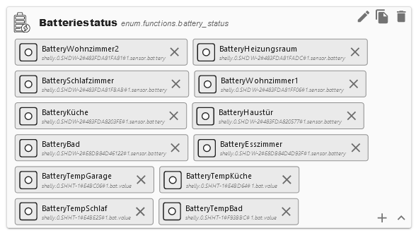

                code_text<xml xmlns="https://developers.google.com/blockly/xml">
                  <block type="on_ext" id="RT3@Kxqxg#w3f=(kzwCu" x="-1187" y="-837">
                    <field name="CONDITION">lt</field>
                    <value name="OID0">
                      <shadow type="field_oid" id="0)0sp$I1ccfm%4Sde-mT">
                      <block type="selector" id=",lvP%A]1J?Mf^@0s2D%[">
                        <field name="TEXT">state[id=*](functions=battery_status)</field>
                      <block type="controls_if" id="{?]bg`YUOZWT2we!P4vN">
                          <block type="logic_compare" id="Q/LZnTJ4,q6WHgnUK9c_">
                            <field name="OP">LTE</field>
                              <block type="on_source" id="8xEXpe~]awB]?3+!e5%%">
                              <block type="math_number" id="PX(:OSKOFyY},Ycn6Gj_">
                                <field name="NUM">10</field>
                          <block type="telegram" id="Uo4B+UB=p7aq8i{?6.^t">
                            <field name="INSTANCE">.0</field>
                            <field name="LOG"></field>
                            <value name="MESSAGE">
                              <shadow type="text" id="~^[f6^A3*aT+_7X_Yj@v">
                              <block type="text_join" id="+-0P=;(xkUW!3*^-mIvK">
                                <mutation items="9"></mutation>
                                <value name="ADD0">
                                  <block type="text" id="IPHJ%fgm|9Yurk#K%;h_">
                                    <field name="TEXT">Batteriestatus - Überwachungsbericht</field>
                                <value name="ADD1">
                                  <block type="text_newline" id="%,dou1,8ngy}W=@}W$[U">
                                    <field name="Type">\n</field>
                                <value name="ADD2">
                                  <block type="on_source" id=":uJC`%r!B]q4Zd=aL2uI">
                                    <field name="ATTR">common.name</field>
                                <value name="ADD3">
                                  <block type="text_newline" id="w+u?@OUGQ8pvOLPRE;0w">
                                <value name="ADD4">
                                  <block type="text" id="S=Df3Iao0a.}/kCfSfeC">
                                    <field name="TEXT">Die Kapazität der Baterie befindet sich unter 10%</field>
                                <value name="ADD5">
                                  <block type="text_newline" id="[2f6VQ[.E80i[R%ivQyG">
                                <value name="ADD6">
                                  <block type="text" id="#r^B9Yb4oMYTb$AqaDs8">
                                    <field name="TEXT">Es wird Zeit neue zu besorgen</field>
                                <value name="ADD7">
                                  <block type="text_newline" id="tlRTmB2_P--tzNoJVbU8">
                                <value name="ADD8">
                                  <block type="text" id="SBRz?#E;mp78~gZ6ujP0">
                                    <field name="TEXT">Hier ein Link zum Artikel: https://www.amazon.de/VARTA-PROFESSIONAL-CR123A-2er-Bli-Blau-Silber/dp/B000EGWOEU/ref=sr_1_3?__mk_de_DE=%C3%85M%C3%85%C5%BD%C3%95%C3%91&amp;dchild=1&amp;keywords=cr123a+batterie&amp;qid=1624186391&amp;sr=8-3</field>
                            <value name="USERNAME">
                              <block type="text" id="Vs_`rMJ`cH4mqvRUu=Qr">
                                <field name="TEXT"></field>
                Bin Es kommt leider keine Nachricht an. Hab ich bei den Aufzählungen einen Fehler gemacht?
                paul53 frankthegreat dslraser 3 Replies Last reply Reply Quote 0
                  paul53 @IceD112 last edited by paul53
                  @iced112 sagte: Hab ich bei den Aufzählungen einen Fehler gemacht?
                  Prüfe es selbst in der Log-Ausgabe von:
                  Beachte: Getriggert wird nur, wenn der Batteriewert sinkt (ist kleiner als letztes).

                    • dslraser
                      dslraser Forum Testing Most Active @IceD112 last edited by dslraser

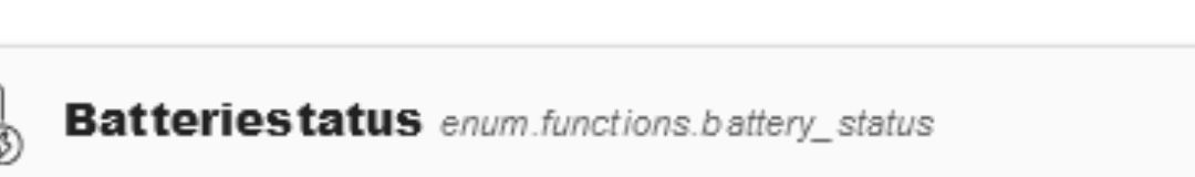

                      @iced112
                      Hast Du da ein Leerzeichen drinn ?
                      b attery_status
                      • I
                        IceD112 @dslraser last edited by IceD112
                        @dslraser Muss dass denn da rein? 🙂
                        Aber nein, da ist kein Leerzeichen. Das schaut nur so aus
                        • I
                          IceD112 @frankthegreat last edited by
                          @frankthegreat
                          Am Batteriestatus der Sensoren kann ich kein Wert eingeben 🤕
                            @iced112 sagte: Muss dass denn da rein?
                            Nein, im Gegenteil.
                              @iced112 sagte: Am Batteriestatus der Sensoren kann ich kein Wert eingeben
                              In den Expertenmodus schalten.
                              • I
                                IceD112 @paul53 last edited by
                                Danke für den Tipp. Es hat funktioniert. Die Statusüberwachung funktioniert. Danke für eure Hinweise
