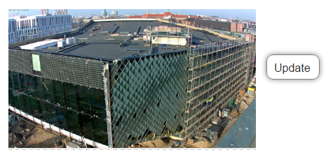

      ich habe in vis ein Bild aus einer externen URL, ein automatisches Update alle x ms möchte ich aus technsichen Gründen nicht.
      Wie kann ich einen ReLoadButton realisieren der das Bild per Knopf neu lädt?

            [{"tpl":"tplImage","data":{"g_fixed":true,"g_visibility":false,"g_css_font_text":false,"g_css_background":false,"g_css_shadow_padding":false,"g_css_border":false,"g_gestures":false,"g_signals":false,"visibility-cond":"==","visibility-val":1,"visibility-groups-action":"hide","refreshInterval":"0","refreshOnWakeUp":"false","refreshOnViewChange":"false","signals-cond-0":"==","signals-val-0":true,"signals-icon-0":"/vis/signals/lowbattery.png","signals-icon-size-0":0,"signals-blink-0":false,"signals-horz-0":0,"signals-vert-0":0,"signals-hide-edit-0":false,"signals-cond-1":"==","signals-val-1":true,"signals-icon-1":"/vis/signals/lowbattery.png","signals-icon-size-1":0,"signals-blink-1":false,"signals-horz-1":0,"signals-vert-1":0,"signals-hide-edit-1":false,"signals-cond-2":"==","signals-val-2":true,"signals-icon-2":"/vis/signals/lowbattery.png","signals-icon-size-2":0,"signals-blink-2":false,"signals-horz-2":0,"signals-vert-2":0,"signals-hide-edit-2":false,"src":"http://webcam-profi.de/bilder/bam/image.jpg","class":"update-image"},"style":{"left":"100px","top":"187px","width":"353px","height":"202px"},"widgetSet":"basic"},{"tpl":"tplHtml","data":{"g_fixed":false,"g_visibility":false,"g_css_font_text":false,"g_css_background":false,"g_css_shadow_padding":true,"g_css_border":true,"g_gestures":false,"g_signals":false,"visibility-cond":"==","visibility-val":1,"visibility-groups-action":"hide","refreshInterval":"0","signals-cond-0":"==","signals-val-0":true,"signals-icon-0":"/vis/signals/lowbattery.png","signals-icon-size-0":0,"signals-blink-0":false,"signals-horz-0":0,"signals-vert-0":0,"signals-hide-edit-0":false,"signals-cond-1":"==","signals-val-1":true,"signals-icon-1":"/vis/signals/lowbattery.png","signals-icon-size-1":0,"signals-blink-1":false,"signals-horz-1":0,"signals-vert-1":0,"signals-hide-edit-1":false,"signals-cond-2":"==","signals-val-2":true,"signals-icon-2":"/vis/signals/lowbattery.png","signals-icon-size-2":0,"signals-blink-2":false,"signals-horz-2":0,"signals-vert-2":0,"signals-hide-edit-2":false,"html":"\nUpdate"},"style":{"left":"468px","top":"252px","width":"64px","height":"24px","padding":"","box-shadow":"0 0 010px gray","border-radius":"10px","border-width":"1px","border-style":"solid","border-color":"gray","cursor":"pointer","padding-left":"10px","padding-top":"10px"},"widgetSet":"basic"}]

                @MrLee:
                .wo muß der code hin?!? `
                Der code ist das Widget.
                Du musst es importieren:
                http://www.iobroker.net/?page_id=2754&lang=de#Widgets_2
                Unterpunkt 18.
                Rainer

                  Alleings habe ich das Problem das es bei mir nicht läuft. Vermutlich weil ich (was ich leider nicht gesagt habe) das Bild über ein php-script bekomme:
                  /get_pic.php?cam=2
                  ist die Url...daher bekomme ich bei update drücken nur ein image broken
                  kann man das fixen?
