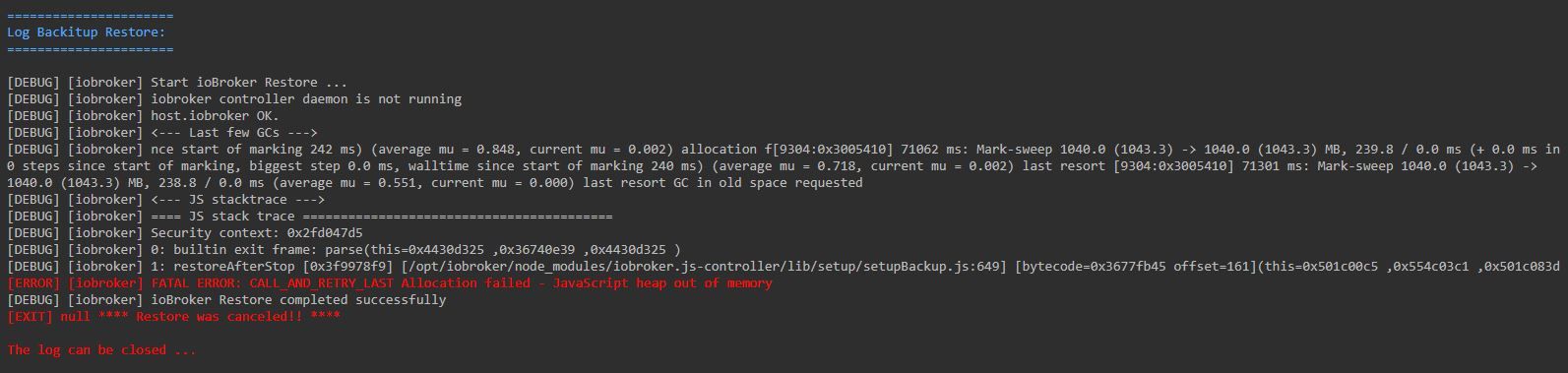

      keine Fehlermeldung nichts. Doch als ich auf die WebOberfläche schaute, war immer noch nur die Grundinstallation vorhanden. Dachte mir, installiere den BackItUp Adapter und probiere es darüber.

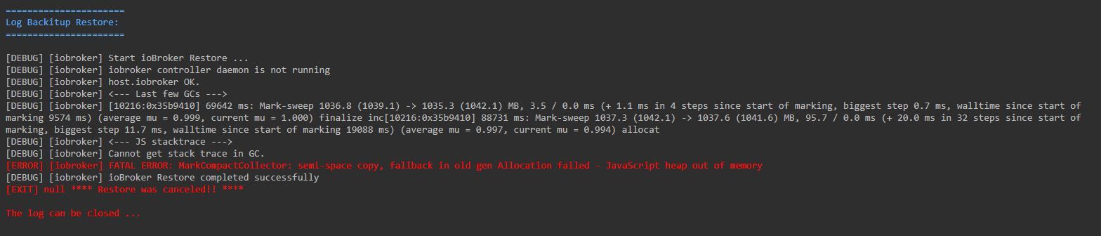

                              Thomas Braun Most Active @MadDoc last edited by
                              @maddoc Da geht auf dem Heap der Speicher aus.

                                       [DEBUG] [iobroker] Start ioBroker Restore ...
                                      [DEBUG] [iobroker] iobroker controller daemon is not running
                                      [DEBUG] [iobroker] host.iobroker OK.
                                      [DEBUG] [iobroker] <--- Last few GCs --->
                                      [DEBUG] [iobroker] [10216:0x35b9410] 69642 ms: Mark-sweep 1036.8 (1039.1) -> 1035.3 (1042.1) MB, 3.5 / 0.0 ms (+ 1.1 ms in 4 steps since start of marking, biggest step 0.7 ms, walltime since start of marking 9574 ms) (average mu = 0.999, current mu = 1.000) finalize inc[10216:0x35b9410] 88731 ms: Mark-sweep 1037.3 (1042.1) -> 1037.6 (1041.6) MB, 95.7 / 0.0 ms (+ 20.0 ms in 32 steps since start of marking, biggest step 11.7 ms, walltime since start of marking 19088 ms) (average mu = 0.997, current mu = 0.994) allocat
                                      [DEBUG] [iobroker] <--- JS stacktrace --->
                                      [DEBUG] [iobroker] Cannot get stack trace in GC.
                                      [ERROR] [iobroker] FATAL ERROR: MarkCompactCollector: semi-space copy, fallback in old gen Allocation failed - JavaScript heap out of memory
                                      [DEBUG] [iobroker] ioBroker Restore completed successfully
                                      [EXIT] null **** Restore was canceled!! ****
                                      Hoffe so ist besser zu lesen!!!!
