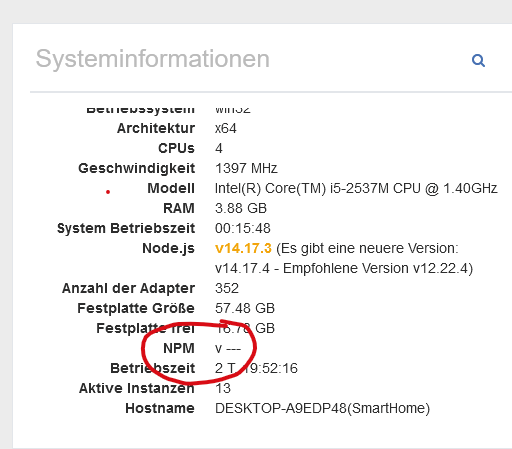

      Hallo!
      ich habe das Problem,dass im Iobroker die npm nicht mehr vorhanden ist siehe Bild:
      es funktioniert soweit aber noch alles, nur bei Updates tritt folgender Fehler auf und die Updates werden abgebrochen:
      $ ./iobroker upgrade backitup
      Update backitup from @2.1.11 to @2.1.13
      host.DESKTOP-A9EDP48(SmartHome) Adapter "system.adapter.backitup.0" is stopped.
      ERROR: Error: double-loading config "C:\Program Files\iobroker\SmartHome\env\etc\npmrc" as "global", previously loaded as "user"    at Config.[loadObject] (C:\Program Files\iobroker\SmartHome\env\npm\node_modules\npm\node_modules\@npmcli\config\lib\index.js:451:13)    at C:\Program Files\iobroker\SmartHome\env\npm\node_modules\npm\node_modules\@npmcli\config\lib\index.js:490:30    at async Config.[loadFile] (C:\Program Files\iobroker\SmartHome\env\npm\node_modules\npm\node_modules\@npmcli\config\lib\index.js:488:5)    at async Config.load (C:\Program Files\iobroker\SmartHome\env\npm\node_modules\npm\node_modules\@npmcli\config\lib\index.js:268:5)    at async Object.[_load] (C:\Program Files\iobroker\SmartHome\env\npm\node_modules\npm\lib\npm.js:185:5)Error: call config.load() before reading values    at Config.get (C:\Program Files\iobroker\SmartHome\env\npm\node_modules\npm\node_modules\@npmcli\config\lib\index.js:182:13)    at exitHandler (C:\Program Files\iobroker\SmartHome\env\npm\node_modules\npm\lib\utils\exit-handler.js:185:32)    at module.exports (C:\Program Files\iobroker\SmartHome\env\npm\node_modules\npm\lib\cli.js:75:12)Error: call config.load() before reading values    at Config.get (C:\Program Files\iobroker\SmartHome\env\npm\node_modules\npm\node_modules\@npmcli\config\lib\index.js:182:13)    at process.exitHandler (C:\Program Files\iobroker\SmartHome\env\npm\node_modules\npm\lib\utils\exit-handler.js:185:32)    at process.emit (events.js:375:28)    at processPromiseRejections (internal/process/promises.js:245:33)    at processTicksAndRejections (internal/process/task_queues.js:96:32)C:\Program Files\iobroker\SmartHome\env\npm\node_modules\npm\node_modules\@npmcli\config\lib\index.js:182

      Habe im Forum lange gesucht, aber leider nichts hilfreiches gefunden Kann mir jemand helfen,oder hat jemand eine Idee wie ich diesen Fehler beheben kann?
      Vielen Dank im Voraus!!

            Homoran Global Moderator Administrators @Paulsen33 last edited by
            @paulsen33 sagte in NPM Error Windows:
            und wo hast du das hier her?
            NPM-Version:
            6.14.12
            siehe Bild:
            ich hab dann eher den Verdacht, dass da etwas mit dem Info Adapter nicht stimmt.
