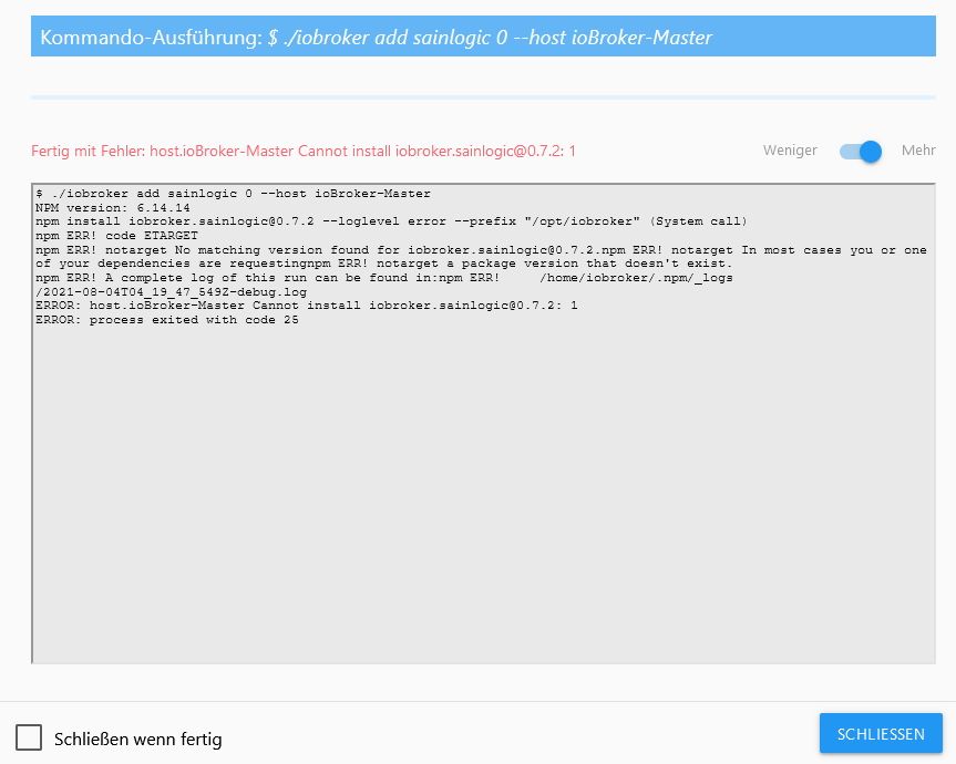

      beim Versuch den "sainlogic" Adapter zu installieren kommt folgender Fehler.
      (Hatte ich aber die Tage aber auch schon beim HS100)
      $ ./iobroker add sainlogic 0 --host ioBroker-Master
      NPM version: 6.14.14
      npm install iobroker.sainlogic@0.7.2 --loglevel error --prefix "/opt/iobroker" (System call)
      npm ERR! code ETARGET
      npm ERR! notarget No matching version found for iobroker.sainlogic@0.7.2.npm ERR! notarget In most cases you or one of your dependencies are requestingnpm ERR! notarget a package version that doesn't exist.
      npm ERR! A complete log of this run can be found in:npm ERR!     /home/iobroker/.npm/_logs/2021-08-04T04_19_47_549Z-debug.log
      ERROR: host.ioBroker-Master Cannot install iobroker.sainlogic@0.7.2: 1
      ERROR: process exited with code 25
      log:
      0 info it worked if it ends with ok
      1 verbose cli [
      1 verbose cli   '/usr/bin/node',
      1 verbose cli   '/usr/bin/npm',
      1 verbose cli   'install',
      1 verbose cli   'iobroker.sainlogic@0.7.2',
      1 verbose cli   '--loglevel',
      1 verbose cli   'error',
      1 verbose cli   '--prefix',
      1 verbose cli   '/opt/iobroker'
      1 verbose cli ]
      2 info using npm@6.14.14
      3 info using node@v12.22.4
      4 verbose npm-session 9ca16e53a6913013
      5 silly install loadCurrentTree
      6 silly install readLocalPackageData
      7 http fetch GET 304 https://registry.npmjs.org/iobroker.sainlogic 950ms (from cache)
      8 silly registry:manifest no matching version for iobroker.sainlogic@0.7.2 in the cache. Forcing revalidation.
      9 http fetch GET 200 https://registry.npmjs.org/iobroker.sainlogic 961ms
      10 silly fetchPackageMetaData error for iobroker.sainlogic@0.7.2 No matching version found for iobroker.sainlogic@0.7.2.
      11 timing stage:rollbackFailedOptional Completed in 1ms
      12 timing stage:runTopLevelLifecycles Completed in 5356ms
      13 verbose type version
      14 verbose stack iobroker.sainlogic: No matching version found for iobroker.sainlogic@0.7.2.
      14 verbose stack     at pickManifest (/usr/lib/node_modules/npm/node_modules/npm-pick-manifest/index.js:122:13)
      14 verbose stack     at /usr/lib/node_modules/npm/node_modules/pacote/lib/fetchers/registry/manifest.js:43:18
      14 verbose stack     at tryCatcher (/usr/lib/node_modules/npm/node_modules/bluebird/js/release/util.js:16:23)
      14 verbose stack     at Promise._settlePromiseFromHandler (/usr/lib/node_modules/npm/node_modules/bluebird/js/release/promise.js:517:31)
      14 verbose stack     at Promise._settlePromise (/usr/lib/node_modules/npm/node_modules/bluebird/js/release/promise.js:574:18)
      14 verbose stack     at Promise._settlePromise0 (/usr/lib/node_modules/npm/node_modules/bluebird/js/release/promise.js:619:10)
      14 verbose stack     at Promise._settlePromises (/usr/lib/node_modules/npm/node_modules/bluebird/js/release/promise.js:699:18)
      14 verbose stack     at _drainQueueStep (/usr/lib/node_modules/npm/node_modules/bluebird/js/release/async.js:138:12)
      14 verbose stack     at _drainQueue (/usr/lib/node_modules/npm/node_modules/bluebird/js/release/async.js:131:9)
      14 verbose stack     at Async._drainQueues (/usr/lib/node_modules/npm/node_modules/bluebird/js/release/async.js:147:5)
      14 verbose stack     at Immediate.Async.drainQueues [as _onImmediate] (/usr/lib/node_modules/npm/node_modules/bluebird/js/release/async.js:17:14)
      14 verbose stack     at processImmediate (internal/timers.js:461:21)
      15 verbose cwd /opt/iobroker
      16 verbose Linux 4.19.0-17-amd64
      17 verbose argv "/usr/bin/node" "/usr/bin/npm" "install" "iobroker.sainlogic@0.7.2" "--loglevel" "error" "--prefix" "/opt/iobroker"
      18 verbose node v12.22.4
      19 verbose npm  v6.14.14
      20 error code ETARGET
      21 error notarget No matching version found for iobroker.sainlogic@0.7.2.
      22 error notarget In most cases you or one of your dependencies are requesting
      22 error notarget a package version that doesn't exist.
      23 verbose exit [ 1, true ]
      Jemand ne Idee?

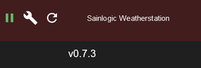

                • Glasfaser
                  Glasfaser @Fogg last edited by
                  @fogg sagte in Kann Adapter nicht installieren:
                  Nein, ich kriege diese Meldung in meinem ioB wenn ich ein update machen will:
                  Keine Ahnung , habe ihn ohne Probleme installiert ... , nur kommen dann andere Fehlermeldungen .
                  Siehe auch Screenshot oben .

                                          JSControler: 3.3.18
                                          Könnte quasi das Node-js sein. Aber sicher bin ich mir da nicht.
                                          • Glasfaser
                                            V13.14.0
                                            Das ist aber eine ungerade Version
                                            Node.js Versions-Anforderungen Die unterstützten Node.js Versionen bleiben in diesem Update gleich: 10.x, 12.x und auch 14.x werden offiziell unterstützt. Aufgrund der übergreifenden Adapter-Kompatibilität bleibt die empfohlene Node.js Version für ioBroker aktuell weiterhin auf 12.x. Falls jemand bereits mit Node.js 16.x arbeiten möchte, dann bitte im Moment AUSSCHLIESSLICH mit npm 6 !! (Bei npm 7 gibt es noch Probleme mit GitHub Installs bei einigen Adaptern)
                                            Fogg 1 Reply Last reply Reply Quote 0
