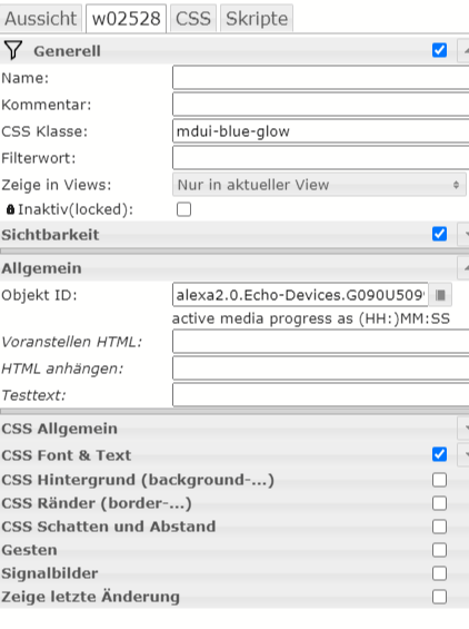

                              Habe aktuell wiedermal dieses ack-Flag Problem.
                              fast 2 Monate war Ruhe.
                              Heute wieder selbes Problem.
                              web.0 2021-08-24 22:01:47.187 warn Read-only state "alexa2.0.Echo-Devices.G090U5099045059V.Player.mediaProgress" has been written without ack-flag with value "210"
                              Ich hab damals nichts geändert.
                              Widget ist auch unverändert.
                              [{"tpl":"tplValueString","data":{"oid":"alexa2.0.Echo-Devices.G090U5099045059V.Player.mediaProgressStr","g_fixed":true,"g_visibility":true,"g_css_font_text":true,"g_css_background":false,"g_css_shadow_padding":false,"g_css_border":false,"g_gestures":false,"g_signals":false,"g_last_change":false,"visibility-cond":"==","visibility-val":"","visibility-groups-action":"hide","signals-cond-0":"==","signals-val-0":true,"signals-icon-0":"/vis.0/Buchenweg/lowbattery.png","signals-icon-size-0":0,"signals-blink-0":false,"signals-horz-0":0,"signals-vert-0":0,"signals-hide-edit-0":false,"signals-cond-1":"==","signals-val-1":true,"signals-icon-1":"/vis.0/Buchenweg/lowbattery.png","signals-icon-size-1":0,"signals-blink-1":false,"signals-horz-1":0,"signals-vert-1":0,"signals-hide-edit-1":false,"signals-cond-2":"==","signals-val-2":true,"signals-icon-2":"/vis.0/Buchenweg/lowbattery.png","signals-icon-size-2":0,"signals-blink-2":false,"signals-horz-2":0,"signals-vert-2":0,"signals-hide-edit-2":false,"lc-type":"last-change","lc-is-interval":true,"lc-is-moment":false,"lc-format":"","lc-position-vert":"top","lc-position-horz":"right","lc-offset-vert":0,"lc-offset-horz":0,"lc-font-size":"12px","lc-font-family":"","lc-font-style":"","lc-bkg-color":"","lc-color":"","lc-border-width":"0","lc-border-style":"","lc-border-color":"","lc-border-radius":10,"lc-zindex":0,"visibility-oid":"","html_prepend":"","class":"mdui-blue-glow"},"style":{"left":"354px","top":"503px","color":"#ffffff","width":"78px","height":"37px","text-align":"left","font-style":"normal","font-size":"x-large","z-index":"58","font-weight":"bold","font-family":"RobotoCondensed-Light","text-shadow":"rgba(0, 0, 0, 0.9) 3px 3px 4px"},"widgetSet":"basic"}]
                              Liegt das Problem an Alexa, an VIS oder an Web?
                              Was kann ich machen, damit es wieder normal ist? Derzeit wird das Log mit den Meldungen geflutet.

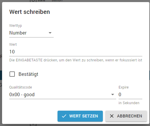

                                Sobald ich unter Objekten eine Zahl (egal 10, oder 10.0) eingebe,
                                wird die Lautstärke erfolgreich am Receiver geändert. Gleichzeitig bekomme ich allerdings einen Logeintrag und der übergebene Wert verschwindet im DP:
                                enigma2.0
                                2021-12-28 09:58:54.682	info	State value to set for "enigma2.0.command.SET_VOLUME" has to be type "number" but received type "string"

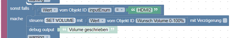

                                Detto wenn ich in einem Blockly einen Wert setze:
                                  "common": {
                                    "name": "Wunsch Volume 0-100%",
                                    "desc": "Manuell erzeugt",
                                    "role": "level.volume",
                                    "type": "number",
                                    "min": 0,
                                    "max": 100,
                                    "read": true,
                                    "write": true,
                                    "def": 0
                                  "type": "state",
                                  "_id": "0_userdata.0.Audio_Video.WoZ.Wunsch_Volume_iQ",
                                  "acl": {
                                    "object": 1636,
                                    "state": 1636,
                                    "owner": "system.user.admin",
                                  "user": "system.user.admin",
                                  "ts": 1640512411775

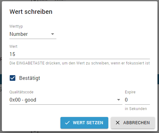

                                Setze ich den Wert allerdings mit "Bestätigt"
                                Bleibt der Wert stehen und es kommt auch kein Logeintrag.
                                Wie kann ich dieses "Bestätigt" in einem Blockly simulieren? Oder bin ich da gedanklich komplett falsch abgebogen?

                                  @metaxa sagte in Wozu ist der ack-Flag da?:
                                  mit "aktualisiere", dann ist ack=true - dann wird aber der Adapter nichts machen und deine Box behält die alte Lautstärke
                                  mit "steuere" ist ack = false
