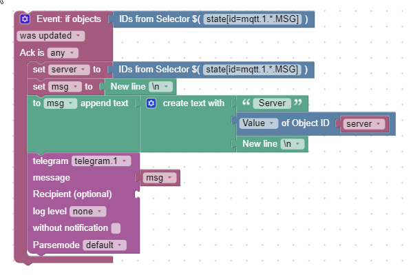

      I have problem in my blocky script
      I'm trying to get value of updated object id sent to telegram
      Blocky looks like below
      I have several mqtt.1 object, for ex. mqtt.1.bedroom, mqtt.1.classroom, etvc
      If there is update in value of one mqtt.1 object, for ex. mqtt.1.bedroom.MSG, I want telegram to send value of mqtt.1.bedroom.MSG
      However with this blocky, telegram only send word "Server" without value
      How to do this?

            @paul53 by inserting value "server", it will show all mqtt.1.* object, not only updated object
            so for ex. I have mqtt.1.bedroom.MSG and mqtt.1.classroom.MSG, then
            server = mqtt.1.bedroom.MSG,mqtt.1.classroom.MSG

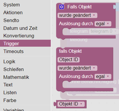

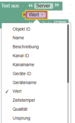

              Wert (object value) shows the value of the just updated datapoint. You will find it under "Trigger".
              If you want to send the ID (for ex. "mqtt.1.bedroom.MSG") of the updated datapoint:
              If you want to send both (id and value):

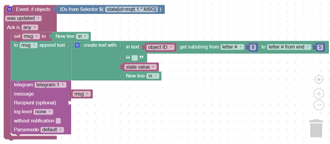

                    FYI below my updated blocky script
                      paul53 @dony71 last edited by paul53
                      @dony71
                      Try replacing $Selector with RegExp.
                      The $Selector does not recognise new data points because it uses the buffer of the Javascript instance. A subscription with RegExp captures new data points.
