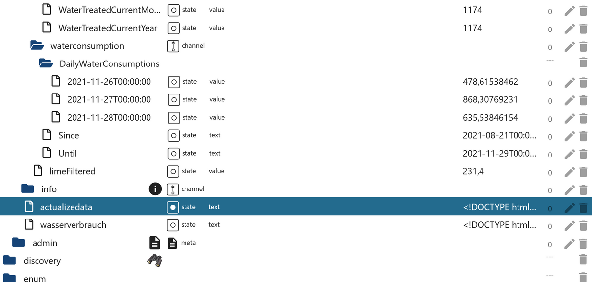

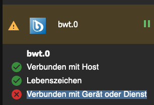

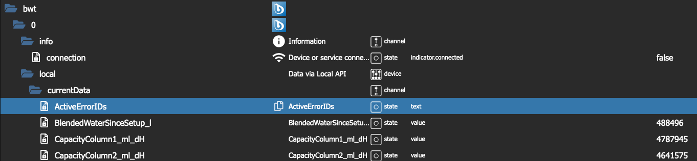

                              @qwertz Ich habe mal was blind probiert
                              https://forum.iobroker.net/topic/49576/test-adapter-bwt-v0-0-x

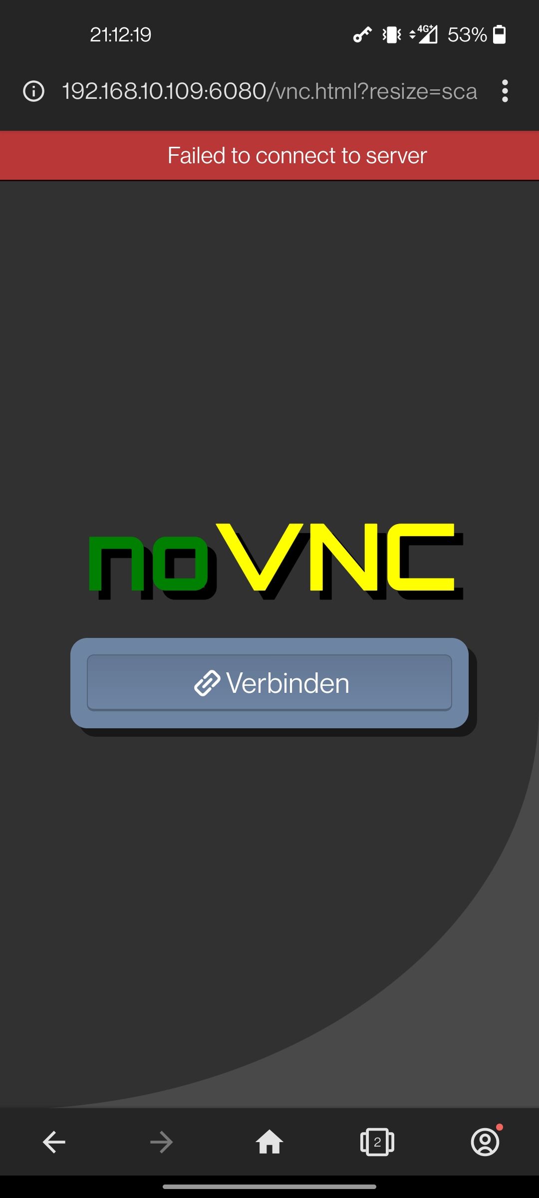

                                Kusi @tombox last edited by Kusi
                                @tombox Ich bin zur Zeit nur mit dem Natel über VPN verbunden, konnte den Adapter dennoch installieren.
                                Folgendes wir im Log gezeigt:

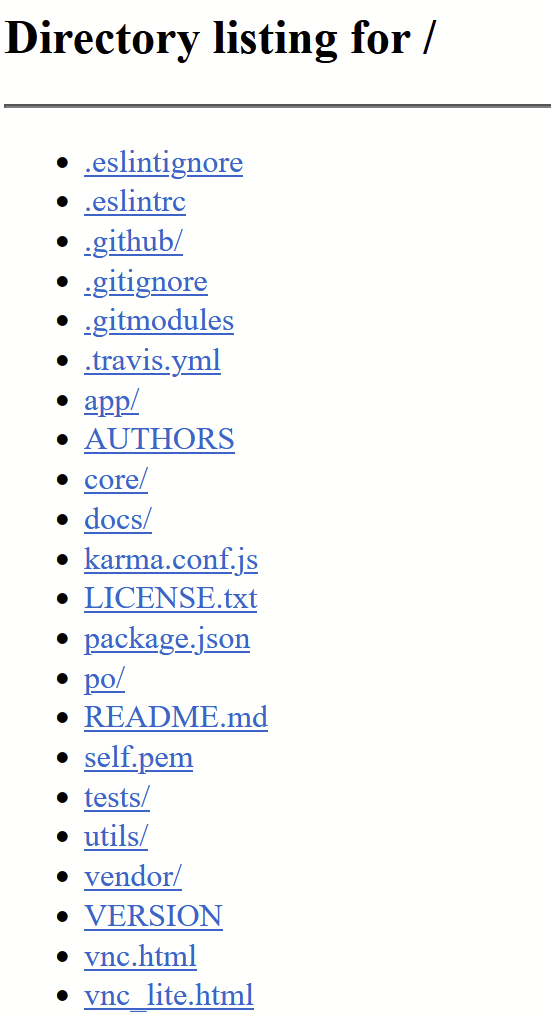

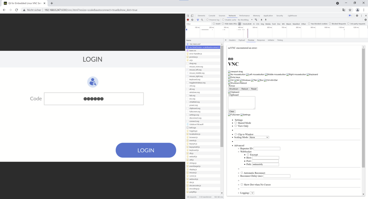

                                2021-11-21 20:44:27.998 info "<!DOCTYPE html>\n<html lang="en" class="noVNC_loading">\n<head>\n\n <!--\n noVNC example: simple example using default UI\n Copyright (C) 2018 The noVNC Authors\n noVNC is licensed under the MPL 2.0 (see LICENSE.txt)\n This file is licensed under the 2-Clause BSD license (see LICENSE.txt).\n\n Connect parameters are provided in query string:\n http://example.com/?host=HOST&port=PORT&encrypt=1\n or the fragment:\n http://example.com/#host=HOST&port=PORT&encrypt=1\n -->\n <title>noVNC</title>\n\n <meta charset="utf-8">\n\n <!-- Icons (see app/images/icons/Makefile for what the sizes are for) -->\n <link rel="icon" sizes="16x16" type="image/png" href="app/images/icons/novnc-16x16.png">\n <link rel="icon" sizes="24x24" type="image/png" href="app/images/icons/novnc-24x24.png">\n <link rel="icon" sizes="32x32" type="image/png" href="app/images/icons/novnc-32x32.png">\n <link rel="icon" sizes="48x48" type="image/png" href="app/images/icons/novnc-48x48.png">\n <link rel="icon" sizes="60x60" type="image/png" href="app/images/icons/novnc-60x60.png">\n <link rel="icon" sizes="64x64" type="image/png" href="app/images/icons/novnc-64x64.png">\n <link rel="icon" sizes="72x72" type="image/png" href="app/images/icons/novnc-72x72.png">\n <link rel="icon" sizes="76x76" type="image/png" href="app/images/icons/novnc-76x76.png">\n <link rel="icon" sizes="96x96" type="image/png" href="app/images/icons/novnc-96x96.png">\n <link rel="icon" sizes="120x120" type="image/png" href="app/images/icons/novnc-120x120.png">\n <link rel="icon" sizes="144x144" type="image/png" href="app/images/icons/novnc-144x144.png">\n <link rel="icon" sizes="152x152" type="image/png" href="app/images/icons/novnc-152x152.png">\n <link rel="icon" sizes="192x192" type="image/png" href="app/images/icons/novnc-192x192.png">\n <!-- Firefox currently mishandles SVG, see #1419039\n <link rel="icon" sizes="any" type="image/svg+xml" href="app/images/icons/novnc-icon.svg">\n -->\n <!-- Repeated last so that legacy handling will pick this -->\n <link rel="icon" sizes="16x16" type="image/png" href="app/images/icons/novnc-16x16.png">\n\n <!-- Apple iOS Safari settings -->\n <meta name="viewport" content="width=device-width, initial-scale=1.0, maximum-scale=1.0, user-scalable=no">\n <meta name="apple-mobile-web-app-capable" content="yes">\n <meta name="apple-mobile-web-app-status-bar-style" content="black-translucent">\n <!-- Home Screen Icons (favourites and bookmarks use the normal icons) -->\n <link rel="apple-touch-icon" sizes="60x60" type="image/png" href="app/images/icons/novnc-60x60.png">\n <link rel="apple-touch-icon" sizes="76x76" type="image/png" href="app/images/icons/novnc-76x76.png">\n <link rel="apple-touch-icon" sizes="120x120" type="image/png" href="app/images/icons/novnc-120x120.png">\n <link rel="apple-touch-icon" sizes="152x152" type="image/png" href="app/images/icons/novnc-152x152.png">\n\n <!-- Stylesheets -->\n <link rel="stylesheet" href="app/styles/base.css">\n\n <!-- this is included as a normal file in order to catch script-loading errors as well -->\n <script src="app/error-handler.js"></script>\n\n <!-- begin scripts -->\n <!-- promise polyfills promises for IE11 -->\n <script src="vendor/promise.js"></script>\n <!-- ES2015/ES6 modules polyfill -->\n <script type="module">\n window._noVNC_has_module_support = true;\n </script>\n <script>\n window.addEventListener("load", function() {\n if (window._noVNC_has_module_support) return;\n var loader = document.createElement("script");\n loader.src = "vendor/browser-es-module-loader/dist/browser-es-module-loader.js";\n document.head.appendChild(loader);\n });\n </script>\n <!-- actual script modules -->\n <script type="module" crossorigin="anonymous" src="app/ui.js"></script>\n <!-- end scripts -->\n</head>\n\n<body>\n\n <div id="noVNC_fallback_error" class="noVNC_center">\n <div>\n <div>noVNC encountered an error:</div>\n <br>\n <div id="noVNC_fallback_errormsg"></div>\n </div>\n </div>\n\n <!-- noVNC Control Bar -->\n <div id="noVNC_control_bar_anchor" class="noVNC_vcenter">\n\n <div id="noVNC_control_bar">\n <div id="noVNC_control_bar_handle" title="Hide/Show the control bar"><div></div></div>\n\n <div class="noVNC_scroll">\n\n <h1 class="noVNC_logo" translate="no"><span>no</span><br>VNC</h1>\n\n <!-- Drag/Pan the viewport -->\n <input type="image" alt="viewport drag" src="app/images/drag.svg"\n id="noVNC_view_drag_button" class="noVNC_button noVNC_hidden"\n title="Move/Drag Viewport">\n\n <!--noVNC Touch Device only buttons-->\n <div id="noVNC_mobile_buttons">\n <input type="image" alt="No mousebutton" src="app/images/mouse_none.svg"\n id="noVNC_mouse_button0" class="noVNC_button"\n title="Active Mouse Button">\n <input type="image" alt="Left mousebutton" src="app/images/mouse_left.svg"\n id="noVNC_mouse_button1" class="noVNC_button"\n title="Active Mouse Button">\n <input type="image" alt="Middle mousebutton" src="app/images/mouse_middle.svg"\n id="noVNC_mouse_button2" class="noVNC_button"\n title="Active Mouse Button">\n <input type="image" alt="Right mousebutton" src="app/images/mouse_right.svg"\n id="noVNC_mouse_button4" class="noVNC_button"\n title="Active Mouse Button">\n <input type="image" alt="Keyboard" src="app/images/keyboard.svg"\n id="noVNC_keyboard_button" class="noVNC_button" title="Show Keyboard">\n </div>\n\n <!-- Extra manual keys -->\n <div id="noVNC_extra_keys">\n <input type="image" alt="Extra keys" src="app/images/toggleextrakeys.svg"\n id="noVNC_toggle_extra_keys_button" class="noVNC_button"\n title="Show Extra Keys">\n <div class="noVNC_vcenter">\n <div id="noVNC_modifiers" class="noVNC_panel">\n <input type="image" alt="Ctrl" src="app/images/ctrl.svg"\n id="noVNC_toggle_ctrl_button" class="noVNC_button"\n title="Toggle Ctrl">\n <input type="image" alt="Alt" src="app/images/alt.svg"\n id="noVNC_toggle_alt_button" class="noVNC_button"\n title="Toggle Alt">\n <input type="image" alt="Windows" src="app/images/windows.svg"\n id="noVNC_toggle_windows_button" class="noVNC_button"\n title="Toggle Windows">\n <input type="image" alt="Tab" src="app/images/tab.svg"\n id="noVNC_send_tab_button" class="noVNC_button"\n title="Send Tab">\n <input type="image" alt="Esc" src="app/images/esc.svg"\n id="noVNC_send_esc_button" class="noVNC_button"\n title="Send Escape">\n <input type="image" alt="Ctrl+Alt+Del" src="app/images/ctrlaltdel.svg"\n id="noVNC_send_ctrl_alt_del_button" class="noVNC_button"\n title="Send Ctrl-Alt-Del">\n </div>\n </div>\n </div>\n\n <!-- Shutdown/Reboot -->\n <input type="image" alt="Shutdown/Reboot" src="app/images/power.svg"\n id="noVNC_power_button" class="noVNC_button"\n title="Shutdown/Reboot...">\n <div class="noVNC_vcenter">\n <div id="noVNC_power" class="noVNC_panel">\n <div class="noVNC_heading">\n <img alt="" src="app/images/power.svg"> Power\n </div>\n <input type="button" id="noVNC_shutdown_button" value="Shutdown">\n <input type="button" id="noVNC_reboot_button" value="Reboot">\n <input type="button" id="noVNC_reset_button" value="Reset">\n </div>\n </div>\n\n <!-- Clipboard -->\n <input type="image" alt="Clipboard" src="app/images/clipboard.svg"\n id="noVNC_clipboard_button" class="noVNC_button"\n title="Clipboard">\n <div class="noVNC_vcenter">\n <div id="noVNC_clipboard" class="noVNC_panel">\n <div class="noVNC_heading">\n <img alt="" src="app/images/clipboard.svg"> Clipboard\n </div>\n <textarea id="noVNC_clipboard_text" rows=5></textarea>\n <br>\n <input id="noVNC_clipboard_clear_button" type="button"\n value="Clear" class="noVNC_submit">\n </div>\n </div>\n\n <!-- Toggle fullscreen -->\n <input type="image" alt="Fullscreen" src="app/images/fullscreen.svg"\n id="noVNC_fullscreen_button" class="noVNC_button noVNC_hidden"\n title="Fullscreen">\n\n <!-- Settings -->\n <input type="image" alt="Settings" src="app/images/settings.svg"\n id="noVNC_settings_button" class="noVNC_button"\n title="Settings">\n <div class="noVNC_vcenter">\n <div id="noVNC_settings" class="noVNC_panel">\n <ul>\n <li class="noVNC_heading">\n <img alt="" src="app/images/settings.svg"> Settings\n </li>\n <li>\n <label><input id="noVNC_setting_shared" type="checkbox"> Shared Mode</label>\n </li>\n <li>\n <label><input id="noVNC_setting_view_only" type="checkbox"> View Only</label>\n </li>\n <li><hr></li>\n <li>\n <label><input id="noVNC_setting_view_clip" type="checkbox"> Clip to Window</label>\n </li>\n <li>\n <label for="noVNC_setting_resize">Scaling Mode:</label>\n <select id="noVNC_setting_resize" name="vncResize">\n <option value="off">None</option>\n <option value="scale">Local Scaling</option>\n <option value="remote">Remote Resizing</option>\n </select>\n </li>\n <li><hr></li>\n <li>\n <div class="noVNC_expander">Advanced</div>\n <div><ul>\n <li>\n <label for="noVNC_setting_repeaterID">Repeater ID:</label>\n <input id="noVNC_setting_repeaterID" type="text" value="">\n </li>\n <li>\n <div class="noVNC_expander">WebSocket</div>\n <div><ul>\n <li>\n <label><input id="noVNC_setting_encrypt" type="checkbox"> Encrypt</label>\n </li>\n <li>\n <label for="noVNC_setting_host">Host:</label>\n <input id="noVNC_setting_host">\n </li>\n <li>\n <label for="noVNC_setting_port">Port:</label>\n <input id="noVNC_setting_port" type="number">\n </li>\n <li>\n <label for="noVNC_setting_path">Path:</label>\n <input id="noVNC_setting_path" type="text" value="websockify">\n </li>\n </ul></div>\n </li>\n <li><hr></li>\n <li>\n <label><input id="noVNC_setting_reconnect" type="checkbox"> Automatic Reconnect</label>\n </li>\n <li>\n <label for="noVNC_setting_reconnect_delay">Reconnect Delay (ms):</label>\n <input id="noVNC_setting_reconnect_delay" type="number">\n </li>\n <li><hr></li>\n <li>\n <label><input id="noVNC_setting_show_dot" type="checkbox"> Show Dot when No Cursor</label>\n </li>\n <li><hr></li>\n <!-- Logging selection dropdown -->\n <li>\n <label>Logging:\n <select id="noVNC_setting_logging" name="vncLogging">\n </select>\n </label>\n </li>\n </ul></div>\n </li>\n </ul>\n </div>\n </div>\n\n <!-- Connection Controls -->\n <input type="image" alt="Disconnect" src="app/images/disconnect.svg"\n id="noVNC_disconnect_button" class="noVNC_button"\n title="Disconnect">\n\n </div>\n </div>\n\n <div id="noVNC_control_bar_hint"></div>\n\n </div> <!-- End of noVNC_control_bar -->\n\n <!-- Status Dialog -->\n <div id="noVNC_status"></div>\n\n <!-- Connect button -->\n <div class="noVNC_center">\n <div id="noVNC_connect_dlg">\n <div class="noVNC_logo" translate="no"><span>no</span>VNC</div>\n <div id="noVNC_connect_button"><div>\n <img alt="" src="app/images/connect.svg"> Connect\n </div></div>\n </div>\n </div>\n\n <!-- Password Dialog -->\n <div class="noVNC_center noVNC_connect_layer">\n <div id="noVNC_password_dlg" class="noVNC_panel"><form>\n <ul>\n <li>\n <label>Password:</label>\n <input id="noVNC_password_input" type="password">\n </li>\n <li>\n <input id="noVNC_password_button" type="submit" value="Send Password" class="noVNC_submit">\n </li>\n </ul>\n </form></div>\n </div>\n\n <!-- Transition Screens -->\n <div id="noVNC_transition">\n <div id="noVNC_transition_text"></div>\n <div>\n <input type="button" id="noVNC_cancel_reconnect_button" value="Cancel" class="noVNC_submit">\n </div>\n <div class="noVNC_spinner"></div>\n </div>\n\n <!-- This is where the RFB elements will attach -->\n <div id="noVNC_container">\n <!-- Note that Google Chrome on Android doesn't respect any of these,\n html attributes which attempt to disable text suggestions on the\n on-screen keyboard. Let's hope Chrome implements the ime-mode\n style for example -->\n <textarea id="noVNC_keyboardinput" autocapitalize="off"\n autocomplete="off" spellcheck="false" tabindex="-1"></textarea>\n </div>\n\n <audio id="noVNC_bell">\n <source src="app/sounds/bell.oga" type="audio/ogg">\n <source src="app/sounds/bell.mp3" type="audio/mpeg">\n </audio>\n </body>\n</html>\n"
                                  tombox @Kusi last edited by
                                  @kusi da ist irgendeine vnc verbindung im weg
                                  Q K 3 Replies Last reply Reply Quote 0

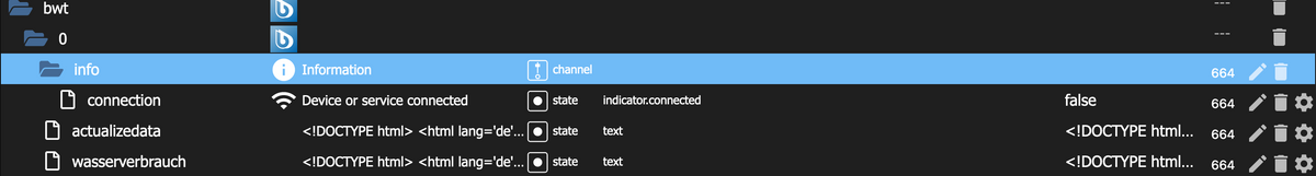

                                    qwertz @tombox last edited by qwertz
                                    @tombox
                                    Bei mir kommt:
                                    "<!DOCTYPE html>\n<html lang='de'>\n <head>\n <meta http-equiv=\"Content-Type\" content=\"text/html; charset=utf-8\" /> \n <meta name=\"viewport\" content=\"width=device-width, height=device-height, initial-scale=1.0\">\n <title>\t \n Login \n </title>\n <link href=\"/favicon.ico\" type=\"image/x-icon\" rel=\"icon\"/><link href=\"/favicon.ico\" type=\"image/x-icon\" rel=\"shortcut icon\"/><link rel=\"stylesheet\" type=\"text/css\" href=\"/css/font.min.css\"/><link rel=\"stylesheet\" type=\"text/css\" href=\"/css/default.min.css\"/><link rel=\"stylesheet\" type=\"text/css\" href=\"/css/progressbarBackLeft.min.css\"/><link rel=\"stylesheet\" type=\"text/css\" href=\"/css/simpleMenuCloseRight.min.css\"/><link rel=\"stylesheet\" type=\"text/css\" href=\"/css/onlyTitleHeader.min.css\"/><link rel=\"stylesheet\" type=\"text/css\" href=\"/css/mobile.min.css\"/><script type=\"text/javascript\" src=\"/js/jquery-3.1.1.min.js\"></script> </head>\n \n <!-- ************ Inhalt ********* -->\n <body>\n <div class=\"container\">\n <div class=\"content\" >\n <!-- ************ BWT-Logo ********* -->\n <div class=\"logo\">\n <img src=\"/img/cake.logo.png\" class=\"logoImage\" alt=\"\"/> </div>\n <!-- ************ Inhalt vom Display ********* -->\n <div id=\"displayBackground\">\n <div id =\"headerBackground\" >\n <div id=\"displayHeader\" >\n \n <div style=\"color:#545554;text-transform: uppercase; width:100%;\" align=\"center\" class=\"headLine1 menuHeaderTitle\">Login</div>\n \n </div>\n \n \n </div>\n \n <div class=\"display\"> \n <!-- ************ Header ********* --> \n \n \n<div align=\"center\"><img src=\"/img/techniker_login_48.png\" class=\"TSLoginIcon\">\n</div>\n<form action=\"/users/login?url=%2Fusers%2Flogin\" id=\"STLoginLoginForm\" method=\"post\" accept-charset=\"utf-8\"><div style=\"display:none;\"><input type=\"hidden\" name=\"_method\" value=\"POST\"/></div><div class=\"displayBorder\"><label class=\" copy labelforSelect labels\" >Code</label><label for=\"STLoginPWField\"></label><input name=\"STLoginPWField\" placeholder=\"Bitte eingeben\" =\"\" class=\"editFieldButton copy\" id=\"STLoginPWField\" type=\"password\"/></div><div class=\"buttonsDiv\" >\n <button id=\"STLoginButton\" class=\"weiterButton\" name=\"function\" value=\"save\" type=\"submit\" formaction=\"/users/login\">LOGIN</button>\n</div> \n\n<script>\n \n \n</script> \n </div>\n </div>\n </div>\n </div>\n </body>\n</html>\n\n\n\n"
                                        @tombox sagte in BWT Weichwasseranlage auslesen:
                                        vnc verbindung
                                        Was meinst du damit?
                                            @tombox
                                            Gelöscht und neu installiert: trotzdem:
