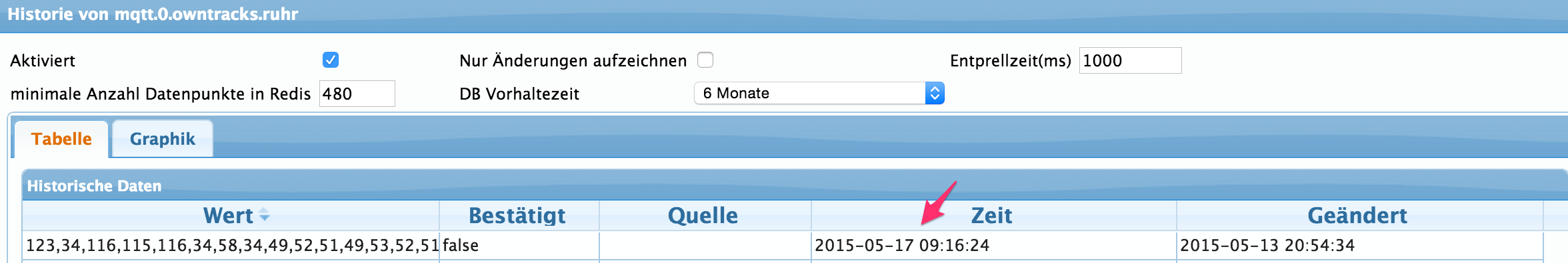

            • ruhr70
              ruhr70 last edited by
              mqtt-0	2015-05-17 09:38:47	info	Type: string; Payload: {"cog":-1,"batt":"100","lon":"7.92283","acc":"65","vel":-1,"vac":10,"lat":"52.3427","t":"u","tst":"1431848304","alt":43,"_type":"location","tid":"MH"}
              mqtt-0	2015-05-17 09:38:47	info	Type: object
              mqtt-0	2015-05-17 09:38:41	info	Client [iPhone 6] subscribes on "mqtt.0.owntracks.ruhr.#" with regex /^mqtt\.0\.owntracks\.ruhr\..*/
              mqtt-0	2015-05-17 09:38:41	info	Client [iPhone 6] subscribes on "owntracks.ruhr.#" with regex /^owntracks\.ruhr\..*/
              mqtt-0	2015-05-17 09:38:41	info	Client [iPhone 6] subscribes on "mqtt.0.owntracks.+.+" with regex /mqtt\.0\.owntracks\.[^.]*\.[^\.].*$/
              mqtt-0	2015-05-17 09:38:41	info	Client [iPhone 6] subscribes on "owntracks.+.+" with regex /owntracks\.[^.]*\.[^\.].*$/
              mqtt-0	2015-05-17 09:38:41	info	Client [iPhone 6] connected
              mqtt-0	2015-05-17 09:38:27	info	Client [iPhone 6] closed
              mqtt-0	2015-05-17 09:38:27	info	Client [iPhone 6] disconnected
              mqtt-0	2015-05-17 09:38:26	info	Type: string; Payload: {"cog":-1,"batt":"100","lon":"7.92283","acc":"65","vel":-1,"vac":10,"lat":"52.2427","t":"u","tst":"1431848304","alt":43,"_type":"location","tid":"MH"}
              mqtt-0	2015-05-17 09:38:26	info	Type: object
              mqtt-0	2015-05-17 09:38:24	info	Type: string; Payload: {"tst":"1431848304","acc":"65","_type":"location","alt":43,"lon":"7.92283","vac":10,"vel":-1,"lat":"52.3427","cog":-1,"tid":"MH","batt":"100"}
              mqtt-0	2015-05-17 09:38:24	info	Type: object
              mqtt-0	2015-05-17 09:38:20	info	Client [iPhone 6] subscribes on "mqtt.0.owntracks.ruhr.#" with regex /^mqtt\.0\.owntracks\.ruhr\..*/
              mqtt-0	2015-05-17 09:38:20	info	Client [iPhone 6] subscribes on "owntracks.ruhr.#" with regex /^owntracks\.ruhr\..*/
              mqtt-0	2015-05-17 09:38:20	info	Client [iPhone 6] subscribes on "mqtt.0.owntracks.+.+" with regex /mqtt\.0\.owntracks\.[^.]*\.[^\.].*$/
              mqtt-0	2015-05-17 09:38:20	info	Client [iPhone 6] subscribes on "owntracks.+.+" with regex /owntracks\.[^.]*\.[^\.].*$/
              mqtt-0	2015-05-17 09:38:20	info	Client [iPhone 6] connected
              mqtt-0	2015-05-17 09:38:11	info	Starting MQTT authenticated server on port 1883
              mqtt-0	2015-05-17 09:38:10	info	starting. Version 0.2.7 in /opt/iobroker/node_modules/iobroker.mqtt
              Im Log steht die Zeichenkette. Im Historie stehen trotzdem die Dezimahlzahlen.
              • Bluefox
                Bluefox last edited by
                Ich glaube, ich habe es.
                Kannst du noch die Zeile (ca 465):
                     if (typeof packet.payload == 'string' && packet.payload[0] == '{') {
                           try {
                               packet.payload = JSON.parse(packet.payload);
                auf
                     if (0 || typeof packet.payload == 'string' && packet.payload[0] == '{') {
                • ruhr70
                  Zeile ausgetauscht. mqqt Adapter neu gestartet.
                  In der Variable stehen immer noch die Dezimalzahlen (ganz aktuell von 19:05).
                  mqtt-0	2015-05-17 19:10:17	info	Client [iPhone 6] closed
                  mqtt-0	2015-05-17 19:10:17	info	Client [iPhone 6] disconnected
                  mqtt-0	2015-05-17 19:05:16	info	Type: string; Payload: {"cog":-1,"batt":"100","lon":"7.92287","acc":"65","vel":-1,"vac":10,"lat":"52.2426","t":"u","tst":"1431882313","alt":41,"_type":"location","tid":"MH"}
                  mqtt-0	2015-05-17 19:05:16	info	Type: object
                  mqtt-0	2015-05-17 19:05:14	info	Client [iPhone 6] subscribes on "mqtt.0.owntracks.ruhr.#" with regex /^mqtt\.0\.owntracks\.ruhr\..*/
                  mqtt-0	2015-05-17 19:05:14	info	Client [iPhone 6] subscribes on "owntracks.ruhr.#" with regex /^owntracks\.ruhr\..*/
                  mqtt-0	2015-05-17 19:05:14	info	Client [iPhone 6] subscribes on "mqtt.0.owntracks.+.+" with regex /mqtt\.0\.owntracks\.[^.]*\.[^\.].*$/
                  mqtt-0	2015-05-17 19:05:14	info	Client [iPhone 6] subscribes on "owntracks.+.+" with regex /owntracks\.[^.]*\.[^\.].*$/
                  mqtt-0	2015-05-17 19:05:14	info	Client [iPhone 6] connected
                  mqtt-0	2015-05-17 19:04:56	info	Starting MQTT authenticated server on port 1883
                  mqtt-0	2015-05-17 19:04:55	info	starting. Version 0.2.7 in /opt/iobroker/node_modules/iobroker.mqtt
                  mqtt-0	2015-05-17 19:04:53	info	terminating
                  Im Log steht der Text ja schon so, wie wie wir ihn brauchen.
                  Ich hoffe nur, dass das Dezimalthema nicht von mir kommt :shock:
