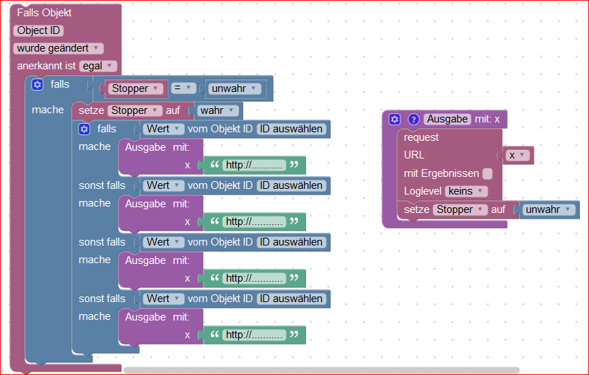

      • rantanplan
        rantanplan last edited by
        Hallo Jeeper.at
        Bau doch im Blockly einen "Stopper" ein.
        Blockly Import
        <xml xmlns="http://www.w3.org/1999/xhtml"><block type="on" id="@t_e}|]DG/O07f-(v-5k" x="-412" y="13"><field name="OID">Object ID</field>
        <statement name="STATEMENT"><block type="controls_if" id="-e%9|p7+YNm0%uCfc;1c"><value name="IF0"><block type="logic_compare" id="0(pbF/wL;)wA^adaD}5N"><field name="OP">EQ</field>
                <value name="A"><block type="variables_get" id=")+dV=k:UX|*M*G*6J7xy"><field name="VAR">Stopper</field></block></value>
                <value name="B"><block type="logic_boolean" id="nDHW`OiN~!.jTXS9`!vn"><field name="BOOL">FALSE</field></block></value></block></value>
            <statement name="DO0"><block type="variables_set" id=",#s5,-:Y-8np@n}R%1-9"><field name="VAR">Stopper</field>
                <value name="VALUE"><block type="logic_boolean" id="M=}8M~Ph[@d..E8^:#jV"><field name="BOOL">TRUE</field></block></value>
                <next><block type="controls_if" id=".[7:8o*AKo~IhEP?q*d!"><mutation elseif="3"></mutation>
                    <value name="IF0"><block type="get_value" id="^C`J/-voGg?9|ocLE((w"><field name="ATTR">val</field>
                        <field name="OID">ID auswählen</field></block></value>
                    <statement name="DO0"><block type="procedures_callnoreturn" id="An)MH:k)u6M](gspJ|Is"><mutation name="Ausgabe"><arg name="x"></arg></mutation>
                        <value name="ARG0"><block type="text" id="s3~#v8VWFJwcNzP,_yFw"><field name="TEXT">http://...........</field></block></value></block></statement>
                    <value name="IF1"><block type="get_value" id="DM@P=DU~2S5EaGxbreJJ"><field name="ATTR">val</field>
                    <statement name="DO1"><block type="procedures_callnoreturn" id="!uHgp}q~IkJaT,WytRO/"><mutation name="Ausgabe"><arg name="x"></arg></mutation>
                        <value name="ARG0"><block type="text" id="TGNW_CliFue-Y1:2F-])"><field name="TEXT">http://...........</field></block></value></block></statement>
                    <value name="IF2"><block type="get_value" id="bHX1*l`q[t)lLHS!%{oj"><field name="ATTR">val</field>
                    <statement name="DO2"><block type="procedures_callnoreturn" id="T1xel!oRR8`2+f!a,UTW"><mutation name="Ausgabe"><arg name="x"></arg></mutation>
                        <value name="ARG0"><block type="text" id="WIg5NU^u:pT+h_8k`3jX"><field name="TEXT">http://...........</field></block></value></block></statement>
                    <value name="IF3"><block type="get_value" id="Mp?A*/:X6Gx2i{PYa4{T"><field name="ATTR">val</field>
                    <statement name="DO3"><block type="procedures_callnoreturn" id="U(,X/EsEx?|T:kWL)~jS"><mutation name="Ausgabe"><arg name="x"></arg></mutation>
                        <value name="ARG0"><block type="text" id="Magg|;a[TjL`8_C;bq`G"><field name="TEXT">http://...........</field></block></value></block></statement></block></next></block></statement></block></statement></block>
        <block type="procedures_defnoreturn" id="d6=F=/SszHt#PIQ%Ix?:" x="113" y="163"><mutation><arg name="x"></arg></mutation>
        <field name="NAME">Ausgabe</field>
        <statement name="STACK"><block type="request" id="bJ+WLjndL@uq-N@Q{W?5"><mutation with_statement="false"></mutation>
        <field name="WITH_STATEMENT">FALSE</field>
            <value name="URL"><shadow type="text" id="[TUMszpJT#pk{Lt`m#;C"><field name="TEXT">text</field></shadow>
              <block type="variables_get" id="^*)XmRGq1nm_4]3vz{0o"><field name="VAR">x</field></block></value>
            <next><block type="variables_set" id="YEe7dE-T!fu#WP0=naU="><field name="VAR">Stopper</field>
                <value name="VALUE"><block type="logic_boolean" id="H:W}n[Qu1aTE2lRObL6J"><field name="BOOL">FALSE</field></block></value></block></next></block></statement></block></xml>
        So könnte es funktionieren.
