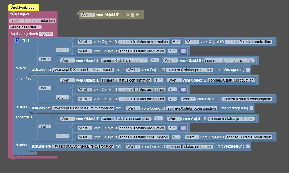

    5. Fehlermeldung warum?
      Steinmetz_4 last edited by Steinmetz_4
      ich erhalte durchwegs diese Fehlermeldung:
      Zeit
      debug
      Nachricht
      javascript.0
      2021-10-09 11:04:28.634	warn	at processImmediate (internal/timers.js:461:21)
      javascript.0
      2021-10-09 11:04:43.435	warn	at processImmediate (internal/timers.js:461:21)
      javascript.0
      2021-10-09 11:04:43.435	warn	at Immediate._onImmediate (/opt/iobroker/node_modules/iobroker.js-controller/lib/adapter.js:5706:41)
      javascript.0
      2021-10-09 11:04:43.435	warn	at Object.stateChange (/opt/iobroker/node_modules/iobroker.javascript/main.js:525:29)
      javascript.0
      2021-10-09 11:04:43.432	warn	at Object.callback (/opt/iobroker/node_modules/iobroker.javascript/lib/sandbox.js:1087:38)
      javascript.0
      2021-10-09 11:04:43.431	warn	at Object.<anonymous> (script.js.Aller_Anfang.Sonnen.Direktverbrauch:4:150)
      javascript.0
      2021-10-09 11:04:43.430	warn	getState "false" not found (3)
      für dieses Blockly Script:
        <block type="comment" id="v0+Qx$kU8uvP:.cIiNxG" x="488" y="238">
          <field name="COMMENT">Direktverbrauch</field>
            <block type="on" id="#@$!`ts0DsFX77Z%CAW5">
              <field name="OID">sonnen.0.status.production</field>
                <block type="controls_if" id="Ev7%)II(#54utgPQN/*H">
                  <mutation elseif="2"></mutation>
                    <block type="logic_operation" id="Rk,m,5c*!!DZQa?H]Vps">
                      <field name="OP">AND</field>
                        <block type="logic_operation" id="8EHqCa+!^W9W:FNc)%oP">
                            <block type="logic_compare" id="Z4N0/9uqV^m4*/$KAVX|">
                              <field name="OP">NEQ</field>
                                <block type="get_value" id="H#P:utAb;@a%4G#;hZx|">
                                  <field name="OID">sonnen.0.status.consumption</field>
                                <block type="get_value" id="Zv/,k+AGXpAo!e%9?5TE">
                            <block type="logic_compare" id="r4#PTnnV(tQdIY!Z`v^O">
                              <field name="OP">GT</field>
                                <block type="get_value" id="6ApdIeyh?O=pXrLKa(^C">
                                <block type="math_number" id="zYErv@EG3m+p;ow$AaL$">
                                  <field name="NUM">0</field>
                        <block type="get_value_var" id="W2n+w1@MT,h?2WsZ`A0(">
                          <value name="OID">
                            <shadow type="text" id="D/]Nazx^7~VCdd_:`;,%">
                              <field name="TEXT"></field>
                            <block type="logic_compare" id="??3,;JluTgjlG;C,iZkQ">
                              <field name="OP">LTE</field>
                                <block type="get_value" id="S**5PaiJ/NWl?(avUz!o">
                                <block type="get_value" id="c8@VdsWw1YmpAHz4u)v#">
                    <block type="update" id="neMAPV.F53UtP2+=eK7B">
                      <field name="OID">javascript.0.Sonnen.Direktverbrauch</field>
                        <block type="get_value" id="{(Y{X$[kxsWV{pKt(Uo4">
                  <value name="IF1">
                    <block type="logic_operation" id="Ti{9.cPk=pYO_#%XyQwH">
                        <block type="logic_compare" id="6uIF^dS9xkr+H(zGO/7#">
                            <block type="get_value" id="Ao/Q@L{UZF!+sp=kGR=!">
                            <block type="get_value" id="n~1(s@7b}s|j,xze8-df">
                        <block type="logic_operation" id="5*ep;aBjE,K74z_R2li}">
                            <block type="logic_compare" id="DBPO],|nw#n/|y4c%;eF">
                                <block type="get_value" id="cWR5m2(AeP16CGL~~zj~">
                                <block type="math_number" id="GAG#T8334B)7}YHSVrfn">
                            <block type="logic_compare" id="E!7j]aIiR}m6T=xR?#;(">
                              <field name="OP">GTE</field>
                                <block type="get_value" id="Zb!pk_1xjVDU1(t-51#9">
                                <block type="get_value" id="%PyCFwN.B!Vj]WNIa6{e">
                  <statement name="DO1">
                    <block type="update" id="W`zHsB}e,A^SN/.%[;$`">
                        <block type="get_value" id="C9$]tXmt!ADx!1%fkgJm">
                  <value name="IF2">
                    <block type="logic_operation" id="BQwo1NQ6Z?5ipjSQ/|j?">
                        <block type="logic_compare" id="Kaz^tQC|Ub6rXRg(;#7Z">
                            <block type="get_value" id="_6HBK0_w9FmRD*jY|Gy)">
                            <block type="get_value" id="vG7/JDJy-En}A]H.TZJ.">
                        <block type="logic_operation" id="CweYC@d^cdcU)T}[)|*8">
                            <block type="logic_compare" id="?OdpYZa?]FO[G9ocR-v%">
                                <block type="get_value" id="-EUT4J{{vdkXW-R=*lHl">
                                <block type="math_number" id="@/w/+/,VT:fbXkZU{7bc">
                            <block type="logic_compare" id="2=57;Kzm0`mWEPgY7+jy">
                                <block type="get_value" id="A$$^vPt~C!}=p`Kt@k0*">
                                <block type="get_value" id="{m$3pV}_bS0W%H{k.sOA">
                  <statement name="DO2">
                    <block type="update" id="6:W=N.lSE2^|)OxHz@5W">
                        <block type="get_value" id="yfnashpQ,tN_:{;0{YFd">
      // Direktverbrauch
      on({id: "sonnen.0.status.production"/*Production*/, change: "ne"}, async function (obj) {
        var value = obj.state.val;
        if (getState("sonnen.0.status.consumption").val != getState("sonnen.0.status.production").val && getState("sonnen.0.status.production").val > 0 && getState((getState("sonnen.0.status.production").val <= getState("sonnen.0.status.consumption").val)).val) {
          setState("javascript.0.Sonnen.Direktverbrauch"/*Direktverbrauch*/, getState("sonnen.0.status.production").val, true);
        } else if (getState("sonnen.0.status.consumption").val != getState("sonnen.0.status.production").val && getState("sonnen.0.status.production").val > 0 && getState("sonnen.0.status.production").val >= getState("sonnen.0.status.consumption").val) {
          setState("javascript.0.Sonnen.Direktverbrauch"/*Direktverbrauch*/, getState("sonnen.0.status.consumption").val, true);
        } else if (getState("sonnen.0.status.consumption").val != getState("sonnen.0.status.production").val && getState("sonnen.0.status.production").val > 0 && getState("sonnen.0.status.consumption").val >= getState("sonnen.0.status.production").val) {
      //JTNDeG1sJTIweG1sbnMlM0QlMjJodHRwcyUzQSUyRiUyRmRldmVsb3BlcnMuZ29vZ2xlLmNvbSUyRmJsb2NrbHklMkZ4bWwlMjIlM0UlM0NibG9jayUyMHR5cGUlM0QlMjJjb21tZW50JTIyJTIwaWQlM0QlMjJ2MCUyQlF4JTI0a1U4dXZQJTNBLmNJaU54RyUyMiUyMHglM0QlMjI0ODglMjIlMjB5JTNEJTIyMjM4JTIyJTNFJTNDZmllbGQlMjBuYW1lJTNEJTIyQ09NTUVOVCUyMiUzRURpcmVrdHZlcmJyYXVjaCUzQyUyRmZpZWxkJTNFJTNDbmV4dCUzRSUzQ2Jsb2NrJTIwdHlwZSUzRCUyMm9uJTIyJTIwaWQlM0QlMjIlMjMlNDAlMjQhJTYwdHMwRHNGWDc3WiUyNUNBVzUlMjIlM0UlM0NmaWVsZCUyMG5hbWUlM0QlMjJPSUQlMjIlM0Vzb25uZW4uMC5zdGF0dXMucHJvZHVjdGlvbiUzQyUyRmZpZWxkJTNFJTNDZmllbGQlMjBuYW1lJTNEJTIyQ09ORElUSU9OJTIyJTNFbmUlM0MlMkZmaWVsZCUzRSUzQ2ZpZWxkJTIwbmFtZSUzRCUyMkFDS19DT05ESVRJT04lMjIlM0UlM0MlMkZmaWVsZCUzRSUzQ3N0YXRlbWVudCUyMG5hbWUlM0QlMjJTVEFURU1FTlQlMjIlM0UlM0NibG9jayUyMHR5cGUlM0QlMjJjb250cm9sc19pZiUyMiUyMGlkJTNEJTIyRXY3JTI1KUlJKCUyMzU0dXRnUFFOJTJGKkglMjIlM0UlM0NtdXRhdGlvbiUyMGVsc2VpZiUzRCUyMjIlMjIlM0UlM0MlMkZtdXRhdGlvbiUzRSUzQ3ZhbHVlJTIwbmFtZSUzRCUyMklGMCUyMiUzRSUzQ2Jsb2NrJTIwdHlwZSUzRCUyMmxvZ2ljX29wZXJhdGlvbiUyMiUyMGlkJTNEJTIyUmslMkNtJTJDNWMqISFEWlFhJTNGSCU1RFZwcyUyMiUzRSUzQ2ZpZWxkJTIwbmFtZSUzRCUyMk9QJTIyJTNFQU5EJTNDJTJGZmllbGQlM0UlM0N2YWx1ZSUyMG5hbWUlM0QlMjJBJTIyJTNFJTNDYmxvY2slMjB0eXBlJTNEJTIybG9naWNfb3BlcmF0aW9uJTIyJTIwaWQlM0QlMjI4RUhxQ2ElMkIhJTVFVzlXJTNBRk5jKSUyNW9QJTIyJTNFJTNDZmllbGQlMjBuYW1lJTNEJTIyT1AlMjIlM0VBTkQlM0MlMkZmaWVsZCUzRSUzQ3ZhbHVlJTIwbmFtZSUzRCUyMkElMjIlM0UlM0NibG9jayUyMHR5cGUlM0QlMjJsb2dpY19jb21wYXJlJTIyJTIwaWQlM0QlMjJaNE4wJTJGOXVxViU1RW00KiUyRiUyNEtBVlglN0MlMjIlM0UlM0NmaWVsZCUyMG5hbWUlM0QlMjJPUCUyMiUzRU5FUSUzQyUyRmZpZWxkJTNFJTNDdmFsdWUlMjBuYW1lJTNEJTIyQSUyMiUzRSUzQ2Jsb2NrJTIwdHlwZSUzRCUyMmdldF92YWx1ZSUyMiUyMGlkJTNEJTIySCUyM1AlM0F1dEFiJTNCJTQwYSUyNTRHJTIzJTNCaFp4JTdDJTIyJTNFJTNDZmllbGQlMjBuYW1lJTNEJTIyQVRUUiUyMiUzRXZhbCUzQyUyRmZpZWxkJTNFJTNDZmllbGQlMjBuYW1lJTNEJTIyT0lEJTIyJTNFc29ubmVuLjAuc3RhdHVzLmNvbnN1bXB0aW9uJTNDJTJGZmllbGQlM0UlM0MlMkZibG9jayUzRSUzQyUyRnZhbHVlJTNFJTNDdmFsdWUlMjBuYW1lJTNEJTIyQiUyMiUzRSUzQ2Jsb2NrJTIwdHlwZSUzRCUyMmdldF92YWx1ZSUyMiUyMGlkJTNEJTIyWnYlMkYlMkNrJTJCQUdYcEFvIWUlMjU5JTNGNVRFJTIyJTNFJTNDZmllbGQlMjBuYW1lJTNEJTIyQVRUUiUyMiUzRXZhbCUzQyUyRmZpZWxkJTNFJTNDZmllbGQlMjBuYW1lJTNEJTIyT0lEJTIyJTNFc29ubmVuLjAuc3RhdHVzLnByb2R1Y3Rpb24lM0MlMkZmaWVsZCUzRSUzQyUyRmJsb2NrJTNFJTNDJTJGdmFsdWUlM0UlM0MlMkZibG9jayUzRSUzQyUyRnZhbHVlJTNFJTNDdmFsdWUlMjBuYW1lJTNEJTIyQiUyMiUzRSUzQ2Jsb2NrJTIwdHlwZSUzRCUyMmxvZ2ljX2NvbXBhcmUlMjIlMjBpZCUzRCUyMnI0JTIzUFRublYodFFkSVkhWiU2MHYlNUVPJTIyJTNFJTNDZmllbGQlMjBuYW1lJTNEJTIyT1AlMjIlM0VHVCUzQyUyRmZpZWxkJTNFJTNDdmFsdWUlMjBuYW1lJTNEJTIyQSUyMiUzRSUzQ2Jsb2NrJTIwdHlwZSUzRCUyMmdldF92YWx1ZSUyMiUyMGlkJTNEJTIyNkFwZElleWglM0ZPJTNEcFhyTEthKCU1RUMlMjIlM0UlM0NmaWVsZCUyMG5hbWUlM0QlMjJBVFRSJTIyJTNFdmFsJTNDJTJGZmllbGQlM0UlM0NmaWVsZCUyMG5hbWUlM0QlMjJPSUQlMjIlM0Vzb25uZW4uMC5zdGF0dXMucHJvZHVjdGlvbiUzQyUyRmZpZWxkJTNFJTNDJTJGYmxvY2slM0UlM0MlMkZ2YWx1ZSUzRSUzQ3ZhbHVlJTIwbmFtZSUzRCUyMkIlMjIlM0UlM0NibG9jayUyMHR5cGUlM0QlMjJtYXRoX251bWJlciUyMiUyMGlkJTNEJTIyellFcnYlNDBFRzNtJTJCcCUzQm93JTI0QWFMJTI0JTIyJTNFJTNDZmllbGQlMjBuYW1lJTNEJTIyTlVNJTIyJTNFMCUzQyUyRmZpZWxkJTNFJTNDJTJGYmxvY2slM0UlM0MlMkZ2YWx1ZSUzRSUzQyUyRmJsb2NrJTNFJTNDJTJGdmFsdWUlM0UlM0MlMkZibG9jayUzRSUzQyUyRnZhbHVlJTNFJTNDdmFsdWUlMjBuYW1lJTNEJTIyQiUyMiUzRSUzQ2Jsb2NrJTIwdHlwZSUzRCUyMmdldF92YWx1ZV92YXIlMjIlMjBpZCUzRCUyMlcybiUyQncxJTQwTVQlMkNoJTNGMldzWiU2MEEwKCUyMiUzRSUzQ2ZpZWxkJTIwbmFtZSUzRCUyMkFUVFIlMjIlM0V2YWwlM0MlMkZmaWVsZCUzRSUzQ3ZhbHVlJTIwbmFtZSUzRCUyMk9JRCUyMiUzRSUzQ3NoYWRvdyUyMHR5cGUlM0QlMjJ0ZXh0JTIyJTIwaWQlM0QlMjJEJTJGJTVETmF6eCU1RTd+VkNkZF8lM0ElNjAlM0IlMkMlMjUlMjIlM0UlM0NmaWVsZCUyMG5hbWUlM0QlMjJURVhUJTIyJTNFJTNDJTJGZmllbGQlM0UlM0MlMkZzaGFkb3clM0UlM0NibG9jayUyMHR5cGUlM0QlMjJsb2dpY19jb21wYXJlJTIyJTIwaWQlM0QlMjIlM0YlM0YzJTJDJTNCSmx1VGdqbEclM0JDJTJDaVprUSUyMiUzRSUzQ2ZpZWxkJTIwbmFtZSUzRCUyMk9QJTIyJTNFTFRFJTNDJTJGZmllbGQlM0UlM0N2YWx1ZSUyMG5hbWUlM0QlMjJBJTIyJTNFJTNDYmxvY2slMjB0eXBlJTNEJTIyZ2V0X3ZhbHVlJTIyJTIwaWQlM0QlMjJTKio1UGFpSiUyRk5XbCUzRihhdlV6IW8lMjIlM0UlM0NmaWVsZCUyMG5hbWUlM0QlMjJBVFRSJTIyJTNFdmFsJTNDJTJGZmllbGQlM0UlM0NmaWVsZCUyMG5hbWUlM0QlMjJPSUQlMjIlM0Vzb25uZW4uMC5zdGF0dXMucHJvZHVjdGlvbiUzQyUyRmZpZWxkJTNFJTNDJTJGYmxvY2slM0UlM0MlMkZ2YWx1ZSUzRSUzQ3ZhbHVlJTIwbmFtZSUzRCUyMkIlMjIlM0UlM0NibG9jayUyMHR5cGUlM0QlMjJnZXRfdmFsdWUlMjIlMjBpZCUzRCUyMmM4JTQwVmRzV3cxWW1wQUh6NHUpdiUyMyUyMiUzRSUzQ2ZpZWxkJTIwbmFtZSUzRCUyMkFUVFIlMjIlM0V2YWwlM0MlMkZmaWVsZCUzRSUzQ2ZpZWxkJTIwbmFtZSUzRCUyMk9JRCUyMiUzRXNvbm5lbi4wLnN0YXR1cy5jb25zdW1wdGlvbiUzQyUyRmZpZWxkJTNFJTNDJTJGYmxvY2slM0UlM0MlMkZ2YWx1ZSUzRSUzQyUyRmJsb2NrJTNFJTNDJTJGdmFsdWUlM0UlM0MlMkZibG9jayUzRSUzQyUyRnZhbHVlJTNFJTNDJTJGYmxvY2slM0UlM0MlMkZ2YWx1ZSUzRSUzQ3N0YXRlbWVudCUyMG5hbWUlM0QlMjJETzAlMjIlM0UlM0NibG9jayUyMHR5cGUlM0QlMjJ1cGRhdGUlMjIlMjBpZCUzRCUyMm5lTUFQVi5GNTNVdFAyJTJCJTNEZUs3QiUyMiUzRSUzQ211dGF0aW9uJTIweG1sbnMlM0QlMjJodHRwJTNBJTJGJTJGd3d3LnczLm9yZyUyRjE5OTklMkZ4aHRtbCUyMiUyMGRlbGF5X2lucHV0JTNEJTIyZmFsc2UlMjIlM0UlM0MlMkZtdXRhdGlvbiUzRSUzQ2ZpZWxkJTIwbmFtZSUzRCUyMk9JRCUyMiUzRWphdmFzY3JpcHQuMC5Tb25uZW4uRGlyZWt0dmVyYnJhdWNoJTNDJTJGZmllbGQlM0UlM0NmaWVsZCUyMG5hbWUlM0QlMjJXSVRIX0RFTEFZJTIyJTNFRkFMU0UlM0MlMkZmaWVsZCUzRSUzQ3ZhbHVlJTIwbmFtZSUzRCUyMlZBTFVFJTIyJTNFJTNDYmxvY2slMjB0eXBlJTNEJTIyZ2V0X3ZhbHVlJTIyJTIwaWQlM0QlMjIlN0IoWSU3QlglMjQlNUJreHNXViU3QnBLdChVbzQlMjIlM0UlM0NmaWVsZCUyMG5hbWUlM0QlMjJBVFRSJTIyJTNFdmFsJTNDJTJGZmllbGQlM0UlM0NmaWVsZCUyMG5hbWUlM0QlMjJPSUQlMjIlM0Vzb25uZW4uMC5zdGF0dXMucHJvZHVjdGlvbiUzQyUyRmZpZWxkJTNFJTNDJTJGYmxvY2slM0UlM0MlMkZ2YWx1ZSUzRSUzQyUyRmJsb2NrJTNFJTNDJTJGc3RhdGVtZW50JTNFJTNDdmFsdWUlMjBuYW1lJTNEJTIySUYxJTIyJTNFJTNDYmxvY2slMjB0eXBlJTNEJTIybG9naWNfb3BlcmF0aW9uJTIyJTIwaWQlM0QlMjJUaSU3QjkuY1BrJTNEcFlPXyUyMyUyNVh5UXdIJTIyJTNFJTNDZmllbGQlMjBuYW1lJTNEJTIyT1AlMjIlM0VBTkQlM0MlMkZmaWVsZCUzRSUzQ3ZhbHVlJTIwbmFtZSUzRCUyMkElMjIlM0UlM0NibG9jayUyMHR5cGUlM0QlMjJsb2dpY19jb21wYXJlJTIyJTIwaWQlM0QlMjI2dUlGJTVFZFM5eGtyJTJCSCh6R08lMkY3JTIzJTIyJTNFJTNDZmllbGQlMjBuYW1lJTNEJTIyT1AlMjIlM0VORVElM0MlMkZmaWVsZCUzRSUzQ3ZhbHVlJTIwbmFtZSUzRCUyMkElMjIlM0UlM0NibG9jayUyMHR5cGUlM0QlMjJnZXRfdmFsdWUlMjIlMjBpZCUzRCUyMkFvJTJGUSU0MEwlN0JVWkYhJTJCc3AlM0RrR1IlM0QhJTIyJTNFJTNDZmllbGQlMjBuYW1lJTNEJTIyQVRUUiUyMiUzRXZhbCUzQyUyRmZpZWxkJTNFJTNDZmllbGQlMjBuYW1lJTNEJTIyT0lEJTIyJTNFc29ubmVuLjAuc3RhdHVzLmNvbnN1bXB0aW9uJTNDJTJGZmllbGQlM0UlM0MlMkZibG9jayUzRSUzQyUyRnZhbHVlJTNFJTNDdmFsdWUlMjBuYW1lJTNEJTIyQiUyMiUzRSUzQ2Jsb2NrJTIwdHlwZSUzRCUyMmdldF92YWx1ZSUyMiUyMGlkJTNEJTIybn4xKHMlNDA3YiU3RHMlN0NqJTJDeHplOC1kZiUyMiUzRSUzQ2ZpZWxkJTIwbmFtZSUzRCUyMkFUVFIlMjIlM0V2YWwlM0MlMkZmaWVsZCUzRSUzQ2ZpZWxkJTIwbmFtZSUzRCUyMk9JRCUyMiUzRXNvbm5lbi4wLnN0YXR1cy5wcm9kdWN0aW9uJTNDJTJGZmllbGQlM0UlM0MlMkZibG9jayUzRSUzQyUyRnZhbHVlJTNFJTNDJTJGYmxvY2slM0UlM0MlMkZ2YWx1ZSUzRSUzQ3ZhbHVlJTIwbmFtZSUzRCUyMkIlMjIlM0UlM0NibG9jayUyMHR5cGUlM0QlMjJsb2dpY19vcGVyYXRpb24lMjIlMjBpZCUzRCUyMjUqZXAlM0JhQmpFJTJDSzc0el9SMmxpJTdEJTIyJTNFJTNDZmllbGQlMjBuYW1lJTNEJTIyT1AlMjIlM0VBTkQlM0MlMkZmaWVsZCUzRSUzQ3ZhbHVlJTIwbmFtZSUzRCUyMkElMjIlM0UlM0NibG9jayUyMHR5cGUlM0QlMjJsb2dpY19jb21wYXJlJTIyJTIwaWQlM0QlMjJEQlBPJTVEJTJDJTdDbnclMjNuJTJGJTdDeTRjJTI1JTNCZUYlMjIlM0UlM0NmaWVsZCUyMG5hbWUlM0QlMjJPUCUyMiUzRUdUJTNDJTJGZmllbGQlM0UlM0N2YWx1ZSUyMG5hbWUlM0QlMjJBJTIyJTNFJTNDYmxvY2slMjB0eXBlJTNEJTIyZ2V0X3ZhbHVlJTIyJTIwaWQlM0QlMjJjV1I1bTIoQWVQMTZDR0x+fnpqfiUyMiUzRSUzQ2ZpZWxkJTIwbmFtZSUzRCUyMkFUVFIlMjIlM0V2YWwlM0MlMkZmaWVsZCUzRSUzQ2ZpZWxkJTIwbmFtZSUzRCUyMk9JRCUyMiUzRXNvbm5lbi4wLnN0YXR1cy5wcm9kdWN0aW9uJTNDJTJGZmllbGQlM0UlM0MlMkZibG9jayUzRSUzQyUyRnZhbHVlJTNFJTNDdmFsdWUlMjBuYW1lJTNEJTIyQiUyMiUzRSUzQ2Jsb2NrJTIwdHlwZSUzRCUyMm1hdGhfbnVtYmVyJTIyJTIwaWQlM0QlMjJHQUclMjNUODMzNEIpNyU3RFlIU1ZyZm4lMjIlM0UlM0NmaWVsZCUyMG5hbWUlM0QlMjJOVU0lMjIlM0UwJTNDJTJGZmllbGQlM0UlM0MlMkZibG9jayUzRSUzQyUyRnZhbHVlJTNFJTNDJTJGYmxvY2slM0UlM0MlMkZ2YWx1ZSUzRSUzQ3ZhbHVlJTIwbmFtZSUzRCUyMkIlMjIlM0UlM0NibG9jayUyMHR5cGUlM0QlMjJsb2dpY19jb21wYXJlJTIyJTIwaWQlM0QlMjJFITdqJTVEYUlpUiU3RG02VCUzRHhSJTNGJTIzJTNCKCUyMiUzRSUzQ2ZpZWxkJTIwbmFtZSUzRCUyMk9QJTIyJTNFR1RFJTNDJTJGZmllbGQlM0UlM0N2YWx1ZSUyMG5hbWUlM0QlMjJBJTIyJTNFJTNDYmxvY2slMjB0eXBlJTNEJTIyZ2V0X3ZhbHVlJTIyJTIwaWQlM0QlMjJaYiFwa18xeGpWRFUxKHQtNTElMjM5JTIyJTNFJTNDZmllbGQlMjBuYW1lJTNEJTIyQVRUUiUyMiUzRXZhbCUzQyUyRmZpZWxkJTNFJTNDZmllbGQlMjBuYW1lJTNEJTIyT0lEJTIyJTNFc29ubmVuLjAuc3RhdHVzLnByb2R1Y3Rpb24lM0MlMkZmaWVsZCUzRSUzQyUyRmJsb2NrJTNFJTNDJTJGdmFsdWUlM0UlM0N2YWx1ZSUyMG5hbWUlM0QlMjJCJTIyJTNFJTNDYmxvY2slMjB0eXBlJTNEJTIyZ2V0X3ZhbHVlJTIyJTIwaWQlM0QlMjIlMjVQeUNGd04uQiFWaiU1RFdOSWE2JTdCZSUyMiUzRSUzQ2ZpZWxkJTIwbmFtZSUzRCUyMkFUVFIlMjIlM0V2YWwlM0MlMkZmaWVsZCUzRSUzQ2ZpZWxkJTIwbmFtZSUzRCUyMk9JRCUyMiUzRXNvbm5lbi4wLnN0YXR1cy5jb25zdW1wdGlvbiUzQyUyRmZpZWxkJTNFJTNDJTJGYmxvY2slM0UlM0MlMkZ2YWx1ZSUzRSUzQyUyRmJsb2NrJTNFJTNDJTJGdmFsdWUlM0UlM0MlMkZibG9jayUzRSUzQyUyRnZhbHVlJTNFJTNDJTJGYmxvY2slM0UlM0MlMkZ2YWx1ZSUzRSUzQ3N0YXRlbWVudCUyMG5hbWUlM0QlMjJETzElMjIlM0UlM0NibG9jayUyMHR5cGUlM0QlMjJ1cGRhdGUlMjIlMjBpZCUzRCUyMlclNjB6SHNCJTdEZSUyQ0ElNUVTTiUyRi4lMjUlNUIlM0IlMjQlNjAlMjIlM0UlM0NtdXRhdGlvbiUyMHhtbG5zJTNEJTIyaHR0cCUzQSUyRiUyRnd3dy53My5vcmclMkYxOTk5JTJGeGh0bWwlMjIlMjBkZWxheV9pbnB1dCUzRCUyMmZhbHNlJTIyJTNFJTNDJTJGbXV0YXRpb24lM0UlM0NmaWVsZCUyMG5hbWUlM0QlMjJPSUQlMjIlM0VqYXZhc2NyaXB0LjAuU29ubmVuLkRpcmVrdHZlcmJyYXVjaCUzQyUyRmZpZWxkJTNFJTNDZmllbGQlMjBuYW1lJTNEJTIyV0lUSF9ERUxBWSUyMiUzRUZBTFNFJTNDJTJGZmllbGQlM0UlM0N2YWx1ZSUyMG5hbWUlM0QlMjJWQUxVRSUyMiUzRSUzQ2Jsb2NrJTIwdHlwZSUzRCUyMmdldF92YWx1ZSUyMiUyMGlkJTNEJTIyQzklMjQlNUR0WG10IUFEeCExJTI1ZmtnSm0lMjIlM0UlM0NmaWVsZCUyMG5hbWUlM0QlMjJBVFRSJTIyJTNFdmFsJTNDJTJGZmllbGQlM0UlM0NmaWVsZCUyMG5hbWUlM0QlMjJPSUQlMjIlM0Vzb25uZW4uMC5zdGF0dXMuY29uc3VtcHRpb24lM0MlMkZmaWVsZCUzRSUzQyUyRmJsb2NrJTNFJTNDJTJGdmFsdWUlM0UlM0MlMkZibG9jayUzRSUzQyUyRnN0YXRlbWVudCUzRSUzQ3ZhbHVlJTIwbmFtZSUzRCUyMklGMiUyMiUzRSUzQ2Jsb2NrJTIwdHlwZSUzRCUyMmxvZ2ljX29wZXJhdGlvbiUyMiUyMGlkJTNEJTIyQlF3bzFOUTZaJTNGNWlwalNRJTJGJTdDaiUzRiUyMiUzRSUzQ2ZpZWxkJTIwbmFtZSUzRCUyMk9QJTIyJTNFQU5EJTNDJTJGZmllbGQlM0UlM0N2YWx1ZSUyMG5hbWUlM0QlMjJBJTIyJTNFJTNDYmxvY2slMjB0eXBlJTNEJTIybG9naWNfY29tcGFyZSUyMiUyMGlkJTNEJTIyS2F6JTVFdFFDJTdDVWI2clhSZyglM0IlMjM3WiUyMiUzRSUzQ2ZpZWxkJTIwbmFtZSUzRCUyMk9QJTIyJTNFTkVRJTNDJTJGZmllbGQlM0UlM0N2YWx1ZSUyMG5hbWUlM0QlMjJBJTIyJTNFJTNDYmxvY2slMjB0eXBlJTNEJTIyZ2V0X3ZhbHVlJTIyJTIwaWQlM0QlMjJfNkhCSzBfdzlGbVJEKmpZJTdDR3kpJTIyJTNFJTNDZmllbGQlMjBuYW1lJTNEJTIyQVRUUiUyMiUzRXZhbCUzQyUyRmZpZWxkJTNFJTNDZmllbGQlMjBuYW1lJTNEJTIyT0lEJTIyJTNFc29ubmVuLjAuc3RhdHVzLmNvbnN1bXB0aW9uJTNDJTJGZmllbGQlM0UlM0MlMkZibG9jayUzRSUzQyUyRnZhbHVlJTNFJTNDdmFsdWUlMjBuYW1lJTNEJTIyQiUyMiUzRSUzQ2Jsb2NrJTIwdHlwZSUzRCUyMmdldF92YWx1ZSUyMiUyMGlkJTNEJTIydkc3JTJGSkRKeS1FbiU3REElNURILlRaSi4lMjIlM0UlM0NmaWVsZCUyMG5hbWUlM0QlMjJBVFRSJTIyJTNFdmFsJTNDJTJGZmllbGQlM0UlM0NmaWVsZCUyMG5hbWUlM0QlMjJPSUQlMjIlM0Vzb25uZW4uMC5zdGF0dXMucHJvZHVjdGlvbiUzQyUyRmZpZWxkJTNFJTNDJTJGYmxvY2slM0UlM0MlMkZ2YWx1ZSUzRSUzQyUyRmJsb2NrJTNFJTNDJTJGdmFsdWUlM0UlM0N2YWx1ZSUyMG5hbWUlM0QlMjJCJTIyJTNFJTNDYmxvY2slMjB0eXBlJTNEJTIybG9naWNfb3BlcmF0aW9uJTIyJTIwaWQlM0QlMjJDd2VZQyU0MGQlNUVjZGNVKVQlN0QlNUIpJTdDKjglMjIlM0UlM0NmaWVsZCUyMG5hbWUlM0QlMjJPUCUyMiUzRUFORCUzQyUyRmZpZWxkJTNFJTNDdmFsdWUlMjBuYW1lJTNEJTIyQSUyMiUzRSUzQ2Jsb2NrJTIwdHlwZSUzRCUyMmxvZ2ljX2NvbXBhcmUlMjIlMjBpZCUzRCUyMiUzRk9kcFlaYSUzRiU1REZPJTVCRzlvY1ItdiUyNSUyMiUzRSUzQ2ZpZWxkJTIwbmFtZSUzRCUyMk9QJTIyJTNFR1QlM0MlMkZmaWVsZCUzRSUzQ3ZhbHVlJTIwbmFtZSUzRCUyMkElMjIlM0UlM0NibG9jayUyMHR5cGUlM0QlMjJnZXRfdmFsdWUlMjIlMjBpZCUzRCUyMi1FVVQ0SiU3QiU3QnZka1hXLVIlM0QqbEhsJTIyJTNFJTNDZmllbGQlMjBuYW1lJTNEJTIyQVRUUiUyMiUzRXZhbCUzQyUyRmZpZWxkJTNFJTNDZmllbGQlMjBuYW1lJTNEJTIyT0lEJTIyJTNFc29ubmVuLjAuc3RhdHVzLnByb2R1Y3Rpb24lM0MlMkZmaWVsZCUzRSUzQyUyRmJsb2NrJTNFJTNDJTJGdmFsdWUlM0UlM0N2YWx1ZSUyMG5hbWUlM0QlMjJCJTIyJTNFJTNDYmxvY2slMjB0eXBlJTNEJTIybWF0aF9udW1iZXIlMjIlMjBpZCUzRCUyMiU0MCUyRnclMkYlMkIlMkYlMkNWVCUzQWZiWGtaVSU3QjdiYyUyMiUzRSUzQ2ZpZWxkJTIwbmFtZSUzRCUyMk5VTSUyMiUzRTAlM0MlMkZmaWVsZCUzRSUzQyUyRmJsb2NrJTNFJTNDJTJGdmFsdWUlM0UlM0MlMkZibG9jayUzRSUzQyUyRnZhbHVlJTNFJTNDdmFsdWUlMjBuYW1lJTNEJTIyQiUyMiUzRSUzQ2Jsb2NrJTIwdHlwZSUzRCUyMmxvZ2ljX2NvbXBhcmUlMjIlMjBpZCUzRCUyMjIlM0Q1NyUzQkt6bTAlNjBtV0VQZ1k3JTJCanklMjIlM0UlM0NmaWVsZCUyMG5hbWUlM0QlMjJPUCUyMiUzRUdURSUzQyUyRmZpZWxkJTNFJTNDdmFsdWUlMjBuYW1lJTNEJTIyQSUyMiUzRSUzQ2Jsb2NrJTIwdHlwZSUzRCUyMmdldF92YWx1ZSUyMiUyMGlkJTNEJTIyQSUyNCUyNCU1RXZQdH5DISU3RCUzRHAlNjBLdCU0MGswKiUyMiUzRSUzQ2ZpZWxkJTIwbmFtZSUzRCUyMkFUVFIlMjIlM0V2YWwlM0MlMkZmaWVsZCUzRSUzQ2ZpZWxkJTIwbmFtZSUzRCUyMk9JRCUyMiUzRXNvbm5lbi4wLnN0YXR1cy5jb25zdW1wdGlvbiUzQyUyRmZpZWxkJTNFJTNDJTJGYmxvY2slM0UlM0MlMkZ2YWx1ZSUzRSUzQ3ZhbHVlJTIwbmFtZSUzRCUyMkIlMjIlM0UlM0NibG9jayUyMHR5cGUlM0QlMjJnZXRfdmFsdWUlMjIlMjBpZCUzRCUyMiU3Qm0lMjQzcFYlN0RfYlMwVyUyNUglN0JrLnNPQSUyMiUzRSUzQ2ZpZWxkJTIwbmFtZSUzRCUyMkFUVFIlMjIlM0V2YWwlM0MlMkZmaWVsZCUzRSUzQ2ZpZWxkJTIwbmFtZSUzRCUyMk9JRCUyMiUzRXNvbm5lbi4wLnN0YXR1cy5wcm9kdWN0aW9uJTNDJTJGZmllbGQlM0UlM0MlMkZibG9jayUzRSUzQyUyRnZhbHVlJTNFJTNDJTJGYmxvY2slM0UlM0MlMkZ2YWx1ZSUzRSUzQyUyRmJsb2NrJTNFJTNDJTJGdmFsdWUlM0UlM0MlMkZibG9jayUzRSUzQyUyRnZhbHVlJTNFJTNDc3RhdGVtZW50JTIwbmFtZSUzRCUyMkRPMiUyMiUzRSUzQ2Jsb2NrJTIwdHlwZSUzRCUyMnVwZGF0ZSUyMiUyMGlkJTNEJTIyNiUzQVclM0ROLmxTRTIlNUUlN0MpT3hIeiU0MDVXJTIyJTNFJTNDbXV0YXRpb24lMjB4bWxucyUzRCUyMmh0dHAlM0ElMkYlMkZ3d3cudzMub3JnJTJGMTk5OSUyRnhodG1sJTIyJTIwZGVsYXlfaW5wdXQlM0QlMjJmYWxzZSUyMiUzRSUzQyUyRm11dGF0aW9uJTNFJTNDZmllbGQlMjBuYW1lJTNEJTIyT0lEJTIyJTNFamF2YXNjcmlwdC4wLlNvbm5lbi5EaXJla3R2ZXJicmF1Y2glM0MlMkZmaWVsZCUzRSUzQ2ZpZWxkJTIwbmFtZSUzRCUyMldJVEhfREVMQVklMjIlM0VGQUxTRSUzQyUyRmZpZWxkJTNFJTNDdmFsdWUlMjBuYW1lJTNEJTIyVkFMVUUlMjIlM0UlM0NibG9jayUyMHR5cGUlM0QlMjJnZXRfdmFsdWUlMjIlMjBpZCUzRCUyMnlmbmFzaHBRJTJDdE5fJTNBJTdCJTNCMCU3QllGZCUyMiUzRSUzQ2ZpZWxkJTIwbmFtZSUzRCUyMkFUVFIlMjIlM0V2YWwlM0MlMkZmaWVsZCUzRSUzQ2ZpZWxkJTIwbmFtZSUzRCUyMk9JRCUyMiUzRXNvbm5lbi4wLnN0YXR1cy5wcm9kdWN0aW9uJTNDJTJGZmllbGQlM0UlM0MlMkZibG9jayUzRSUzQyUyRnZhbHVlJTNFJTNDJTJGYmxvY2slM0UlM0MlMkZzdGF0ZW1lbnQlM0UlM0MlMkZibG9jayUzRSUzQyUyRnN0YXRlbWVudCUzRSUzQyUyRmJsb2NrJTNFJTNDJTJGbmV4dCUzRSUzQyUyRmJsb2NrJTNFJTNDJTJGeG1sJTNF
      Was läuft hier falsch?
      Mfg
      Tom

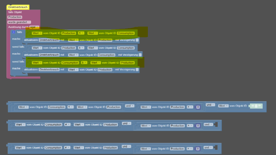

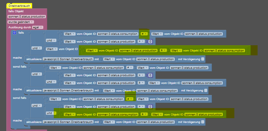

      • Cinimod
        Cinimod Most Active @Steinmetz_4 last edited by Cinimod
        @steinmetz_4
        Du hast da nen Fehler drin:
        mach es mal so :
        Ob das dein Problem löst weiß ich nicht, aber das würde ich erstmal in Ordnung bringen

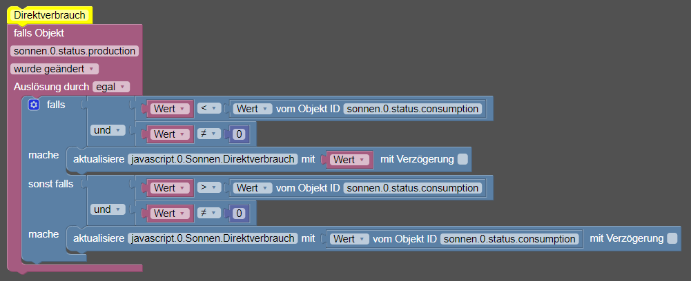

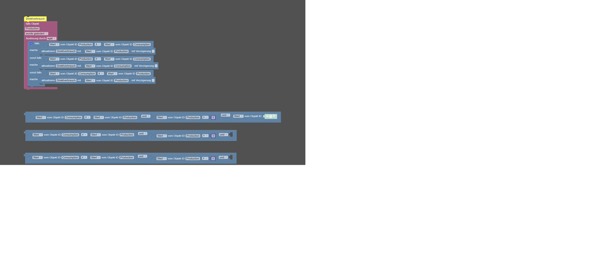

        • Cinimod
          @steinmetz_4 sagte in [Fehlermeldung warum?]
          Du fragst auch im ersten und dritten Bereich exakt das selbe ab ! Hast es nur rum gedreht.
          Und die "falls ungleich" abfrage ist auch Unsinn wenn du bei "<=" und bei ">=" eine Änderung haben willst .... und du solltest dann auch nur einmal "<=" oder ">=" benutzen, denn sonst will er beide ausführen wenn die Werte dann gleich sind ... nimm einmal nur ">" bzw. "<".
          Vorschlag:

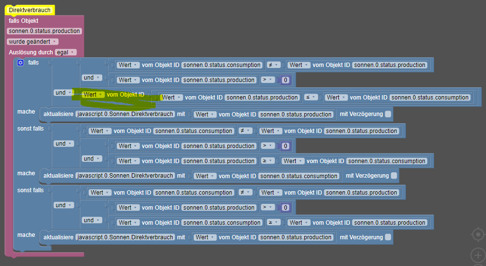

            Steinmetz_4 @Cinimod last edited by
            @cinimod In Blockly sieht das so aus:
            Es ist etwas verwirrend, da es viele Werte sein müssen.
            • Cinimod
              @steinmetz_4
              ich kenne dein blockly script, habe es doch bereits gepostet hier ...
              hast du meine Nachricht überhaut gelesen ?
              möchtest du meinen Vorschlag mal testen ?
                @cinimod ja, hab ich und mach ich. Hab nur im Moment nicht die Zeit. Wird aber die nächsten Tage ausprobiert.
                Danke schon mal.
                Cinimod 2 Replies Last reply Reply Quote 0
                • Cinimod
                  @steinmetz_4
                  Ok viel Erfolg, gerne Rückmeldung

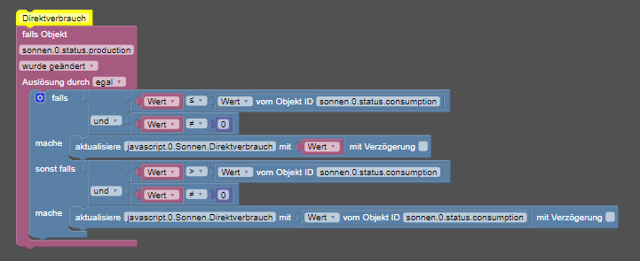

                  • Cinimod
                    @steinmetz_4
                    besser noch du nimmst nur die < und > klammer, denn wenn Consumption = Produktion ist möchtest du ja keine Änderung des Direktverbrauch richtig ? Dann sparst du dir schon mal überall die frage der Ungleichheit, denn es tut sich nur was wenn größer oder kleiner, und nicht wenn gleich.
                    Kannst dein nachgebautes Skript gern noch mal zeigen, wenn du Probleme hast. Via PN ist unpraktisch

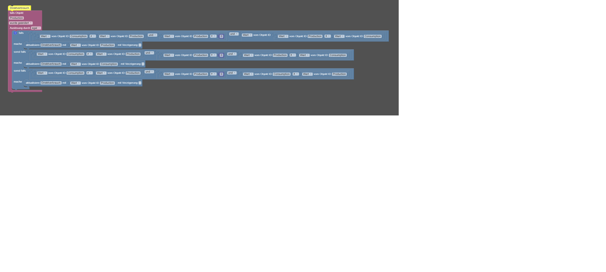

                      @cinimod
                      Ich habs jetzt mal so gemacht:
                      Bisher keine Fehler...
                      • Cinimod
                        @steinmetz_4
                        du fragst aber schon wieder zwei mal genau das selbe ab:
                          @cinimod
                          Da hast Du wieder recht... 😁
