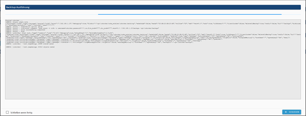

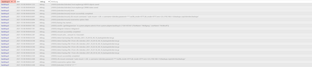

              Wie soll ich dir den Lauf von Backitup erstellen??
              Die beiden hatte ich vor 3 Tagen gemacht.
                Thomas Braun Most Active @McWoolf last edited by
                @mcwoolf sagte in Backitup erstellt keine Backups mehr:
                Jedenfalls nicht als verwaschenen Screenshot.
                Aus dem Log File entnehmen.
                iobroker logs --watch
                oder aus dem PopUp den Text herauskopieren.
                McWoolf 1 Reply Last reply Reply Quote 0

                  Hier aus der Console
                  2021-10-11 11:24:10.137 - debug: backitup.0 (6517) Backup has started ...
                  2021-10-11 11:24:20.138 - debug: backitup.0 (6517) [iobroker/mount] noserverino option: false
                  2021-10-11 11:24:20.139 - debug: backitup.0 (6517) [iobroker/mount] cifs-mount command: "sudo mount -t cifs -o username=iobroker,password=,rw,file_mode=0777,dir_mode=0777,vers=3.0 //192.168.1.15/backups /opt/iobroker/backups"
                  2021-10-11 11:24:20.529 - debug: backitup.0 (6517) [iobroker/mount] mount successfully completed
                  2021-10-11 11:24:20.531 - debug: backitup.0 (6517) [iobroker/mount] done
                  2021-10-11 11:24:30.576 - debug: backitup.0 (6517) [iobroker/iobroker] host.raspberrypi 29881 states saved
                  2021-10-11 11:24:30.927 - debug: backitup.0 (6517) [iobroker/iobroker] host.raspberrypi 40757 objects saved
                  2021-10-11 11:24:30.927 - debug: backitup.0 (6517) [iobroker/iobroker] host.raspberrypi 40757 objects saved/<
                  Hier aus dem Popup
                  Started iobroker ...
                  [DEBUG] [mount] - noserverino option: false
                  [DEBUG] [mount] - cifs-mount command: "sudo mount -t cifs -o username=iobroker,password=****,rw,file_mode=0777,dir_mode=0777,vers=3.0 //192.168.1.15/backups /opt/iobroker/backups"
                  [DEBUG] [mount] - mount successfully completed
                  [DEBUG] [mount] - done
                  [DEBUG] [iobroker] - host.raspberrypi 29881 states saved
                  [DEBUG] [iobroker] - host.raspberrypi 40757 objects saved/<
                  mehr passiert leider nicht, bei diesem Stand bleibt alles stehen.
                  Auch wenn ich das ganze 15 min laufen lasse.

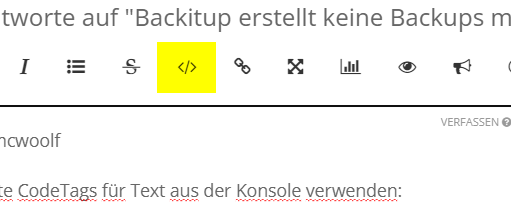

                        @mcwoolf
                        Bitte CodeTags für Text aus der Konsole verwenden:

                          2021-10-11 11:25:58.752  - error: tr-064.0 (2535) tr-064.0 already running
                          2021-10-11 11:25:58.757  - warn: tr-064.0 (2535) Terminated (ADAPTER_ALREADY_RUNNING): Without reason
                          2021-10-11 11:25:59.794  - error: host.raspberrypi instance system.adapter.tr-064.0 terminated with code 7 (ADAPTER_ALREADY_RUNNING)
                          2021-10-11 11:26:00.763  - error: hue.0 (2557) hue.0 already running
                          2021-10-11 11:26:00.767  - warn: hue.0 (2557) Terminated (ADAPTER_ALREADY_RUNNING): Without reason
                          2021-10-11 11:26:01.419  - error: host.raspberrypi instance system.adapter.hue.0 terminated with code 7 (ADAPTER_ALREADY_RUNNING)
                          2021-10-11 11:26:08.836  - warn: cloud.0 (2582) slow connection to objects DB. Still waiting ...
                          2021-10-11 11:26:09.362  - error: cloud.0 (2582) cloud.0 already running
                          2021-10-11 11:26:09.364  - warn: cloud.0 (2582) Terminated (ADAPTER_ALREADY_RUNNING): Without reason
                          2021-10-11 11:26:10.111  - error: host.raspberrypi instance system.adapter.cloud.0 terminated with code 7 (ADAPTER_ALREADY_RUNNING)
                          2021-10-11 11:26:11.547  - error: discovery.0 (2601) discovery.0 already running
                          2021-10-11 11:26:11.566  - warn: discovery.0 (2601) Terminated (ADAPTER_ALREADY_RUNNING): Without reason
                          2021-10-11 11:26:11.848  - error: fritzdect.0 (2608) fritzdect.0 already running
                          2021-10-11 11:26:11.852  - warn: fritzdect.0 (2608) Terminated (ADAPTER_ALREADY_RUNNING): Without reason
                          2021-10-11 11:26:12.243  - error: host.raspberrypi instance system.adapter.discovery.0 terminated with code 7 (ADAPTER_ALREADY_RUNNING)
                          2021-10-11 11:26:12.857  - error: host.raspberrypi instance system.adapter.fritzdect.0 terminated with code 7 (ADAPTER_ALREADY_RUNNING)
                          2021-10-11 11:26:14.891  - error: heatingcontrol.0 (2634) heatingcontrol.0 already running
                          2021-10-11 11:26:14.894  - warn: heatingcontrol.0 (2634) Terminated (ADAPTER_ALREADY_RUNNING): Without reason
                          2021-10-11 11:26:15.581  - error: host.raspberrypi instance system.adapter.heatingcontrol.0 terminated with code 7 (ADAPTER_ALREADY_RUNNING)
                          2021-10-11 11:26:21.812  - error: influxdb.0 (2655) influxdb.0 already running
                          2021-10-11 11:26:21.817  - warn: influxdb.0 (2655) Terminated (ADAPTER_ALREADY_RUNNING): Without reason
                          2021-10-11 11:26:22.819  - error: host.raspberrypi instance system.adapter.influxdb.0 terminated with code 7 (ADAPTER_ALREADY_RUNNING)
                          2021-10-11 11:26:25.817  - error: info.0 (2671) info.0 already running
                          2021-10-11 11:26:25.823  - warn: info.0 (2671) Terminated (ADAPTER_ALREADY_RUNNING): Without reason
                          2021-10-11 11:26:26.866  - error: host.raspberrypi instance system.adapter.info.0 terminated with code 7 (ADAPTER_ALREADY_RUNNING)
                          2021-10-11 11:26:27.910  - error: rpi2.0 (2686) No Value found for cpu_frequency
                          2021-10-11 11:26:28.843  - error: iot.0 (2709) iot.0 already running
                          2021-10-11 11:26:28.848  - warn: iot.0 (2709) Terminated (ADAPTER_ALREADY_RUNNING): Without reason
                          2021-10-11 11:26:29.614  - error: host.raspberrypi instance system.adapter.iot.0 terminated with code 7 (ADAPTER_ALREADY_RUNNING)
                          2021-10-11 11:26:32.948  - error: jarvis.0 (2773) jarvis.0 already running
                          2021-10-11 11:26:32.955  - warn: jarvis.0 (2773) Terminated (ADAPTER_ALREADY_RUNNING): Without reason
                          2021-10-11 11:26:33.754  - error: host.raspberrypi instance system.adapter.jarvis.0 terminated with code 7 (ADAPTER_ALREADY_RUNNING)
                          2021-10-11 11:26:39.885  - error: linkeddevices.0 (2820) linkeddevices.0 already running
                          2021-10-11 11:26:39.894  - warn: linkeddevices.0 (2820) Terminated (ADAPTER_ALREADY_RUNNING): Without reason
                          2021-10-11 11:26:40.225  - error: linux-control.0 (2845) linux-control.0 already running
                          2021-10-11 11:26:40.230  - warn: linux-control.0 (2845) Terminated (ADAPTER_ALREADY_RUNNING): Without reason
                          2021-10-11 11:26:40.586  - error: host.raspberrypi instance system.adapter.linkeddevices.0 terminated with code 7 (ADAPTER_ALREADY_RUNNING)
                          2021-10-11 11:26:40.906  - error: host.raspberrypi instance system.adapter.linux-control.0 terminated with code 7 (ADAPTER_ALREADY_RUNNING)
                          2021-10-11 11:26:47.309  - error: ring.0 (2876) ring.0 already running
                          2021-10-11 11:26:47.313  - warn: ring.0 (2876) Terminated (ADAPTER_ALREADY_RUNNING): Without reason
                          2021-10-11 11:26:48.526  - warn: javascript.0 (2563) Please delete file /opt/iobroker/backups/Warnungen/Bewegung_festgestellt
                          2021-10-11 11:26:49.305  - error: host.raspberrypi instance system.adapter.ring.0 terminated with code 7 (ADAPTER_ALREADY_RUNNING)
                          2021-10-11 11:26:49.741  - error: scenes.0 (2923) scenes.0 already running
                          2021-10-11 11:26:49.745  - warn: scenes.0 (2923) Terminated (ADAPTER_ALREADY_RUNNING): Without reason
                          2021-10-11 11:26:50.791  - error: host.raspberrypi instance system.adapter.scenes.0 terminated with code 7 (ADAPTER_ALREADY_RUNNING)
                          2021-10-11 11:26:53.475  - error: shelly.0 (2953) shelly.0 already running
                          2021-10-11 11:26:53.479  - warn: shelly.0 (2953) Terminated (ADAPTER_ALREADY_RUNNING): Without reason
                          2021-10-11 11:26:53.484  - error: cloud.0 (2865) Cloud says: timeout
                          2021-10-11 11:26:54.237  - error: host.raspberrypi instance system.adapter.shelly.0 terminated with code 7 (ADAPTER_ALREADY_RUNNING)
                          2021-10-11 11:26:57.007  - error: sony-bravia.0 (2974) sony-bravia.0 already running
                          2021-10-11 11:26:57.019  - warn: sony-bravia.0 (2974) Terminated (ADAPTER_ALREADY_RUNNING): Without reason
                          2021-10-11 11:26:58.233  - error: host.raspberrypi instance system.adapter.sony-bravia.0 terminated with code 7 (ADAPTER_ALREADY_RUNNING)
                          2021-10-11 11:27:00.594  - error: unifi.0 (2997) unifi.0 already running
                          2021-10-11 11:27:00.607  - warn: unifi.0 (2997) Terminated (ADAPTER_ALREADY_RUNNING): Without reason
                          2021-10-11 11:27:02.272  - error: host.raspberrypi instance system.adapter.unifi.0 terminated with code 7 (ADAPTER_ALREADY_RUNNING)
                          2021-10-11 11:27:07.496  - error: velux.0 (3034) velux.0 already running
                          2021-10-11 11:27:07.520  - warn: velux.0 (3034) Terminated (ADAPTER_ALREADY_RUNNING): Without reason
                          2021-10-11 11:27:09.331  - warn: jarvis.0 (3045) slow connection to states DB. Still waiting ...
                          2021-10-11 11:27:10.313  - error: host.raspberrypi instance system.adapter.velux.0 terminated with code 7 (ADAPTER_ALREADY_RUNNING)
                          2021-10-11 11:27:10.384  - error: vis-inventwo.0 (3060) vis-inventwo.0 already running
                          2021-10-11 11:27:10.388  - warn: vis-inventwo.0 (3060) Terminated (ADAPTER_ALREADY_RUNNING): Without reason
                          2021-10-11 11:27:11.374  - error: host.raspberrypi instance system.adapter.vis-inventwo.0 terminated with code 7 (ADAPTER_ALREADY_RUNNING)
                          2021-10-11 11:27:16.504  - error: web.0 (3129) web.0 already running
                          2021-10-11 11:27:16.509  - warn: web.0 (3129) Terminated (ADAPTER_ALREADY_RUNNING): Without reason
                          2021-10-11 11:27:17.491  - error: host.raspberrypi instance system.adapter.web.0 terminated with code 7 (ADAPTER_ALREADY_RUNNING)
                          2021-10-11 11:27:20.290  - error: yahka.0 (3170) yahka.0 already running
                          2021-10-11 11:27:20.296  - warn: yahka.0 (3170) Terminated (ADAPTER_ALREADY_RUNNING): Without reason
                          2021-10-11 11:27:21.171  - error: host.raspberrypi instance system.adapter.yahka.0 terminated with code 7 (ADAPTER_ALREADY_RUNNING)
                          2021-10-11 11:27:23.199  - error: cloud.0 (2865) Cloud says: timeout
                          2021-10-11 11:27:23.986  - debug: backitup.0 (3477) Redis Objects: Use Redis connection: 127.0.0.1:9001
                          2021-10-11 11:27:24.223  - debug: backitup.0 (3477) Objects client ready ... initialize now
                          2021-10-11 11:27:24.322  - debug: backitup.0 (3477) Objects create System PubSub Client
                          2021-10-11 11:27:24.324  - debug: backitup.0 (3477) Objects create User PubSub Client
                          2021-10-11 11:27:24.326  - debug: backitup.0 (3477) Objects client initialize lua scripts
                          2021-10-11 11:27:24.434  - debug: backitup.0 (3477) Objects connected to redis: 127.0.0.1:9001
                          2021-10-11 11:27:24.454  - debug: backitup.0 (3477) objectDB connected
                          2021-10-11 11:27:24.459  - debug: backitup.0 (3477) Redis States: Use Redis connection: 127.0.0.1:9000
                          2021-10-11 11:27:24.605  - info: host.raspberrypi instance system.adapter.shelly.0 started with pid 3520
                          2021-10-11 11:27:24.639  - debug: backitup.0 (3477) States create System PubSub Client
                          2021-10-11 11:27:24.643  - debug: backitup.0 (3477) States create User PubSub Client
                          2021-10-11 11:27:24.726  - debug: backitup.0 (3477) States connected to redis: 127.0.0.1:9000
                          2021-10-11 11:27:24.727  - debug: backitup.0 (3477) statesDB connected
                          2021-10-11 11:27:24.764  - error: backitup.0 (3477) backitup.0 already running
                          2021-10-11 11:27:24.766  - debug: backitup.0 (3477) Plugin sentry destroyed
                          2021-10-11 11:27:24.767  - warn: backitup.0 (3477) Terminated (ADAPTER_ALREADY_RUNNING): Without reason
                          2021-10-11 11:27:25.579  - error: host.raspberrypi instance system.adapter.backitup.0 terminated with code 7 (ADAPTER_ALREADY_RUNNING)
                          2021-10-11 11:27:58.178  - debug: backitup.0 (3967) Redis Objects: Use Redis connection: 127.0.0.1:9001
                          2021-10-11 11:27:58.306  - debug: backitup.0 (3967) Objects client ready ... initialize now
                          2021-10-11 11:27:58.322  - debug: backitup.0 (3967) Objects create System PubSub Client
                          2021-10-11 11:27:58.324  - debug: backitup.0 (3967) Objects create User PubSub Client
                          2021-10-11 11:27:58.326  - debug: backitup.0 (3967) Objects client initialize lua scripts
                          2021-10-11 11:27:58.425  - debug: backitup.0 (3967) Objects connected to redis: 127.0.0.1:9001
                          2021-10-11 11:27:58.439  - debug: backitup.0 (3967) objectDB connected
                          2021-10-11 11:27:58.442  - debug: backitup.0 (3967) Redis States: Use Redis connection: 127.0.0.1:9000
                          2021-10-11 11:27:58.929  - debug: backitup.0 (3967) States create System PubSub Client
                          2021-10-11 11:27:58.932  - debug: backitup.0 (3967) States create User PubSub Client
                          2021-10-11 11:27:59.035  - debug: backitup.0 (3967) States connected to redis: 127.0.0.1:9000
                          2021-10-11 11:27:59.036  - debug: backitup.0 (3967) statesDB connected
                          2021-10-11 11:28:06.768  - debug: backitup.0 (3967) Plugin sentry Initialize Plugin (enabled=true)
                          2021-10-11 11:28:07.861  - debug: backitup.0 (3967) noserverino option: false
                          2021-10-11 11:28:07.863  - debug: backitup.0 (3967) cifs-mount command: "sudo mount -t cifs -o username=iobroker,password=****,rw,file_mode=0777,dir_mode=0777,vers=3.0 //192.168.1.15/backups /opt/iobroker/backups"
                          2021-10-11 11:28:07.955  - debug: backitup.0 (3967) first mount attempt with smb option failed. try next mount attempt without smb option ...
                          2021-10-11 11:28:07.956  - debug: backitup.0 (3967) cifs-mount command: "sudo mount -t cifs -o username=iobroker,password=****,rw,file_mode=0777,dir_mode=0777 //192.168.1.15/backups /opt/iobroker/backups"
                          2021-10-11 11:28:08.370  - debug: backitup.0 (3967) mount successfully completed
                          2021-10-11 11:28:10.387  - debug: backitup.0 (3967) detect backup file 1 from cifs: iobroker_2021_09_30-02_40_16_backupiobroker.tar.gz
                          2021-10-11 11:28:10.388  - debug: backitup.0 (3967) detect backup file 2 from cifs: iobroker_2021_10_01-02_40_16_backupiobroker.tar.gz
                          2021-10-11 11:28:10.388  - debug: backitup.0 (3967) detect backup file 3 from cifs: iobroker_2021_10_02-02_40_16_backupiobroker.tar.gz
                          2021-10-11 11:28:10.389  - debug: backitup.0 (3967) detect backup file 4 from cifs: iobroker_2021_10_03-02_40_16_backupiobroker.tar.gz
                          2021-10-11 11:28:10.390  - debug: backitup.0 (3967) detect backup file 5 from cifs: iobroker_2021_10_04-02_40_16_backupiobroker.tar.gz
                          2021-10-11 11:28:10.391  - debug: backitup.0 (3967) detect last backup file: iobroker_2021_10_04-02_40_16_backupiobroker.tar.gz
                          10-11 11:28:17.669  - debug: backitup.0 (3967) mount activ... umount in 2 Seconds!!
                          2021-10-11 11:31:55.410  - debug: backitup.0 (3967) system.adapter.admin.0: logging true
                          2021-10-11 11:31:56.317  -
