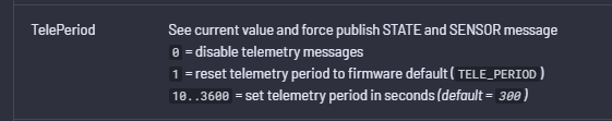

                      Quelle: https://tasmota.github.io/docs/Commands/
                      TelePeriod See current value and force publish STATE and SENSOR message
                      0 = disable telemetry messages
                      1 = reset telemetry period to firmware default (TELE_PERIOD)
                      10..3600 = set telemetry period in seconds (default = 300)
