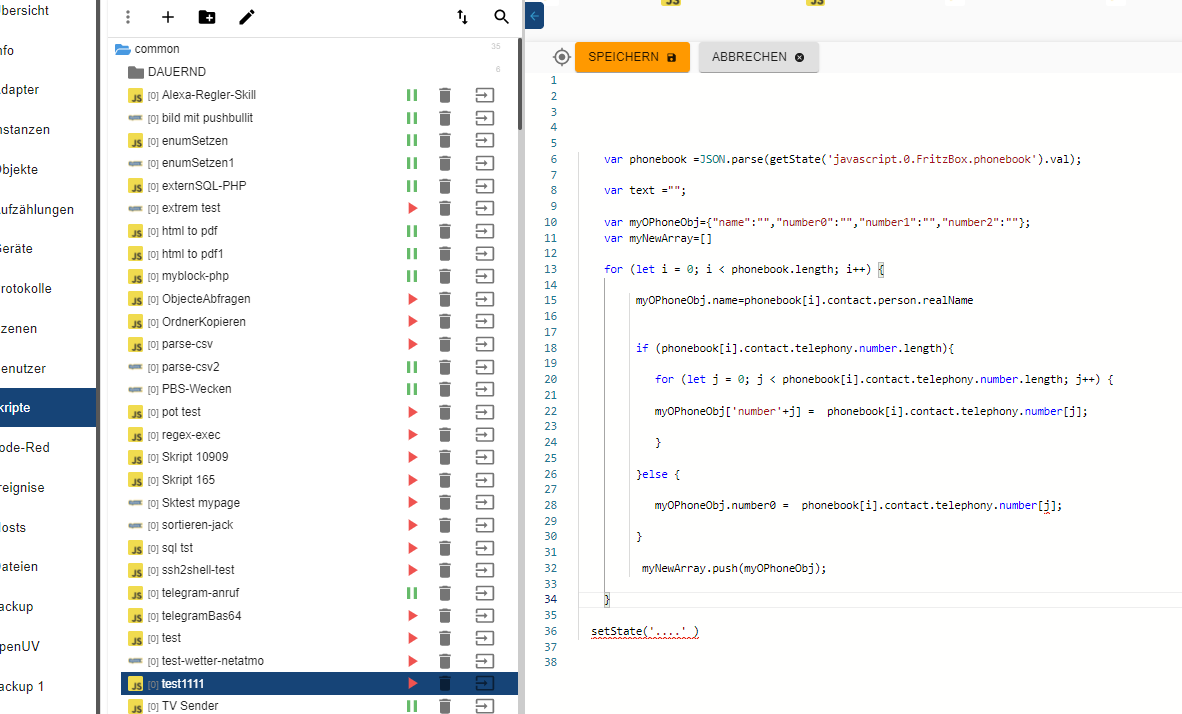

                    hier mal ein entwurf - wird wahrscheinlich noch nicht ganz ok sein - aber der grundstock steht
                            var phonebook =JSON.parse(getState('javascript.0.FritzBox.phonebook').val);
                            var text ="";
                            var myOPhoneObj={"name":"","number0":"","number1":"","number2":""};
                            var myNewArray=[]
                            for (let i = 0; i < phonebook.length; i++) {
                                 myOPhoneObj.name=phonebook[i].contact.person.realName
                                 if (phonebook[i].contact.telephony.number.length){
                                    for (let j = 0; j < phonebook[i].contact.telephony.number.length; j++) {
                                    myOPhoneObj['number'+j] =  phonebook[i].contact.telephony.number[j];
                                 }else {
                                    myOPhoneObj.number0 =  phonebook[i].contact.telephony.number[j];
                                  myNewArray.push(myOPhoneObj);
                          setState('....' )
                    J D3ltoroxp 2 Replies Last reply Reply Quote 0
                      jampr @liv-in-sky last edited by
                      @liv-in-sky
                      Super, danke. Ich muss mir dann mal das inventwo json widget anschauen. Hab das noch nie vorher benutzt.
