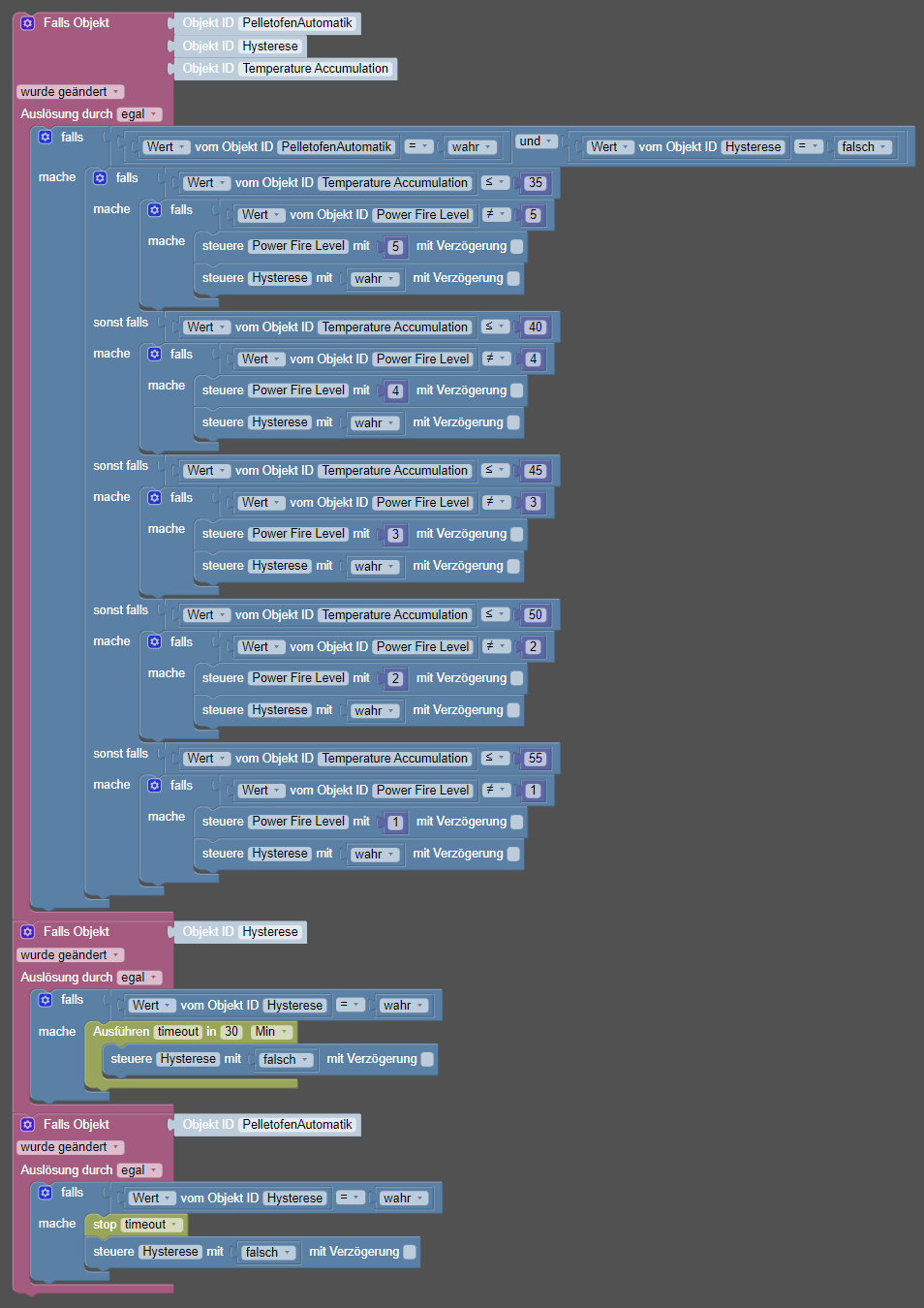

      ich bastle mir gerade ein BlocklyScript um die Leistungsstufen meines Pelletofens automatisch anzupassen.
      Leider kommt beim Starten des Scripts o.g. Fehler und ich hab keine Ahnung woran er sich stören könnte.
      Das hier steht im Log:
      javascript.0
      2021-11-08 13:33:49.970	error	at processImmediate (internal/timers.js:463:21)
      javascript.0
      2021-11-08 13:33:49.970	error	at Immediate._onImmediate (/opt/iobroker/node_modules/iobroker.javascript/main.js:1306:17)
      javascript.0
      2021-11-08 13:33:49.970	error	at /opt/iobroker/node_modules/iobroker.javascript/main.js:1817:17
      javascript.0
      2021-11-08 13:33:49.969	error	at prepareScript (/opt/iobroker/node_modules/iobroker.javascript/main.js:1716:37)
      javascript.0
      2021-11-08 13:33:49.969	error	at createVM (/opt/iobroker/node_modules/iobroker.javascript/main.js:1469:28)
      javascript.0
      2021-11-08 13:33:49.969	error	at Object.createScript (vm.js:261:10)
      javascript.0
      2021-11-08 13:33:49.969	error	at new Script (vm.js:88:7)
      javascript.0
      2021-11-08 13:33:49.968	error	SyntaxError: Invalid or unexpected token
      javascript.0
      2021-11-08 13:33:49.968	error	^^^^^^^^^
      javascript.0
      2021-11-08 13:33:49.968	error	on({id: new RegExp(getState\\("javascript\\.0\\.Pelletlager\\.PelletofenAutomatik"\\)\\.val + "$|" + getState\\("palazzetti\\.0\\.get\\.t5"\\)\\.val + "$|" + getState\\("javascript\\.0\\.Pelletlager\\.Hysterese"\\)\\.val + "$"), change: "ne"}, async function (obj) {
      javascript.0
      2021-11-08 13:33:49.967	error	script.js.Raumklima.Pelletofensteuerung compile failed: at script.js.Raumklima.Pelletofensteuerung:4
      MOD-Edit: Code in code-tags gesetzt!
      var timeout;
          if (getState("javascript.0.Pelletlager.PelletofenAutomatik").val == true) {
          if (getState("palazzetti.0.get.t5").val <= 35) {
            if (getState("palazzetti.0.control.pwr").val != 5 && getState("javascript.0.Pelletlager.Hysterese").val == true) {
              setState("palazzetti.0.control.pwr"/*Power Fire Level*/, 5);
              setState("javascript.0.Pelletlager.Hysterese"/*Hysterese*/, true);
          } else if (getState("palazzetti.0.get.t5").val <= 40) {
            if (getState("palazzetti.0.control.pwr").val != 4 && getState("javascript.0.Pelletlager.Hysterese").val == true) {
              setState("palazzetti.0.control.pwr"/*Power Fire Level*/, 4);
          } else if (getState("palazzetti.0.get.t5").val <= 45) {
            if (getState("palazzetti.0.control.pwr").val != 3 && getState("javascript.0.Pelletlager.Hysterese").val == true) {
              setState("palazzetti.0.control.pwr"/*Power Fire Level*/, 3);
          } else if (getState("palazzetti.0.get.t5").val <= 50) {
            if (getState("palazzetti.0.control.pwr").val != 2 && getState("javascript.0.Pelletlager.Hysterese").val == true) {
              setState("palazzetti.0.control.pwr"/*Power Fire Level*/, 2);
          } else if (getState("palazzetti.0.get.t5").val <= 55) {
            if (getState("palazzetti.0.control.pwr").val != 1 && getState("javascript.0.Pelletlager.Hysterese").val == true) {
              setState("palazzetti.0.control.pwr"/*Power Fire Level*/, 1);
      on({id: getState("javascript.0.Pelletlager.Hysterese").val, change: "ne"}, async function (obj) {
        var value = obj.state.val;
        if (getState("javascript.0.Pelletlager.Hysterese").val == true) {
          timeout = setTimeout(async function () {
            setState("javascript.0.Pelletlager.Hysterese"/*Hysterese*/, false);
          }, 1800000);
      on({id: getState("javascript.0.Pelletlager.PelletofenAutomatik").val, change: "ne"}, async function (obj) {
          (function () {if (timeout) {clearTimeout(timeout); timeout = null;}})();

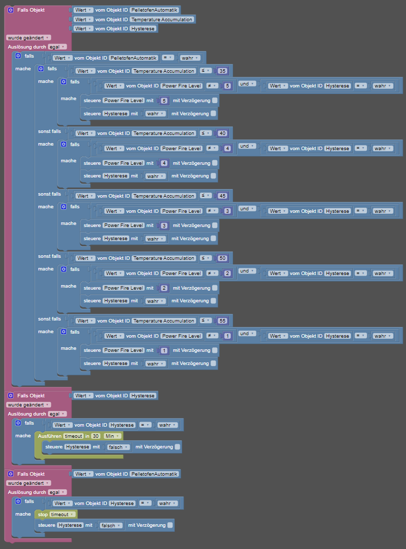

        paul53 @Rummelmug last edited by
        @rummelmug sagte: keine Ahnung woran er sich stören könnte.
        Siehe Doku
        Asgothian Rummelmug 2 Replies Last reply Reply Quote 0
        • Asgothian
          Asgothian Developer @paul53 last edited by
          @paul53 sagte in Blockly Error compile failed:
          Siehe Doku
          Kleiner Tip: Schau Dir das erste Bild in der Verlinkten Doku an. Vergleiche es mit deinem Skript. Abgesehen davon das es viel kürzer und kleiner ist gibt es da einen grossen Unterschied.
          A.
          • Rummelmug
            Rummelmug @paul53 last edited by
            Siehe Doku
            oha.. peinlich... Besten Dank 😄
            so paßt's
