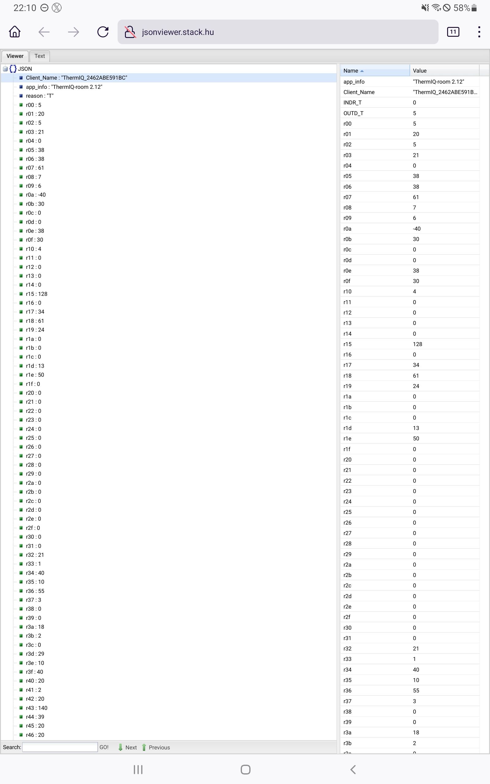

      Von meine Wärmeanlage bekomme ich via mqtt ein datenpunkt mit ein json objekt die 136 werte haben. Ich möchte am liebsten diesen json mit eine Schleife neue Datenpunkte erzeugen und updaten. Ist das mit Blockly möglich oder muss ich es in native javascript schreiben? Hat jemand ein beispiel wie man so was macht? (ich bin kein programmierer)
      Mein json:
      {"Client_Name":"ThermIQ_2462ABE591BC","app_info":"ThermIQ-room 2.12","reason":"T","r00":5,"r01":20,"r02":5,"r03":21,"r04":0,"r05":38,"r06":38,"r07":61,"r08":7,"r09":6,"r0a":-40,"r0b":30,"r0c":0,"r0d":0,"r0e":38,"r0f":30,"r10":4,"r11":0,"r12":0,"r13":0,"r14":0,"r15":128,"r16":0,"r17":34,"r18":61,"r19":24,"r1a":0,"r1b":0,"r1c":0,"r1d":13,"r1e":50,"r1f":0,"r20":0,"r21":0,"r22":0,"r23":0,"r24":0,"r25":0,"r26":0,"r27":0,"r28":0,"r29":0,"r2a":0,"r2b":0,"r2c":0,"r2d":0,"r2e":0,"r2f":0,"r30":0,"r31":0,"r32":21,"r33":1,"r34":40,"r35":10,"r36":55,"r37":3,"r38":0,"r39":0,"r3a":18,"r3b":2,"r3c":0,"r3d":29,"r3e":10,"r3f":40,"r40":20,"r41":2,"r42":20,"r43":140,"r44":39,"r45":20,"r46":20,"r47":7,"r48":60,"r49":150,"r4a":10,"r4b":55,"r4c":20,"r4d":-15,"r4e":18,"r4f":70,"r50":20,"r51":0,"r52":20,"r53":60,"r54":60,"r55":0,"r56":0,"r57":0,"r58":0,"r59":0,"r5a":0,"r5b":1,"r5c":0,"r5d":0,"r5e":0,"r5f":-1,"r60":0,"r61":32,"r62":68,"r63":1,"r64":3,"r65":3,"r66":0,"r67":0,"r68":24302,"r69":-8098,"r6a":3808,"r6b":-10482,"r6c":727,"r6d":2,"r6e":0,"r6f":0,"r70":0,"r71":-30208,"r72":2442,"r73":9,"r74":0,"r75":0,"r76":0,"r77":0,"r78":0,"r79":0,"r7a":0,"r7b":0,"r7c":0,"r7d":2,"r7e":2,"r7f":2,"INDR_T": 0.0,"OUTD_T": 5.0,"TRGT_T": 21.0, "time": "2021-10-31 23:13:09 CET","timestamp": 1635718389 }

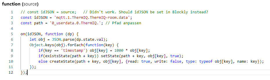

                    @videonisse sagte in Aus JSON 136 Datenpunkte erzeugen:
                    Oder muss ich das separat machen?
                    Ja, als erstes in der Schleife:
                            if(key == 'timestamp') obj[key] = 1000 * obj[key];
                    • V
                      Videonisse @paul53 last edited by
                      @paul53 Danke, funktioniert natürlich gut!
                      Du hast recht, es ist schon in Linux Format (seconds), aber ich brauche es in Javascript Format (milliseconds). Ich weiß aber nicht, ob das noch richtigist, wollte Object/State Role = Datum haben. Dann muss es angeblich in milliseconds sein.
                      "date (common.type = number - epoch seconds * 1000" Source

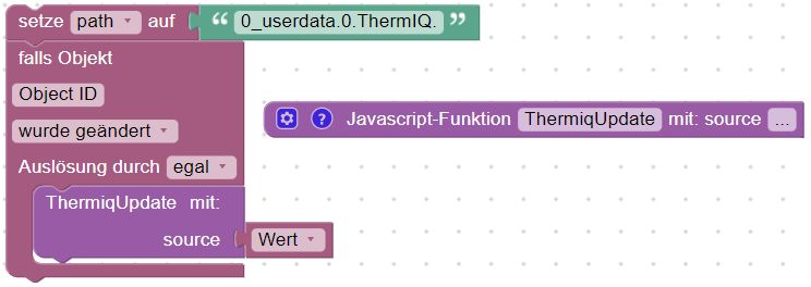

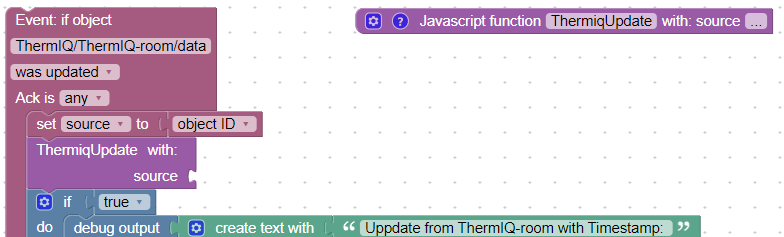

                      Ich möchte auch gern die Variable "idJSON" in Blockly setzen aber verstehe nicht wie ich dass richtig mache.
                      Kann ich irgenwie die Variabel "object ID" von den Trigger benutzen? Ich habe mit unten probiert aber geht nicht.
                        paul53 @Videonisse last edited by paul53
                        @videonisse sagte: Kann ich irgenwie die Variabel "object ID" von den Trigger benutzen?
                        Der Block ist schon richtig, aber "value" (oder so ähnlich) selektieren.
                        Wenn schon mit Blockly, dann
                        Inhalt der Funktion ThermiqUpdate(source):
                        let obj = JSON.parse(source);
                        Object.keys(obj).forEach(function(key) {
                            if(existsState(path + key)) setState(path + key, obj[key], true);
                            else createState(path + key, obj[key], {read: true, write: false, type: typeof obj[key], name: key});
                        • V
