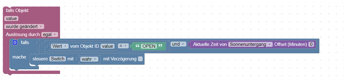

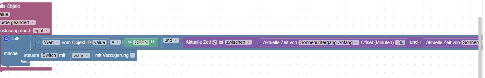

      ich versuche wie verrückt einzustellen, dass wenn die Tür öffnet - bei Sonnenuntergang - dass das Licht angeht und das solange bis die Sonne wieder aufgeht.
      on({id: "bshb.0.hdm:HomeMaticIP:3014F711A000009A1859781C.ShutterContact.value"/*value*/, change: "ne"}, async function (obj) {
        var value = obj.state.val;
        if (getState("bshb.0.hdm:HomeMaticIP:3014F711A000009A1859781C.ShutterContact.value").val == 'OPEN' && compareTime(getAstroDate("sunsetStart", undefined, -30), getAstroDate("sunrise", undefined, 0), "between", null)) {
          setState("shelly.0.SHSW-1#76935D#1.Relay0.Switch"/*Switch*/, true);
      //JTNDeG1sJTIweG1sbnMlM0QlMjJodHRwcyUzQSUyRiUyRmRldmVsb3BlcnMuZ29vZ2xlLmNvbSUyRmJsb2NrbHklMkZ4bWwlMjIlM0UlM0NibG9jayUyMHR5cGUlM0QlMjJvbiUyMiUyMGlkJTNEJTIyejBtRVNqUn40aiU1RHlDQ3VmJTNGVHF3JTIyJTIweCUzRCUyMi0xMjYyJTIyJTIweSUzRCUyMi0xMDM3JTIyJTNFJTNDZmllbGQlMjBuYW1lJTNEJTIyT0lEJTIyJTNFYnNoYi4wLmhkbSUzQUhvbWVNYXRpY0lQJTNBMzAxNEY3MTFBMDAwMDA5QTE4NTk3ODFDLlNodXR0ZXJDb250YWN0LnZhbHVlJTNDJTJGZmllbGQlM0UlM0NmaWVsZCUyMG5hbWUlM0QlMjJDT05ESVRJT04lMjIlM0VuZSUzQyUyRmZpZWxkJTNFJTNDZmllbGQlMjBuYW1lJTNEJTIyQUNLX0NPTkRJVElPTiUyMiUzRSUzQyUyRmZpZWxkJTNFJTNDc3RhdGVtZW50JTIwbmFtZSUzRCUyMlNUQVRFTUVOVCUyMiUzRSUzQ2Jsb2NrJTIwdHlwZSUzRCUyMmNvbnRyb2xzX2lmJTIyJTIwaWQlM0QlMjItQUFpTzNXISU2MCU2MFRVMyUzRFIlM0ElNjBJdGYlMjIlM0UlM0N2YWx1ZSUyMG5hbWUlM0QlMjJJRjAlMjIlM0UlM0NibG9jayUyMHR5cGUlM0QlMjJsb2dpY19vcGVyYXRpb24lMjIlMjBpZCUzRCUyMjdvU05Ya294eCU3QzNCTSUzQjFJMiElM0FBJTIyJTNFJTNDZmllbGQlMjBuYW1lJTNEJTIyT1AlMjIlM0VBTkQlM0MlMkZmaWVsZCUzRSUzQ3ZhbHVlJTIwbmFtZSUzRCUyMkElMjIlM0UlM0NibG9jayUyMHR5cGUlM0QlMjJsb2dpY19jb21wYXJlJTIyJTIwaWQlM0QlMjI5a0dZV21zJTJCIUVYdyU1QmolNURsWjB4eSUyMiUzRSUzQ2ZpZWxkJTIwbmFtZSUzRCUyMk9QJTIyJTNFRVElM0MlMkZmaWVsZCUzRSUzQ3ZhbHVlJTIwbmFtZSUzRCUyMkElMjIlM0UlM0NibG9jayUyMHR5cGUlM0QlMjJnZXRfdmFsdWUlMjIlMjBpZCUzRCUyMkclM0FqbEYqS3FQJTVFbkdRXy0zVnd6SCUyMiUzRSUzQ2ZpZWxkJTIwbmFtZSUzRCUyMkFUVFIlMjIlM0V2YWwlM0MlMkZmaWVsZCUzRSUzQ2ZpZWxkJTIwbmFtZSUzRCUyMk9JRCUyMiUzRWJzaGIuMC5oZG0lM0FIb21lTWF0aWNJUCUzQTMwMTRGNzExQTAwMDAwOUExODU5NzgxQy5TaHV0dGVyQ29udGFjdC52YWx1ZSUzQyUyRmZpZWxkJTNFJTNDJTJGYmxvY2slM0UlM0MlMkZ2YWx1ZSUzRSUzQ3ZhbHVlJTIwbmFtZSUzRCUyMkIlMjIlM0UlM0NibG9jayUyMHR5cGUlM0QlMjJ0ZXh0JTIyJTIwaWQlM0QlMjJmUiUzRG8lNUJvJTNEUHAlMkZiMXhQX2d3JTI1TW4lMjIlM0UlM0NmaWVsZCUyMG5hbWUlM0QlMjJURVhUJTIyJTNFT1BFTiUzQyUyRmZpZWxkJTNFJTNDJTJGYmxvY2slM0UlM0MlMkZ2YWx1ZSUzRSUzQyUyRmJsb2NrJTNFJTNDJTJGdmFsdWUlM0UlM0N2YWx1ZSUyMG5hbWUlM0QlMjJCJTIyJTNFJTNDYmxvY2slMjB0eXBlJTNEJTIydGltZV9jb21wYXJlX2V4JTIyJTIwaWQlM0QlMjI5aCU3RF8ha3lwbFVhdzR5UCU1RU1+TWwlMjIlM0UlM0NtdXRhdGlvbiUyMHhtbG5zJTNEJTIyaHR0cCUzQSUyRiUyRnd3dy53My5vcmclMkYxOTk5JTJGeGh0bWwlMjIlMjBlbmRfdGltZSUzRCUyMnRydWUlMjIlMjBhY3R1YWxfdGltZSUzRCUyMnRydWUlMjIlM0UlM0MlMkZtdXRhdGlvbiUzRSUzQ2ZpZWxkJTIwbmFtZSUzRCUyMlVTRV9BQ1RVQUxfVElNRSUyMiUzRVRSVUUlM0MlMkZmaWVsZCUzRSUzQ2ZpZWxkJTIwbmFtZSUzRCUyMk9QVElPTiUyMiUzRWJldHdlZW4lM0MlMkZmaWVsZCUzRSUzQ3ZhbHVlJTIwbmFtZSUzRCUyMlNUQVJUX1RJTUUlMjIlM0UlM0NzaGFkb3clMjB0eXBlJTNEJTIydGV4dCUyMiUyMGlkJTNEJTIyJTNCU3JGWCUyNDMlMjRUTXMwJTdEcjF6RzYlMjQlNUQlMjIlM0UlM0NmaWVsZCUyMG5hbWUlM0QlMjJURVhUJTIyJTNFMTIlM0EwMCUzQyUyRmZpZWxkJTNFJTNDJTJGc2hhZG93JTNFJTNDYmxvY2slMjB0eXBlJTNEJTIydGltZV9hc3RybyUyMiUyMGlkJTNEJTIyV1RqQmF+KColMjQ5aTlxJTJCKlF5cyUyNCUyMyUyMiUzRSUzQ2ZpZWxkJTIwbmFtZSUzRCUyMlRZUEUlMjIlM0VzdW5zZXRTdGFydCUzQyUyRmZpZWxkJTNFJTNDZmllbGQlMjBuYW1lJTNEJTIyT0ZGU0VUJTIyJTNFLTMwJTNDJTJGZmllbGQlM0UlM0MlMkZibG9jayUzRSUzQyUyRnZhbHVlJTNFJTNDdmFsdWUlMjBuYW1lJTNEJTIyRU5EX1RJTUUlMjIlM0UlM0NzaGFkb3clMjB0eXBlJTNEJTIydGV4dCUyMiUyMGlkJTNEJTIyJTNBTUVWeCU0MCUzRllMJTdDTDNyKVBpa1YlM0R4JTIyJTNFJTNDZmllbGQlMjBuYW1lJTNEJTIyVEVYVCUyMiUzRTE4JTNBMDAlM0MlMkZmaWVsZCUzRSUzQyUyRnNoYWRvdyUzRSUzQ2Jsb2NrJTIwdHlwZSUzRCUyMnRpbWVfYXN0cm8lMjIlMjBpZCUzRCUyMlQlN0R5VEZSRG1SWm0lM0YxZiU0ME1vSDZJJTIyJTNFJTNDZmllbGQlMjBuYW1lJTNEJTIyVFlQRSUyMiUzRXN1bnJpc2UlM0MlMkZmaWVsZCUzRSUzQ2ZpZWxkJTIwbmFtZSUzRCUyMk9GRlNFVCUyMiUzRTAlM0MlMkZmaWVsZCUzRSUzQyUyRmJsb2NrJTNFJTNDJTJGdmFsdWUlM0UlM0MlMkZibG9jayUzRSUzQyUyRnZhbHVlJTNFJTNDJTJGYmxvY2slM0UlM0MlMkZ2YWx1ZSUzRSUzQ3N0YXRlbWVudCUyMG5hbWUlM0QlMjJETzAlMjIlM0UlM0NibG9jayUyMHR5cGUlM0QlMjJjb250cm9sJTIyJTIwaWQlM0QlMjIlM0FsLilaam1TJTdEZCUyM2NKOHFRUE9KUyUyMiUzRSUzQ211dGF0aW9uJTIweG1sbnMlM0QlMjJodHRwJTNBJTJGJTJGd3d3LnczLm9yZyUyRjE5OTklMkZ4aHRtbCUyMiUyMGRlbGF5X2lucHV0JTNEJTIyZmFsc2UlMjIlM0UlM0MlMkZtdXRhdGlvbiUzRSUzQ2ZpZWxkJTIwbmFtZSUzRCUyMk9JRCUyMiUzRXNoZWxseS4wLlNIU1ctMSUyMzc2OTM1RCUyMzEuUmVsYXkwLlN3aXRjaCUzQyUyRmZpZWxkJTNFJTNDZmllbGQlMjBuYW1lJTNEJTIyV0lUSF9ERUxBWSUyMiUzRUZBTFNFJTNDJTJGZmllbGQlM0UlM0N2YWx1ZSUyMG5hbWUlM0QlMjJWQUxVRSUyMiUzRSUzQ2Jsb2NrJTIwdHlwZSUzRCUyMmxvZ2ljX2Jvb2xlYW4lMjIlMjBpZCUzRCUyMjNsdTdyQTJEMHg4JTYwJTdCN2QlMjVpJTJDLi4lMjIlM0UlM0NmaWVsZCUyMG5hbWUlM0QlMjJCT09MJTIyJTNFVFJVRSUzQyUyRmZpZWxkJTNFJTNDJTJGYmxvY2slM0UlM0MlMkZ2YWx1ZSUzRSUzQyUyRmJsb2NrJTNFJTNDJTJGc3RhdGVtZW50JTNFJTNDJTJGYmxvY2slM0UlM0MlMkZzdGF0ZW1lbnQlM0UlM0MlMkZibG9jayUzRSUzQyUyRnhtbCUzRQ==
      Ich habe auch schon die Astro Datensätze in den Objekten drin, allerdings weiß ich nicht wie ich blockly damit ansteuere.
      Hat jemand einen Tipp?

        Homoran Global Moderator Administrators @JB1985 last edited by
        @jb1985 setz mal einen debug Baustein über das falls, in dem du den Wert von value anzeigen lässt
        außerdem darf ein Astroereignis nicht tagesübergreifend sein, also muss es hier heißen
        NICHT zwischen sonnen auf und sonnenuntergang

                      Jetzt geht das Licht jetzt sogar an. Als würde die Astrozeit gar nicht interessieren. Weil Sonnenuntergang ist ja noch nicht.

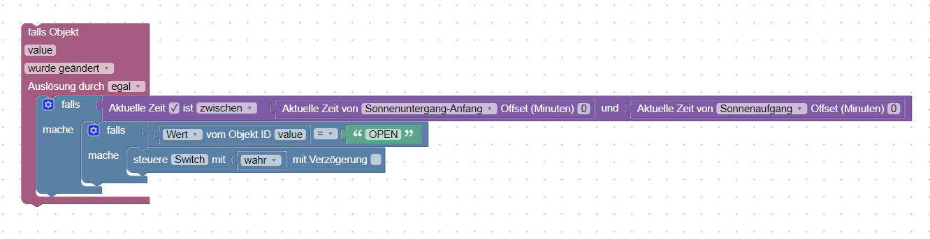

                          So, ich denke so wird das funktionieren!
                              @jb1985 sagte in Wenn Tür auf (Astro) dann Licht an:
                              nein!
                              NICHT zwischen Aufgang und Untergang

                                JB1985 @Homoran last edited by
                                @homoran andersrum hatte ich gerade funktioniert. Das Licht ist (Tagsüber) angegangen, also Aufgang und Untergang.
                                Sollte somit Aufgang und Untergang bei Dunkelheit das Licht einschalten.

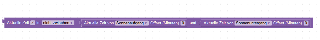

                                  das habe ich schon verstanden nur
                                  @homoran sagte in Wenn Tür auf (Astro) dann Licht an:
                                  JB1985 1 Reply Last reply Reply Quote 0
                                  • JB1985
                                    @homoran mache ich das ohne "zwischen" funktioniert es gar nicht.
                                    Ich werde es mal heute Abend testen.
                                      natürlich brauchst du eine Logik.
                                      Einfach die Uhrzeit des Sonnenuntergangs anzugeben bringt nix.
                                      Zwischen ist auch richtig!
                                      aber nicht Sonnenuntergang (heute) und Sonnenaufgang(ebenfalls heute)
                                      Was du willst ist heute auf die Zeit von Morgen zuzugreifen, das geht nicht.
                                      Das geht nur mit
                                      JB1985 1 Reply Last reply Reply Quote 1
                                        @homoran Cool Danke! Habe ich gemacht und werde es mal heute Abend testen.
                                        • JB1985
                                          Funktioniert, Besten Dank!
