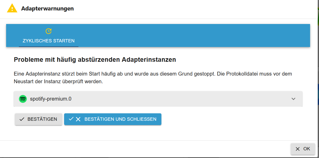

      Hallo Zusammen,
      ich konnte den Spotify Adapter eigentlich erfolgreich installieren...(grüne Instanz), aber nach einer Weile wenn ich wieder aufs Webinterface gehe kommt die Absturzmeldung 😞 was läuft da falsch?
      Über ne Info was ich da machen kann wäre ich Euch sehr dankbar.
      Gruss
        Thomas Braun Most Active last edited by
        @kusselin
        Was steht denn in der genannten Protokolldatei?

          @thomas-braun Hallo Thomas, kann ich die Protokoll auch nach dem Schliessen des Fensters noch aufrufen?
            Thomas Braun Most Active @Kusselin last edited by
            @kusselin Klar.
            less -r /opt/iobroker/log/iobroker.current.log
            Kusselin 1 Reply Last reply Reply Quote 0

                            2021-12-02 09:47:20.635  - error: spotify-premium.0 (21759) spotify status polling stopped with error Error: getaddrinfo EAI_AGAIN api.spotify.com
                            021-12-02 11:04:24.783  - info: spotify-premium.0 (21759) State value to set for "spotify-premium.0.player.playlist.tracksTotal" has to be type "string" but received type "number"
                            2021-12-02 11:04:24.935  - error: spotify-premium.0 (21759) uncaught exception: Cannot read property 'name' of undefined
                            2021-12-02 11:04:24.936  - error: spotify-premium.0 (21759) TypeError: Cannot read property 'name' of undefined
                                at Object.listenOnHtmlTracklist [as func] (/opt/iobroker/node_modules/iobroker.spotify-premium/main.js:2035:33)
                                at /opt/iobroker/node_modules/iobroker.spotify-premium/lib/cache.js:229:19
                                at Array.forEach (<anonymous>)
                                at trigger (/opt/iobroker/node_modules/iobroker.spotify-premium/lib/cache.js:223:14)
                                at Object.setExternal (/opt/iobroker/node_modules/iobroker.spotify-premium/lib/cache.js:262:5)
                                at Object.stateChange (/opt/iobroker/node_modules/iobroker.spotify-premium/main.js:56:43)
                                at Immediate.<anonymous> (/opt/iobroker/node_modules/iobroker.js-controller/lib/adapter.js:5706:41)
                                at processImmediate (internal/timers.js:461:21)
                            2021-12-02 11:04:24.936  - error: spotify-premium.0 (21759) Cannot read property 'name' of undefined
                            2021-12-02 11:04:24.984  - info: spotify-premium.0 (21759) State value to set for "spotify-premium.0.player.playlist.trackNo" has to be type "number" but received type "string"
                            2021-12-02 11:04:24.991  - info: spotify-premium.0 (21759) terminating
                            2021-12-02 11:04:24.991  - warn: spotify-premium.0 (21759) Terminated (UNCAUGHT_EXCEPTION): Without reason
                            2021-12-02 11:04:25.564  - error: host.iobroker-live instance system.adapter.spotify-premium.0 terminated with code 6 (UNCAUGHT_EXCEPTION)
                            2021-12-02 11:04:25.566  - info: host.iobroker-live Restart adapter system.adapter.spotify-premium.0 because enabled
                            2021-12-02 11:04:55.591  - info: host.iobroker-live instance system.adapter.spotify-premium.0 started with pid 326
                            2021-12-02 11:04:56.716  - info: spotify-premium.0 (326) starting. Version 1.1.3 in /opt/iobroker/node_modules/iobroker.spotify-premium, node: v12.22.6, js-controller: 3.3.21
                            2021-12-02 11:04:57.504  - error: spotify-premium.0 (326) Unhandled promise rejection. This error originated either by throwing inside of an async function without a catch block, or by rejecting a promise which was not handled with .catch().
                            2021-12-02 11:04:57.504  - error: spotify-premium.0 (326) unhandled promise rejection: Cannot read property 'name' of undefined
                            2021-12-02 11:04:57.505  - error: spotify-premium.0 (326) TypeError: Cannot read property 'name' of undefined
                                at Object.setValue (/opt/iobroker/node_modules/iobroker.spotify-premium/lib/cache.js:213:13)
                                at copyState (/opt/iobroker/node_modules/iobroker.spotify-premium/main.js:435:18)
                                at /opt/iobroker/node_modules/iobroker.spotify-premium/main.js:666:37
                            2021-12-02 11:04:57.505  - error: spotify-premium.0 (326) Cannot read property 'name' of undefined
                            2021-12-02 11:04:57.509  - info: spotify-premium.0 (326) State value to set for "spotify-premium.0.player.playlist.trackNo" has to be type "number" but received type "string"
                            2021-12-02 11:04:57.516  - info: spotify-premium.0 (326) terminating
                            2021-12-02 11:04:57.517  - warn: spotify-premium.0 (326) Terminated (UNCAUGHT_EXCEPTION): Without reason
                            2021-12-02 11:04:58.115  - error: host.iobroker-live instance system.adapter.spotify-premium.0 terminated with code 6 (UNCAUGHT_EXCEPTION)
                            2021-12-02 11:04:58.116  - info: host.iobroker-live Restart adapter system.adapter.spotify-premium.0 because enabled
                              @kusselin
                              Ich kann da nix draus erkennen. Aber ich kann auch kein javascript.
                              • Kusselin
                                Kusselin @Thomas Braun last edited by
                                @thomas-braun ok trotzdem danke
                                  @kusselin
                                  Deine nodeJS-Installation 'sauber' ist würde ich vielleicht mal ein Issue anlegen.
