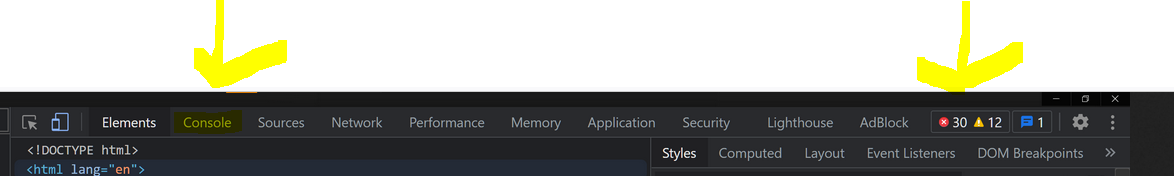

        @rushmed
        Was kommt in der Konsole bei F12?
          Rushmed Most Active @sigi234 last edited by
          @sigi234 wie kann ich denn auf nem Android Telefon die F12 Taste drücken?

                sigi234 Forum Testing Most Active @Rushmed last edited by
                @rushmed sagte in Samsung Internet Browser Problem mit ioBroker Web UI:
                Upps.......
                  Rushmed Most Active last edited by Rushmed
                  Ok, habe jetzt debug Zugriff auf den Samsung Browser. Wo kann ich da nach Problemen suchen?

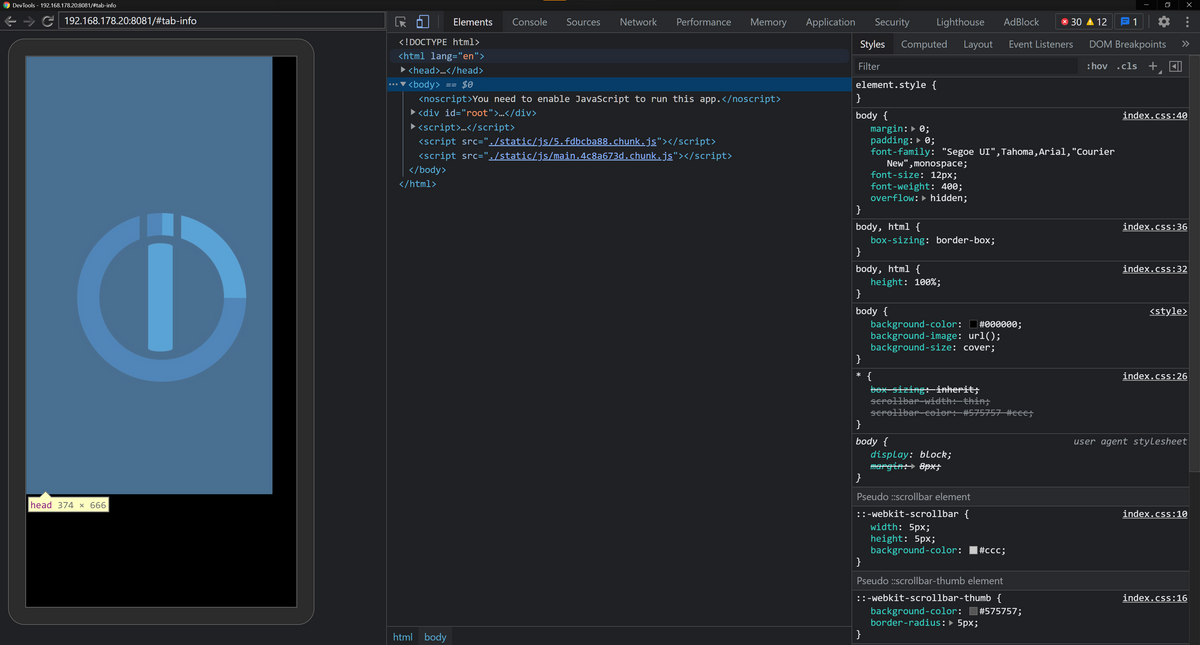

                    @rushmed
                    Console , steht da was?
                          @sigi234 ja
                          iobroker.admin@5.1.28
                          socket.io.js:59 [2021-12-04T12:10:21.256Z] Try to connect
                          socket.io.js:91 WebSocket connection to 'ws://192.168.178.20:8081/?sid=1638619821257&name=admin' failed: Error in connection establishment: net::ERR_SSL_PROTOCOL_ERROR
                          SocketClient.connect @ socket.io.js:91
                          (anonymous) @ Connection.ts:239
                          u @ runtime.js:63
                          (anonymous) @ runtime.js:294
                          (anonymous) @ runtime.js:119
                          n @ asyncToGenerator.js:3
                          i @ asyncToGenerator.js:25
                          (anonymous) @ asyncToGenerator.js:32
                          (anonymous) @ asyncToGenerator.js:21
                          (anonymous) @ 5.fdbcba88.chunk.js:2
                          (anonymous) @ Connection.ts:99
                          socket.io.js:59 [2021-12-04T12:10:21.344Z] Start reconnect 0
                          socket.io.js:61 [2021-12-04T12:10:21.345Z] ws connection error: CLOSE_ABNORMAL
                          error @ socket.io.js:61
                          socket.onclose @ socket.io.js:128
                          socket.io.js:59 [2021-12-04T12:10:21.345Z] Reconnect is already running 0
                          socket.io.js:59 [2021-12-04T12:10:21.368Z] Try to connect
                          socket.io.js:91 WebSocket connection to 'ws://192.168.178.20:8081/?sid=1638619821370&name=admin' failed: Error in connection establishment: net::ERR_SSL_PROTOCOL_ERROR
                          (anonymous) @ socket.io.js:372
                          socket.io.js:59 [2021-12-04T12:10:21.429Z] Start reconnect 1
                          socket.io.js:61 [2021-12-04T12:10:21.430Z] ws connection error: CLOSE_ABNORMAL
                          socket.io.js:59 [2021-12-04T12:10:21.430Z] Reconnect is already running 1
                          socket.io.js:59 [2021-12-04T12:10:22.430Z] Try to connect
                          socket.io.js:91 WebSocket connection to 'ws://192.168.178.20:8081/?sid=1638619822432&name=admin' failed: Error in connection establishment: net::ERR_SSL_PROTOCOL_ERROR
                          socket.io.js:59 [2021-12-04T12:10:22.520Z] Start reconnect 2
                          socket.io.js:61 [2021-12-04T12:10:22.521Z] ws connection error: CLOSE_ABNORMAL
                          socket.io.js:59 [2021-12-04T12:10:22.521Z] Reconnect is already running 2
                          socket.io.js:59 [2021-12-04T12:10:24.521Z] Try to connect
                          socket.io.js:91 WebSocket connection to 'ws://192.168.178.20:8081/?sid=1638619824521&name=admin' failed: Error in connection establishment: net::ERR_SSL_PROTOCOL_ERROR
                          socket.io.js:59 [2021-12-04T12:10:24.582Z] Start reconnect 3
                          socket.io.js:61 [2021-12-04T12:10:24.583Z] ws connection error: CLOSE_ABNORMAL
                          socket.io.js:59 [2021-12-04T12:10:24.583Z] Reconnect is already running 3
                          socket.io.js:59 [2021-12-04T12:10:27.583Z] Try to connect
                          socket.io.js:91 WebSocket connection to 'ws://192.168.178.20:8081/?sid=1638619827584&name=admin' failed: Error in connection establishment: net::ERR_SSL_PROTOCOL_ERROR
                          socket.io.js:59 [2021-12-04T12:10:27.674Z] Start reconnect 4
                          socket.io.js:61 [2021-12-04T12:10:27.674Z] ws connection error: CLOSE_ABNORMAL
                          socket.io.js:59 [2021-12-04T12:10:27.675Z] Reconnect is already running 4
                          socket.io.js:59 [2021-12-04T12:10:31.675Z] Try to connect
                          socket.io.js:91 WebSocket connection to 'ws://192.168.178.20:8081/?sid=1638619831676&name=admin' failed: Error in connection establishment: net::ERR_SSL_PROTOCOL_ERROR
                          socket.io.js:59 [2021-12-04T12:10:31.764Z] Start reconnect 5
                          socket.io.js:61 [2021-12-04T12:10:31.767Z] ws connection error: CLOSE_ABNORMAL
                          socket.io.js:59 [2021-12-04T12:10:31.775Z] Reconnect is already running 5
                          socket.io.js:59 [2021-12-04T12:10:36.767Z] Try to connect
                          socket.io.js:91 WebSocket connection to 'ws://192.168.178.20:8081/?sid=1638619836768&name=admin' failed: Error in connection establishment: net::ERR_SSL_PROTOCOL_ERROR
                          socket.io.js:59 [2021-12-04T12:10:36.857Z] Start reconnect 5
                          socket.io.js:61 [2021-12-04T12:10:36.858Z] ws connection error: CLOSE_ABNORMAL
                          socket.io.js:59 [2021-12-04T12:10:36.859Z] Reconnect is already running 5

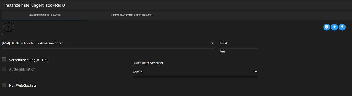

                            • sigi234
                              @rushmed
                              Zeig mal Instanzeinstellungen: socketio.0
                                Ich habe weder HTTPS noch eine socketio. Instanz.
                                Ich leg mal eine an.
                                Edit:
                                Authentifizierung habe ich aktiv.
                                Mit dem alten Admin UI komme ich schonmal zum Login Screen und bleibe danach hängen.

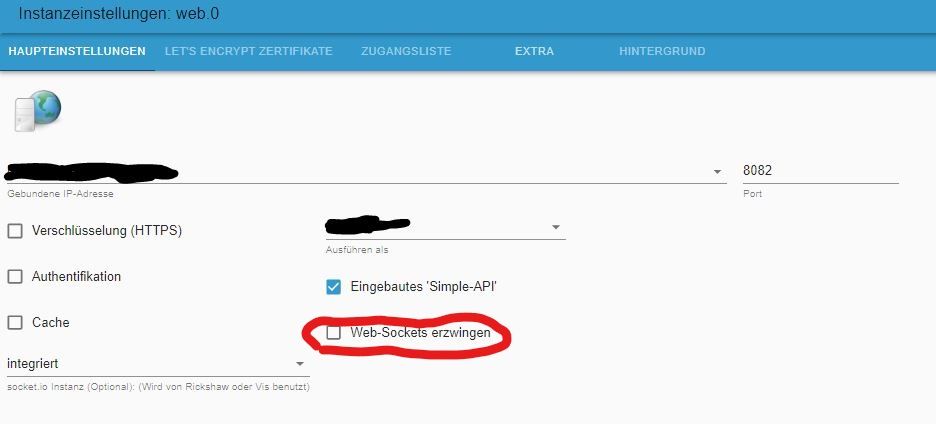

                                      • Seffe
                                        Seffe @Rushmed last edited by Seffe
                                        @rushmed Konntest du das Problem lösen?
                                        Hätte noch den Vorschlag den Hacken beim erzwingen der Websockets in der Instanz Web.0 zu deaktivieren.
                                        Hiermit geht zumindest wieder der Zugriff auf die ViS mit dem neuen Samsung Internet Browser.Websocket.jpg
                                        M R 2 Replies Last reply Reply Quote 0
                                          MK-66 @Seffe last edited by
                                          @seffe @Rushmed
                                          Was aber beim neuen Samsung Internet Browser 16.0.2.19 trotzdem nicht mehr geht, ist der Zugriff auf Flot Diagramme, zumindest bei mir nicht (Websockets erzwingen ist deaktiviert). Sobald mehrere Flots geladen werden sollen, passiert außer einem derhenden Kreis einfach gar nichts und irgendwann stürzt der Browser dann auch noch ab. Wenn nur ein einzelnes Flot geladen werden soll, geht es. Mit Chrome und FF gibt es da keine Probleme.
                                            Rushmed Most Active @Seffe last edited by
                                            @seffe Nein, es funktionier immernoch nicht. Das Erzwingen der Websockets war bereits deaktiviert.
                                            Ich sehe aber Licht am Ende des Tunnels. In der aktuellen Samsung Internet beta 16.2.1.25 komme ich wieder in die Admin Oberfläche. 👍
                                            Flot und Vis habe ich nicht getestet, ich visualisiere alles mit einer Kombi aus Grafana und HabPanel und das ging beides immer.
