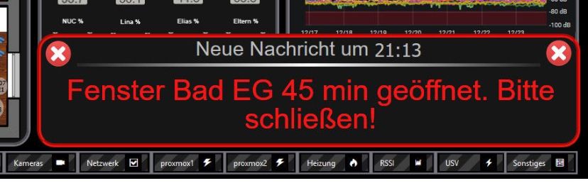

      Ich bin neu mit Iobroker etc am arbeiten und möchte gerne was umsetzen, was mir sicher einer von euch aufzeigen kann, wie ich das umsetzen könnte.
      Meine Idee ist: Ich habe eine Schalter, wenn der auf True ist, möchte ich das ein Text generiert wird, den ich dann nachher auf der Visu darstellen möchte.
      Wer kann mir zeigen wie das geht?

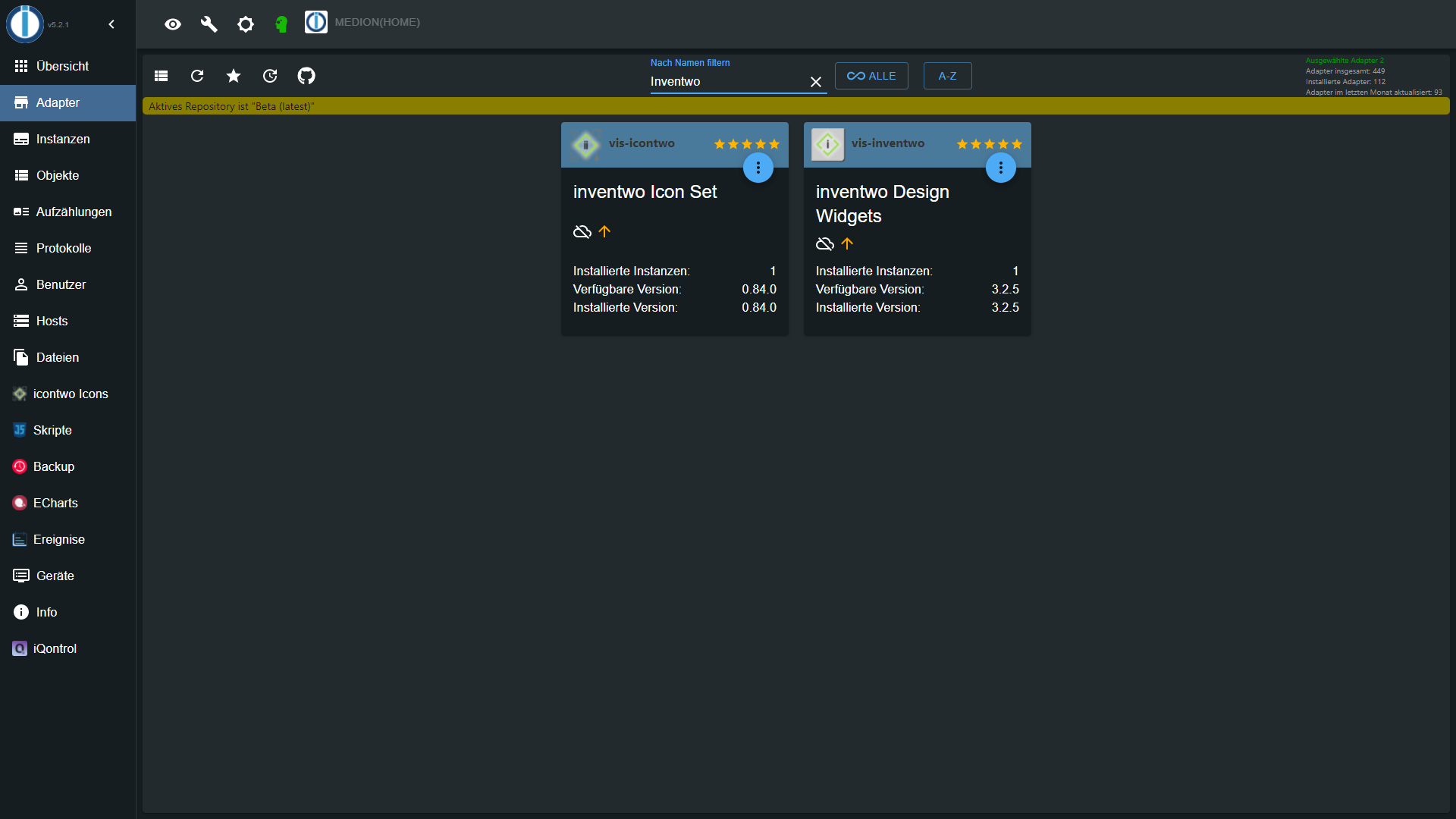

        Nimm mal das, kannst alles machen damit. Brauchst Inventwo Widgets und Icon Widgets.
        Bei Beschriftung kannst du auch bindings einsetzen. {dein DP}
        Als Widget importieren:
        [{"tpl":"i-vis-universal","data":{"g_fixed":false,"g_visibility":false,"g_css_font_text":false,"g_css_background":false,"g_css_shadow_padding":false,"g_css_border":false,"g_gestures":false,"g_signals":false,"g_last_change":false,"visibility-cond":"==","visibility-val":1,"visibility-groups-action":"hide","iUniversalWidgetType":"Background","iValueType":"boolean","iValueComparison":"equal","iStateResponseTime":"0","iStateResetValueTime":"0","iNavWait":"100","iPopUpBackground":"#666666","iPopUpPreventClickOutside":"","iPopUpShowTitle":"true","iPopUpTitle":"","iPopUpTitleColor":"#ffffff","iPopUpCloseBtnColor":"#dc2e2e","iPopUpWidth":"800px","iPopUpHeight":"500px","iPopUpHeightTitle":"50","iPopUpTitleSize":"28","iPopUpPosition":"center","iPopUpPositionX":"0","iPopUpPositionY":"0","iPopUpCloseAfterSeconds":"0","iPopUpCornerRadiusUL":"12","iPopUpCornerRadiusUR":"0","iPopUpCornerRadiusLR":"12","iPopUpCornerRadiusLL":"0","iPopUpShadowXOffset":"2","iPopUpShadowYOffset":"2","iPopUpShadowBlur":"2","iPopUpShadowSpread":"1","iPopUpShadowColor":"#111111","iButtonCol":"#333333","iButtonActive":"#333333","iButtonColHover":"","iOpacityBack":"1","iCornerRadiusUL":"5","iCornerRadiusUR":"5","iCornerRadiusLR":"5","iCornerRadiusLL":"5","iContentFlexDirection":"vertical","iContentVertAlign":"iSpace-between","iContentOrder":"orderImgText","iOpacityCtn":"1","iContentType":"image","iTextColor":"#fa0000","iTextColorActive":"#fa0000","iTextSize":"28","iTextAlign":"iStart","iTextSpaceTop":"0","iTextSpaceBottom":"0","iTextSpaceLeft":"0","iTextSpaceRight":"0","iIconSize":"35","iImgAlign":"iCenter","iImgSpaceTop":"0","iImgSpaceBottom":"0","iImgSpaceLeft":"0","iImgSpaceRight":"0","iImgRotation":"0","iImgBlinkFalse":"0","iImgBlinkTrue":"0","iImgColorFalse":"","iImgColorTrue":"","iImgClockFace":"01","iImgClockHands":"01","iImgClockShowBorder":"1","iImgColorClockFace":"#ffffff","iImgColorHands":"#ffffff","iImgColorHandSecond":"#ff0000","iClockShowSeconds":"","iClockTimezone":"Europe/Berlin","iHtmlTextFieldFalse":"","iHtmlTextFieldTrue":"","iShadowXOffset":"0","iShadowYOffset":"2","iShadowBlur":"2","iShadowSpread":"1","iShadowColor":"#111111","iShadowColorActive":"#111111","iShadowColorHover":"","iShadowInnerXOffset":"0","iShadowInnerYOffset":"0","iShadowInnerBlur":"0","iShadowInnerSpread":"0","iShadowInnerColor":"#111111","iShadowInnerColorActive":"#111111","iShadowInnerColorHover":"","iShadowTextXOffset":"0","iShadowTextYOffset":"0","iShadowTextBlur":"0","iShadowTextColor":"#111111","iShadowTextColorActive":"#111111","iBorderSize":"1","iBorderStyle":"solid","iBorderColor":"#f00000","iBorderColorActive":"#f00000","iBorderColorHover":"","signals-cond-0":"==","signals-val-0":true,"signals-icon-0":"/vis/signals/lowbattery.png","signals-icon-size-0":0,"signals-blink-0":false,"signals-horz-0":0,"signals-vert-0":0,"signals-hide-edit-0":false,"signals-cond-1":"==","signals-val-1":true,"signals-icon-1":"/vis/signals/lowbattery.png","signals-icon-size-1":0,"signals-blink-1":false,"signals-horz-1":0,"signals-vert-1":0,"signals-hide-edit-1":false,"signals-cond-2":"==","signals-val-2":true,"signals-icon-2":"/vis/signals/lowbattery.png","signals-icon-size-2":0,"signals-blink-2":false,"signals-horz-2":0,"signals-vert-2":0,"signals-hide-edit-2":false,"lc-type":"last-change","lc-is-interval":true,"lc-is-moment":false,"lc-format":"","lc-position-vert":"top","lc-position-horz":"right","lc-offset-vert":0,"lc-offset-horz":0,"lc-font-size":"12px","lc-font-family":"","lc-font-style":"","lc-bkg-color":"","lc-color":"","lc-border-width":"0","lc-border-style":"","lc-border-color":"","lc-border-radius":10,"lc-zindex":0,"iValueTrue":"","iTextTrue":"Fenster Bad 45 Min. geöffnet - Bitte schließen! ","oid":"0_userdata.0.Test_true_false"},"style":{"left":"22px","top":"25px","width":"592px","height":"50px","z-index":"4"},"widgetSet":"vis-inventwo"}]
        Hier mal was zum ansehen:
        https://forum.iobroker.net/topic/28717/vis-von-sigi234?_=1638912614630
          stefu87_CH @sigi234 last edited by
          @sigi234 Verstehe deine Angaben nicht so ganz. Wollte es gerne mit Blockly versuchen, da mir dies übersichtlicher daher kommt, und ich das besser verstehe wie der Ablauf genau ist.
