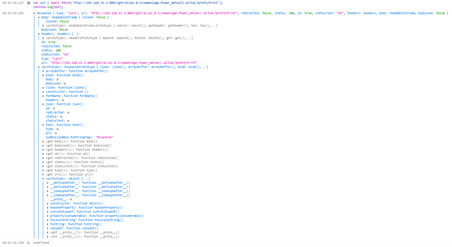

                        SMARTY.ML @Asgothian last edited by SMARTY.ML
                        Nächste Versuch
                        10:23:19.227 var out = await fetch('http://192.168.31.3:8087/get/alias.0.Klimaanlage.Power_aktuell.ACTUAL?prettyPrint');
                        console.log(out);
                        10:23:19.256
                        Response { type: "cors", url: "http://192.168.31.3:8087/get/alias.0.Klimaanlage.Power_aktuell.ACTUAL?prettyPrint", redirected: false, status: 200, ok: true, statusText: "OK", headers: Headers, body: ReadableStream, bodyUsed: false }
                        body: ReadableStream { locked: false }
                        locked: false
                        <prototype>: ReadableStream.prototype { cancel: cancel(), getReader: getReader(), tee: tee(), … }
                        bodyUsed: false
                        headers: Headers {  }
                        <prototype>: HeadersPrototype { append: append(), delete: delete(), get: get(), … }
                        ok: true
                        redirected: false
                        status: 200
                        statusText: "OK"
                        type: "cors"
                        <prototype>: ResponsePrototype { clone: clone(), arrayBuffer: arrayBuffer(), blob: blob(), … }
                        arrayBuffer: function arrayBuffer()
                        blob: function blob()
                        body:
                        bodyUsed:
                        clone: function clone()
                        constructor: function ()
                        formData: function formData()
                        headers:
                        json: function json()
                        ok:
                        redirected:
                        status:
                        statusText:
                        text: function text()
                        type:
                        url:
                        Symbol(Symbol.toStringTag): "Response"
                        <get body()>: function body()
                        <get bodyUsed()>: function bodyUsed()
                        <get headers()>: function headers()
                        <get ok()>: function ok()
                        <get redirected()>: function redirected()
                        <get status()>: function status()
                        <get statusText()>: function statusText()
                        <get type()>: function type()
                        <get url()>: function url()
                        <prototype>: Object { … }

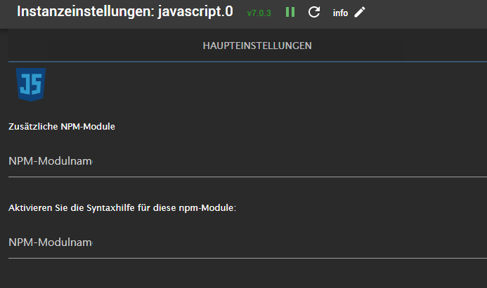

                                      • Wal
                                        Wal Developer @Karel Puhli last edited by
                                        @karel-puhli ,
                                        ich denke das du das Modul fetch hier hinzufügen musst, ist aber ohne Gewähr.
                                        Karel Puhli 1 Reply Last reply Reply Quote 0
                                        • Karel Puhli
                                          Karel Puhli @Wal last edited by Karel Puhli
                                          @wal
                                          Hi Walter!
                                          Danke für Deine Antwort!
                                          Ist in beiden Zeilen drin!
                                          820
