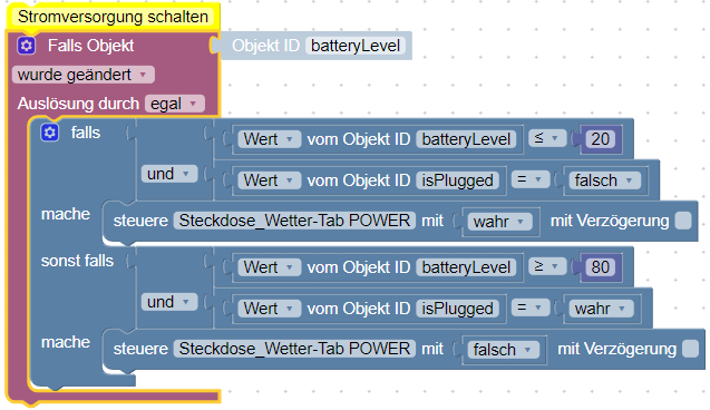

          • Dr. Bakterius
            Dr. Bakterius Most Active @Dr.Pie last edited by
            @dr-pie Ich mache das so:
            <block xmlns="https://developers.google.com/blockly/xml" type="on_ext" id=")BCBw,)KxeP)WiIzN67[" x="112" y="89">
             <value name="OID0">
               <shadow type="field_oid" id="pwV@8NNT!OSL?76id,wm">
                 <field name="oid">fullybrowser.0.192_168_3_20.Info.batteryLevel</field>
               <block type="controls_if" id="TXB!XbknBVuBz1A8V$GF">
                   <block type="logic_operation" id="!C88w+K9{hf{HuUC2!f-" inline="false">
                     <field name="OP">AND</field>
                       <block type="logic_compare" id="Yds8tF6QakgatxTwoTZT">
                         <field name="OP">LTE</field>
                           <block type="get_value" id="q^442Z*EjIK.yQE5+5k~">
                             <field name="OID">fullybrowser.0.192_168_3_20.Info.batteryLevel</field>
                           <block type="math_number" id="#4JiC:Z(7R+u)X;4A+D.">
                             <field name="NUM">20</field>
                       <block type="logic_compare" id="rh|Wv.tRP!Z{^R%m!aod">
                         <field name="OP">EQ</field>
                           <block type="get_value" id="2Q?OwXzZ^[TayYlGbd66">
                             <field name="OID">fullybrowser.0.192_168_3_20.Info.isPlugged</field>
                           <block type="logic_boolean" id="7Qp9#7~O:yB^j)3@ET;+">
                   <block type="control" id="h/o0uZS%l0,3Q,l)y)9R">
                     <field name="OID">sonoff.0.Steckdose_Wetter-Tab.POWER</field>
                       <block type="logic_boolean" id="v~OHjszwO?:4Jq9ESi]r">
                 <value name="IF1">
                   <block type="logic_operation" id="z1v0]@YCoW#an5:h4#wc" inline="false">
                       <block type="logic_compare" id="Nc%5;[#XwPLNd+f2)[uD">
                         <field name="OP">GTE</field>
                           <block type="get_value" id="LrmpDZUJ9m@Mf9f]3`.,">
                           <block type="math_number" id="ZSRDU[%S^wY$?VY^tS[0">
                             <field name="NUM">80</field>
                       <block type="logic_compare" id="4Rgv`*51C2+q[z%{di/;">
                           <block type="get_value" id="KJXV/u7QV%Tu*mpGAycJ">
                           <block type="logic_boolean" id="5a/XBb50B*)cnd))S9=S">
                 <statement name="DO1">
                   <block type="control" id="_U@lv,8o]%8n]?V]QcAa">
                       <block type="logic_boolean" id="s3ND.Z8N~M6~v1})+r:*">

            • Dr.Pie
              Dr.Pie @Dr. Bakterius last edited by
              @dr-bakterius
              Cool ... das Script funktioniert super.
              Ich hab das angepasst und es lief gleich beim ersten mal...
              1000 Dank dafür
