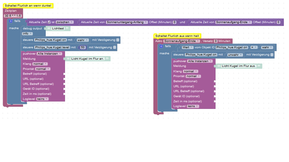

      kann mir jemand sagen warum dieses Blockly meine Lampe nicht einschaltet?
      gewollt ist: Um 6:30 Uhr von Montag bis Freitag, wenn es noch zwischen Sonnenuntergang und Sonnenaufgang ist.
      ! <xml 1999/xmlns="<URL url=" http:/www.w3.org/xhtml"="">http://www.w3.org/1999/xhtml">
      ! <block type="comment" id="oPy]c2cJ)HH4HkCai+Ce" x="-462" y="-263"><field name="COMMENT">Schaltet Flurlich an wenn dunkel</field>
      ! <next><block type="schedule" id="(Qch+s3fvei{HMzHT_"><field name="SCHEDULE">30 6 * * 1-5</field>
      ! <statement name="STATEMENT"><block type="controls_if" id="rM_!?w:|YC]FX(F7~J5b"><value name="IF0"><block type="time_compare_ex" id="pWEBCNZR9N)*}-b{-wY"><mutation end_time="true" actual_time="true"></mutation> ! <field name="USE_ACTUAL_TIME">TRUE</field> ! <field name="OPTION">between</field> ! <value name="START_TIME"><shadow type="text" id="zj7MeQwOcE_01iLbFD"><field name="TEXT">12:00</field></shadow> ! <block type="time_astro" id="_].nmE06?O(,7ZuVenrO"><field name="TYPE">sunsetStart</field> ! <field name="OFFSET">0</field></block></value> ! <value name="END_TIME"><shadow type="text" id="+ErAeP145mf#K}m?oJPu"><field name="TEXT">18:00</field></shadow> ! <block type="time_astro" id="dCI2i2HA_siRE{Hyh0J)"><field name="TYPE">sunriseEnd</field> ! <field name="OFFSET">0</field></block></value></block></value> ! <statement name="DO0"><block type="debug" id="3d0WR-J=+.QP)K73a-"><field name="Severity">log</field> ! <value name="TEXT"><shadow type="text" id="XU[l~tIcBz/eHi{Uwd"><field name="TEXT">Lichttest</field></shadow></value>
      ! <next><block type="control" id="vd7k^lxl@7C/X2|/X+"><mutation delay_input="false"></mutation>
      ! <field name="OID">hue.0.Philips_hue.Kugel.on</field>
      ! <field name="WITH_DELAY">FALSE</field>
      ! <value name="VALUE"><block type="logic_boolean" id="j6K:#(j+/b,
      )87/*g_c"><field name="BOOL">TRUE</field></block></value>
      ! <next><block type="control" id="O%fJg!CDc9jI~YJTtE97"><mutation delay_input="false"></mutation>
      ! <field name="OID">hue.0.Philips_hue.Kugel.level</field>
      ! <value name="VALUE"><block type="math_number" id="mTEA-S8!0s_K[+SieujY"><field name="NUM">50</field></block></value>
      ! <next><block type="pushover" id="JZE45J]TFrg,?=7c5zG8"><field name="PRIORITY">0</field>
      ! <value name="MESSAGE"><shadow type="text" id="j9t)EV5!1TD:L~M}{`;0"><field name="TEXT">Licht Kugel im Flur an.</field></shadow></value></block></next></block></next></block></next></block></statement></block></statement></block></next></block>
      ! <block type="comment" id="cOTf]Bin-?Bj=WB6g4UK" x="163" y="213"><field name="COMMENT">Schaltet Flurlich aus wenn hell</field>
      ! <next><block type="astro" id="yp-FphCS@zi?Znz!z3v6"><field name="TYPE">sunriseEnd</field>
      ! <statement name="STATEMENT"><block type="controls_if" id="E+tp[+F!cv2c[v_#y5+V"><value name="IF0"><block type="logic_compare" id="5a{*T2o=/Ivu1RkShetf"><field name="OP">EQ</field>
      ! <value name="A"><block type="get_value" id="}~_Dsg:{166TDSIB^miQ"><field name="ATTR">val</field>
      ! <field name="OID">hue.0.Philips_hue.Kugel.on</field></block></value>
      ! <value name="B"><block type="logic_boolean" id="C:rK%ButEq{OI6tXFj6F"><field name="BOOL">TRUE</field></block></value></block></value>
      ! <statement name="DO0"><block type="control" id="s#]:!A)qTyXwd4pOj]M@"><mutation delay_input="false"></mutation>
      ! <value name="VALUE"><block type="logic_boolean" id="?v@2Do]uREBpPRxX}x7n"><field name="BOOL">FALSE</field></block></value>
      ! <next><block type="pushover" id="_ey/@T~q+d4XD=QGid"><field name="PRIORITY">0</field>
      ! <value name="MESSAGE"><shadow type="text" id="/NJDs|5KHzuXP~sqO6y5"><field name="TEXT">Licht Kugel im Flur aus.</field></shadow></value></block></next></block></statement></block></statement></block></next></block></xml>
      Das Blockly löst leider einfach nicht aus.
      Gruß Sven

        Es löst deswegen nicht aus da es immer nur die Zeiten Sonnenaufgang und -Untergang vom Aktuellen Tag nimmt. Ich gehe davon aus, dass es in deinem Fall einfach vor Sonnenaufgang sein soll dann musst du als Abfrage ist die jetztige Zeit zwischen 00:00 Uhr und Sonnenaufgang nehmen.
        Ich hab gerade leider nur das Handy griffbereit. Sonst könnte ich das richtige Blockly posten.
        Gruß Stefan

          Hey Stefan,
          danke dir. da hätte ich auch selbst drauf kommen können. Aber manchmal sitzt man davor und sieht den Wald vor lauter Bäumen nicht…
          Vielen Dank Gruß Sven
