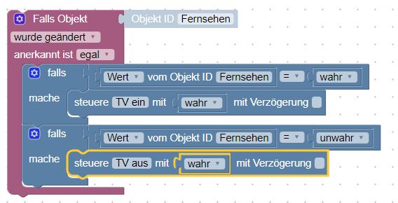

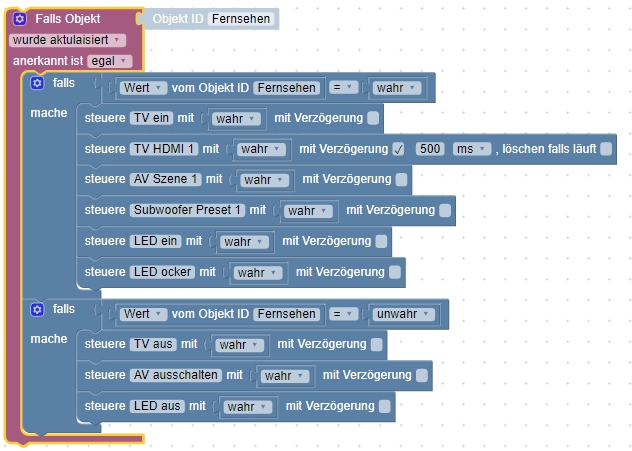

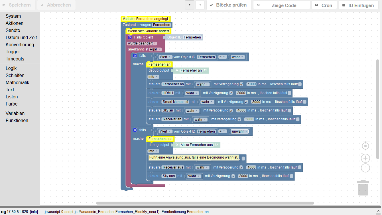

      sorry, der code war unvollständig, hier nun der vollständige.
      Aber, es ist ein Blockly-code !!
      <xml xmlns="http://www.w3.org/1999/xhtml"><block type="on_ext" id="nE(du3aXY2owO0nkeK8B" x="-338" y="13"><mutation items="1"></mutation>
      <value name="OID0"><shadow type="field_oid" id="xkUcu,a7(QU24];C9QRX"><field name="oid">MultiMedia.0.Fernsehen</field></shadow></value>
      <statement name="STATEMENT"><block type="controls_if" id="OAAw8/5t%l.nG/muy8zg"><value name="IF0"><block type="logic_compare" id="}j@Q?Ld3iXz/yB;,I{%f"><field name="OP">EQ</field>
              <value name="A"><block type="get_value" id="Dmta#S:Ep7wjtv5C|0aJ"><field name="ATTR">val</field>
                  <field name="OID">MultiMedia.0.Fernsehen</field></block></value>
              <value name="B"><block type="logic_boolean" id="DAE/tbn%~!dm+!S7)}(J"><field name="BOOL">TRUE</field></block></value></block></value>
          <statement name="DO0"><block type="control" id="Z#BpaV~U)dUL?{f7qzc7"><mutation delay_input="false"></mutation>
              <field name="OID">broadlink.0.SamsungPlasmaTV.CODE_2600d200949413371237133712121213121212131212123713371238121212121213121212121337121212131138123812121213113812131138123812121212123812381212120006009494123713371238121212121213121212121238123713371212121312121213121212371312121212381237121311131238121212371238121213121237123812121200060094941238123713371212121312121212121312371238123713121212121311131212123812121213113812381212121212381212123812371312121212381237121312000d050000000000000000</field>
              <value name="VALUE"><block type="logic_boolean" id="BFo8Fb]r_`Oy`F=]/E8x"><field name="BOOL">TRUE</field></block></value></block></statement>
          <next><block type="controls_if" id="jC{;1-EC{hm6;vt2zje~"><value name="IF0"><block type="logic_compare" id="lOR*##:dhdI0B@xkdHmQ"><field name="OP">EQ</field>
                  <value name="A"><block type="get_value" id=",AUwj/EP!:KC|^tAw,`@"><field name="ATTR">val</field>
                  <value name="B"><block type="logic_boolean" id="WAnR-@A}Hg`|N6HxY]5t"><field name="BOOL">FALSE</field></block></value></block></value>
              <statement name="DO0"><block type="control" id="AfC_gx?2nTg_SurB8dE,"><mutation delay_input="false"></mutation>
                  <field name="OID">broadlink.0.SamsungPlasmaTV.CODE_2600d200969413361337123812121212131211131113123812381237131210141212121310141113121311131136153712131014123713371238133612131113123712381212120006009494123813361436121311131212121310141237133712381311121212131113121211141113121212381238131111131139123713371337111311131139123713121200060094941336123813361411121212131113121212381237133712121213111312121312111312131113123712381311121311381238123713371212121311381337121212000d050000000000000000</field>
                  <value name="VALUE"><block type="logic_boolean" id="w+kXam(Wq0ga^N}NdDuT"><field name="BOOL">TRUE</field></block></value></block></statement></block></next></block></statement></block></xml>

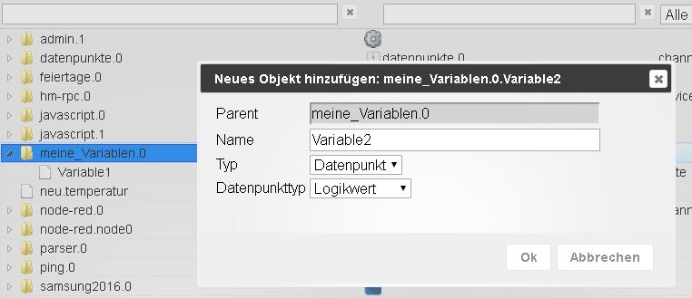

        MauriceSG last edited by
        script scheint zu gehen aber das mit dem Objekt???
        wenn ich ein objekt erstelle habe Ich folgende auswahl:
        Typ:
        Datenpunkt / Kanal / Gerät
        Bei Kanal keine weitere Auswahl!
        Bei Datenpunkt:
        ~~![](</s><URL url=)http://up.picr.de/29953035ir.jpg" />
        aber bei keiner Kombination erscheint bei mir das Feld smartName~~
        • BBTown
          BBTown last edited by

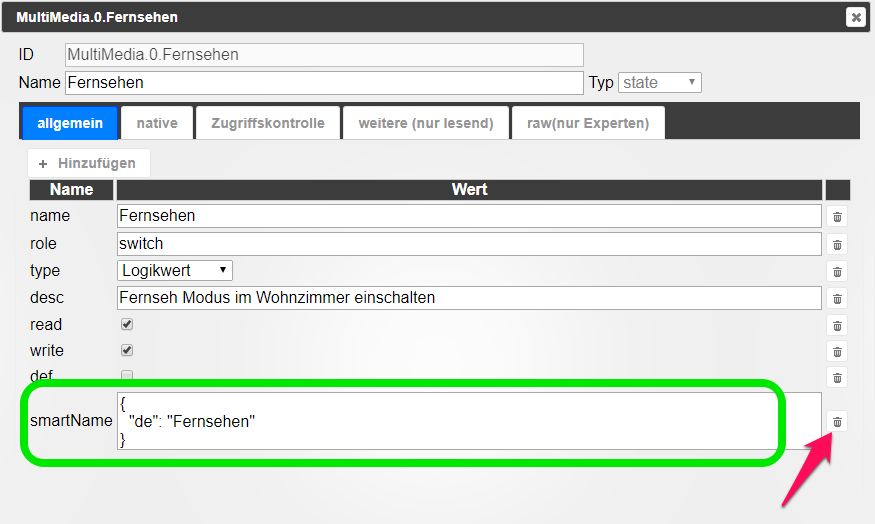

          Weshalb hälst Du dich nicht einfach an die Anleitung?
          Es wird von nichts anderen als einem Datenpunkt gesprochen
          Der smartName wird automatisch vom cloud-Adapter eingetragen wenn Du den Datenpunkt im Cloud-Adapter hinzugefügt hast.
          Ich habe dir lediglch gezeigt wie man über die Eigenschaften des Datenpunktes den Cloud-Adaper-Eintrag wieder entfernen kann.
          Nirgends in der Anleitung ist ein Hinweis darauf, dass Du einen Eintrag in ein Feld smartName tätigen mußt.

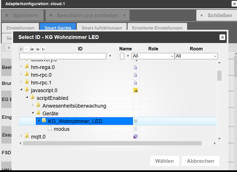

          1. Datenpunkt anlegen
          • Name: "Fernsehen"
          • role=switch
          • type: Logikwert)
          2. Im cloud-Adapter ein Smart-Gerät anlegen
          • Name: "Fernsehen" (mit diesem Namen erfolgt die Ansprache in Alexa)
          • Verküpfung mit dem unter 1.) angelegten Datenpunkt "Fernsehen"
          3.) in der Alexa App prüfen ob es bereits eine Gerät namens "Fernsehen" gibt,
          • falls ja -> verwerfen (entfernen)
          • falls nein (oder nach dem entfernen) in der Alexa App nach Geräten suchen
          • prüfen ob "Fernsehen" angekommen ist
          4.) Script erstellen:
          • was soll geschehen wenn "Fernsehen" = wahr
          • was soll geschehen wenn "Fernsehen" = unwahr
          Ein Beispielscript habe ich dir zum Import angefügt.
          Da mein Datenpunkt "Fernsehen" aber an einer ganz anderen Stelle in der "Objekte-Liste" liegt als der Deine, mußt Du natürlich diese Verknüpfung korrigieren (draufklicken und auswählen) und zwar an allen drei Stellen an denen sich auf "Fernsehen" bezogen wird.
          Das gleiche gilt für die Datenpunkte "TV ein" und "TV aus", die heißen bei dir ganz anders ("Fernseher_schalten"???) und liegen auch an einer anderen stelle, also draufklicken und korrekte Verknüpfung auswählen.
          Mach es doch einfach wie es da steht.

              Der besondere Vorteil von der Vorgehensweise mit dem "Hilfs-Datenpunkt" liegt darin, dass Du über das Script natürlich nicht nur einen einzigen Befehl absetzen kannst, sondern gleich ein ganzes Feuerwerk 🙂
              Ich hatte gesehen, dass Du z.B. "Sky" als weitere "Broadlink"-Taste eingerichtet hattest (so sah es jedesfalls aus).
              Wieso also nicht in deinem (Blockly)-Script nach dem "steuere - TV ein = wahr" auch sofort "steuere - Sky ein = wahr" hinterherschicken?!
              So mußt Du hierfür nicht ein separates Alexa-Kommando geben.
              Schau dir gern noch einmal den ersten Screenshot meines Blockly-Scriptes an:
              Über "Alexa, schalte Fernsehen ein" lasse ich also in einem Rutsch:
              • TV = ein
              • TV Eingangsquelle = HDMI-1
              • AV-Receiver = Eingangsquelle TV
              • Subwoofer = Voreinstellung TV
              • LED-Stripe hinter dem TV = ein
              • LED hinter dem TV Farbe = ocker
              ausführen.

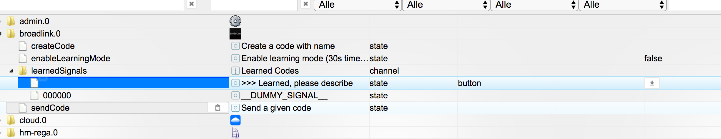

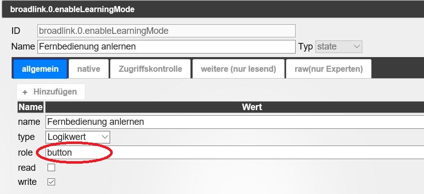

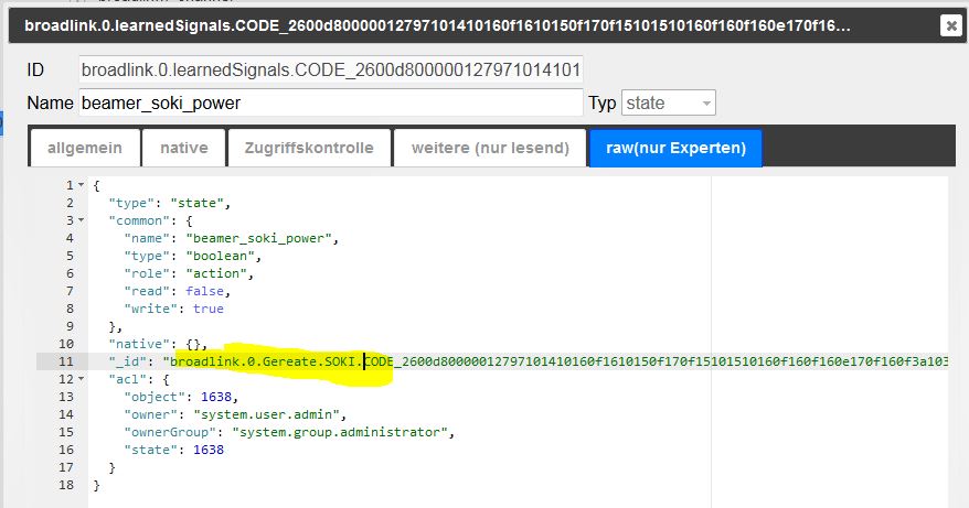

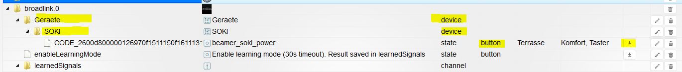

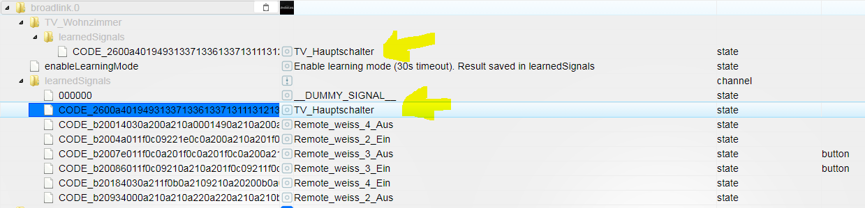

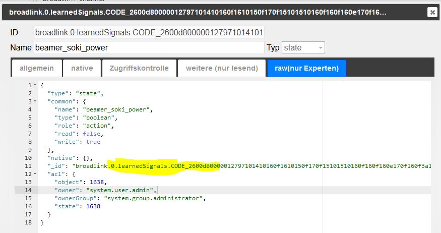

                  Frage1: Bitte, wie bekomme ich einen angelernten Code (Objekt?) in eine andere Struktur? 488_adapt_broadlink.jpg
                  So nicht, dann funktioniert der Code (Datenpunkt?) nicht mehr. 488_adapt_broadlink_1.jpg 488_adapt_broadlink_2.jpg
                  Frage2: Welche Rolle ist für das Ausführen der Codes die Richtige? 488_adapt_broadlink_3.jpg "State" tut, aber genauso wie "Action" oder "Button", ich verstehe nur die Zusammenhänge dahinter nicht.
                  Lieben Dank, mxa
                  • BBTown
                    @metaxa:

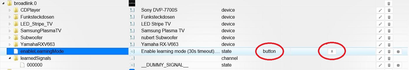

                    Bitte, wie bekomme ich einen angelernten Code (Objekt?) in eine andere Struktur? `
                    Moin metaxa,
                    deine Vorgehensweise ist genau richtig. Der Unterschied zu meiner Struktur ist jedoch, dass Du "Geraete" und "SOKI" als "Kanal (Channel)" und nicht als ""Gerät (Device)" angelegt hast.
                    Ich habe mir angewöhnt die angelernten Fernbedienungstasten als "button" anzulegen.
                    Wenn Du in der Objekte-Übersicht die Taste siehst, dann kannst Du diese sofort durch klick auf das Symbol auslösen und musst den Datenpunkt nicht erst von "false" auf "true" setzen - gerade beim Testen oder sonstigen manuellen Auslösen für mich sehr hilfreich.
                    "Action" kannte ich bisher gar nicht 🙂

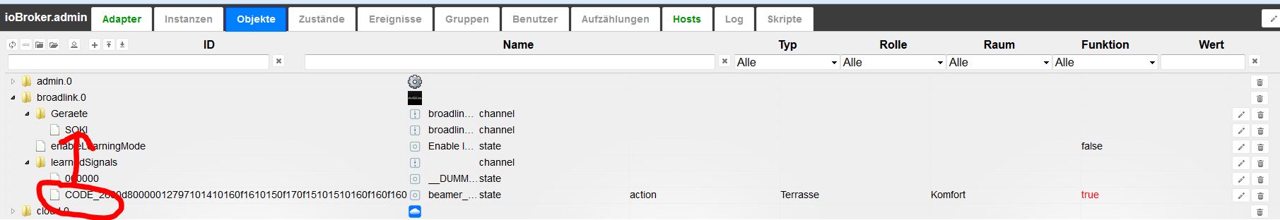

                    • metaxa
                      metaxa last edited by
                      Hi Heiko!
                      Wahrscheinlich war das~~@BBTown:~~
                      und nicht als ""Gerät (Device)" angelegt hast. ` die Lösung. Oder ich hatte auch schon zu lange herumgedoktert.
                      Fakt ist, es passt und funkt (besser "Infrarotet") jetzt dort wo angedacht! :idea: 488_adapt_broadlink_4.jpg
                      Danke für deine Erklärungen!
                      LG, mxa

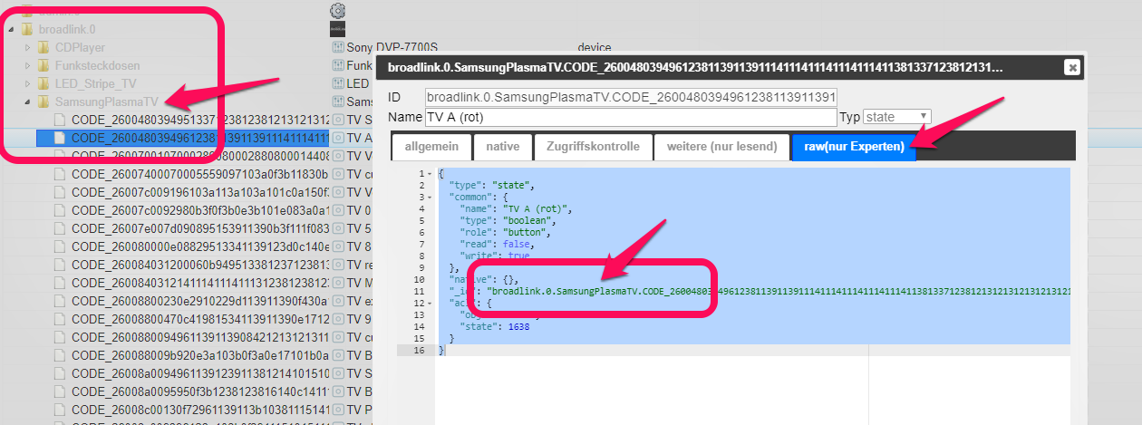

                            @LaGra:
                            Wenn ich einen neuen Code anlerne, wird der alte ständig überschrieben.
                            hat jemand das selbe Phänomen beobachten können? Kennt jemand Lösungsansätze? ` Du mußt den Code nach dem Anlernen natürlich noch Anpassen.
                            Als ID nimmst Du "CODE_xxxxxx" wobei hier "xxxx" der tatsächiche Code ist.
                            Als Namen vergibts Du dann idealerweise noch etwas leicht erkennbares wie "TV ein"
                            Am besten legst Du dir eine Struktur an.
                            Ich habe beispielsweise eine Objektgruppe (Device) "MultiMedia.0" angelegt
                            Da drunter befindet sich die Gruppe (Device) "Samsung Plasma TV"
                            und dort drunter befinden sich dann wiederum die ganzen Steuerocdes (Datenpunkte) meines Samsung Plasma TV
                            usw.

                                          @crepp:
                                          Ich möchte die Codes übersichtlich in einer "Ordner"-Struktur haben. Kann ich die eigentlich auch im Nachhinein anlegen u. sozusagen die Codes dorthin verschieben ` ja, das kannst Du über das Register "raw" in den Eigenschaften des Datenpunktes anpassen. Einfach den Pfad unter "_id:" entsprechend aktualisieren.
                                          [EDIT] Du musst dabei auch nicht in der Rubrik "broadlink.0" bleiben, Du kannst auch eine völlig neue Struktur z.B. "Geräte.0" anlegen und darunter dann deine angelernten Geräte strukturieren.
                                          • C
                                            crepp last edited by
                                            Aha, danke, hatte mir schon so was gedacht, mich aber nicht ran getraut, da ich mich nicht zu den Experten zähle … 😉
                                            Werde das mal testen und gebe Rückmeldung.
                                            Vielen Dank !
                                            Torsten
