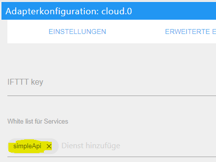

      Hallo ich bin etwas ratlos, habe eine neue Windows10 Installation aufgesetzt und versuche so nach und nach alles was auf der alten Maschine lief, nun auch auf der neuen Maschine ans laufen zu bekommen.
      Folgendes Script sollte Daten aus einem entfernten Rechner holen:
      /*****Castrop saugt Daten aus Giethoorn *****************
      **    Mai 2021
      **    Cloud-Adapter, Zigbee
      **    angelegt:03.05.21
      **    geändert:04.05.21; 12.07.21
      //Temperatur Außen
      schedule("* * * * *", function () {
      var request = require('request');
      const linkOS = "https://iobroker.pro/service/simpleApi/@pro_michaelxxxx@web.de_71de5ba0-989f-11e8-xxxx-1998b1185xxx/getPlainValue/hm-rpc.2.00185BE98B3FCA.1.ACTUAL_TEMPERATURE";
      request(linkOS, function(error, response, body) {
            if (error) {
                log('Error from request:' + error, 'error');
            } else {
                var result = JSON.parse(body);
                          setState("javascript.0.Castrop.OS", result);
                log("Temp. Außen: " +result +" °C");
      Der log des Scriptes sieht so aus:
      11:22:00.342	info	javascript.0 (7996) script.js.Castrop.Daten_Castrop: setForeignState(id=javascript.0.Castrop.OS, state={"val":{"error":"blocked"},"ack":false,"c":"script.js.Castrop.Daten_Castrop"})
      11:22:00.343	info	javascript.0 (7996) script.js.Castrop.Daten_Castrop: Temp. Außen: [object Object] °C
      cloud.0	2022-01-05 11:26:06.723	warn	(5300) Received service "simpleApi", but it is not found in whitelist
      cloud.0	2022-01-05 11:26:06.722	warn	(5300) Received service "simpleApi", but it is not found in whitelist
      cloud.0	2022-01-05 11:26:06.721	warn	(5300) Received service "simpleApi", but it is not found in whitelist
      cloud.0	2022-01-05 11:26:06.720	warn	(5300) Received service "simpleApi", but it is not found in whitelist
      cloud.0	2022-01-05 11:26:06.719	warn	(5300) Received service "simpleApi", but it is not found in whitelist
      cloud.0	2022-01-05 11:26:06.718	warn	(5300) Received service "simpleApi", but it is not found in whitelist
      cloud.0	2022-01-05 11:26:06.717	warn	(5300) Received service "simpleApi", but it is not found in whitelist
      cloud.0	2022-01-05 11:26:06.716	warn	(5300) Received service "simpleApi", but it is not found in whitelist
      cloud.0	2022-01-05 11:26:06.715	warn	(5300) Received service "simpleApi", but it is not found in whitelist
      cloud.0	2022-01-05 11:26:06.714	warn	(5300) Received service "simpleApi", but it is not found in whitelist
      cloud.0	2022-01-05 11:26:06.713	warn	(5300) Received service "simpleApi", but it is not found in whitelist
      Edit: Hier ist die Whitelist und muss der entsprechende Services zu hinterlegt, war falsch geschrieben 🤷‍♂️
      Michael
        Ahnungsbefreit @michihorn last edited by
        @michihorn Schau mal in den Einstellungen des iot-Adapters, im Tab "Services und IFTTT". Da ist sowohl die richtige URL-Syntax definiert, als auch die Whitelist.
