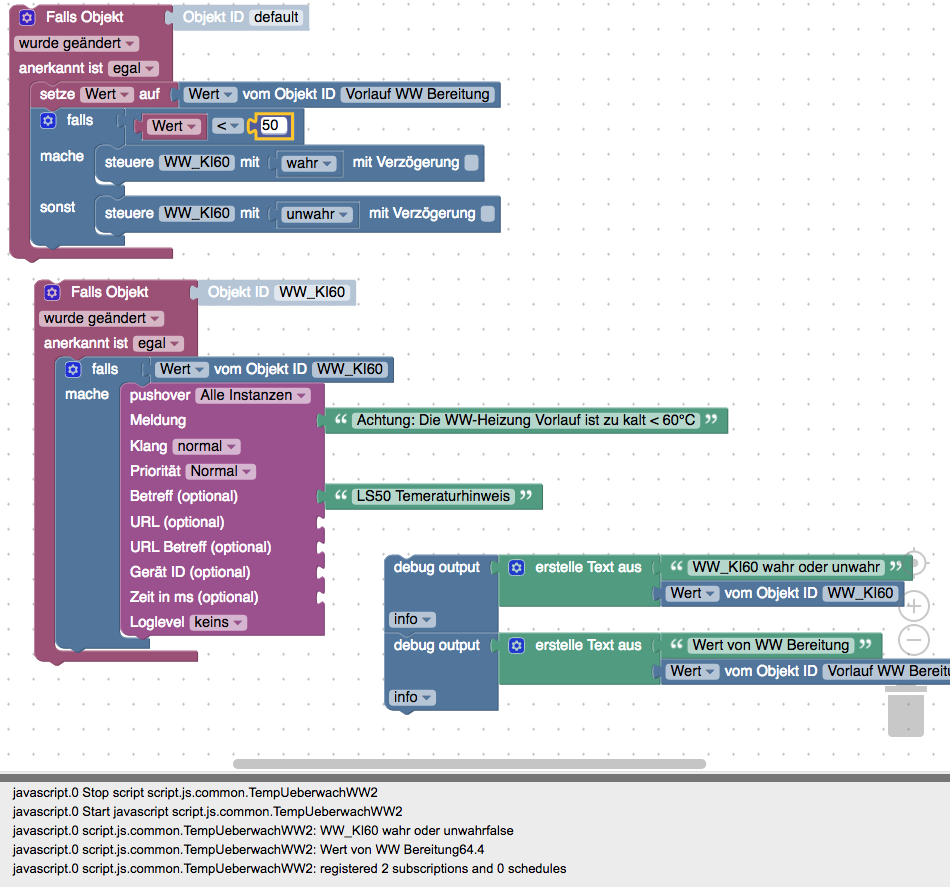

    4. "Wait" in blockly?
    "Wait" in blockly?
      Mac last edited by
      So, hab ich bisher noch nicht gemacht?
      <xml xmlns="http://www.w3.org/1999/xhtml"><block type="on" id="JQK^0|z(du)IM*U6TwJG" x="-287" y="-162"><field name="OID">knx.1.Heizungskeller.Temperaturfühler.Vorlauf_WW_Bereitung</field>
      <statement name="STATEMENT"><block type="controls_if" id=".B.X5K){dsZl]:/^=lLe"><value name="IF0"><block type="logic_compare" id="WwH:4O`a{h[2:+TZUone"><field name="OP">LT</field>
              <value name="A"><block type="convert_tonumber" id="Y^`a;t/+NBzH]%IUFz2v"><value name="VALUE"><block type="on_source" id="bhR_~?IvaV|{*ybh^]RQ"><field name="ATTR">state.val</field></block></value></block></value>
              <value name="B"><block type="math_number" id="un=0::SIrHLcE+o*A*={"><field name="NUM">55</field></block></value></block></value>
          <statement name="DO0"><block type="pushover" id="u--/U[0+PAM8{}c0b61s"><field name="SOUND">siren</field>
              <field name="PRIORITY">1</field>
              <value name="MESSAGE"><shadow type="text" id="KC,0;:gM^:5s}:7-O.wb"><field name="TEXT">text</field></shadow>
                <block type="text" id=";zQua-=(yd6}*?TiU;Kl"><field name="TEXT">Achtung: Die WW-Heizung Vorlauf ist zu kalt < 55°C, bitte Service verständigen.</field></block></value>
              <value name="TITLE"><block type="text" id="cjiw_U0*JpK-nd5?lTOS"><field name="TEXT">LS50 Temoeraturwarnung</field></block></value>
              <next><block type="debug" id="%^xI1?GD2O;Wl678TnE|"><field name="Severity">log</field>
                  <value name="TEXT"><shadow type="text" id="3Bl~5bs^c3P,3V_dc,u4"><field name="TEXT">Achtung: Die WW-Heizung Vorlauf ist zu kalt < 55°C</field></shadow></value></block></next></block></statement></block></statement>
      <next><block type="on_ext" id="`,Z?}tI`A(Z_e8ZqminA"><mutation items="1"></mutation>
          <value name="OID0"><shadow type="field_oid" id="h89UobD}Vg=-]BTFV7TM"><field name="oid">knx.1.Heizungskeller.Temperaturfühler.Vorlauf_WW_Bereitung</field></shadow></value>
          <statement name="STATEMENT"><block type="controls_if" id="{0um4s_71S121vyB,Zw,"><value name="IF0"><block type="logic_compare" id="^`!SV,KB)6K4!MK}-:cA"><field name="OP">LT</field>
                  <value name="A"><block type="convert_tonumber" id="_E9Buth1~5|Lzu]T%R;e"><value name="VALUE"><block type="on_source" id="DOE[,j2vjk!y5QX#OZ:{"><field name="ATTR">state.val</field></block></value></block></value>
                  <value name="B"><block type="math_number" id="mom?P`juZv[pF^8p2RYo"><field name="NUM">60</field></block></value></block></value>
              <statement name="DO0"><block type="timeouts_settimeout" id="`z3QFws(tE}Tf-2E~2q9"><field name="NAME">timeout</field>
                  <field name="DELAY">1</field>
                  <statement name="STATEMENT"><block type="pushover" id="*~j)H=w|w]9pQVy7ACZ5"><field name="PRIORITY">0</field>
                      <value name="MESSAGE"><shadow type="text" id="ZGa0=[A(Rr5=*`mjJKMF"><field name="TEXT">text</field></shadow>
                        <block type="text" id="B/z]v77kH7yJdN2a,3u:"><field name="TEXT">Achtung: Die WW-Heizung Vorlauf ist zu kalt < 60°C</field></block></value>
                      <value name="TITLE"><block type="text" id="jr^!Oc2cOrp5Yx#54NI%"><field name="TEXT">LS50 Temeraturhinweis</field></block></value>
                      <next><block type="debug" id="m{}{`G_3gds~pk;C5{I3"><field name="Severity">log</field>
                          <value name="TEXT"><shadow type="text" id="-.FZ?`b}MnO|)-k7Yvb4"><field name="TEXT">Achtung: Die WW-Heizung Vorlauf ist zu kalt < 60°C</field></shadow></value></block></next></block></statement></block></statement></block></statement></block></next></block>
      <block type="controls_whileUntil" id="A|s#1Fr5U;}`^e]ra.1^" x="212" y="363"><field name="MODE">WHILE</field></block></xml>

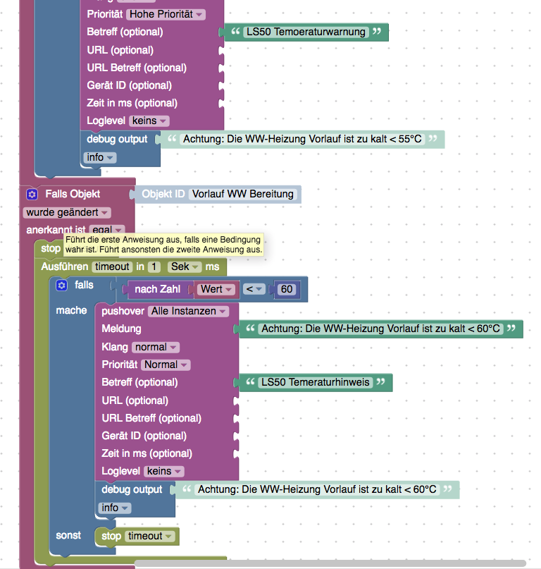

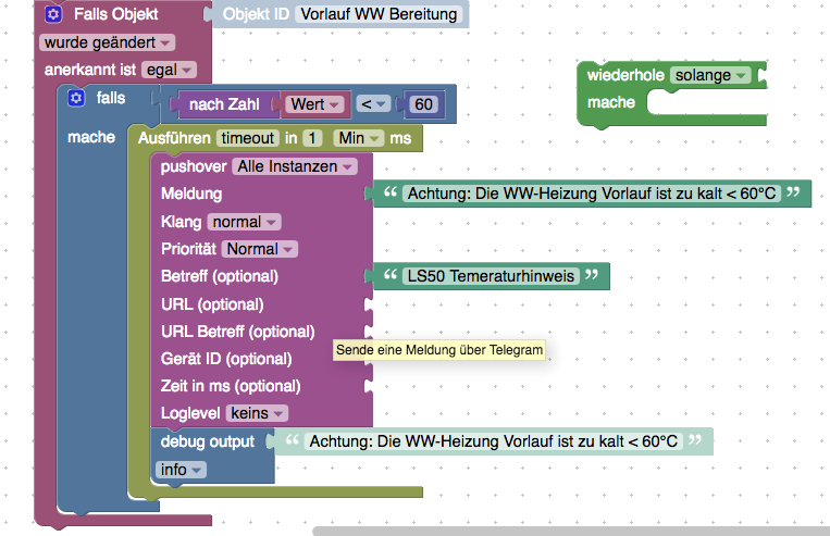

        Probier mal so:
        Ich habe nicht eingebaut das er alle 2-3 minuten wiederhohlt. was jetzt passiert: wen die temperatur sich aendert wird nach einer minute eine meldunge generiert.
        Das passiert jedesmal wen der wert sich erneuert aber kleiner ist als 60 war das was du erreichen woltest ?
            <statement name="STATEMENT"><block type="timeouts_cleartimeout" id=")dU=a:ByKY}!XAWX9@Kq"><field name="NAME">timeout</field>
                <next><block type="timeouts_settimeout" id="`z3QFws(tE}Tf-2E~2q9"><field name="NAME">timeout</field>
                        <statement name="DO0"><block type="pushover" id="*~j)H=w|w]9pQVy7ACZ5"><field name="PRIORITY">0</field>
                                <value name="TEXT"><shadow type="text" id="-.FZ?`b}MnO|)-k7Yvb4"><field name="TEXT">Achtung: Die WW-Heizung Vorlauf ist zu kalt < 60°C</field></shadow></value></block></next></block></statement></block></statement></block></next></block></statement></block></next></block></xml>

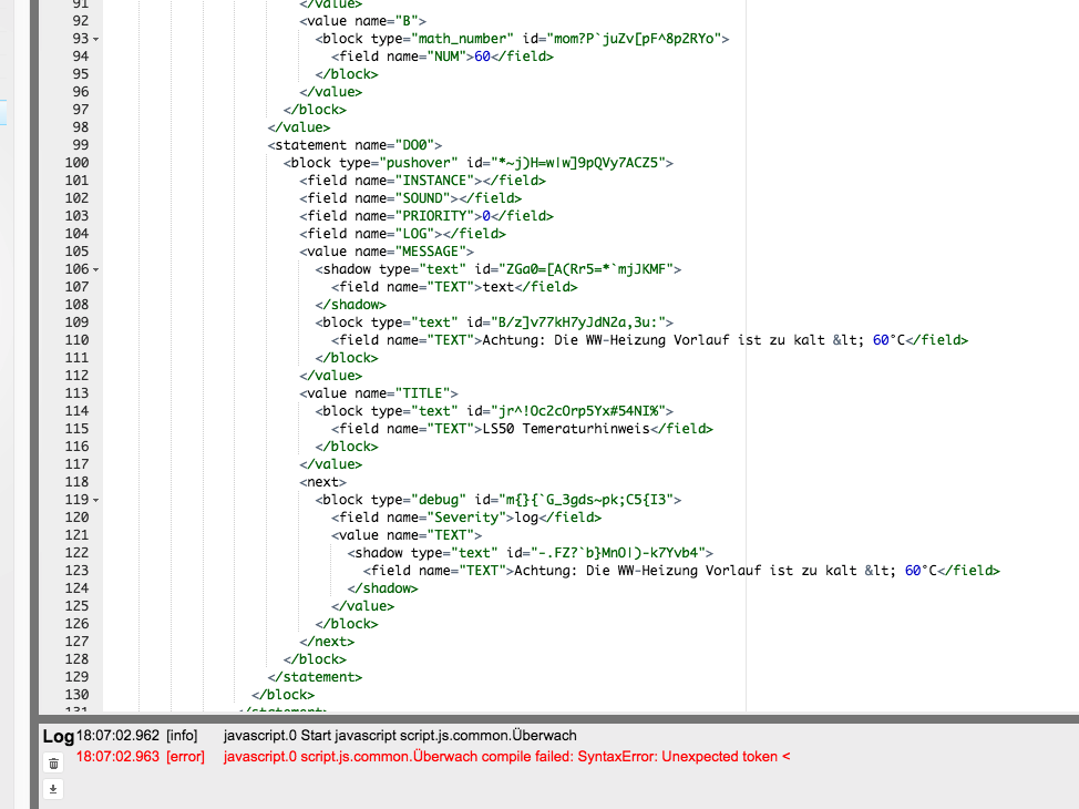

          Ist es richtig, dass ich das von Dir überarbeitet Script nicht mehr in Blockly einlesen kann?
          Leider bekomme ich unten eine Fehlermeldung wenn ich starte > unexpected token, daher kann ich nicht probieren, aber im Prinzip richtig, ich wollte nicht alle 10 Sekunden eine Meldung wenn Alarm gegeben wird
          • Dutchman
            Wie hast du es importiert ?
            Mir den Import Knopf hoffe ich?
            Send from mobile device
              Mit dem Import Knopf über der Arbeitsfläche, nicht im Skript-Explorer
                Mac last edited by
                ENTSCHULDIGUNG!
                Tatsächlich habe ich es einfach einkopiert, ist mir eine Lehre, danke. Ab jetzt nur noch den Importknopf, der ist aber auch verrdammt klein. 😐

                          Sorry, leider muß ich zurückrudern. Die Vorschläge mit dem Timeout stop und Timeout funktionieren leider nicht. Egal welche Variante ich probiert habe, der Alarm kommt bei einer Testverzögerung von 1 Sek. im Sekundentakt durch. Beide Varianten, Stop nur oben und Stop oben und unten habe ich probiert.
                          Zur Frage was das Ganze soll. In einem Mehrfamilienhaus haben wir sogenannte Frischwasserstationen, diese werden wie ein Durchlauferhitzer mit diesem WW-Heizvorauf im Gegenstrom betrieben und erzeugen das Duschwasser direkt in der Wohnung. Dieser Kreis wird aus einem ein m3 Speicher versorgt, ein Mischer sorgt dafür, dass die Vorlauftemperatur nicht über 65 Grad geht wegen der Verkalkung. Wenn die eine oder zwei Familien Duschen wir ad hoc eine sehr große Leistung abgefordert, es gibt immer seine starke Verzögerung, bis der Fühler die abgefallene Temperatur merkt und das Vebtil dann reagiert. Eine Familie im Erdgeschoß hat immer sehr stark schwankende Temperaturen es sehr schwierig die Speichertemperatur, WW Heizvorlauf ins richtige Verhältnis zu setzen. Der untere Wert unter 60 °C taucht immer für kurze Zeit ab, dann reißt das Ventil auf , schließt dann wieder usw.
                          Der Temperaturwert kommt von einer KNX Meßstelle, die verläßlich die richtige Temperatur vorgibt. Dieses Objekt habe ich "Vorlauf WW Bereitung" genannt.
                          Um schnell reagieren zu könne hilft mir der "Voralarm". Der richtige Alarm ist dann bei 55°C, dann ist wirklich etwas defekt.
                          ! <xml 1999/xmlns="<URL url=" http:/www.w3.org/xhtml"="">http://www.w3.org/1999/xhtml">
                          ! <block type="on" id="JQK^0|z(du)IMU6TwJG" x="-412" y="-387"><field name="OID">knx.1.Heizungskeller.Temperaturfühler.Vorlauf_WW_Bereitung</field>
                          ! <field name="CONDITION">ne</field>
                          ! <statement name="STATEMENT"><block type="controls_if" id=".B.X5K){dsZl]:/^=lLe"><value name="IF0"><block type="logic_compare" id="WwH:4Oa{h[2:+TZUone"><field name="OP">LT</field> ! <value name="A"><block type="convert_tonumber" id="Y^a;t/+NBzH]%IUFz2v"><value name="VALUE"><block type="on_source" id="bhR_~?IvaV|{ybh^]RQ"><field name="ATTR">state.val</field></block></value></block></value>
                          ! <value name="B"><block type="math_number" id="un=0::SIrHLcE+o
                          A
                          ! <statement name="DO0"><block type="pushover" id="u–/U[0+PAM8{}c0b61s"><field name="SOUND">siren</field>
                          ! <field name="PRIORITY">1</field>
                          ! <value name="MESSAGE"><shadow type="text" id="KC,0;:gM^:5s}:7-O.wb"><field name="TEXT">text</field></shadow>
                          ! <block type="text" id=";zQua-=(yd6}?TiU;Kl"><field name="TEXT">Achtung: Die WW-Heizung Vorlauf ist zu kalt < 55°C, bitte Service verständigen.</field></block></value>
                          ! <value name="TITLE"><block type="text" id="cjiw_U0
                          ! <next><block type="debug" id="%^xI1?GD2O;Wl678TnE|"><field name="Severity">log</field>
                          ! <value name="TEXT"><shadow type="text" id="3Bl~5bs^c3P,3V_dc,u4"><field name="TEXT">Achtung: Die WW-Heizung Vorlauf ist zu kalt < 55°C</field></shadow></value></block></next></block></statement></block></statement>
                          ! <next><block type="on_ext" id=",Z?}tIA(Z_e8ZqminA"><mutation items="1"></mutation>
                          ! <value name="OID0"><shadow type="field_oid" id="h89UobD}Vg=-]BTFV7TM"><field name="oid">knx.1.Heizungskeller.Temperaturfühler.Vorlauf_WW_Bereitung</field></shadow></value>
                          ! <statement name="STATEMENT"><block type="timeouts_cleartimeout" id=")dU=a:ByKY}!XAWX9@Kq"><field name="NAME">timeout</field>
                          ! <next><block type="timeouts_settimeout" id="z3QFws(tE}Tf-2E~2q9"><field name="NAME">timeout</field> ! <field name="DELAY">1</field> ! <field name="UNIT">sec</field> ! <statement name="STATEMENT"><block type="controls_if" id="{0um4s_71S121vyB,Zw,"><mutation else="1"></mutation> ! <value name="IF0"><block type="logic_compare" id="^!SV,KB)6K4!MK}-:cA"><field name="OP">LT</field>
                          ! <value name="A"><block type="convert_tonumber" id="_E9Buth1~5|Lzu]T%R;e"><value name="VALUE"><block type="on_source" id="DOE[,j2vjk!y5QX#OZ:{"><field name="ATTR">state.val</field></block></value></block></value>
                          ! <value name="B"><block type="math_number" id="mom?PjuZv[pF^8p2RYo"><field name="NUM">60</field></block></value></block></value> ! <statement name="DO0"><block type="pushover" id="*~j)H=w|w]9pQVy7ACZ5"><field name="PRIORITY">0</field> ! <value name="MESSAGE"><shadow type="text" id="ZGa0=[A(Rr5=*mjJKMF"><field name="TEXT">text</field></shadow>
                          ! <block type="text" id="B/z]v77kH7yJdN2a,3u:"><field name="TEXT">Achtung: Die WW-Heizung Vorlauf ist zu kalt < 60°C</field></block></value>
                          ! <value name="TITLE"><block type="text" id="jr^!Oc2cOrp5Yx#54NI%"><field name="TEXT">LS50 Temeraturhinweis</field></block></value>
                          ! <next><block type="debug" id="m{}{G_3gds~pk;C5{I3"><field name="Severity">log</field> ! <value name="TEXT"><shadow type="text" id="-.FZ?b}MnO|)-k7Yvb4"><field name="TEXT">Achtung: Die WW-Heizung Vorlauf ist zu kalt < 60°C</field></shadow></value></block></next></block></statement>
                          ! <statement name="ELSE"><block type="timeouts_cleartimeout" id="T8jIG:vZkU?g8eDqa497"><field name="NAME">timeout</field></block></statement></block></statement></block></next></block></statement></block></next></block></xml>
                            Mac last edited by
                            Hallo Uwe,
                            klappt gut mit dem Tapatalk, hab ich mir auch gerade eingerichtet.
                            Jetzt klappt es tatsächlich super, ich habs ausgiebig getestet kommt eine Meldung durch, dann Ruhe bis zum nächsten Eintreten der Störung, vielen Dank.
                            Das ist die eleganteste Lösung, der Ansatz mit dem Stop Timeout klappt leider doch nicht.
                            Noch nachgeschoben zur Erläuterung der Nutzung:
                            In unserem Mehrfamilienhaus haben wir sogenannte Frischwasserstationen, diese werden wie ein Durchlauferhitzer mit diesem WW-Heizvorauf im Gegenstrom betrieben und erzeugen das Duschwasser direkt in der Wohnung. Dieser Kreis wird aus einem ein m3 Speicher versorgt, ein Mischer sorgt dafür, dass die Vorlauftemperatur nicht über 65 Grad geht wegen der Verkalkung. Wenn die eine oder zwei Familien Duschen wir ad hoc eine sehr große Leistung abgefordert, es gibt immer seine starke Verzögerung, bis der Fühler die abgefallene Temperatur merkt und das Vebtil dann reagiert. Eine Familie im Erdgeschoß hat immer sehr stark schwankende Temperaturen es sehr schwierig die Speichertemperatur, WW Heizvorlauf ins richtige Verhältnis zu setzen. Der untere Wert unter 60 °C taucht immer für kurze Zeit ab, dann reißt das Ventil auf, schließt dann wieder, fängt dann an stark zu pendeln usw.

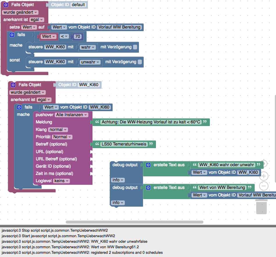

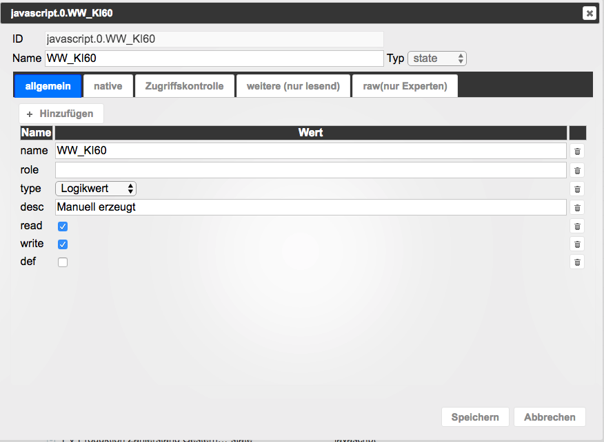

                              Noch eine Frage bitte, da es jetzt so gut funktioniert:
                              Kann ich aus den False/True Zuständen von "WW_KI60", wenn ich sie speichere eine Liste erzeugen - wann wie lange die Störung anstand, und wäre das sehr aufwendig?
                              • Dutchman
                                @Mac:
                                Kann ich aus den False/True Zuständen von "WW_KI60", wenn ich sie speichere eine Liste erzeugen - wann wie lange die Störung anstand, und wäre das sehr aufwendig? `
                                Jup das geht mir flot oder vis und history Tabelle
