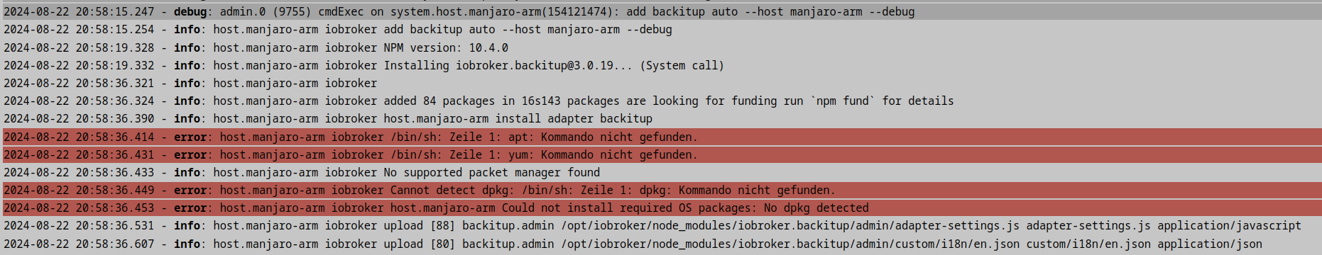

        im ioBroker Protokolle, nur beim Installieren bzw. Update. Heute nochmals getestet mit Debug-Modus:
        2024-08-22 20:58:15.247 - debug: admin.0 (9755) cmdExec on system.host.manjaro-arm(154121474): add backitup auto --host manjaro-arm --debug
        2024-08-22 20:58:15.254 - info: host.manjaro-arm iobroker add backitup auto --host manjaro-arm --debug
        2024-08-22 20:58:19.328 - info: host.manjaro-arm iobroker NPM version: 10.4.0
        2024-08-22 20:58:19.332 - info: host.manjaro-arm iobroker Installing iobroker.backitup@3.0.19... (System call)
        2024-08-22 20:58:36.321 - info: host.manjaro-arm iobroker
        2024-08-22 20:58:36.324 - info: host.manjaro-arm iobroker added 84 packages in 16s143 packages are looking for funding run `npm fund` for details
        2024-08-22 20:58:36.390 - info: host.manjaro-arm iobroker host.manjaro-arm install adapter backitup
        2024-08-22 20:58:36.414 - error: host.manjaro-arm iobroker /bin/sh: Zeile 1: apt: Kommando nicht gefunden.
        2024-08-22 20:58:36.431 - error: host.manjaro-arm iobroker /bin/sh: Zeile 1: yum: Kommando nicht gefunden.
        2024-08-22 20:58:36.433 - info: host.manjaro-arm iobroker No supported packet manager found
        2024-08-22 20:58:36.449 - error: host.manjaro-arm iobroker Cannot detect dpkg: /bin/sh: Zeile 1: dpkg: Kommando nicht gefunden.
        2024-08-22 20:58:36.453 - error: host.manjaro-arm iobroker host.manjaro-arm Could not install required OS packages: No dpkg detected
