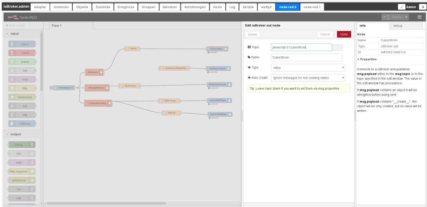

                Fangen wir mal mit einem Beispiel an aufdem ich dann aufbauen kann.
                -LED über VIS Toogle Button an und aus schalten
                -LED über Hardwaretaster An/Aus schalten und Status in Vis wiedergeben
                [{"id":"594403d2.805d04","type":"ioBroker in","z":"d8714f41.d99c8","name":"","topic":"LED AN/AUS","payloadType":"value","onlyack":"","func":"all","gap":"","x":165,"y":260,"wires":[["7faff1d9.b90d18"]]},{"id":"7faff1d9.b90d18","type":"rpi-gpio out","z":"d8714f41.d99c8","name":"","pin":"11","set":"","level":"0","out":"out","x":438,"y":261,"wires":[]},{"id":"4008e29b.c56afc","type":"ioBroker out","z":"d8714f41.d99c8","name":"","topic":"Status LED","ack":"false","autoCreate":"false","x":462,"y":423,"wires":[]},{"id":"d382645c.40a4","type":"rpi-gpio in","z":"d8714f41.d99c8","name":"Taster","pin":"12","intype":"in","debounce":"25","read":false,"x":152,"y":424,"wires":[["4008e29b.c56afc","a0fabe08.30bab"]]},{"id":"a0fabe08.30bab","type":"rpi-gpio out","z":"d8714f41.d99c8","name":"","pin":"11","set":"","level":"0","out":"out","x":443,"y":377,"wires":[]},{"id":"23456bd8.33e084","type":"comment","z":"d8714f41.d99c8","name":"LED AN, LED AUS","info":"LED AN\nLED AUS","x":484,"y":489,"wires":[]},{"id":"7daf7c44.a706d4","type":"comment","z":"d8714f41.d99c8","name":"Toogle Button","info":"","x":178,"y":186,"wires":[]},{"id":"69c4fa4d.67fd9c","type":"comment","z":"d8714f41.d99c8","name":"Hardware Taster","info":"","x":183,"y":487,"wires":[]}]

                      OK,
                      1. In .vis einen Toogle Button (ON/OFF) der eine LED Am Gpio 1 an und aus schaltet
                      2. An Gpio 2 einen Taster der die LED am Gpio 3 an und aus schaltet (das ist ja nur in Node-Red). Der Status der LED soll dann wiederum in .vis angezeigt werden z.B. als leuchtende oder nicht leuchtende Glühbirne
                      (Die Gipo nummer ist Frei erfunden, nur als Beispiel)

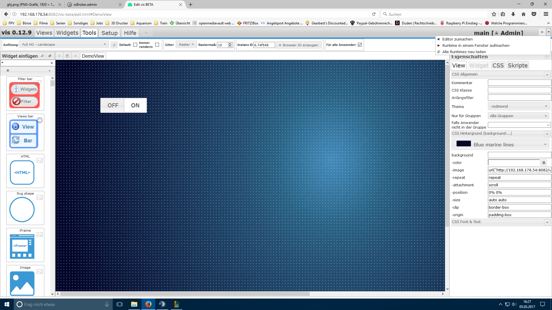

                              Ok, ich habs schon.
                              Man kann die knöpfe im Edit zwar anklicken aber die haben keine Auswirkung.

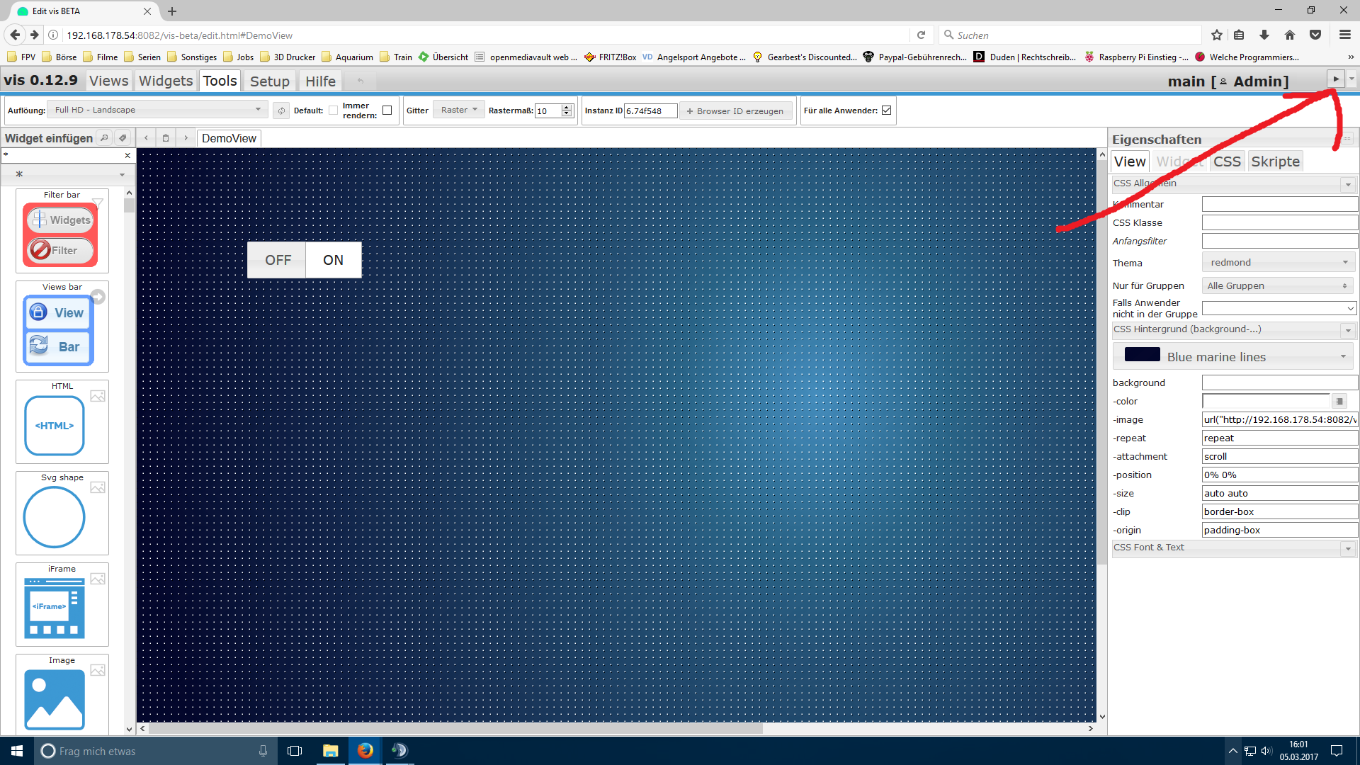

                              (mir ist ein Fehler in der Beta von .vis aufgefallen. Ich nehme an, dass man oben Rechts in .vis auf dem Pfeil nach rechts den Index(also die Seite) öffnet oder? Ich komme da aber immer auf eine about:blank Seite.)
                                @Gummix:
                                Ok, ich habs schon.
                                Man kann die knöpfe im Edit zwar anklicken aber die haben keine Auswirkung. `
                                Da soll einer erst draufkommen, dass du im Edit den Switch bedienst 😄
                                @Gummix:
                                Ich nehme an, dass man oben Rechts in .vis auf dem Pfeil nach rechts den Index(also die Seite) öffnet oder? `
                                wo genau??

                                  Der im Anhang.
                                  Der soll doch zum Index wechseln oder ?
                                  Er bringt mich nur auf "about:blank"
                                    ich habe da keinen Pfeil, sondern das x zum Schließen
                                    Habe extra nochmal auf die neueste Version upgedated - bleibt ein Kreuz
                                    Rainer
                                    • G
                                      Gummix last edited by
                                      Das Kreuz ist zum schließen des Editors:
                                        @Gummix:
                                        Das Kreuz ist zum schließen des Editors: `
                                        genau:
                                        @Homoran:
                                        sondern das x zum Schließen `
                                        Nachdem ich jetzt einmal über das Pulldown auf den play-button geklickt habe bleibt dieser jetzt auch dauerhaft anstelle des x :idea:
                                        Aber bei mir ging der gleiche View nochmal auf.
