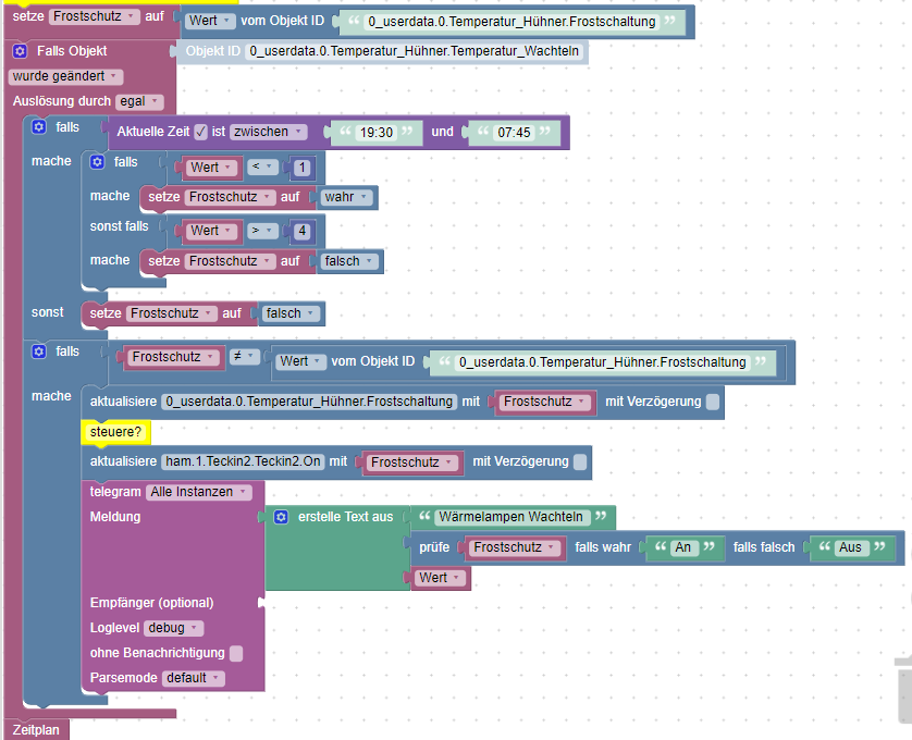

        paul53 @Fritzk last edited by paul53
        @fritzk
        Habe den Temperatur-Trigger-Teil geändert:
         <variables>
           <variable id="v+(iUiNUmNP=QoJnb?Qp">Frostschutz</variable>
         </variables>
         <block type="comment" id=")Jk19jT?sl0`uk0VePrf" x="-488" y="-137">
           <field name="COMMENT">Verhindern von gleichen Mitteilungen</field>
             <block type="variables_set" id="nt=7%,[rFtAb@?U)B]Dh">
               <field name="VAR" id="v+(iUiNUmNP=QoJnb?Qp">Frostschutz</field>
                 <block type="get_value_var" id="~4TVc#i_OEndR~g?k)Ze">
                   <value name="OID">
                     <shadow type="text" id="_5.2AL/Y-rqU@OIq6I=N">
                       <field name="TEXT">0_userdata.0.Temperatur_Hühner.Frostschaltung</field>
                 <block type="on_ext" id="{yVknQbfa981*7rKA-1x">
                   <value name="OID0">
                     <shadow type="field_oid" id="4/Gaf8fh.J~Jr`J^h(UD">
                       <field name="oid">0_userdata.0.Temperatur_Hühner.Temperatur_Wachteln</field>
                     <block type="controls_if" id="9KkkOf:+IbSJPd)#_*nC">
                         <block type="time_compare_ex" id="s6R;tt}!s|;XiXgwRvQk">
                           <mutation xmlns="http://www.w3.org/1999/xhtml" end_time="true" actual_time="true"></mutation>
                           <value name="START_TIME">
                             <shadow type="text" id="wkFl#n),/`p2YM#fG+e-">
                               <field name="TEXT">19:30</field>
                           <value name="END_TIME">
                             <shadow type="text" id="OY*v-^jQi]vQHtKpY:tn">
                               <field name="TEXT">07:45</field>
                         <block type="controls_if" id="s=Yq8}In[=RcBN]GQ@[g">
                             <block type="logic_compare" id="Y!8B`p3`:Pa]62NSMuLR">
                               <field name="OP">LT</field>
                                 <block type="on_source" id="onR.Nj:B:@Px$dC1EPX,">
                                 <block type="math_number" id="8e5UboxC3NpEQluqi!ol">
                                   <field name="NUM">1</field>
                             <block type="variables_set" id="_8YD+n(0cdD6daU-lLqQ">
                                 <block type="logic_boolean" id="%rA^{O=xM1!65+.Y4GLf">
                           <value name="IF1">
                             <block type="logic_compare" id="(.kq5W?87-y{D:oVx=hN">
                               <field name="OP">GT</field>
                                 <block type="on_source" id="BiUADk:V=[1+*`yBMy0k">
                                 <block type="math_number" id="ib:)Ud4Dd~{g!`#6z9`3">
                                   <field name="NUM">4</field>
                           <statement name="DO1">
                             <block type="variables_set" id="[smyd*l{Tzx:(|:N]{ND">
                                 <block type="logic_boolean" id="pPObiFrvB9a(!?WzqxIZ">
                       <statement name="ELSE">
                         <block type="variables_set" id="l.[Z@00}s9p3K(BEkS$l">
                             <block type="logic_boolean" id="DW#$PT}]4ni.^CLOQCZQ">
                         <block type="controls_if" id="}trNP+YjoPI6`3gRex?X">
                             <block type="logic_compare" id="Vi^#q8QR#{%.#EVqC6Le">
                               <field name="OP">NEQ</field>
                                 <block type="variables_get" id="yg,nNRfPh[[cU~=%X^=~">
                                 <block type="get_value_var" id="#b^6[(p2GpaLW[}LKS7,">
                                   <value name="OID">
                                     <shadow type="text" id="S_7;@rxU]7_#(KG{)_%G">
                             <block type="update" id="@0SZS=1J@!Ut9XDqilG9">
                               <field name="OID">0_userdata.0.Temperatur_Hühner.Frostschaltung</field>
                                 <block type="variables_get" id="oNRh|M?Po-:33B_C|5p7">
                                 <block type="comment" id="eq/|CBI}%H?$sM*B+2m-">
                                   <field name="COMMENT">steuere</field>
                                     <block type="update" id=":uzCJh{dIM~mQLBb9;%.">
                                       <field name="OID">ham.1.Teckin2.Teckin2.On</field>
                                         <block type="variables_get" id="AxHAvkNtrSX2gA98rqg~">
                                         <block type="telegram" id="Vd?K?;x9D#lWOI)FawD8">
                                           <field name="LOG">debug</field>
                                           <value name="MESSAGE">
                                             <shadow xmlns="" type="text" id="7qj`Qz3C4Hhcf)`D5yLO">
                                               <field name="TEXT"></field>
                                             <block type="text_join" id="F2d-K@?sVLN+2}:]ronr">
                                               <value name="ADD0">
                                                 <block type="text" id="8UE-$mWh80D2[u^J/e]M">
                                                   <field name="TEXT">Wärmelampen Wachteln </field>
                                               <value name="ADD1">
                                                 <block type="logic_ternary" id="#4:1eVVl,%2F8IwggnDO" inline="false">
                                                   <value name="IF">
                                                     <block type="variables_get" id="E%}[3,j%F7]jJBIzKKm%">
                                                   <value name="THEN">
                                                     <block type="text" id=")+O7x|wbK*G:;2A*$X,i">
                                                       <field name="TEXT">An </field>
                                                   <value name="ELSE">
                                                     <block type="text" id="WA~o2Ah]9*3ZUpR]`6R,">

        Der Datenpunkt "ham.1.Teckin2.Teckin2.On" muss sicherlich mit "steuere" geschrieben werden?
          Fritzk @paul53 last edited by
          @paul53 vielen Dank
          Ich probier es heut abend mal so.
          Der Datenpunkt "ham.1.Teckin2.Teckin2.On" muss nicht mit "steuere" geschrieben werden, kann auch mit aktualisiere angesteuert werden
            Homoran Global Moderator Administrators @Fritzk last edited by
            @fritzk sagte in Hilfe bei Blockly Zeit und Themperatur Steuerung:
            soll die Änderung etwas steuern oder soll nur der Wert aktualisiert werden?
              Fritzk @Homoran last edited by
              @homoran Nein der soll nur von falsch auf wahr gesetzt werden und andersrum auch.
              Das ist nur eine Steckdose da hab ich die Wärmelampe eingesteckt
                Homoran Global Moderator Administrators @Fritzk last edited by Homoran
                und die soll nicht angesteuert werden?
                  @homoran ja schon. In der Zeit von 19: 30 bis 7:45 wenn die Temperatur unter 1 Grad ist soll sie an sein und wenn die Temperatur über 4 Grad ist und definitiv um 8 uhr soll sie aus sein
                    ja schon.
                    dann musst du auch steuere nehmen, sonst wird nur der Wert in ioBroker aktualisiert und die Dose bekommt nichts mit
                      @homoran Achso ja dann mach ich dann werd ich das auch tun.
