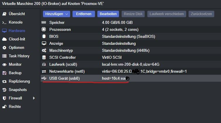

      Den Stick habe ich im Proxmox an die VM durchgereicht:
      Er wird in der VM auch gefunden:
      io-broker@io-broker:~$ ls -la /dev/serial/by-id/
      total 0
      drwxr-xr-x 2 root root 60 Jan 21 19:35 .
      drwxr-xr-x 4 root root 80 Jan 21 19:35 ..
      lrwxrwxrwx 1 root root 13 Jan 21 19:35 usb-ITead_Sonoff_Zigbee_3.0_USB_Dongle_Plus_ecf07515733bec119d56a0957a0af07f-if00-port0 -> ../../ttyUSB0

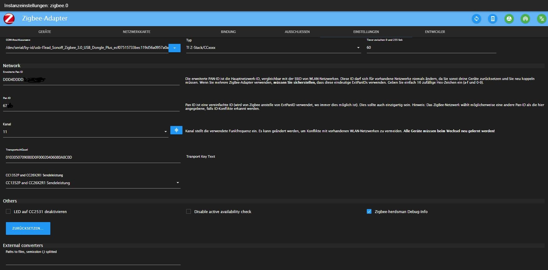

      Die Einstellungen im Zigbee-Adapter habe ich wie folgt gesetzt:

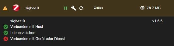

      Der Adaper startet auch, er verbindet sich jedoch nicht:
      Im Log kommen folgende Meldungen:
      zigbee.0
      2022-01-21 19:48:27.979	error	Error herdsman start
      zigbee.0
      2022-01-21 19:48:27.979	error	Failed to start Zigbee
      zigbee.0
      zigbee.0
      zigbee.0
      2022-01-21 19:48:27.978	error	Starting zigbee-herdsman problem : "Error while opening serialport 'Error: Error Resource temporarily unavailable Cannot lock port'"
      zigbee.0
      2022-01-21 19:48:27.769	info	Installed Version: iobroker.zigbee@1.6.6
      zigbee.0
      2022-01-21 19:48:27.757	info	Starting Zigbee npm ...
      zigbee.0
      2022-01-21 19:48:27.756	info	Try to reconnect. 1 attempts left
      zigbee.0
      2022-01-21 19:48:17.754	error	Error herdsman start
      zigbee.0
      2022-01-21 19:48:17.754	error	Failed to start Zigbee
      zigbee.0
      2022-01-21 19:48:17.753	error	Starting zigbee-herdsman problem : "startup failed - configuration-adapter mismatch - see logs above for more information"
      zigbee.0
      2022-01-21 19:48:17.657	error	Re-commissioning your network will require re-pairing of all devices!
      zigbee.0
      2022-01-21 19:48:17.657	error	If you wish to re-commission your network, please remove coordinator backup at /opt/iobroker/iobroker-data/zigbee_0/nvbackup.json.
      zigbee.0
      2022-01-21 19:48:17.657	error	Please update configuration to prevent further issues.
      zigbee.0
      2022-01-21 19:48:17.656	error	- Channel List: configured=11, adapter=11
      zigbee.0
      2022-01-21 19:48:17.656	error	- Network Key: configured=01030507090b0d0f00020406080a0c0d, adapter=01030507090b0d0f00020406080a0c0d
      zigbee.0
      2022-01-21 19:48:17.655	error	- Extended PAN ID: configured=dd2ddd5dddddd4dd, adapter=00124b0024cae298
      zigbee.0
      2022-01-21 19:48:17.655	error	- PAN ID: configured=6746, adapter=6746
      zigbee.0
      2022-01-21 19:48:17.654	error	Configuration is not consistent with adapter state/backup!
      zigbee.0
      2022-01-21 19:48:17.487	info	Installed Version: iobroker.zigbee@1.6.6
      zigbee.0
      2022-01-21 19:48:17.167	info	Starting Zigbee npm ...
      zigbee.0
      2022-01-21 19:48:17.105	info	starting. Version 1.6.6 in /opt/iobroker/node_modules/iobroker.zigbee, node: v12.22.9, js-controller: 3.3.22
      Hat jemand eine Idee woran das liegen könnte, bzw. wo ich suchen müsste?
      Ich habe den Adapter schon mehrfach deinstalliert und wieder installiert.
      Immer das selbe.
      Ich habe auch schon mal den Ordner Zigbbe_0 in /opt/iobroker/iobroker-data/ manuell gelöscht.

      • crunchip
        crunchip Forum Testing Most Active @FreunderNacht last edited by
        @freundernacht probier doch mal in der Instanz Einstellung, den Com Anschlussname aus dem Auswahlmenü, anstatt manuell rein zu schreiben
        FreunderNacht 1 Reply Last reply Reply Quote 0
          Thomas Braun Most Active @FreunderNacht last edited by
          @freundernacht sagte in Fehler Sonoff Zigbee Stick Zigbee Adapter -> Proxmox VM:
          Muss übereinstimmen. Im Adapter anpassen.

            • Asgothian
              Asgothian Developer @FreunderNacht last edited by Asgothian
              @freundernacht Lesen bildet:
              zigbee.0
              zigbee.0
              zigbee.0
              zigbee.0
              zigbee.0
              zigbee.0
              zigbee.0
              zigbee.0
              Da steht genau was nicht ok ist. Manchmal frage ich mich echt warum wir das ins Log schreiben (lassen), wenn es doch keiner liest.
              Du musst entweder 98e2ca24004b1200 als ExtPanId eintragen oder deine Shepherd.db und nvbackup.json (in /opt/iobroker/iobroker-data/zigbee_0) löschen (und alle Geräte neu anlernen)
              A.

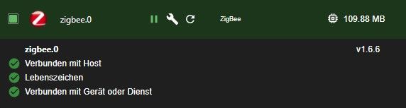

              • FreunderNacht
                FreunderNacht @Asgothian last edited by
                @Thomas-Braun
                @Asgothian
                Danke @Thomas-Braun,
                Danke @Asgothian,
                das war es.
                Manchmal sieht man den Wald vor lauter Bäumen nicht mehr.
                Ich hatte gelesen, das die PAN ID frei vergeben werden kann.
                Tut mir leid, hätte ich wirklich selbst sehen können.
                Vielen Dank

                      • Asgothian
                        @freundernacht um die ExtPanID zu setzen musst du den Adapter starten. Damit wird diese auch auf das Netzwerk angewandt. Deswegen der Hinweis zum löschen der Datei. Wenn nichts angelernt ist ist das of die einfachere Wahl.
                        Löschen der Datei lohnt natürlich nur nachdem der Adapter angehalten wurde.
                        A.
                        • FreunderNacht
                          @asgothian
                          Vielen Dank für die ausführliche Antwort, das hat mir sehr geholfen.
                          Nach dem Stoppen des Adapters und dem löschen des Ordners:
                          Hats dann beim erneuten starten funktioniert.
                          Ich hatte ja eh noch keine Geräte angelernt.
                          • V
                            vqe17235 @Asgothian last edited by
                            @asgothian
                            Hallo zusammen, ich habe anscheinend ein ähnliches Problem... Allerdings taucht ein so detaillierter Log im Protokoll bei mir nicht auf, obwohl ich für den Adapter alles anzeigen lasse. Wie kann ich denn sehen, welche Werte konfiguriert sind, und welche es sein sollten?
                            • crunchip
                              crunchip Forum Testing Most Active @vqe17235 last edited by
                              @vqe17235 die Instanz auf debug stellen.
                              Ohne Fehlermeldung kan man schlecht helfen
