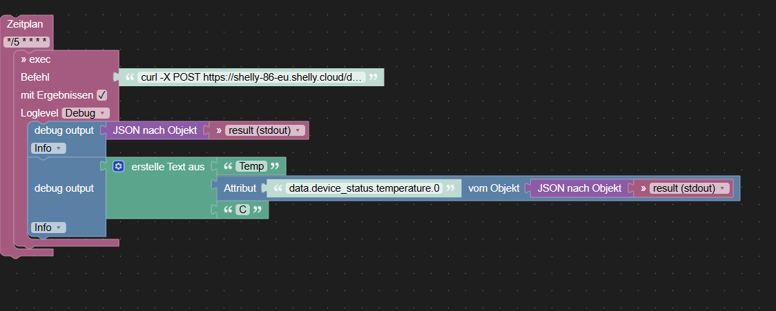

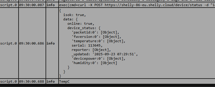

                        benbensimpson2204 last edited by
                        Nabend bräuchte mal eure Hilfe
                        würde gerne den Temperaturwert aus der Shellycloud auslesen und in einem Datenpunkt speichern. Hier mein Blockly
                        hier der output
                        javascript.0	23:06:18.523	info	script.js.common.test.shellycloud: {"isok":true,"data":{"online":true,"device_status":{"ts":1735941967.78,"_updated":"2025-01-03 22:06:08","input:1":{"id":1,"state":false},"serial":3550,"id":"XXXXXXXXXXXX","v_eve:1":{"ev":"","ttl":-1,"id":1},"input:0":{"id":0,"state":false},"wifi":{"sta_ip":"192.168.1.135","status":"got ip","ssid":"RUT241_77A7","rssi":-24},"addons":["temperature:100","voltmeter:100"],"temperature:100":{"id":100,"errors":[],"tC":6.81,"tF":44.26},"input:2":{"id":2,"counts":{"by_minute":[0,0,0],"minute_ts":1735941900,"total":0},"freq":0},"ws":{"connected":false},"sys":{"webhook_rev":109,"mac":"CC7B5C880810","restart_required":false,"time":"04:01","unixtime":1735873286,"uptime":330882,"ram_size":267904,"ram_free":109720,"fs_size":393216,"fs_free":102400,"cfg_rev":48,"kvs_rev":0,"schedule_rev":6,"available_updates":{},"reset_reason":1},"mqtt":{"connected":false},"v_eve:0":{"ev":"","ttl":-1,"id":0},"v_eve:2":{"ev":"","ttl":-1,"id":2},"voltmeter:100":{"id":100,"voltage":12.49,"errors":[]},"switch:0":{"id":0,"output":false,"source":"timer"},"code":"SNSN-0043X","cloud":{"connected":true},"switch:1":{"id":1,"output":false,"source":"timer"},"ble":{}}}}
                        javascript.0	23:06:18.523	info	script.js.common.test.shellycloud: TempC
                        leider bekomme ich kein wert raus, und weiß jetzt auch nicht mehr weiter
                          Alexvoell @benbensimpson2204 last edited by
                          @benbensimpson2204
                          Ich bekomme auch kein Werte heraus beim Shelly Aussentempfühler kann mir bitte jemand helfen

                              Alexvoell @Alexvoell last edited by
                              @alexvoell said in Shelly cloud in ioBroker einbinden:
                              @benbensimpson2204

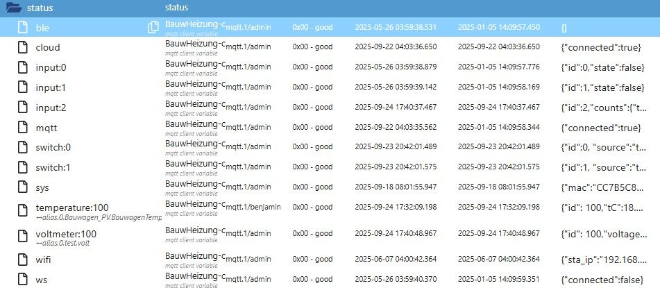

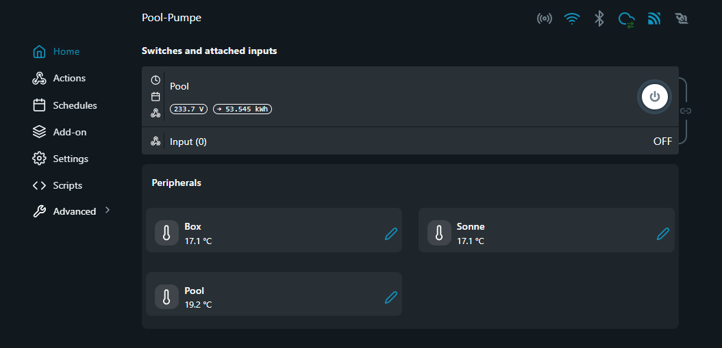

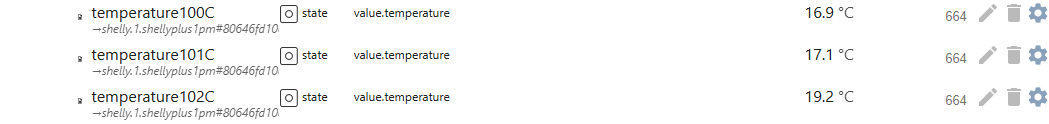

                                was für einen fühler meinst du denn?
                                hab beim pool einen shelly+1pm mit addon und hab im adapter und ioB alle werte drinnen.
                                  Alexvoell @da_Woody last edited by

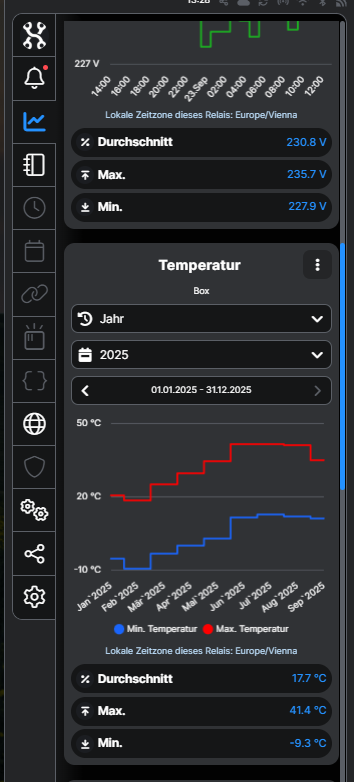

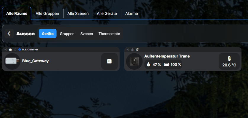

                                  @da_woody Vielen Dank, aber ich kann nur über ein anderes Netzwerk auf diese Sensor zugreifen, benötige des wegen den Cloud-Zugang zwecks Logging der Temperatur über das komplette Jahr.f70b1f10-cb07-42b3-ab44-3ce504ee7c01-image.png
                                  • da_Woody
                                    da_Woody @Alexvoell last edited by
                                    @alexvoell abgesehn davon, daß dein sensor ein update will.
                                    via VPN solltest du ja auf diesen "fühler" zugreifen können in einem anderen netzwerk per IP.
                                    nach 10x lesen glaube ich dein problem zu erkennen! 🤡
                                    du siehst zwar in der APP die werte,
                                    die gibts aber im adapter nicht.
                                    IMHO müsstest du das z.b. in influxdb loggen und dann selbst berechnen.
                                      @da_woody Hallo, vielen Dank für die Unterstützung bzw. den Versuch zu helfen.
                                      Ich möchte den Sensor aus der Ferne – ohne VPN – über die Cloud auslesen und die Daten dort auch loggen.
                                      Das Logging an sich ist mir soweit klar.
                                      Allerdings wird der Sensor, wie im ursprünglichen Beitrag beschrieben, nicht in der Cloud ausgelesen und IOBroker mit der richtigen Temp angezeigt, und ich verstehe nicht, woran das liegt.
