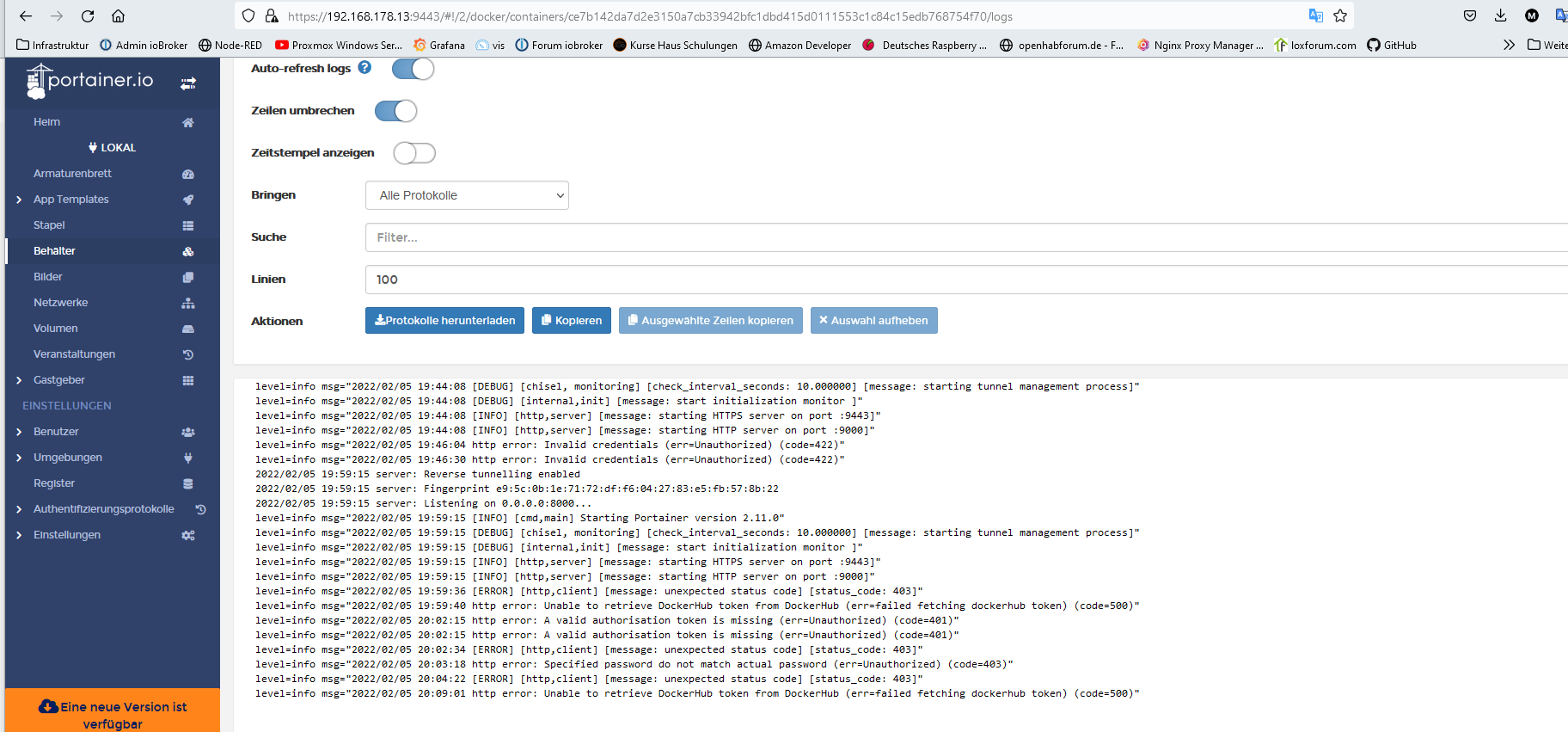

    4. Portainer Fehler ungültiges Token?

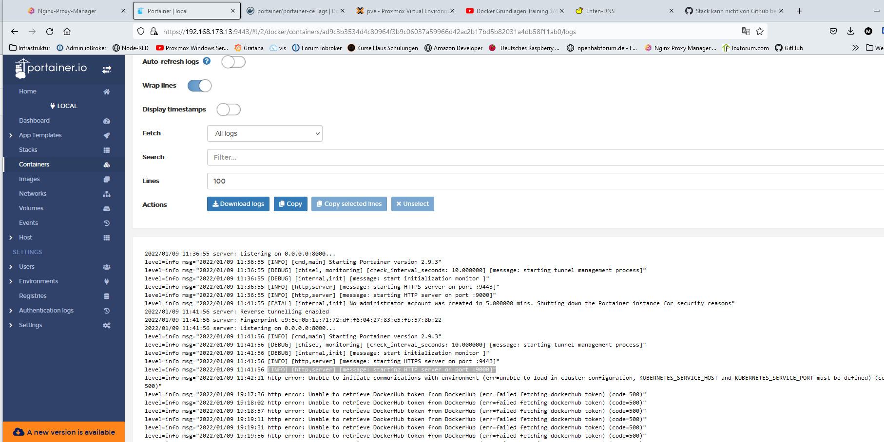

      level=info msg="2022/01/09 11:36:54 [FATAL] [internal,init] No administrator account was created in 5.000000 mins. Shutting down the Portainer instance for security reasons",
      2022/01/09 11:36:55 server: Reverse tunnelling enabled,
      2022/01/09 11:36:55 server: Fingerprint e9:5c:0b:1e:71:72:df:f6:04:27:83:e5:fb:57:8b:22,
      2022/01/09 11:36:55 server: Listening on 0.0.0.0:8000...,
      level=info msg="2022/01/09 11:36:55 [INFO] [cmd,main] Starting Portainer version 2.9.3",
      level=info msg="2022/01/09 11:36:55 [DEBUG] [chisel, monitoring] [check_interval_seconds: 10.000000] [message: starting tunnel management process]",
      level=info msg="2022/01/09 11:36:55 [DEBUG] [internal,init] [message: start initialization monitor ]",
      level=info msg="2022/01/09 11:36:55 [INFO] [http,server] [message: starting HTTPS server on port :9443]",
      level=info msg="2022/01/09 11:36:55 [INFO] [http,server] [message: starting HTTP server on port :9000]",
      level=info msg="2022/01/09 11:41:55 [FATAL] [internal,init] No administrator account was created in 5.000000 mins. Shutting down the Portainer instance for security reasons",
      2022/01/09 11:41:56 server: Reverse tunnelling enabled,
      2022/01/09 11:41:56 server: Fingerprint e9:5c:0b:1e:71:72:df:f6:04:27:83:e5:fb:57:8b:22,
      2022/01/09 11:41:56 server: Listening on 0.0.0.0:8000...,
      level=info msg="2022/01/09 11:41:56 [INFO] [cmd,main] Starting Portainer version 2.9.3",
      level=info msg="2022/01/09 11:41:56 [DEBUG] [chisel, monitoring] [check_interval_seconds: 10.000000] [message: starting tunnel management process]",
      level=info msg="2022/01/09 11:41:56 [DEBUG] [internal,init] [message: start initialization monitor ]",
      level=info msg="2022/01/09 11:41:56 [INFO] [http,server] [message: starting HTTPS server on port :9443]",
      level=info msg="2022/01/09 11:41:56 [INFO] [http,server] [message: starting HTTP server on port :9000]",
      level=info msg="2022/01/09 11:42:11 http error: Unable to initiate communications with environment (err=unable to load in-cluster configuration, KUBERNETES_SERVICE_HOST and KUBERNETES_SERVICE_PORT must be defined) (code=500)",
      level=info msg="2022/01/09 19:17:36 http error: Unable to retrieve DockerHub token from DockerHub (err=failed fetching dockerhub token) (code=500)",
      level=info msg="2022/01/09 19:18:02 http error: Unable to retrieve DockerHub token from DockerHub (err=failed fetching dockerhub token) (code=500)",
      level=info msg="2022/01/09 19:18:57 http error: Unable to retrieve DockerHub token from DockerHub (err=failed fetching dockerhub token) (code=500)",
      level=info msg="2022/01/09 19:19:11 http error: Unable to retrieve DockerHub token from DockerHub (err=failed fetching dockerhub token) (code=500)",
      level=info msg="2022/01/09 19:19:31 http error: Unable to retrieve DockerHub token from DockerHub (err=failed fetching dockerhub token) (code=500)",
      level=info msg="2022/01/09 19:19:56 http error: Unable to retrieve DockerHub token from DockerHub (err=failed fetching dockerhub token) (code=500)",
      level=info msg="2022/01/09 19:20:54 http error: Unable to retrieve DockerHub token from DockerHub (err=failed fetching dockerhub token) (code=500)",
      level=info msg="2022/01/09 19:21:37 http error: Unable to retrieve DockerHub token from DockerHub (err=failed fetching dockerhub token) (code=500)",
      level=info msg="2022/01/09 19:22:43 http error: Unable to retrieve DockerHub token from DockerHub (err=failed fetching dockerhub token) (code=500)",
      level=info msg="2022/01/09 19:24:38 http error: Unable to retrieve DockerHub token from DockerHub (err=failed fetching dockerhub token) (code=500)",
      level=info msg="2022/01/09 19:24:46 http error: Unable to retrieve DockerHub token from DockerHub (err=failed fetching dockerhub token) (code=500)",
      level=info msg="2022/01/09 19:25:58 http error: Unable to retrieve DockerHub token from DockerHub (err=failed fetching dockerhub token) (code=500)",
      level=info msg="2022/01/09 19:39:28 http error: Unable to retrieve DockerHub token from DockerHub (err=failed fetching dockerhub token) (code=500)",
      level=info msg="2022/01/09 19:40:25 http error: Unable to retrieve DockerHub token from DockerHub (err=failed fetching dockerhub token) (code=500)",
      level=info msg="2022/01/09 19:42:22 http error: Invalid JWT token (err=Invalid JWT token) (code=401)",
      level=info msg="2022/01/10 07:15:23 http error: Invalid JWT token (err=Invalid JWT token) (code=401)",
      level=info msg="2022/01/10 07:16:25 http error: Unable to retrieve DockerHub token from DockerHub (err=failed fetching dockerhub token) (code=500)",
      level=info msg="2022/01/10 07:17:13 http error: Unable to retrieve DockerHub token from DockerHub (err=Get \"https://auth.docker.io/token?service=registry.docker.io&scope=repository:ratelimitpreview/test:pull\": context deadline exceeded (Client.Timeout exceeded while awaiting headers)) (code=500)",
      level=info msg="2022/01/10 07:17:26 http error: Unable to retrieve DockerHub token from DockerHub (err=failed fetching dockerhub token) (code=500)",
      level=info msg="2022/01/10 07:19:09 http error: Unable to retrieve DockerHub token from DockerHub (err=failed fetching dockerhub token) (code=500)",
      level=info msg="2022/01/10 07:24:49 http error: Unable to retrieve DockerHub token from DockerHub (err=failed fetching dockerhub token) (code=500)",
      level=info msg="2022/01/10 07:33:38 http error: Unable to retrieve DockerHub token from DockerHub (err=failed fetching dockerhub token) (code=500)",
      level=info msg="2022/01/10 07:35:20 http error: Unable to retrieve DockerHub token from DockerHub (err=failed fetching dockerhub token) (code=500)",
      2022/02/04 19:58:27 server: Reverse tunnelling enabled,
      2022/02/04 19:58:27 server: Fingerprint e9:5c:0b:1e:71:72:df:f6:04:27:83:e5:fb:57:8b:22,
      2022/02/04 19:58:27 server: Listening on 0.0.0.0:8000...,
      level=info msg="2022/02/04 19:58:27 [DEBUG] [chisel, monitoring] [check_interval_seconds: 10.000000] [message: starting tunnel management process]",
      level=info msg="2022/02/04 19:58:27 [INFO] [cmd,main] Starting Portainer version 2.9.3",
      level=info msg="2022/02/04 19:58:27 [DEBUG] [internal,init] [message: start initialization monitor ]",
      level=info msg="2022/02/04 19:58:27 [INFO] [http,server] [message: starting HTTPS server on port :9443]",
      level=info msg="2022/02/04 19:58:27 [INFO] [http,server] [message: starting HTTP server on port :9000]",
      level=info msg="2022/02/04 19:58:38 http error: Invalid JWT token (err=Invalid JWT token) (code=401)",
      level=info msg="2022/02/04 19:58:43 [ERROR] [http,client] [message: unexpected status code] [status_code: 403]",
      level=info msg="2022/02/04 19:58:50 [ERROR] [http,client] [message: unexpected status code] [status_code: 403]",
      level=info msg="2022/02/04 19:58:58 http error: Unable to retrieve DockerHub token from DockerHub (err=failed fetching dockerhub token) (code=500)",
      level=info msg="2022/02/04 19:59:59 http error: Unable to retrieve DockerHub token from DockerHub (err=failed fetching dockerhub token) (code=500)",
      level=info msg="2022/02/04 20:06:34 http error: Unable to retrieve DockerHub token from DockerHub (err=failed fetching dockerhub token) (code=500)",
      level=info msg="2022/02/04 20:06:36 http error: Unable to retrieve DockerHub token from DockerHub (err=failed fetching dockerhub token) (code=500)",
      level=info msg="2022/02/04 20:12:29 http error: Unable to retrieve DockerHub token from DockerHub (err=failed fetching dockerhub token) (code=500)",
      level=info msg="2022/02/04 20:12:31 http error: Unable to retrieve DockerHub token from DockerHub (err=failed fetching dockerhub token) (code=500)",
      level=info msg="2022/02/04 20:14:32 http error: Unable to retrieve DockerHub token from DockerHub (err=failed fetching dockerhub token) (code=500)",
      level=info msg="2022/02/04 20:14:33 http error: Unable to retrieve DockerHub token from DockerHub (err=failed fetching dockerhub token) (code=500)",
      level=info msg="2022/02/04 20:15:14 http error: Unable to retrieve DockerHub token from DockerHub (err=failed fetching dockerhub token) (code=500)",
      level=info msg="2022/02/04 20:15:15 http error: Unable to retrieve DockerHub token from DockerHub (err=failed fetching dockerhub token) (code=500)",
      level=info msg="2022/02/04 20:23:22 http error: Unable to retrieve DockerHub token from DockerHub (err=Get \"https://auth.docker.io/token?service=registry.docker.io&scope=repository:ratelimitpreview/test:pull\": context deadline exceeded (Client.Timeout exceeded while awaiting headers)) (code=500)",
      level=info msg="2022/02/04 20:23:26 http error: Unable to retrieve DockerHub token from DockerHub (err=Get \"https://auth.docker.io/token?service=registry.docker.io&scope=repository:ratelimitpreview/test:pull\": context deadline exceeded (Client.Timeout exceeded while awaiting headers)) (code=500)",
      2022/02/04 20:26:23 server: Reverse tunnelling enabled,
      2022/02/04 20:26:23 server: Fingerprint e9:5c:0b:1e:71:72:df:f6:04:27:83:e5:fb:57:8b:22,
      2022/02/04 20:26:23 server: Listening on 0.0.0.0:8000...,
      level=info msg="2022/02/04 20:26:23 [DEBUG] [chisel, monitoring] [check_interval_seconds: 10.000000] [message: starting tunnel management process]",
      level=info msg="2022/02/04 20:26:23 [INFO] [cmd,main] Starting Portainer version 2.9.3",
      level=info msg="2022/02/04 20:26:23 [DEBUG] [internal,init] [message: start initialization monitor ]",
      level=info msg="2022/02/04 20:26:23 [INFO] [http,server] [message: starting HTTPS server on port :9443]",
      level=info msg="2022/02/04 20:26:23 [INFO] [http,server] [message: starting HTTP server on port :9000]",
      level=info msg="2022/02/04 20:26:32 http error: Invalid JWT token (err=Invalid JWT token) (code=401)",
      level=info msg="2022/02/04 20:26:33 http error: Invalid JWT token (err=Invalid JWT token) (code=401)",
      level=info msg="2022/02/04 20:26:37 [ERROR] [http,client] [message: unexpected status code] [status_code: 403]",
      level=info msg="2022/02/04 20:26:53 http error: Unable to retrieve DockerHub token from DockerHub (err=failed fetching dockerhub token) (code=500)",
      level=info msg="2022/02/04 20:27:20 http error: Unable to retrieve DockerHub token from DockerHub (err=failed fetching dockerhub token) (code=500)",
      2022/02/04 20:31:50 server: Reverse tunnelling enabled,
      2022/02/04 20:31:50 server: Fingerprint e9:5c:0b:1e:71:72:df:f6:04:27:83:e5:fb:57:8b:22,
      2022/02/04 20:31:50 server: Listening on 0.0.0.0:8000...,
      level=info msg="2022/02/04 20:31:50 [DEBUG] [chisel, monitoring] [check_interval_seconds: 10.000000] [message: starting tunnel management process]",
      level=info msg="2022/02/04 20:31:50 [INFO] [cmd,main] Starting Portainer version 2.9.3",
      level=info msg="2022/02/04 20:31:50 [DEBUG] [internal,init] [message: start initialization monitor ]",
      level=info msg="2022/02/04 20:31:50 [INFO] [http,server] [message: starting HTTPS server on port :9443]",
      level=info msg="2022/02/04 20:31:50 [INFO] [http,server] [message: starting HTTP server on port :9000]",
      level=info msg="2022/02/04 20:31:51 http error: Invalid JWT token (err=Invalid JWT token) (code=401)",
      level=info msg="2022/02/04 20:32:48 [ERROR] [http,client] [message: unexpected status code] [status_code: 403]"

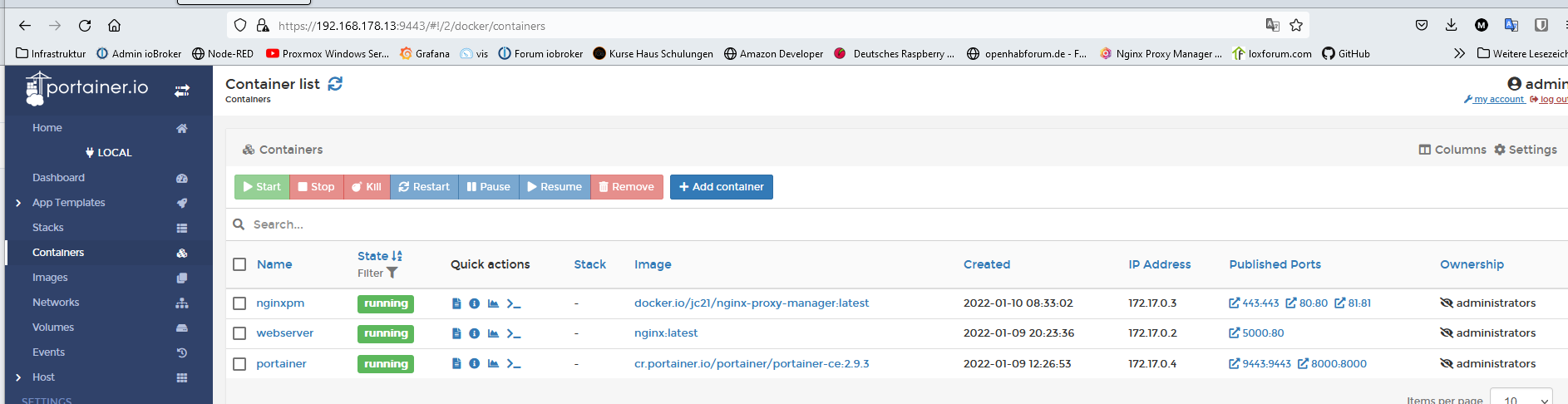

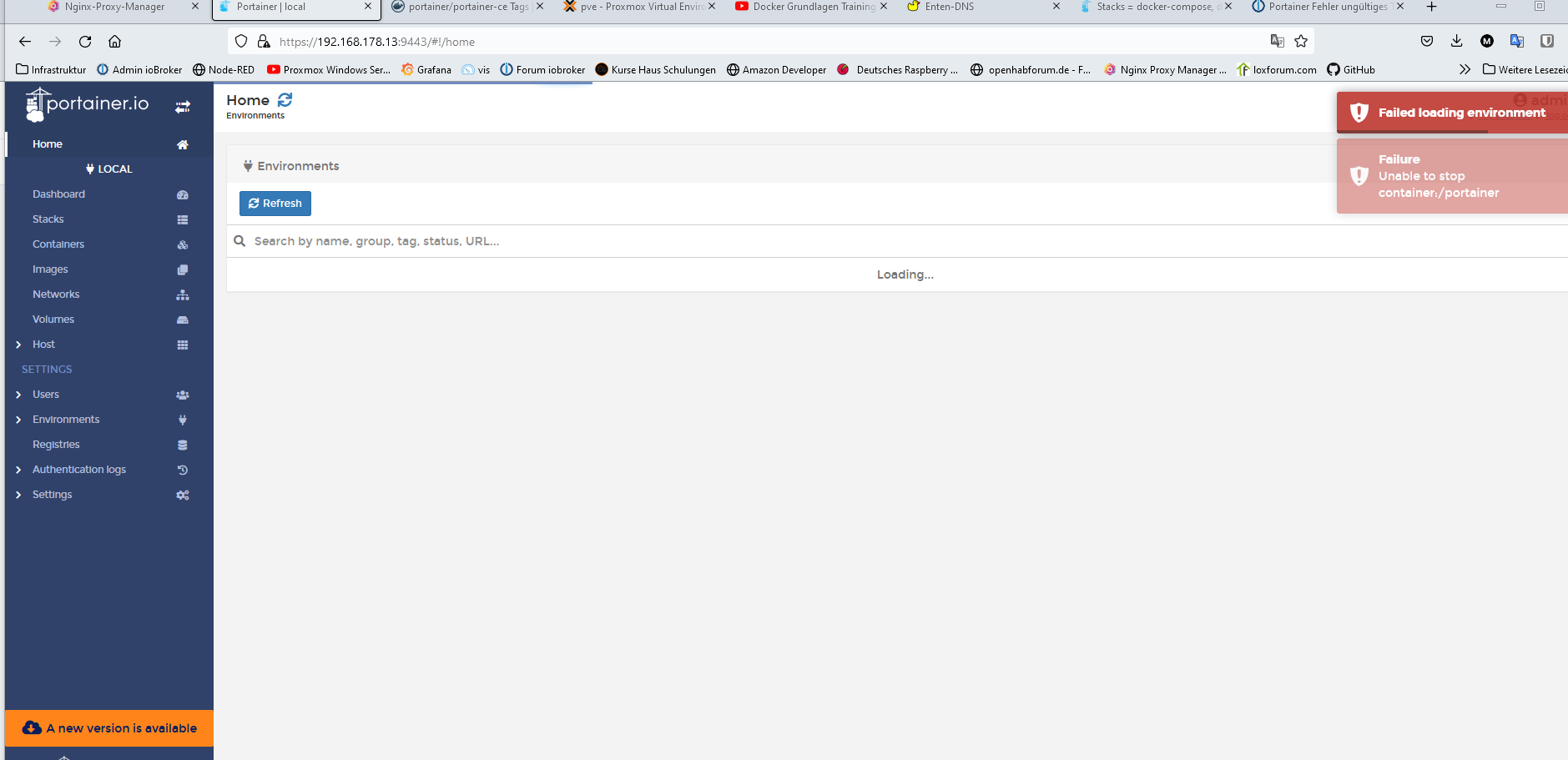

      abd99683-ccf8-448e-b5b6-1d5ad6221e2c-grafik.png code_text

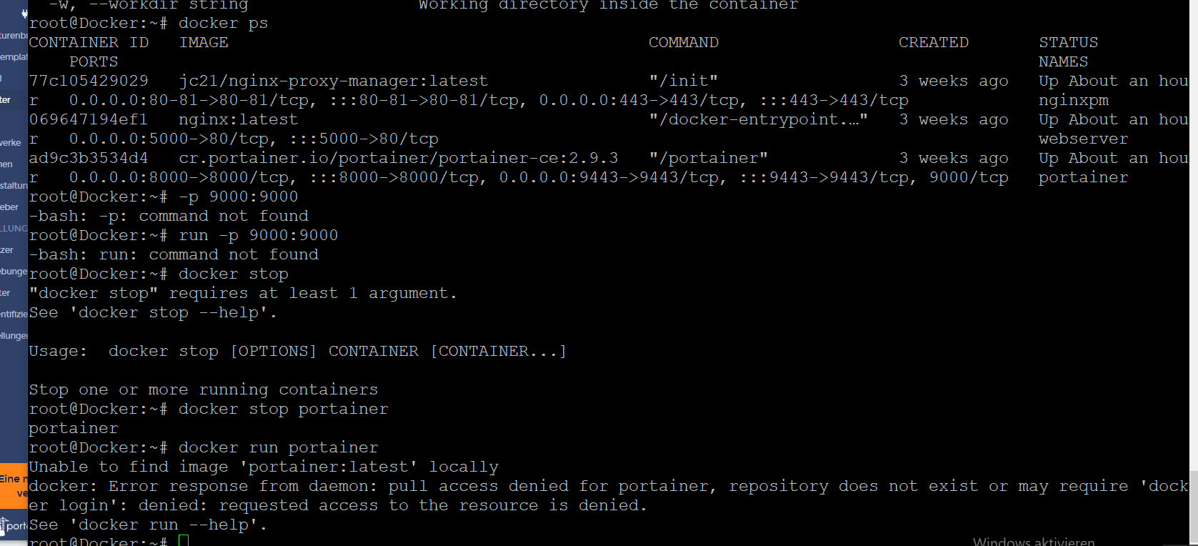

        A Former User @Guest last edited by
        @marcel-drzal

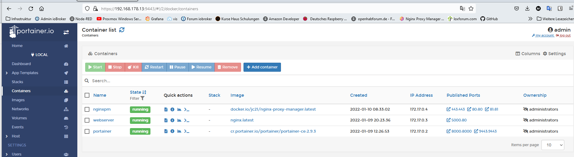

        6e50303f-528c-4496-9604-a70f0fd306d2-grafik.png code_text
        Verstehe nicht warum hier Port 9000 steht? habe doch  9443  eingestelt?
        Hoffe es hat eine eine Idee?
        Danke euch

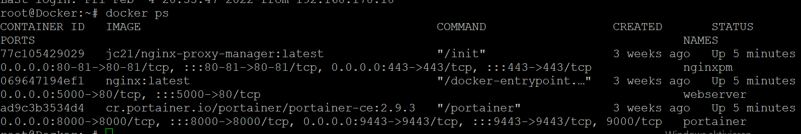

        • Glasfaser

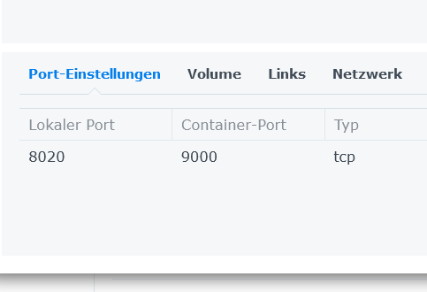

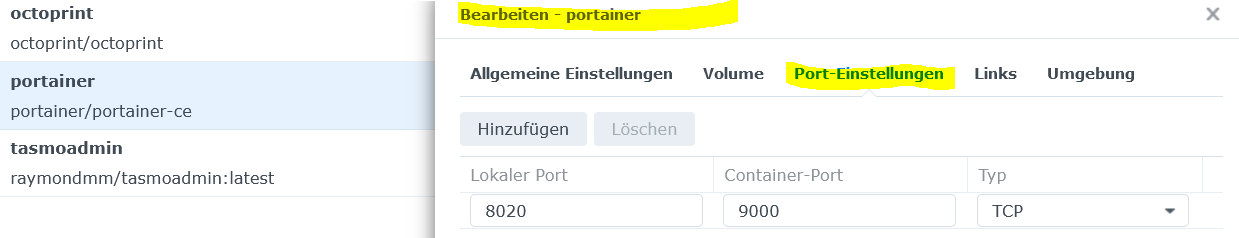

          Glasfaser @Guest last edited by Glasfaser
          @marcel-drzal
          Port ist bei mir 8020 , im Docker 9000
          über Syn Docker .

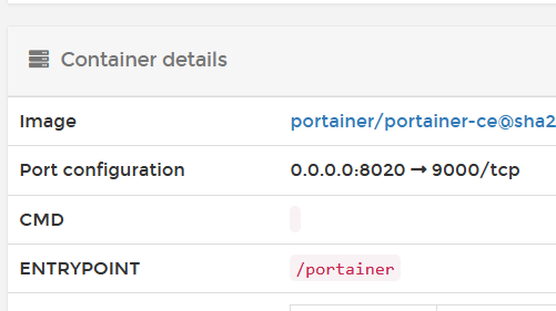

          59035473-f3d3-4a16-942d-3f834cb4af1c-grafik.png.
          portainer/portainer-ce              "/portainer"             16 months ago   Up 2 weeks                   8000/tcp, 0.0.0.0:8020->9000/tcp
          ? Glasfaser 2 Replies Last reply Reply Quote 0
            A Former User @Glasfaser last edited by
            @glasfaser

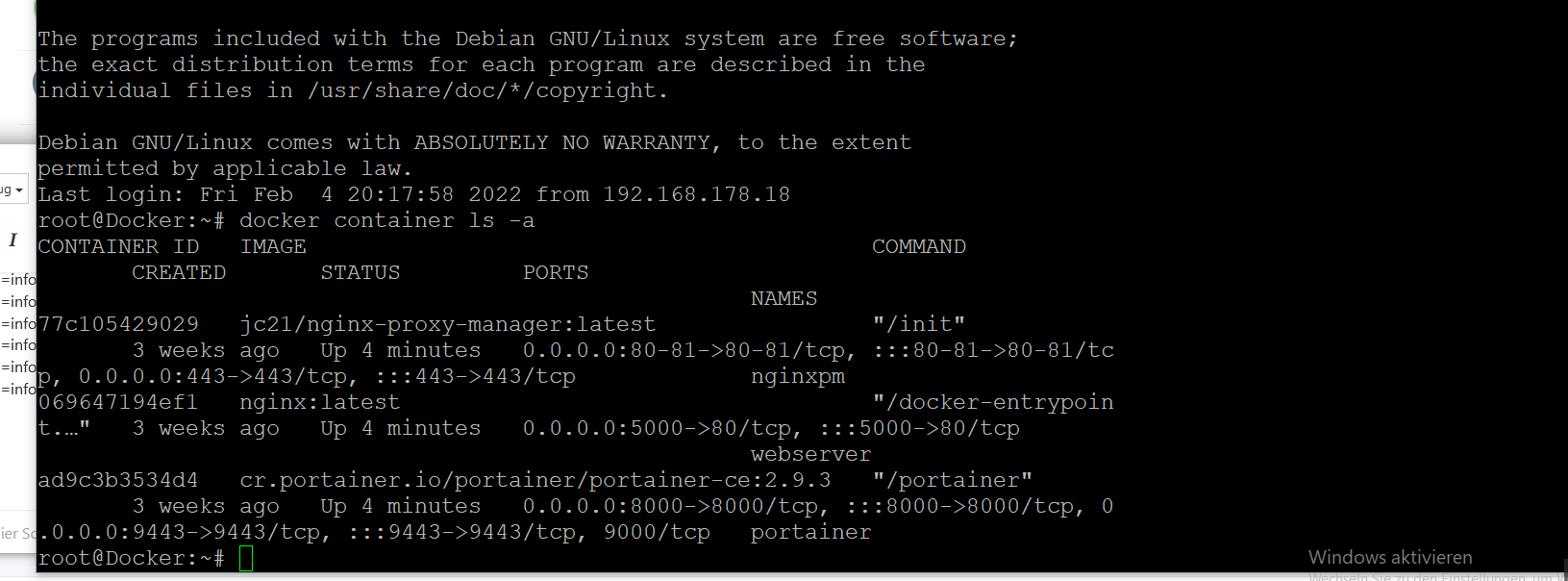

            54779ec1-2d01-47cc-86fd-2b17739101d3-grafik.png code_text
            wie kann ich das beheben?

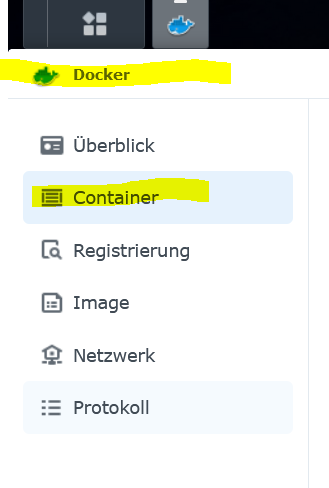

            • Glasfaser

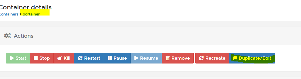

              Glasfaser @Glasfaser last edited by
              @marcel-drzal
              @glasfaser sagte in Portainer Fehler ungültiges Token?:
              über Syn Docker .
              Siehe oben :
              Mit der normalen Syn Docker Oberfläche , Docker stoppen , bearbeiten
                @glasfaser Leider ist das nonch neuland für mich.
                wenn ich den Container Stoppe muss ich die Maschine neu Starten, da dann alle Container weg sind

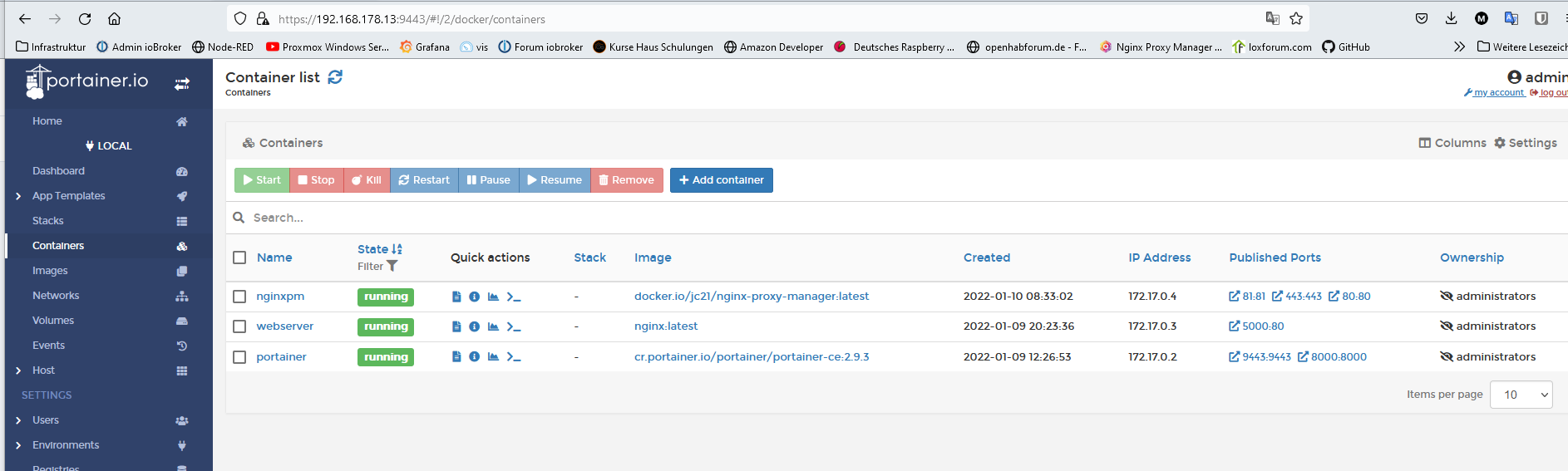

                e886d7d8-f992-415c-84f3-c7f2dc652056-grafik.png code_text
                • Glasfaser
                  @marcel-drzal sagte in Portainer Fehler ungültiges Token?:
                  ? keine Ahnung was du machst .
                  Einfach in der Synology anmelden , dann unter Docker :
                  b9fb5d3e-4381-42da-b7f2-616c2adee345-grafik.png .
                  Portainer stoppen :
                  Dann auf Portainer , rechte Maustaste ... bearbeiten
                  Glasfaser ? 2 Replies Last reply Reply Quote 0
                      @glasfaser Habe den Portainer auf einen IntelNUC in Proxmox laufen auf den port 9443
                      00b4ae6a-acd2-4495-bc13-7c01e020ad54-grafik.png code_text
                      • Glasfaser
                        @marcel-drzal
                        In Container Portainer ... Edit
                            @glasfaser
                            habe versucht ihn neu zu installieren
                            ohen Erfolg
                            a37a8f64-82d8-419e-a968-cd65bf61c6b6-grafik.png code_text

                              Habe nun meine Docker version auf 2.11 gebraht
                              leider immer noch der Fehler im Log hängt es mit https usammen?
                              2022/02/05 18:36:51 server: Reverse tunnelling enabled,
                              2022/02/05 18:36:51 server: Fingerprint e9:5c:0b:1e:71:72:df:f6:04:27:83:e5:fb:57:8b:22,
                              2022/02/05 18:36:51 server: Listening on 0.0.0.0:8000...,
                              level=info msg="2022/02/05 18:36:51 [DEBUG] [chisel, monitoring] [check_interval_seconds: 10.000000] [message: starting tunnel management process]",
                              level=info msg="2022/02/05 18:36:51 [INFO] [cmd,main] Starting Portainer version 2.11.0",
                              level=info msg="2022/02/05 18:36:51 [DEBUG] [internal,init] [message: start initialization monitor ]",
                              level=info msg="2022/02/05 18:36:51 [INFO] [http,server] [message: starting HTTPS server on port :9443]",
                              level=info msg="2022/02/05 18:36:51 [INFO] [http,server] [message: starting HTTP server on port :9000]",
                              level=info msg="2022/02/05 18:37:08 http error: A valid authorisation token is missing (err=Unauthorized) (code=401)",
                              level=info msg="2022/02/05 18:37:12 [ERROR] [http,client] [message: unexpected status code] [status_code: 403]",
                              level=info msg="2022/02/05 18:37:21 http error: Unable to retrieve DockerHub token from DockerHub (err=failed fetching dockerhub token) (code=500)"
                                @glasfaser
                                habe es hinbekommen, aber der fehler wird immer noch angezeigt
                                denke es ist eine Meldung das http nicht geht da ich mit https drin bin
                                was denkst du?
