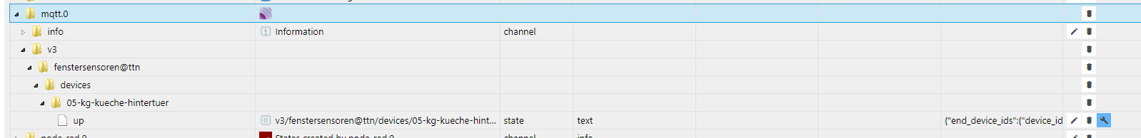

      Sobald ich einen neuen Fenstersensor in TNN integriere, wird dieser automatisch als Objekt im IOBroker angelegt, soweit so gut.
      Im Feld Wert wird folgender Wert eingespeichert:
      {"end_device_ids":{"device_id":"05-kg-kueche-hintertuer","application_ids":{"application_id":"fenstersensoren"},"dev_eui":"A84041926183EDDA","join_eui":"A840410000000107","dev_addr":"260B2243"},"correlation_ids":["as🆙01FV3D09B9V3ETAP1BZAEFMT3Z","gs:conn:01FTS84B358ED261TB5RY6N9F8","gs🆙host:01FTS84B3D4E5BA1AV56C125R0","gs:uplink:01FV3D09454QG2TJ9JXPXXANB7","ns:uplink:01FV3D094NQ8537EYWK2E7YP4Y","rpc:/ttn.lorawan.v3.GsNs/HandleUplink:01FV3D094NZXAX2WHYX625J3HD","rpc:/ttn.lorawan.v3.NsAs/HandleUplink:01FV3D09B8KF91AYJSJBBJVXQK"],"received_at":"2022-02-04T22:17:16.906561406Z","uplink_message":{"session_key_id":"AX6WxzPUM62CROAz2oRFeA==","f_port":10,"f_cnt":104,"frm_payload":"DFoBAAA3AAAAAA==","decoded_payload":{"ALARM":0,"BAT_V":3.162,"DOOR_OPEN_STATUS":0,"DOOR_OPEN_TIMES":55,"LAST_DOOR_OPEN_DURATION":0,"MOD":1},"rx_metadata":[{"gateway_ids":{"gateway_id":"05-andreasberg","eui":"A84041211B2C4150"},"time":"2022-02-04T22:17:16.657852Z","timestamp":4174745691,"rssi":-91,"channel_rssi":-91,"snr":8.2,"location":{"latitude":52.3220922480177,"longitude":10.401136254215945,"source":"SOURCE_REGISTRY"},"uplink_token":"ChwKGgoOMDUtYW5kcmVhc2JlcmcSCKhAQSEbLEFQENug1sYPGgwI7Mv2jwYQhbaSwwIg+MbvkcCzQSoMCOzL9o8GEOCM2LkC"}],"settings":{"data_rate":{"lora":{"bandwidth":125000,"spreading_factor":7}},"coding_rate":"4/5","frequency":"868100000","timestamp":4174745691,"time":"2022-02-04T22:17:16.657852Z"},"received_at":"2022-02-04T22:17:16.693896219Z","consumed_airtime":"0.061696s","version_ids":{"brand_id":"dragino","model_id":"lds01","hardware_version":"unknown_hw_version","firmware_version":"1.3.0","band_id":"EU_863_870"},"network_ids":{"net_id":"000013","tenant_id":"ttn","cluster_id":"ttn-eu1"}}}

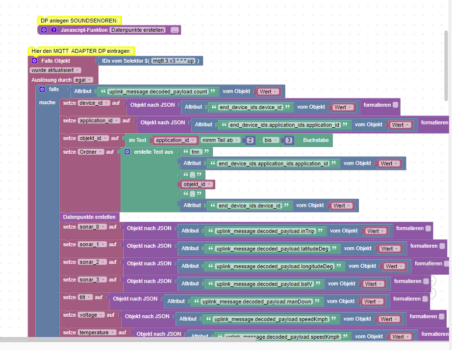

        @flehmann1234 jetzt habe ich was gefunden...
        https://forum.iobroker.net/topic/46100/mqtt-parsen-mit-blockly?_=1644016678753
        könnte das so funktioieren?

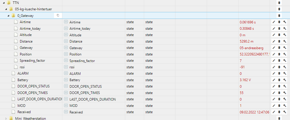

            @j_paul danke für deine Hilfe, hast mir sehr weiter geholfen.
            Jetzt kann ich endlich loslegen... Grüße

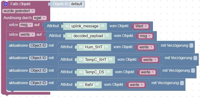

                  Derzeit habe ich mich mit einem Blockly Sript beholfen.
                  Hier hat mir @hafenmeister sehr geholfen.
