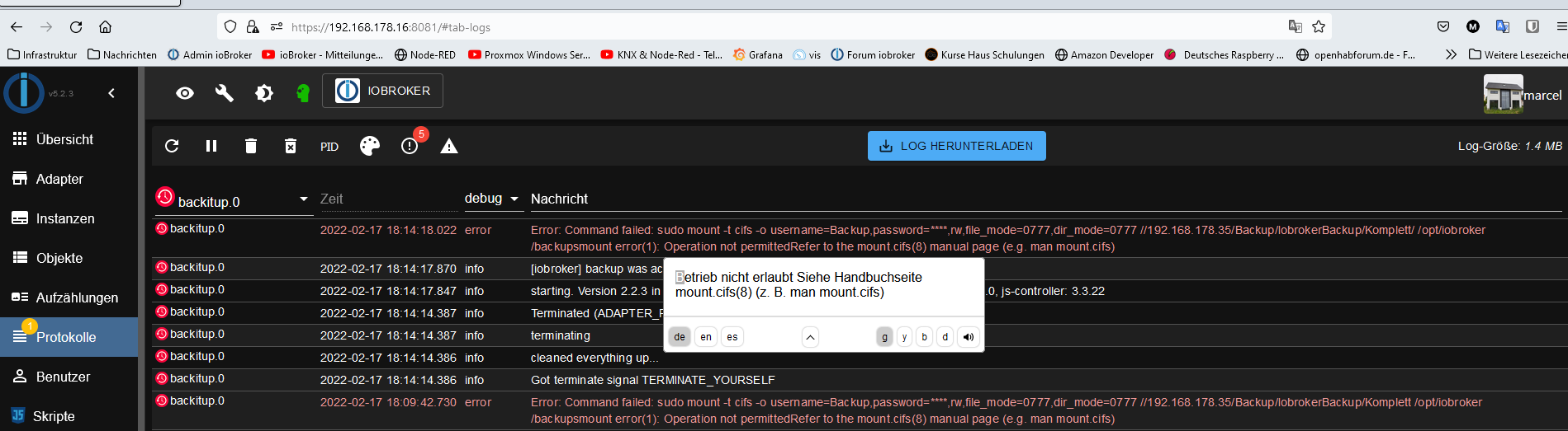

      Fehler: Befehl fehlgeschlagen: sudo mount -t cifs -o username=Backup,password=****,rw,file_mode=0777,dir_mode=0777 //192.168.178.35/Backup/Iobroker_Backup/Standard/ /opt/iobroker/backupsmount Fehler(1): Operation nicht zulässig. Siehe Handbuchseite mount.cifs(8) (z. B. man mount.cifs)
      Started iobroker ...
      [DEBUG] [mount] start with {"mountType":"CIFS","type":"storage","source":"cifs","mount":"//192.168.178.35","debugging":true,"fileDir":"/opt/iobroker/node_modules/iobroker.backitup","wakeOnLAN":false,"macAd":"20:DE:20:DE:20:DE","wolTime":"25","smb":"vers=2.0","sudo":true,"cifsDomain":"","clientInodes":false,"deleteOldBackup":true,"ownDir":true,"dir":"/Backup/Iobroker_Backup/Standard/","dirMinimal":"/Backup/Iobroker_Backup/Standard/","user":"Backup","pass":"****"}
      [DEBUG] [mount] - noserverino option: false
      [DEBUG] [mount] - cifs-mount command: "sudo mount -t cifs -o username=Backup,password=****,rw,file_mode=0777,dir_mode=0777,vers=2.0 //192.168.178.35/Backup/Iobroker_Backup/Standard/ /opt/iobroker/backups"
      [DEBUG] [mount] - first mount attempt with smb option failed. try next mount attempt without smb option ...
      [DEBUG] [mount] - cifs-mount command: "sudo mount -t cifs -o username=Backup,password=****,rw,file_mode=0777,dir_mode=0777 //192.168.178.35/Backup/Iobroker_Backup/Standard/ /opt/iobroker/backups"
      [ERROR] [mount] - [undefined Error: Command failed: sudo mount -t cifs -o username=Backup,password=****,rw,file_mode=0777,dir_mode=0777 //192.168.178.35/Backup/Iobroker_Backup/Standard/ /opt/iobroker/backups
      mount error(1): Operation not permitted
      Refer to the mount.cifs(8) manual page (e.g. man mount.cifs)
      [ERROR] [mount] - [IGNORED] Error: Command failed: sudo mount -t cifs -o username=Backup,password=****,rw,file_mode=0777,dir_mode=0777 //192.168.178.35/Backup/Iobroker_Backup/Standard/ /opt/iobroker/backups

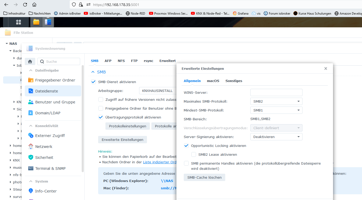

          Stelle bei der SYN und Backitup auf SMB 3
          ist auch mehrmals beschrieben ...
          Beispiel :
          https://forum.iobroker.net/topic/50705/gelöst-backitup-auf-raspi-verbindet-sich-nicht-mit-synology
            Siggi0904 last edited by
            Ja, SMB1 würde ich nicht mehr verwenden.
            Bitte auf SMB2 für Min und SMB3 für Max einstellen.
              A Former User @Siggi0904 last edited by
              @siggi0904 danke habe ich geändert

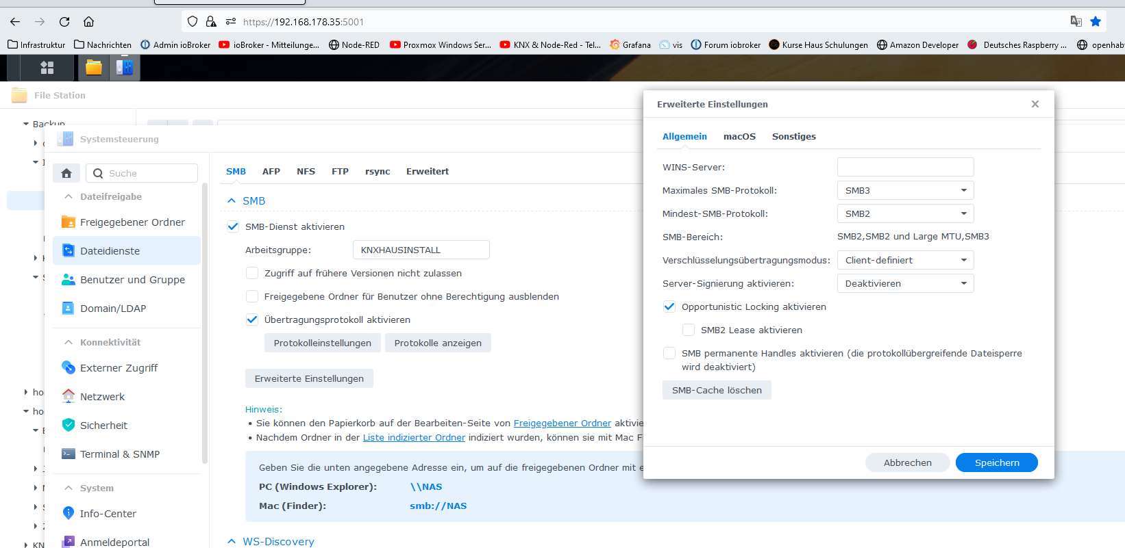

                A Former User @Glasfaser last edited by A Former User
                @glasfaser
                @siggi0904
                3.0 ist eingestellt,
                Synology kommt nicht an nur auf dem Nuc siehe Verzeichnis
                Error: Command failed: sudo mount -t cifs -o username=Backup,password=****,rw,file_mode=0777,dir_mode=0777 //192.168.178.35/Backup/Iobroker_Backup/Standard/ /opt/iobroker/backupsmount error(1): Operation not permittedRefer to the mount.cifs(8) manual page (e.g. man mount.cifs)

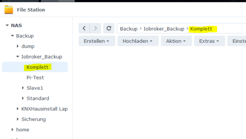

                  @marcel-drzal sagte in backitup backupsmount Fehler Synology:
                  und du zeigst :

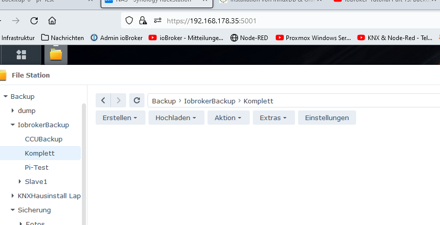

                  überprüfe dein Verzeichniss .... alles weitere ist fast gleich wie im beigefügten Thread ...
                  ? 2 Replies Last reply Reply Quote 0

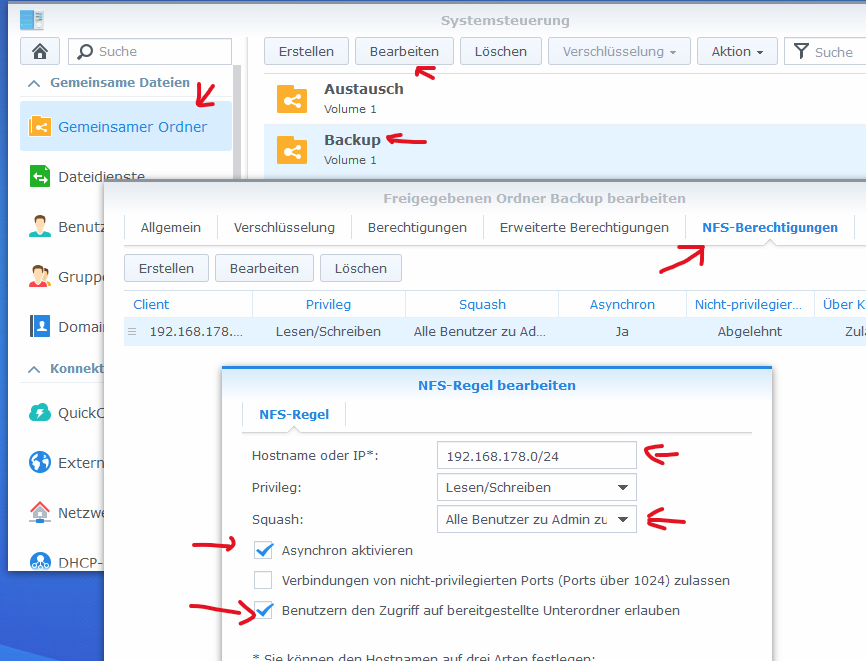

                      @marcel-drzal schau mal in die Ordner-Einstellungen.
                      Sollte so aussehen:

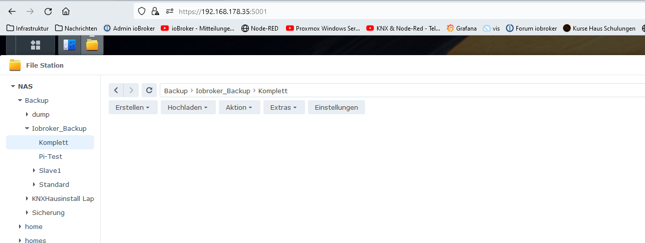

                        @glasfaser passt alles
                        Kommt auch beim Intel NUC im Verzeichniss an, ist die Berechtigung falsch?
                        auf der Synology kommt aber nicht an??
                        auf der Synology, muss die Arbeitsgruppe angegeben werden?

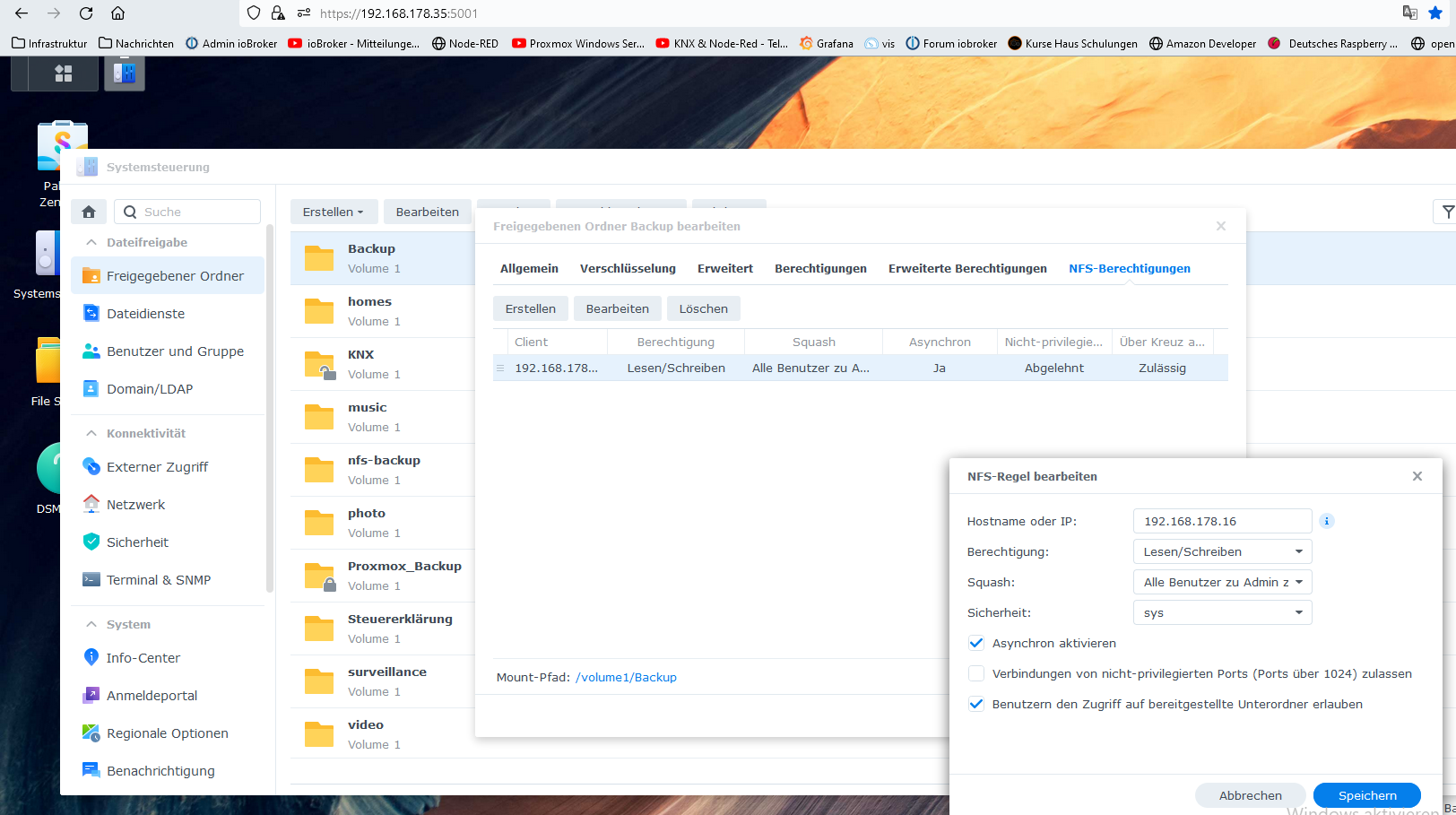

                            Siggi0904 @Guest last edited by
                            @marcel-drzal Hast du mal bei den NFS-Rechten geschaut?
                              @siggi0904
                                @marcel-drzal Gut, bei DSM 7 bin ich raus. Das hab ich nicht, da meine DS zu alt ist.
                                Weiß nicht, was da gemacht wurde.

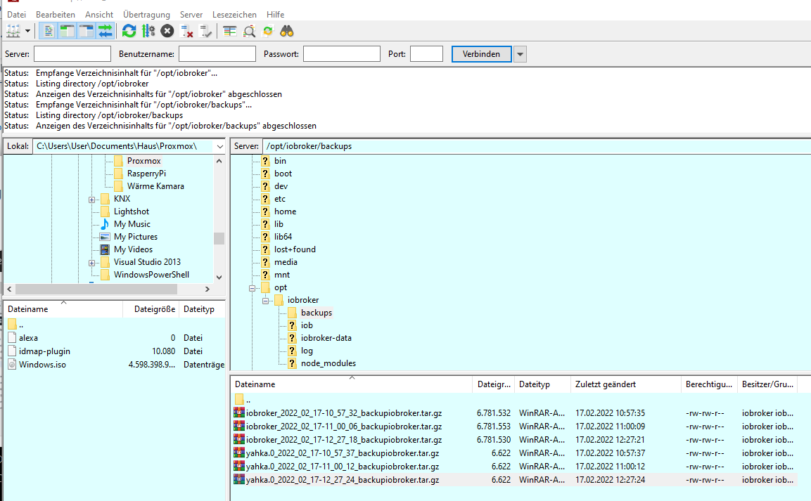

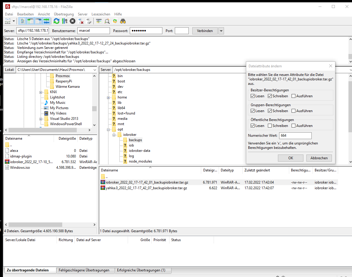

                                  A Former User last edited by
                                  Puchover kommt auch an und auf dem Nuc wird das Backup mit der Datenberechtigun (664) geschrieben.
                                  Nun findet das Backup auch kein Ende und läuft immer weiter.
                                  {"enabled":true,"notificationsType":"Pushover","type":"message","instance":"","NoticeType":"longEmailNotice","emailReceiver":"xxx@xxx.com","emailSender":"xxx@xxx.com","onlyError":false,"emailWaiting":0,"hostName":"","systemLang":"de"},"pushover":{"enabled":true,"notificationsType":"Pushover","type":"message","instance":"pushover.0","SilentNotice":false,"NoticeType":"longPushoverNotice","deviceID":"","onlyError":true,"pushoverWaiting":0,"hostName":"","systemLang":"de"},"whatsapp":{"enabled":true,"notificationsType":"Pushover","type":"message","instance":"","NoticeType":"longWhatsappNotice","onlyError":false,"whatsappWaiting":0,"hostName":"","systemLang":"de"},"backupDir":"/opt/iobroker/backups","influxDBEvents":[{"host":"","port":"8088","dbName":"","nameSuffix":"influxDB-1","exe":""}],"mySqlEvents":[],"pgSqlEvents":[]}
                                  [DEBUG] [umount] start with {"mountType":"CIFS","type":"storage","source":"cifs","mount":"//192.168.178.35","debugging":true,"fileDir":"/opt/iobroker/node_modules/iobroker.backitup","wakeOnLAN":false,"macAd":"20:DE:20:DE:20:DE","wolTime":"25","smb":"vers=3.0","sudo":true,"cifsDomain":"","clientInodes":false,"deleteOldBackup":true,"ownDir":true,"dir":"/Backup/IobrokerBackup/Komplett/","dirMinimal":"/Backup/IobrokerBackup/Komplett/","user":"Backup","pass":"****","backupDir":"/opt/iobroker/backups","influxDBEvents":[{"host":"","port":"8088","dbName":"","nameSuffix":"influxDB-1","exe":""}],"mySqlEvents":[],"pgSqlEvents":[]}
                                    Habe nun mal mit ftp versucht aber auch ein Fehler.
                                    2022-02-17 21:20:55.019 - info : pushover.0 (358) Pushover-Benachrichtigung senden: {"message":"BackItUp:\nIhr Backup wurde nicht vollständig erstellt. Bitte überprüfen Sie die Fehler!!\n\ninfluxDB: Fehler: Befehl fehlgeschlagen: influxd backup -portable -database iobroker -host 192.168.178.17:8088 \"/opt/iobroker/backups/influxDB_2022_02_17-21_20_45_backupiobroker\"\n/bin/sh: 1: influxd: not found\n\nftp : Fehler: /backupDir/iobroker/yahka.0_2022_02_17-21_20_47_backupiobroker.tar.gz: Berechtigung verweigert.","sound":"pushover","title":"Backitup","priority":"0"}
