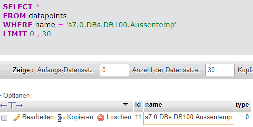

              der Datenpunkt ist vorhanden (S7)
              , auch in der DB vorhanden
              Daten sind auch drinn

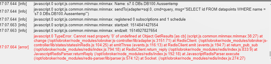

                  00:05:04.263	[info]	javascript.0 Stop script script.js.common.minmax.Aussentemp
                  00:05:04.301	[info]	javascript.0 Start javascript script.js.common.minmax.Aussentemp
                  00:05:04.301	[info]	javascript.0 script.js.common.minmax.Aussentemp: schedule(cron=*/5 * * * *)
                  00:05:04.308	[info]	javascript.0 script.js.common.minmax.Aussentemp: 1 Name: s7.0.DBs.DB100.Aussentemp
                  00:05:04.308	[info]	javascript.0 script.js.common.minmax.Aussentemp: sendTo(adapter=sql.0, cmd=query, msg="SELECT id as id FROM datapoints WHERE name = 's7.0.DBs.DB100.Aussentemp'")
                  00:05:04.309	[info]	javascript.0 script.js.common.minmax.Aussentemp: registered 0 subscriptions and 1 schedule
                  00:05:04.320	[info]	javascript.0 script.js.common.minmax.Aussentemp: startzeit: 1514847904311
                  00:05:04.320	[info]	javascript.0 script.js.common.minmax.Aussentemp: endzeit: 1514934304311
                  00:05:04.321	[info]	javascript.0 script.js.common.minmax.Aussentemp: undefined
                  00:05:04.321	[error]	javascript.0 TypeError: Cannot read property '0' of undefined at Object.GetResults [as cb] (script.js.common.minmax.Aussentemp:42:27) at change (/opt/iobroker/node_modules/iobroker.js-controller/lib/adapter.js:3151:71) at RedisClient. (/opt/iobroker/node_modules/iobroker.js-controller/lib/states/statesInRedis.js:104:25) at emitThree (events.js:116:13) at RedisClient.emit (events.js:194:7) at return_pub_sub (/opt/iobroker/node_modules/redis/index.js:794:18) at RedisClient.return_reply (/opt/iobroker/node_modules/redis/index.js:833:9) at JavascriptRedisParser.returnReply (/opt/iobroker/node_modules/redis/index.js:192:18) at JavascriptRedisParser.execute (/opt/iobroker/node_modules/redis-parser/lib/parser.js:574:12) at Socket. (/opt/iobroker/node_modules/redis/index.js:274:27)
                  • Thisoft
                    Thisoft last edited by
                    Dat Ding wehrt sich aber auch - müssen wir uns rantasten… Ändere mal bitte das Codestück wie folgt:

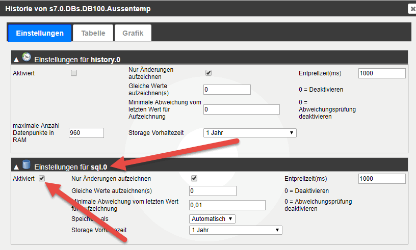

                        "Error: ER_NO_DB_ERROR: No database selected"
                        Jetzt wo ich nochmal auf deine Screenshots schaue fällt es mir auch wie Schuppen aus den Haaren 😉
                        Du hast ja gar keinen SQL-Adapter sondern nur die History aktiviert! (Hatte ich auch weiter vorn schon mal danach gefragt…)
                        Dann wird das so nix. Kann ich dir aber auch aus dem Stegreif nicht weiterhelfen. History habe und hatte ich nie im Einsatz. Evtl. kann ich heute abend mal schauen was man da umbauen müsste...

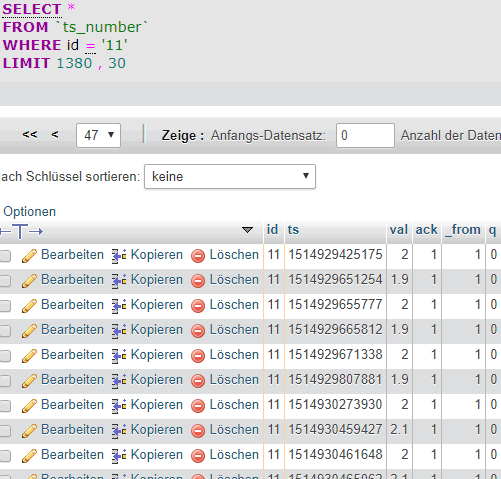

                              in der Tabelle steht etwas

                                Zeigst Du bitte mal die Einstellungen deines SQL-Adapters?

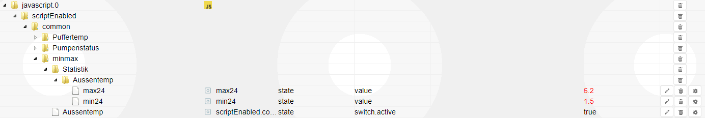

                                          18:26:28.007	[info]	javascript.0 script.js.common.minmax.Aussentemp: Fn Max[{"MaxVal":6.2}]
                                          18:26:28.008	[info]	javascript.0 script.js.common.minmax.Aussentemp: setForeignState(id=javascript.0.scriptEnabled.common.minmax.Statistik.Aussentemp.max24, state=6.2)
                                          18:26:28.029	[info]	javascript.0 script.js.common.minmax.Aussentemp: Fn Min[{"MinVal":1.5}]
                                          18:26:28.030	[info]	javascript.0 script.js.common.minmax.Aussentemp: setForeignState(id=javascript.0.scriptEnabled.common.minmax.Statistik.Aussentemp.min24, state=1.5)
                                          finde keine error ausgabe, sollte also funzn
                                          Vielen Dank bis hierhin schon mal und für die Geduld 😄
                                          hab jetzt nur noch diese Fehlermeldung in der Log 😢 :
                                          admin.0	2018-01-03 18:26:28.047	error	change ID is empty: {"common":{"enabled":1.5},"from":"system.adapter.javascript.0","ts":1515000388026,"_id":null}
                                          cloud.0	2018-01-03 18:26:28.037	error	change ID is empty: {"common":{"enabled":1.5},"from":"system.adapter.javascript.0","ts":1515000388026,"_id":null}
                                          sql.0	2018-01-03 18:26:28.036	error	change ID is empty: {"common":{"enabled":1.5},"from":"system.adapter.javascript.0","ts":1515000388026,"_id":null}
                                          javascript.0	2018-01-03 18:26:28.035	error	change ID is empty: {"common":{"enabled":1.5},"from":"system.adapter.javascript.0","ts":1515000388026,"_id":null}
                                          web.0	2018-01-03 18:26:28.033	error	change ID is empty: {"common":{"enabled":1.5},"from":"system.adapter.javascript.0","ts":1515000388026,"_id":null}
                                          sql.0	2018-01-03 18:26:28.021	error	change ID is empty: {"common":{"enabled":6.2},"from":"system.adapter.javascript.0","ts":1515000388010,"_id":null}
                                          javascript.0	2018-01-03 18:26:28.023	error	change ID is empty: {"common":{"enabled":6.2},"from":"system.adapter.javascript.0","ts":1515000388010,"_id":null}
                                          cloud.0	2018-01-03 18:26:28.022	error	change ID is empty: {"common":{"enabled":6.2},"from":"system.adapter.javascript.0","ts":1515000388010,"_id":null}
                                          web.0	2018-01-03 18:26:28.018	error	change ID is empty: {"common":{"enabled":6.2},"from":"system.adapter.javascript.0","ts":1515000388010,"_id":null}
                                          die Werte stehen aber im Datenpunkt
