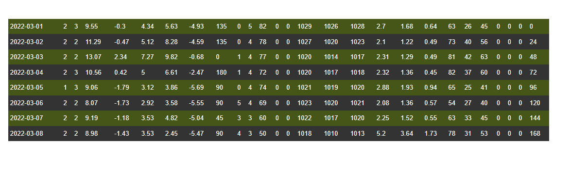

      Folgenden Objekt erhalte ich per API Abruf...
      {'time':['2022-03-01','2022-03-02','2022-03-03','2022-03-04','2022-03-05','2022-03-06','2022-03-07','2022-03-08'],'pictocode':[2,2,2,2,1,2,2,2],'uvindex':[3,2,2,3,3,2,2,2],'temperature_max':[9.55,11.29,13.07,10.56,9.06,8.07,9.19,8.98],'temperature_min':[-0.3,-0.47,2.34,0.42,-1.79,-1.73,-1.18,-1.43],'temperature_mean':[4.34,5.12,7.27,5,3.12,2.92,3.53,3.53],'felttemperature_max':[5.63,8.28,9.82,6.61,3.86,3.58,4.82,2.45],'felttemperature_min':[-4.93,-4.59,-0.68,-2.47,-5.69,-5.55,-5.04,-5.47],'winddirection':[135,135,0,180,90,90,45,90],'precipitation_probability':[0,0,1,1,0,5,3,4],'rainspot':['0000000000000000000000000000000000000000000000000','0000000000000000000000000000000000000000000000000','0000000000000000000000000000000000000000000000000','0000000000000000000000000000000000000000000000000','0000000000000000000000000000000000000000000000000','0000000000000000000000000000000000000000000000000','0000000000000000000000000000000000000000000000000','0000000000000000000000000000000000000000000000000'],'predictability_class':[5,4,4,4,4,4,3,3],'predictability':[82,78,77,72,74,69,60,50],'precipitation':[0,0,0,0,0,0,0,0],'snowfraction':[0,0,0,0,0,0,0,0],'sealevelpressure_max':[1029,1027,1020,1020,1021,1023,1022,1018],'sealevelpressure_min':[1026,1020,1014,1017,1019,1020,1017,1010],'sealevelpressure_mean':[1028,1023,1017,1018,1020,1021,1020,1013],'windspeed_max':[2.7,2.1,2.31,2.32,2.88,2.08,2.25,5.2],'windspeed_mean':[1.68,1.22,1.29,1.36,1.93,1.36,1.52,3.64],'windspeed_min':[0.64,0.49,0.49,0.45,0.94,0.57,0.55,1.73],'relativehumidity_max':[63,73,81,82,65,54,63,78],'relativehumidity_min':[26,40,42,37,25,27,33,31],'relativehumidity_mean':[45,56,63,60,41,40,45,53],'convective_precipitation':[0,0,0,0,0,0,0,0],'precipitation_hours':[0,0,0,0,0,0,0,0],'humiditygreater90_hours':[0,0,0,0,0,0,0,0],'indexto1hvalues_start':[0,24,48,72,96,120,144,168],'indexto1hvalues_end':[23,47,71,95,119,143,167,191]}
      Ich würde jetzt gerne diese Daten in dem MaterialDesign-Widget Table verwenden. Dazu muss das Objekt ja noch in ein JSON Array umgewandelt werden.
      Leider sind meine Javascript Fähigkeiten noch nicht so weit, und ich schaffe es nicht dieses Objekt umzuwandeln.
      Könnt Ihr mir auf die Sprünge helfen?
      Könnte ich auch nur Teile dieses Objektes verwenden?
      Danke für Eure Hilfe 😊
      Dirk

              Das ist kein String (JSON), sondern ein Objekt. Umwandlung in JSON:
              let json = JSON.stringify(obj);

                  Das Original-Objekt mit vielen Arrays muss erst in ein Array mit vielen Objekten gewandelt und anschließend nach JSON konvertiert werden.
                  const arr = [];
                  const time = obj.time; // 1. Array im Original-Objekt
                  for(let i = 0; i < time.length; i++) {
                      const newObj = {};
                      for(let prop in obj) {
                          newObj[prop] = obj[prop][i];
                      arr.push(newObj);
                  setState(idJson, JSON.stringify(arr), true)
                    OliverIO @dirk_1930 last edited by OliverIO

                      @dirk_1930 sagte: Könnte ich auch nur Teile dieses Objektes verwenden?
                      Verwende eine Liste mit den zu selektierenden Eigenschaften:
                      const idJson = '0_userdata.0.xyz'; // Ziel-DP mit JSON-Tabelle
                      const selector = ['time', 'uvindex', 'temperature_mean'];
                      // Objekt in Variable obj einlesen
                      const arr = [];
                      const length = obj.time.length; // Länge 1. Array im Original-Objekt
                      for(let i = 0; i < length; i++) {
                          const newObj = {};
                              if(selector.includes(prop)) newObj[prop] = obj[prop][i];
                          arr.push(newObj);
                      setState(idJson, JSON.stringify(arr), true);
                      dirk_1930 1 Reply Last reply Reply Quote 0

                        👍 😳 Perfekt... Vielen Dank für die Hilfe!
