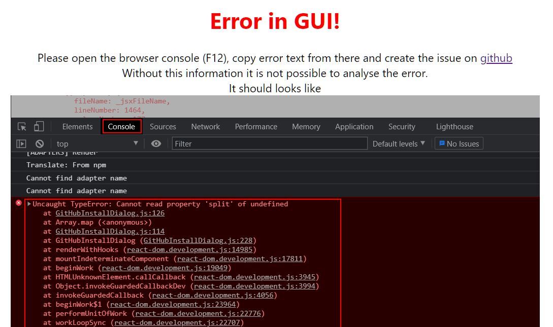

      Bei Benutzer, kommt diese Fehlermeldung Error in GUI!
      2instrument.ts:125 Error: Minified React error #31; visit https://reactjs.org/docs/error-decoder.html?invariant=31&args[]=object with keys {en%2C de%2C ru%2C pt%2C nl%2C fr%2C it%2C es%2C pl%2C zh-cn} for the full message or use the non-minified dev environment for full errors and additional helpful warnings.

                                            Mosi @Jan1 last edited by
                                            @jan1
                                            Bitte, dieses Blild findet man ja ziemlich oft im Forum.
                                            J Homoran 2 Replies Last reply Reply Quote 0
