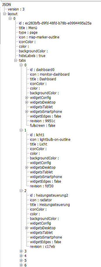

      Hey, ich hab ein JSON Datenpunkt mit mehreren ID's von denen ich die Werte bräuchte, diese muss ich dann nacheinander an einen Datenpunkte senden (mit einem Delay von ~10 Sekunden pro Wert).
      Ab besten um 7 Uhr und um 16:30 Uhr.
      Kann mir da jemand helfen? ob JS oder Blockly wäre mir egal 🙂
      {"version":3,"layout":[{"id":"ec283bfb-d9fd-48fd-b78b-e0994495a25a","title":"Menü","type":"page","icon":"map-marker-outline","iconColor":"","color":"","backgroundColor":"","hideLabels":true,"tabs":[{"id":"dashboard0","icon":"monitor-dashboard","title":"Dashboard","iconColor":"","color":"","backgroundColor":"","widgetConfig":{"desktopWidgetHeight":"45"},"widgetsDesktop":[{"x":4,"y":0,"w":4,"h":2,"i":"d5a6021e-024d-4c45-ae07-8de70de5ce76","items":["72c35a15-fd46-4495-a76f-c3001b24e3eb"],"scaleToFitContents":true,"alignmentVertical":"top","alignmentHorizontal":"center","moved":false},{"x":0,"y":0,"w":4,"h":8,"i":"244f1fdb-a46e-44e5-a43d-b1491a3a0119","items":["1283920c-2035-4643-88be-f60a23e08647"],"scaleToFitContents":true,"alignmentVertical":"top","alignmentHorizontal":"center","moved":false},{"x":0,"y":8,"w":4,"h":2,"i":"174a53dd-1ff7-4331-8ed4-74d81ced9e60","items":["9d021c8b-bb36-4a20-99f2-431c68b9cc07"],"scaleToFitContents":true,"alignmentVertical":"middle","alignmentHorizontal":"center","moved":false},{"x":0,"y":10,"w":4,"h":2,"i":"045c489d-4ce5-4b53-8a3f-5e37b8f3df97","items":["7f0f2651-0132-439c-ba36-adf4e9f8cd64"],"scaleToFitContents":false,"alignmentVertical":"top","alignmentHorizontal":"left","moved":false},{"x":0,"y":12,"w":4,"h":7,"i":"789795ff-5aa1-4143-ae70-ea468d25fe9d","items":["0978c005-d9a2-425e-afac-052b9a22d244"],"scaleToFitContents":true,"alignmentVertical":"top","alignmentHorizontal":"center","moved":false},{"x":4,"y":2,"w":4,"h":5,"i":"eaa3ce04-4221-4c80-80eb-0e150cef3a0e","items":["84027048-31bc-4ecf-9ff4-8649c8b267ab"],"scaleToFitContents":true,"alignmentVertical":"top","alignmentHorizontal":"center","moved":false},{"x":4,"y":7,"w":4,"h":3,"i":"465f8ace-1792-46a4-9278-301bd3c7a6fb","items":["da8c1f65-4b6a-4a1b-a69d-4a315fe61a69"],"scaleToFitContents":true,"alignmentVertical":"top","alignmentHorizontal":"center","moved":false},{"x":4,"y":10,"w":4,"h":3,"i":"ff5c9bf3-0b63-42d5-8f93-e37ce87b786f","items":["0962bfcf-9f04-4b7b-86c4-c814f6987396"],"scaleToFitContents":true,"alignmentVertical":"top","alignmentHorizontal":"center","moved":false},{"x":4,"y":13,"w":1,"h":2,"i":"e9101240-9ddb-4f46-820b-f3abd77ee09d","items":["634511a2-cffd-4cde-a451-aa03b6e61983"],"scaleToFitContents":true,"alignmentVertical":"middle","alignmentHorizontal":"center","moved":false},{"x":8,"y":0,"w":4,"h":3,"i":"73d562b9-4e4f-4515-bdd3-717525fa86ae","items":["694246b5-20cf-4ad0-8d2e-6b0fa7d0ef7d"],"scaleToFitContents":true,"alignmentVertical":"top","alignmentHorizontal":"center","moved":false},{"x":8,"y":3,"w":4,"h":5,"i":"8235e64e-eace-46ca-8f19-0e4651235317","items":["79f1a43b-7508-4821-9c94-e885fe3468c2"],"scaleToFitContents":true,"alignmentVertical":"top","alignmentHorizontal":"center","moved":false},{"x":8,"y":8,"w":4,"h":6,"i":"b5a5c944-de39-4541-8a20-331daac66fc6","items":["ef835af8-0d34-48b6-9a63-d1e4519859fe"],"scaleToFitContents":true,"alignmentVertical":"top","alignmentHorizontal":"center","moved":false},{"x":8,"y":14,"w":4,"h":5,"i":"72caabc9-ed1d-4aad-a6cd-da7d10e33b46","items":["2ab33449-5d62-4cbe-a39b-119b759bc841"],"scaleToFitContents":true,"alignmentVertical":"top","alignmentHorizontal":"center","moved":false},{"x":5,"y":13,"w":1,"h":2,"i":"8a574210-9895-48c8-86ac-81600ff699e4","items":["bdf1d693-7b1a-41ad-a03a-856decec48ca"],"scaleToFitContents":true,"alignmentVertical":"middle","alignmentHorizontal":"center","moved":false},{"x":6,"y":13,"w":1,"h":2,"i":"260359bb-2f3f-46bf-9a57-f406c7457364","items":["13707f43-2628-4d02-ac7e-ae9a4f313c2c"],"scaleToFitContents":true,"alignmentVertical":"middle","alignmentHorizontal":"center","moved":false},{"x":7,"y":13,"w":1,"h":2,"i":"9f7ee3c5-51d6-4806-b40b-725e3d805aed","items":["080ea341-1409-4ea3-a3ed-4b6e0eaf07e7"],"scaleToFitContents":true,"alignmentVertical":"middle","alignmentHorizontal":"center","moved":false}],"widgetsTablet":[],"widgetsSmartphone":[{"x":0,"y":0,"w":4,"h":4,"i":"443b1401-e54c-451c-8d34-1841ebd810dd","moved":false,"items":[]}],"widgetEdges":false,"revision":"9951c","fullscreen":false},{"id":"licht1","icon":"lightbulb-on-outline","title":"Licht","iconColor":"","color":"","backgroundColor":"","widgetConfig":{},"widgetsDesktop":[{"x":0,"y":0,"w":6,"h":9,"i":"aa456f5c-2e12-45ce-a3c6-7354ab8798a0","items":["005907d2-1090-4261-a4ad-bfce8e17e2a8"],"scaleToFitContents":true,"alignmentVertical":"top","alignmentHorizontal":"center","moved":false},{"x":6,"y":0,"w":6,"h":9,"i":"2ab33f3e-faa1-40a0-8de8-b65f5af51f51","items":["3117a766-3980-40cb-97c7-18e56fd8a9d3"],"scaleToFitContents":true,"alignmentVertical":"top","alignmentHorizontal":"center","moved":false}],"widgetsTablet":[],"widgetsSmartphone":[],"widgetEdges":false,"revision":"fdf30"},{"id":"heizungssteuerung2","icon":"radiator","title":"Heizungssteuerung","iconColor":"","color":"","backgroundColor":"","widgetConfig":{},"widgetsDesktop":[{"x":0,"y":0,"w":6,"h":7,"i":"ff78687d-e7a7-4c32-b1a5-456268419b4e","items":["92041707-97c8-47d9-b11e-9f4867de8fc0"],"scaleToFitContents":true,"alignmentVertical":"top","alignmentHorizontal":"center","moved":false},{"x":0,"y":7,"w":6,"h":7,"i":"d2b6be03-fc7b-464a-89fe-1020411e72e2","items":["f0b6edee-10af-480e-8da5-da11b4e9e50c"],"scaleToFitContents":true,"alignmentVertical":"top","alignmentHorizontal":"center","moved":false},{"x":6,"y":0,"w":6,"h":7,"i":"e4087f4c-9ff0-4b5e-9f54-9ff782c168ca","items":["e0730875-68d8-4248-86d3-7d2a2ac1e319"],"scaleToFitContents":true,"alignmentVertical":"top","alignmentHorizontal":"center","moved":false},{"x":6,"y":7,"w":6,"h":7,"i":"1b36540c-289f-4254-8815-398c0f4babd4","items":["64e80b1b-dc5c-43e7-a529-7431531289fe"],"scaleToFitContents":true,"alignmentVertical":"top","alignmentHorizontal":"center","moved":false},{"x":0,"y":14,"w":12,"h":10,"i":"db5b8fc3-5837-45ad-891d-e4614194cb8d","items":["ffb6b329-30c3-43c9-9c85-0476b9138469"],"scaleToFitContents":true,"alignmentVertical":"top","alignmentHorizontal":"center","moved":false}],"widgetsTablet":[],"widgetsSmartphone":[],"widgetEdges":false,"revision":"c17eb"},{"id":"klimaanlage3","icon":"air-conditioner","title":"Klimaanlage","iconColor":"","color":"","backgroundColor":"","widgetConfig":{},"widgetsDesktop":[{"x":0,"y":0,"w":6,"h":7,"i":"b799c17a-b66b-42ff-a719-3a9d293b8536","items":["4ed6dacd-616e-438c-a144-568dd8eca606"],"scaleToFitContents":true,"alignmentVertical":"top","alignmentHorizontal":"center","moved":false},{"x":0,"y":7,"w":6,"h":7,"i":"3dc11b6a-e3a4-4718-93a6-bf73e3aea06a","items":["be55c1f7-a93b-4ddd-9a9e-993e3088c64d"],"scaleToFitContents":true,"alignmentVertical":"top","alignmentHorizontal":"center","moved":false},{"x":6,"y":7,"w":6,"h":7,"i":"da02aa89-8677-4937-9db2-b0316780abb0","items":["719fde61-de05-4fbd-a87b-6e23a645f94b"],"scaleToFitContents":true,"alignmentVertical":"top","alignmentHorizontal":"center","moved":false},{"x":6,"y":0,"w":6,"h":7,"i":"d87e9872-a37a-4911-a793-261be5b95c80","items":["adcb677a-d17f-484a-8016-1817d96afdbb"],"scaleToFitContents":true,"alignmentVertical":"top","alignmentHorizontal":"center","moved":false},{"x":0,"y":14,"w":12,"h":9,"i":"6ce2f435-910c-4a06-a4ec-7a34b67c382a","items":["4959eb0b-bf42-41e8-8d7f-40da36e5b56e"],"scaleToFitContents":true,"alignmentVertical":"top","alignmentHorizontal":"center","moved":false}],"widgetsTablet":[],"widgetsSmartphone":[],"widgetEdges":false,"revision":"e1c51"},{"id":"media4","icon":"play-network","title":"Media","iconColor":"","color":"","backgroundColor":"","widgetConfig":{},"widgetsDesktop":[{"x":0,"y":0,"w":3,"h":4,"i":"275b1067-a90c-4c5c-86d4-d6851c026635","items":["b2cd368e-901b-421b-b664-9cc701684e90"],"scaleToFitContents":true,"alignmentVertical":"top","alignmentHorizontal":"center","moved":false},{"x":6,"y":0,"w":6,"h":3,"i":"b5cc0b7e-3505-409f-b49b-5d198b7e3896","items":["11a61bb7-5ca1-4de7-9b6e-f8245b43cad1"],"scaleToFitContents":true,"alignmentVertical":"top","alignmentHorizontal":"center","moved":false},{"x":6,"y":3,"w":6,"h":11,"i":"1c71964d-9b05-4326-b3a2-cf33058a6f6a","items":["7f3053bc-b1fe-453f-b5f3-9e6ab2cc5910"],"scaleToFitContents":true,"alignmentVertical":"top","alignmentHorizontal":"center","moved":false},{"x":3,"y":0,"w":3,"h":2,"i":"6f5fc3f2-3d9d-4ca5-b6f2-f1d5241109b8","items":["46c03adf-35d6-4839-ba5a-ac8813425893"],"scaleToFitContents":true,"alignmentVertical":"top","alignmentHorizontal":"center","moved":false},{"x":3,"y":2,"w":3,"h":2,"i":"967daaaf-90f1-4df5-a753-aa24911d4ed1","items":["a4e6cddc-663f-455f-9194-142f156a68a7"],"scaleToFitContents":true,"alignmentVertical":"top","alignmentHorizontal":"center","moved":false},{"x":0,"y":4,"w":6,"h":13,"i":"328d9ea2-d834-4a4c-a9e2-41fe4f994257","items":["0e3d6242-5cb2-49f6-b9a7-57f4db4735d6"],"scaleToFitContents":true,"alignmentVertical":"top","alignmentHorizontal":"center","moved":false},{"x":6,"y":14,"w":6,"h":15,"i":"97ec7254-8515-4ba3-b4d2-2f2808a72d84","moved":false,"items":["433f0ac4-a9a6-4bb7-be35-6de9445bdac5"]}],"widgetsTablet":[],"widgetsSmartphone":[],"widgetEdges":false,"revision":"1da43"},{"id":"verkehr5","icon":"car","title":"Verkehr","iconColor":"","color":"","backgroundColor":"","widgetConfig":{},"widgetsDesktop":[{"x":0,"y":0,"w":6,"h":8,"i":"557f7f87-415c-49e3-8771-61599e884fae","items":["f01409f8-5adb-4145-8bb1-f0814c05c6af"],"scaleToFitContents":true,"alignmentVertical":"top","alignmentHorizontal":"center","moved":false},{"x":0,"y":8,"w":6,"h":18,"i":"18b4f4fd-0e47-4b09-a0d5-21bb9b4dc2fa","items":["2c7e2981-b970-494c-bf87-b2818b822daf"],"scaleToFitContents":true,"alignmentVertical":"top","alignmentHorizontal":"center","moved":false},{"x":6,"y":0,"w":6,"h":8,"i":"c2eaf854-e769-40d3-ab0e-3355f4552f61","items":["bc173a3a-350f-4f65-b994-2e7488b359cd"],"scaleToFitContents":true,"alignmentVertical":"top","alignmentHorizontal":"center","moved":false}],"widgetsTablet":[],"widgetsSmartphone":[],"widgetEdges":false,"revision":"b887c"},{"id":"fußball6","icon":"soccer","title":"Fußball","iconColor":"","color":"","backgroundColor":"","widgetConfig":{},"widgetsDesktop":[{"x":0,"y":0,"w":12,"h":37,"i":"a6f7a641-2361-4a25-9577-de5f72707b48","items":["f667cc5a-3856-408e-bca7-0e4a948958cc"],"scaleToFitContents":true,"alignmentVertical":"top","alignmentHorizontal":"center","moved":false}],"widgetsTablet":[],"widgetsSmartphone":[],"widgetEdges":false,"revision":"e8dab"},{"id":"einkaufsliste7","icon":"shopping","title":"Einkaufsliste","iconColor":"","color":"","backgroundColor":"","widgetConfig":{"desktopFitPageHeight":false},"widgetsDesktop":[{"x":0,"y":0,"w":6,"h":13,"i":"04eff561-769e-4053-9884-b90c147b1372","items":["1377d526-4955-4038-854e-580cbbf274dc"],"scaleToFitContents":true,"alignmentVertical":"top","alignmentHorizontal":"center","moved":false},{"x":6,"y":0,"w":6,"h":3,"i":"cf90ba7e-b39e-4328-85c9-dd89ceb664ca","items":["0d0d69f8-d4e6-4cb0-b222-a70f9f08fd6c"],"scaleToFitContents":true,"alignmentVertical":"top","alignmentHorizontal":"center","moved":false},{"x":6,"y":3,"w":6,"h":3,"i":"9f9adca8-8faf-403b-92cc-eccedb02e297","moved":false,"items":["438309dc-79df-48fe-aa4a-2eb27c35a87e"]}],"widgetsTablet":[],"widgetsSmartphone":[],"widgetEdges":false,"revision":"eea4a"},{"id":"kamera8","icon":"city-variant-outline","title":"Kamera","iconColor":"","color":"","backgroundColor":"","widgetConfig":{},"widgetsDesktop":[{"x":0,"y":0,"w":6,"h":9,"i":"a7a967af-092a-46ae-956a-1e341afaa170","items":["adf4ed42-62f8-43be-8e0f-910b45a55dca"],"scaleToFitContents":true,"alignmentVertical":"top","alignmentHorizontal":"center","moved":false},{"x":0,"y":9,"w":6,"h":9,"i":"8719cde4-e51f-4abe-b992-875e80145955","items":["50c712b6-6c53-429e-97ec-adec44daec6a"],"scaleToFitContents":true,"alignmentVertical":"top","alignmentHorizontal":"center","moved":false},{"x":6,"y":0,"w":6,"h":9,"i":"69bd8c6c-d7c7-4838-ac23-9088caea575a","items":["689e63f2-a352-466c-b9dd-4fc22ba8fa12"],"scaleToFitContents":true,"alignmentVertical":"top","alignmentHorizontal":"center","moved":false}],"widgetsTablet":[],"widgetsSmartphone":[],"widgetEdges":true,"revision":"b0f8f"},{"id":"tankstelle9","icon":"gas-station","title":"Tankstelle","iconColor":"","color":"","backgroundColor":"","widgetConfig":{},"widgetsDesktop":[{"x":0,"y":0,"w":12,"h":7,"i":"50c06dfb-e147-4160-9751-36101de6fff0","items":["cd5da296-9af3-4bc3-b8de-be1d04de2cf0"],"scaleToFitContents":true,"alignmentVertical":"top","alignmentHorizontal":"center","moved":false},{"x":0,"y":7,"w":12,"h":6,"i":"db846a1f-40b9-4b82-a0fa-c951b5036d12","items":["789e69bb-c5bb-4c58-b176-a187c63ac75d"],"scaleToFitContents":true,"alignmentVertical":"top","alignmentHorizontal":"center","moved":false},{"x":0,"y":13,"w":12,"h":6,"i":"80ffc7fb-447c-4318-a0a7-d103d4127469","items":["b1f2be16-d368-489e-8f87-59a15b7e4528"],"scaleToFitContents":true,"alignmentVertical":"top","alignmentHorizontal":"center","moved":false},{"x":0,"y":19,"w":12,"h":6,"i":"7ba9ae3c-f111-4036-959b-d4ec27609756","items":["9fea9bcb-66ca-4f54-9882-22c6f860da0c"],"scaleToFitContents":true,"alignmentVertical":"top","alignmentHorizontal":"center","moved":false},{"x":0,"y":25,"w":12,"h":6,"i":"faa05e15-bfd4-4673-b902-a81f5c43c001","items":["2bd5a939-8c24-4f75-baf0-5a9c58b2f666"],"scaleToFitContents":true,"alignmentVertical":"top","alignmentHorizontal":"center","moved":false}],"widgetsTablet":[],"widgetsSmartphone":[],"widgetEdges":false,"revision":"7326d"},{"id":"router10","icon":"wifi","title":"Router","iconColor":"","color":"","backgroundColor":"","widgetConfig":{},"widgetsDesktop":[{"x":0,"y":0,"w":6,"h":8,"i":"9982ed65-f21a-4be2-8bfe-d4339fbee565","items":["bb033c9c-c66c-4eed-b4e3-57ef4cd7677b"],"scaleToFitContents":true,"alignmentVertical":"top","alignmentHorizontal":"center","moved":false},{"x":0,"y":8,"w":6,"h":9,"i":"2081c79d-4039-429c-9c3a-2f03aa3d47d1","items":["336b5ca7-6c6c-4354-91c6-84f29d5a7dbf"],"scaleToFitContents":true,"alignmentVertical":"top","alignmentHorizontal":"center","moved":false},{"x":6,"y":0,"w":6,"h":4,"i":"3d34865e-c81c-4948-8ab5-f2b4b10b334e","items":["5fa5752a-26aa-4420-8e25-ce09d4a65a49"],"scaleToFitContents":true,"alignmentVertical":"top","alignmentHorizontal":"center","moved":false},{"x":6,"y":4,"w":6,"h":9,"i":"97caeff3-ba39-4dce-9cc1-4e448b423e4d","items":["b09371a0-324a-45af-a181-ab308bfe0301"],"scaleToFitContents":true,"alignmentVertical":"top","alignmentHorizontal":"center","moved":false}],"widgetsTablet":[],"widgetsSmartphone":[],"widgetEdges":false,"revision":"ae3e4"},{"icon":"list-status","title":"Adapter Status","id":"7e2be507-8323-47d3-81c7-517451d9a19b","revision":"664e5","widgetsDesktop":[{"x":0,"y":0,"w":12,"h":55,"i":"e3fbae40-f939-44bc-a092-b57da64c58f8","moved":false,"items":["e916fa9f-2728-405d-99bb-ba3c4d42077a"],"scaleToFitContents":false}],"widgetsSmartphone":[]},{"id":"status11","icon":"information-outline","title":"Status","iconColor":"","color":"","backgroundColor":"","widgetConfig":{},"widgetsDesktop":[{"x":0,"y":0,"w":6,"h":27,"i":"d1ddd73d-b5a6-4761-9f83-816b8522afed","items":["f8522446-a9a1-45ac-9884-a5221715e715"],"scaleToFitContents":true,"alignmentVertical":"top","alignmentHorizontal":"center","moved":false},{"x":6,"y":0,"w":6,"h":3,"i":"24262a85-8eda-48a8-b4c1-5cade6b29781","items":["0a7aa09f-21bd-4e37-9263-f23f704094ee"],"scaleToFitContents":true,"alignmentVertical":"top","alignmentHorizontal":"center","moved":false},{"x":6,"y":3,"w":6,"h":5,"i":"0df7e7bc-4b68-4e59-bb0a-db58c6a4044e","items":["0d4e3bde-3bb0-48cc-be14-9d9c85b5e204"],"scaleToFitContents":true,"alignmentVertical":"top","alignmentHorizontal":"center","moved":false},{"x":6,"y":8,"w":3,"h":7,"i":"2a35bfbf-2327-4171-b0e1-c0aa43748849","items":["41afa78c-5c79-4ed9-8580-4d50468b3196"],"scaleToFitContents":true,"alignmentVertical":"top","alignmentHorizontal":"center","moved":false},{"x":6,"y":15,"w":6,"h":3,"i":"c761b439-0ad0-4758-aece-0abc2a8f1ec3","items":["edd6775b-8e32-4c1b-8956-0e3b62bf9572"],"scaleToFitContents":true,"alignmentVertical":"top","alignmentHorizontal":"center","moved":false},{"x":6,"y":18,"w":6,"h":8,"i":"ffc7e666-4c60-40f6-adc0-07cf0620404c","items":["29d7f280-ab2a-45ac-933c-447e7b432dfb"],"scaleToFitContents":true,"alignmentVertical":"top","alignmentHorizontal":"center","moved":false},{"x":9,"y":8,"w":3,"h":7,"i":"9657ebbd-8e74-4014-8f75-a4579e22ecb7","items":["27d11bfc-9d7a-4ebf-9249-bfe4dbc4b6b8"],"scaleToFitContents":true,"alignmentVertical":"top","alignmentHorizontal":"center","moved":false}],"widgetsTablet":[],"widgetsSmartphone":[],"widgetEdges":false,"revision":"28b93"},{"icon":"download","title":"SABnzb","id":"86a2191e-7218-4340-bae6-cb62517c6e7d","revision":"ad136","widgetsDesktop":[{"x":0,"y":0,"w":6,"h":9,"i":"fbd54f1b-03e0-4f1e-acb9-5ccfdfb68337","moved":false,"items":["5299fec0-c0f3-4a0d-a6f4-dd1d7e1be945"]}],"widgetsSmartphone":[]},{"icon":"map-marker-outline","title":"Traccar","id":"aadb41bb-355c-4585-b0d5-a276709bce6e","revision":"c176f","widgetsDesktop":[{"x":7,"y":0,"w":3,"h":7,"i":"47c0e7b9-dfa2-4e28-9508-d176bdb48e81","moved":false,"items":["8e4c4a34-bf66-4b08-ad3f-39266453cc8f"]},{"x":0,"y":0,"w":7,"h":15,"i":"8a323ffe-7377-44b4-b38e-b9b8aee9aef4","moved":false,"items":["4d8f8c66-b2df-44fe-9498-f29e3adfb256"]},{"x":0,"y":15,"w":7,"h":15,"i":"25b5e046-0491-4ff6-b4fa-1207db43fb4e","moved":false,"items":["bedd7d32-d4fd-4482-a4e9-e106bf66ab70"]}],"widgetsSmartphone":[]}]}]}
      • liv-in-sky
        liv-in-sky @Stephan Schleich last edited by
        @stephan-schleich
        da sind viele werte - welche werte genau ? und meinst du die werte sollen in einen dp oder die werte sollen je in einen eigenen dp geschrieben werden

        • Stephan Schleich
          Stephan Schleich @liv-in-sky last edited by Stephan Schleich
          @liv-in-sky Jup :), ich bräuchte jeweils die Werte aus ID, diese müssen dann einzeln an einen anderen DP geschrieben werden, mit nem Delay pro Wert (am besten anpassbar)
          Kurz gesagt, ich lese die ID (ID ist ein Visualisierungstab) aus und schreibe diesen in den DP zum setzten der der aktuellen View, damit erhoffe ich mir einen geschwindigkeits boost meiner View, da diese dann geladen ist wenn ich nachhause komme und nicht dann erst aktualisieren muss

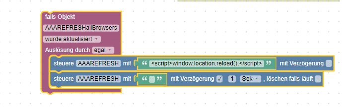

          • liv-in-sky
            liv-in-sky @Stephan Schleich last edited by liv-in-sky
            @stephan-schleich oder - die views sind alle geladen - auf einmal, müssen also nicht einzeln geladen werden - werden pro project geladen - daher werden manche vis-seiten langsam, weil im hintergrund zu viele views sind, die geladen werden, aber nicht angezeigt
            warum machst du nicht einfach einen reload der seite zu einem bestimmten zeitpunkt - da sollte reichen
            ich mache das über einen dp, den ich beschreibe und der versteckt in der vis als binding in einem html widget ist

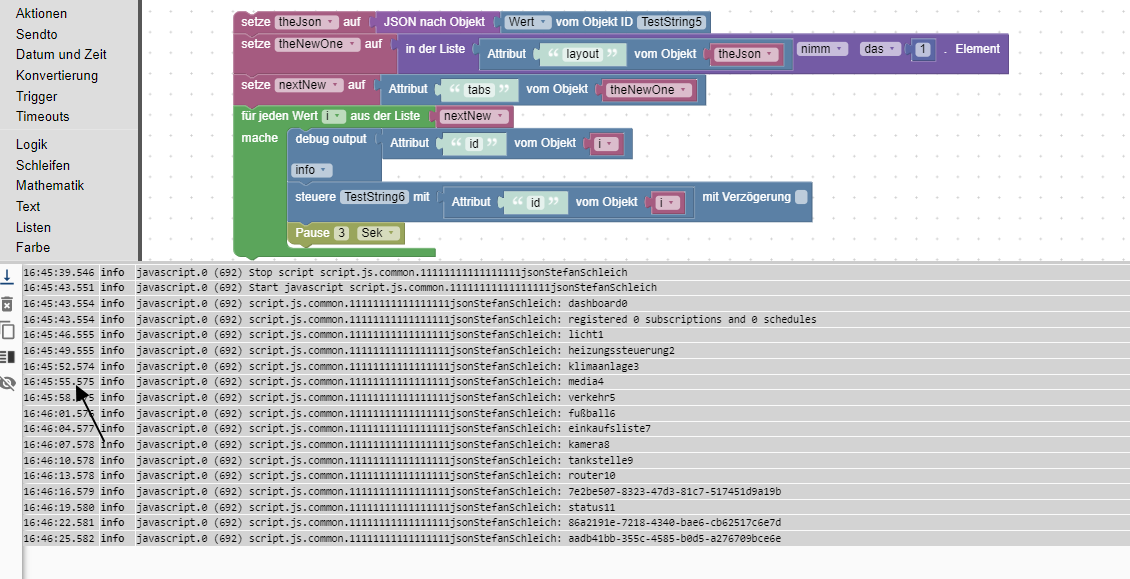

              • liv-in-sky
                @stephan-schleich
                schau mal dieses blockly - du musst die dp angleichen - schreibt im moment alle 3 sek in einen dp
                Stephan Schleich 1 Reply Last reply Reply Quote 1
                • Stephan Schleich
                  @liv-in-sky Perfekt, Vielen Dank 👍 👍
