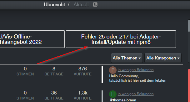

              • crunchip
                crunchip Forum Testing Most Active @headder9999 last edited by
                @headder9999 sagte in Fehler beim js-controller update:
                obroker.yamaha@0.5.3: 217
                  headder9999 @Thomas Braun last edited by
                  @thomas-braun
                  was heißt oben angepinnt?
                  • crunchip
                      headder9999 @crunchip last edited by
                      @crunchip was heißt das nun für mich?
                      • crunchip
                        crunchip Forum Testing Most Active @headder9999 last edited by crunchip
                        @headder9999 das machen was drin steht
                        die Zeile ausführen
                        for i in $(find /opt/iobroker/node_modules -type d -iname ".*-????????" ! -iname ".local-chromium"); do rm -rf ${i%%/}; done
