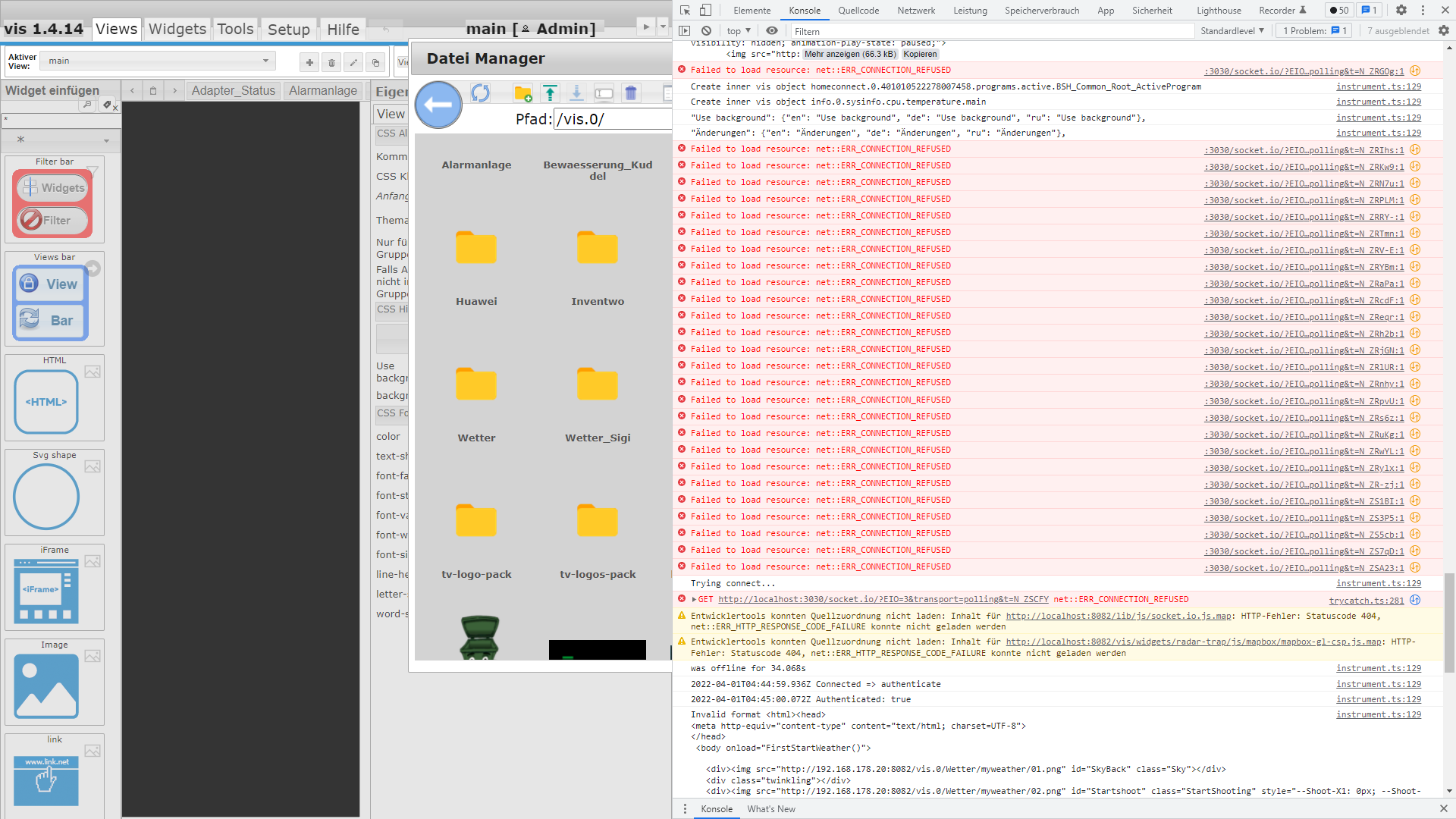

      Vis Projekte lassen sich nicht mehr via Dateimanager löschen. Es kommt immer ein Verbindungsfehler.
      Letze Aktion: Update von Vis ( 1.4.13 auf 1.4.14 )
      host.MedionHome)
      2022-04-01 09:29:23.299	info	host.Medion(Home) Restart adapter system.adapter.web.0 because enabled
      host.MedionHome)
      2022-04-01 09:29:23.299	error	host.Medion(Home) instance system.adapter.web.0 terminated with code 1 (JS_CONTROLLER_STOPPED)
      host.MedionHome)
      2022-04-01 09:29:23.298	error	host.Medion(Home) Caught by controller[0]: at parseType (C:\Program Files\iobroker\Home\node_modules\redis-parser\lib\parser.js:302:14)
      host.MedionHome)
      2022-04-01 09:29:23.298	error	host.Medion(Home) Caught by controller[0]: at parseError (C:\Program Files\iobroker\Home\node_modules\redis-parser\lib\parser.js:179:12)
      host.MedionHome)
      2022-04-01 09:29:23.298	error	host.Medion(Home) Caught by controller[0]: ReplyError: Error ERROR readDir id=vis.0: ENOTDIR: not a directory, scandir 'C:\Program Files\iobroker\Home\iobroker-data\files\vis.0\fremd\vis-user.css\'
      web.0
      2022-04-01 09:29:23.007	error	Error ERROR readDir id=vis.0: ENOTDIR: not a directory, scandir 'C:\Program Files\iobroker\Home\iobroker-data\files\vis.0\fremd\vis-user.css\'
      web.0
      2022-04-01 09:29:23.007	error	ReplyError: Error ERROR readDir id=vis.0: ENOTDIR: not a directory, scandir 'C:\Program Files\iobroker\Home\iobroker-data\files\vis.0\fremd\vis-user.css\' at parseError (C:\Program Files\iobroker\Home\node_modules\redis-parser\lib\parser.js:179:12) at parseType (C:\Program Files\iobroker\Home\node_modules\redis-parser\lib\parser.js:302:14)
      web.0
      2022-04-01 09:29:23.004	error	uncaught exception: Error ERROR readDir id=vis.0: ENOTDIR: not a directory, scandir 'C:\Program Files\iobroker\Home\iobroker-data\files\vis.0\fremd\vis-user.css\'
      host.MedionHome)-Server
      2022-04-01 09:29:22.992	warn	host.Medion(Home)-Server Objects 127.0.0.1:20053 Error from InMemDB: Error: ERROR readDir id=vis.0: ENOTDIR: not a directory, scandir 'C:\Program Files\iobroker\Home\iobroker-data\files\vis.0\fremd\vis-user.css\'

        @sigi234 sagte in VIS Projekte nicht löschbar:
        kann ich nicht bestätigen.
        Ebenfalls Vis 1.4.13 und funktioniert.
        Eventuell bei dir wegen Windows?
        • sigi234
          sigi234 Forum Testing Most Active @Negalein last edited by
          @negalein sagte in VIS Projekte nicht löschbar:
          Den Verdacht habe ich auch. 😞
