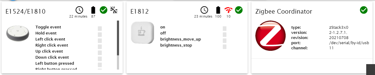

        mcm1957 @mcm1957 last edited by
        Screenshot of devices for Info
        • mcm1957
          The problem has been solved.
          The ZigBees use channel 11. And my Fritzbox with about 1m distance decided to use WLAN channel 1. Together with a quaterly Backup of some WLAN devices the zigbees were unable to communicate.
          Channel scan showed 187% usage for chanlle 11...
          Solved by fixing WLAN to channel 11
