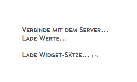

      ich komme nach dem Umzug in den LXF Container (Proxmox) nicht mehr auf die Vis über die Cloud. Lokal funktioniert das aber...
      cloud.0	2022-04-25 12:51:37.281	error	(171142) Addon vis Cannot load widget set spotify-premium Not Found
      cloud.0	2022-04-25 12:51:34.844	info	(171142) received all objects
      cloud.0	2022-04-25 12:51:33.571	info	(171142) User accessed from cloud: SN5zWb-EmGOMplERClsG
      cloud.0	2022-04-25 12:51:33.380	info	(171142) User disconnected from cloud:
      cloud.0	2022-04-25 12:51:33.379	warn	(171142) User disconnected from cloud: 0 0m2DeCmIWv96iI2vClqx
      cloud.0	2022-04-25 12:51:30.854	info	(171142) User accessed from cloud: aVP6yW9j2_7FlDpSClsE
      cloud.0	2022-04-25 12:51:30.708	info	(171142) User disconnected from cloud: Z_97wTcgLH_sLulMClnP
      cloud.0	2022-04-25 12:51:30.708	warn	(171142) Received disconnection for non-existing socketId: Z_97wTcgLH_sLulMClnP
      cloud.0	2022-04-25 12:51:11.072	info	(171142) Connection changed: connect
      cloud.0	2022-04-25 12:51:10.952	info	(171142) Trying to connect as system.user.admin
      cloud.0	2022-04-25 12:50:40.943	info	(171142) Adapter redirected temporally to "https://iobroker.pro:10556" in 30 seconds. Reason: command from server
      cloud.0	2022-04-25 12:50:40.924	info	(171142) Connection changed: connect
      cloud.0	2022-04-25 12:50:40.803	info	(171142) Trying to connect as system.user.admin
      cloud.0	2022-04-25 12:50:40.746	info	(171142) Connecting with https://iobroker.pro:10555 with "......."
      cloud.0	2022-04-25 12:50:40.723	info	(171142) starting. Version 4.1.1 in /opt/iobroker/node_modules/iobroker.cloud, node: v14.19.1, js-controller: 4.0.21
      cloud.0	2022-04-25 12:50:36.912	info	(727) Terminated (ADAPTER_REQUESTED_TERMINATION): Without reason
      cloud.0	2022-04-25 12:50:36.912	info	(727) terminating
      cloud.0	2022-04-25 12:50:36.911	info	(727) Connection lost
      cloud.0	2022-04-25 12:50:36.911	info	(727) Connection changed: io client disconnect
      cloud.0	2022-04-25 12:50:36.909	info	(727) Got terminate signal TERMINATE_YOURSELF
      cloud.0	2022-04-25 12:50:32.258	info	(727) User disconnected from cloud: J8C_LXYEyyO74MehClrb
      fehlt mir da ein widget ? das Spotify ? Den Adapter habe ich installiert ( nutze ihn aber gar nicht)

        gefunden es war der Browser verlauf...
