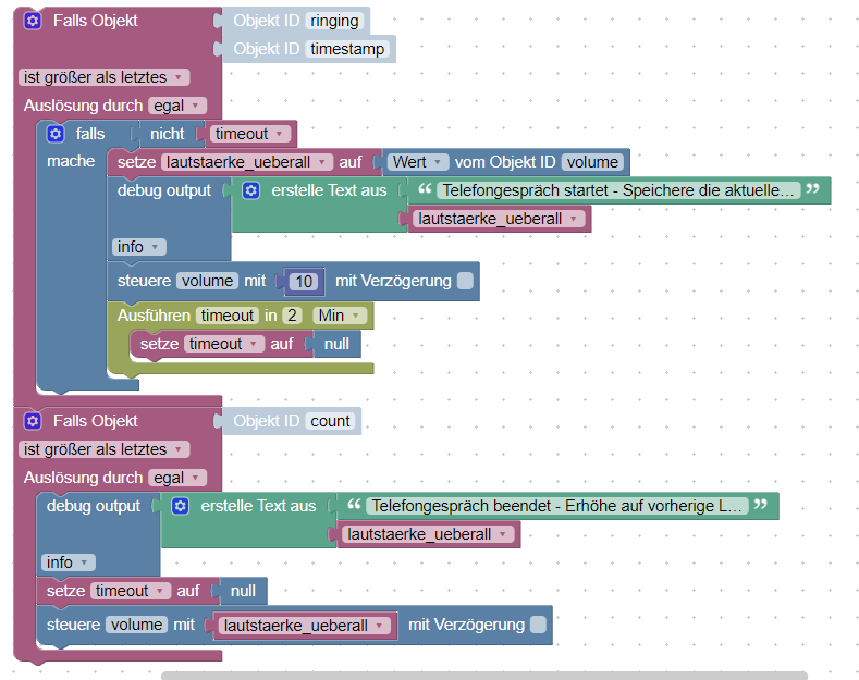

      Ich bekomme diese Fehlermeldung:
      2022-04-29 20:31:26.263  - info: javascript.0 (1154) script.js.common.telefon_klingelt: Telefongespräch beendet - Erhöhe auf vorherige Lautstärke undefined
      2022-04-29 20:31:26.265  - warn: javascript.0 (1154) You are assigning a undefined to the state "alexa2.0.Echo-Devices.0026485aaf2447eb99c27f9e19e6909d.Player.volume" which expects a number. Please fix your code to use a number or change the state type to undefined. This warning might become an error in future versions.
      2022-04-29 20:31:26.547  - warn: javascript.0 (1154)     at setState (/opt/iobroker/node_modules/iobroker.javascript/lib/sandbox.js:1530:20)
      2022-04-29 20:31:26.548  - warn: javascript.0 (1154)     at Object.<anonymous> (script.js.common.telefon_klingelt:19:3)
      2022-04-29 20:31:26.548  - warn: javascript.0 (1154)     at Object.callback (/opt/iobroker/node_modules/iobroker.javascript/lib/sandbox.js:1167:38)
      2022-04-29 20:31:26.549  - warn: javascript.0 (1154)     at Object.stateChange (/opt/iobroker/node_modules/iobroker.javascript/main.js:586:29)
      2022-04-29 20:31:26.549  - warn: javascript.0 (1154)     at Immediate._onImmediate (/opt/iobroker/node_modules/@iobroker/js-controller-adapter/src/lib/adapter/adapter.js:5909:56)
      2022-04-29 20:31:26.549  - warn: javascript.0 (1154)     at processImmediate (node:internal/timers:466:21)
      2022-04-29 20:31:41.848  - info: javascript.0 (1154) script.js.common.telefon_klingelt: Telefongespräch startet - Speichere die aktuelle Lautstärke 40
      2022-04-29 20:31:51.253  - info: javascript.0 (1154) script.js.common.telefon_klingelt: Telefongespräch beendet - Erhöhe auf vorherige Lautstärke 40
      zu diesem Blockly:
      var lautstaerke_ueberall, timeout;
      on({id: new RegExp('tr-064\\.0\\.callmonitor\\.ringing' + "$|" + 'tr-064\\.0\\.callmonitor\\.outbound\\.timestamp' + "$"), change: "gt"}, async function (obj) {
          if (!timeout) {
          lautstaerke_ueberall = getState("alexa2.0.Echo-Devices.G2A0QU0574340BU1.Player.volume").val;
          console.log(('Telefongespräch startet - Speichere die aktuelle Lautstärke ' + String(lautstaerke_ueberall)));
          setState("alias.0.alexa_ueberall_gruppe.volume"/*volume*/, 10);
          timeout = setTimeout(async function () {
            timeout = null;
          }, 120000);
      on({id: 'tr-064.0.calllists.all.count', change: "gt"}, async function (obj) {
        var value = obj.state.val;
        console.log(('Telefongespräch beendet - Erhöhe auf vorherige Lautstärke ' + String(lautstaerke_ueberall)));
        timeout = null;
        setState("alexa2.0.Echo-Devices.0026485aaf2447eb99c27f9e19e6909d.Player.volume"/*volume*/, lautstaerke_ueberall);
      Wo muss denn der Typ angepasst werden? Meine Schatzkarte für die Java-Piraten-Insel ist da etwas löchrig...

        @thomas-braun sagte in Java ist eine Insel...:
        wenn ich das tichtig sehe ist das
        setState("alexa2.0.Echo-Devices.0026485aaf2447eb99c27f9e19e6909d.Player.volume"/volume/, lautstaerke_ueberall)
        dann ist lautstärke überall nicht initialisiert
        was hatte denn der debug ausgeworfen?
          @homoran sagte in Java ist eine Insel...:
          ? Das Log ist vollständig, inkl. Debug-Meldungen.
            Homoran Global Moderator Administrators @Thomas Braun last edited by Homoran
            hast du das Skript gestartet als du am telefonieten warst?
            und dann das Telefonat beendet?
            dann konnte das Skript die bisherige Lautstärke nicht kennen. weil die noch nicht definiert war = undefined
            mach mal oberhalb dercTrigger einenen setze lautstaerke-ueberall auf 40 block
              Das skript lungert die ganze Zeit rum. Was skripte halt so tun.
              Ich hab das Gespräch beendet.
                @thomas-braun hab editiert
                  Hat sich erledigt. Hab die Datenpunkte aus dem tr-064 Adapter nochmal neueingelesen. Hat wohl nach einem Update der FritzLabor-Firmware irgendwie geklemmt.
