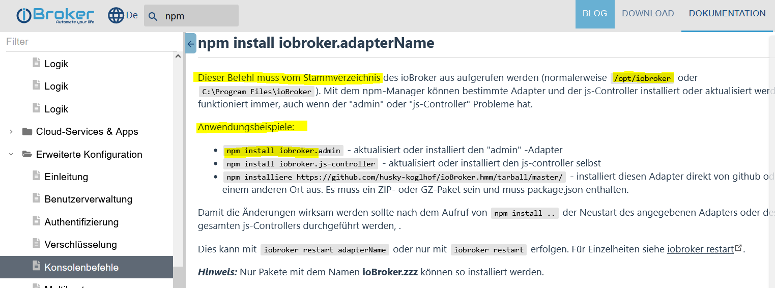

      @aidan
      https://www.iobroker.net/#de/documentation/config/cli.md
